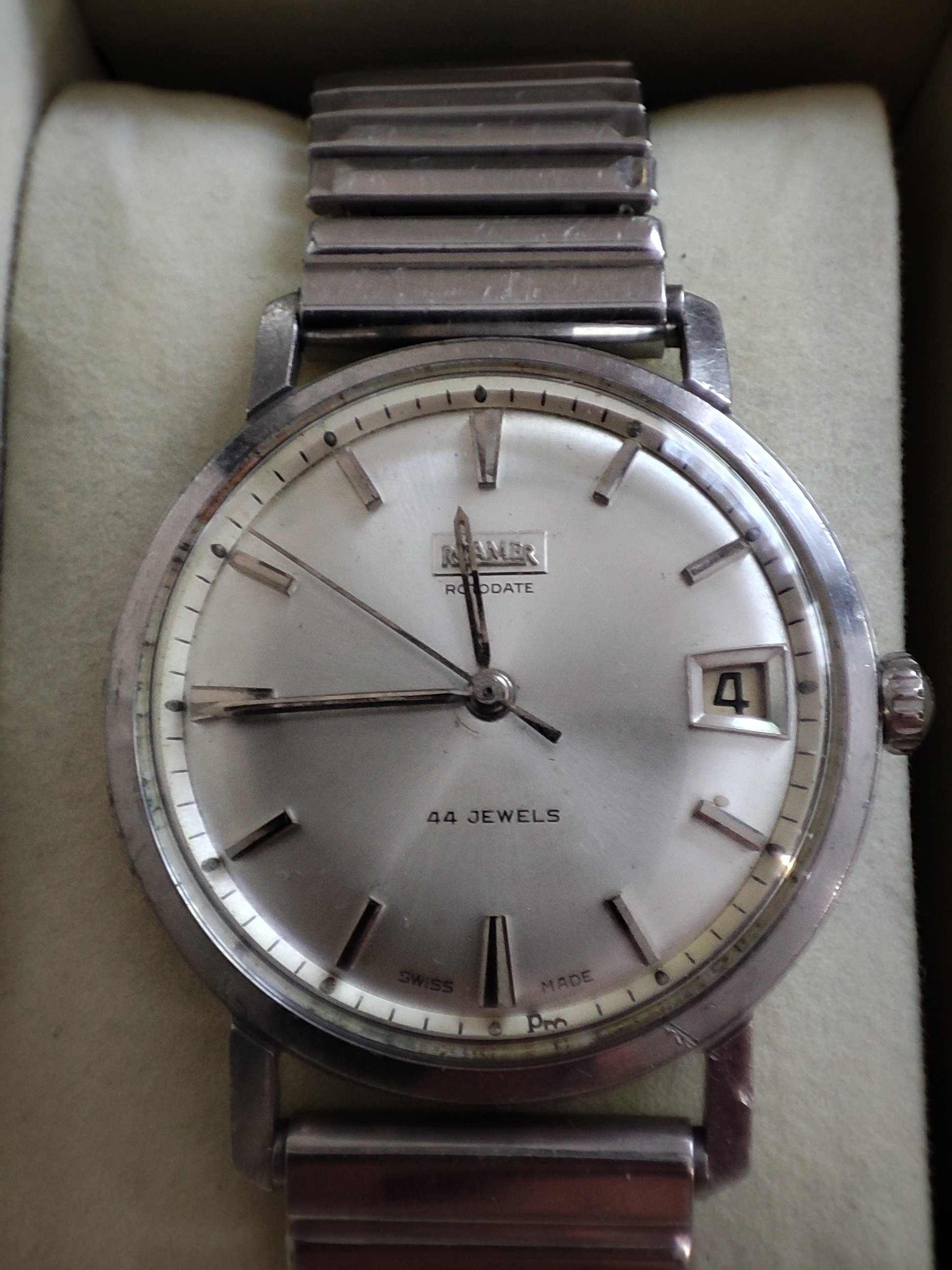

Had a similar occurrence with a Roamer 44 jewel watch which needed the correct column wheel but the previous repairer obviously couldn't find the exact one and used a part from the same Roamer calibre but was slightly shorter due to differences in date and dateless movement configurations.
The workaround for the wrong part was to dish the dial inward to make up for the shorter wheel height.
The upshot was hands at weird upward pointing angles and a damaged dial.
I have never seen 2 alike dials in the Roamer 44 range and this one was unusual in that it had the less common raised applied Roamer badge and less commonly seen raised shaped indices but after a lot of searching on this hopeless case my Watchmaker managed to locate in his stash an exact identical dial in as near to perfect condition as you could expect for a 60 year old dial and parts to complete the other wise basket case watch, I don't know who was more surprised, him or me!

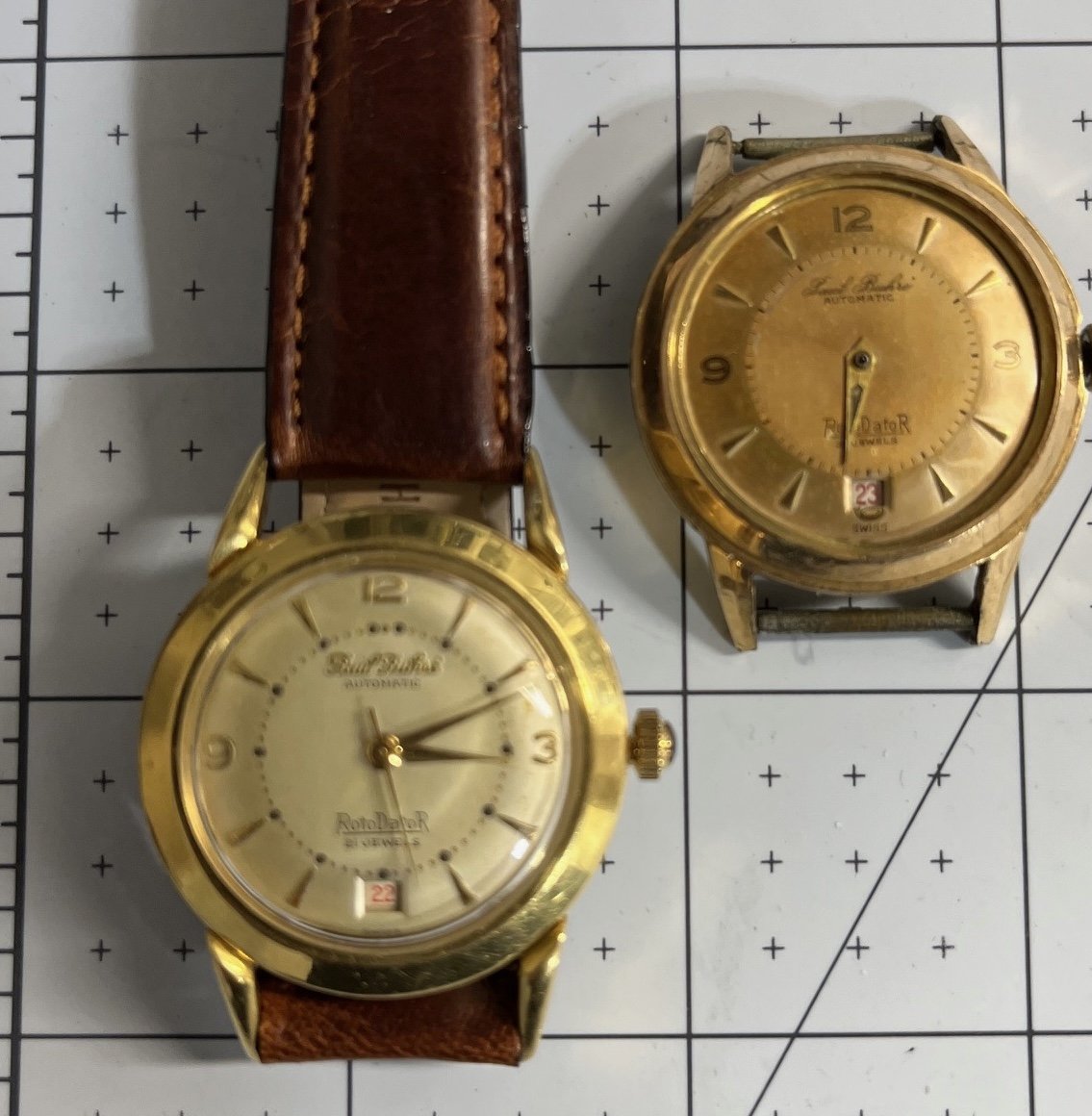

The pictures. The watch on the right is the Felsa 692 (date at 6), name Paul Buhre printed on the dial. This was from my stash. Gold filled case. The one on the left is my friend’s watch. The case is 18-karat, movement is Felsa 692, date at 6. He got back the watch on the left, the only difference was the dial swap from the one on the right. The Paul Buhre name on the donor dial is embossed, not printed. The one on the right now has the crappy dial on it. I gave it to him for spares. (His photo, not mine!)

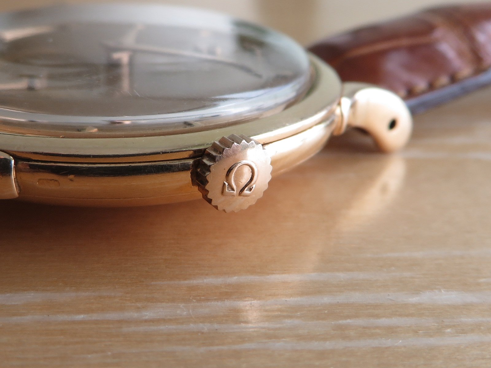

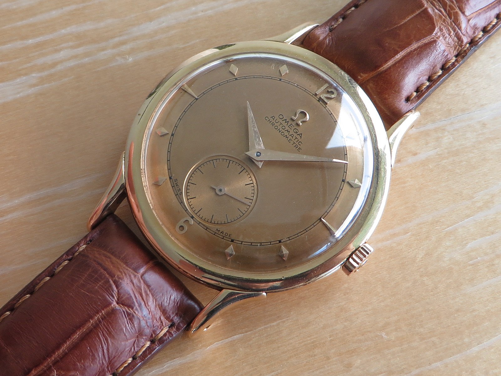

Here's mine.
2500 Centenary, weird not quite rose gold color, crown was wrong when I bought it years ago, lived with it still loved it. Pretty much gave up on finding an appropriate crown, hard enough finding one in yellow let alone this shade. Month or so ago I'm looking for something completely different in my movement stash, bingo correct crown, correct color poking out of a unrelated spare movement. Probably had the spare movement as long as the Centenary!

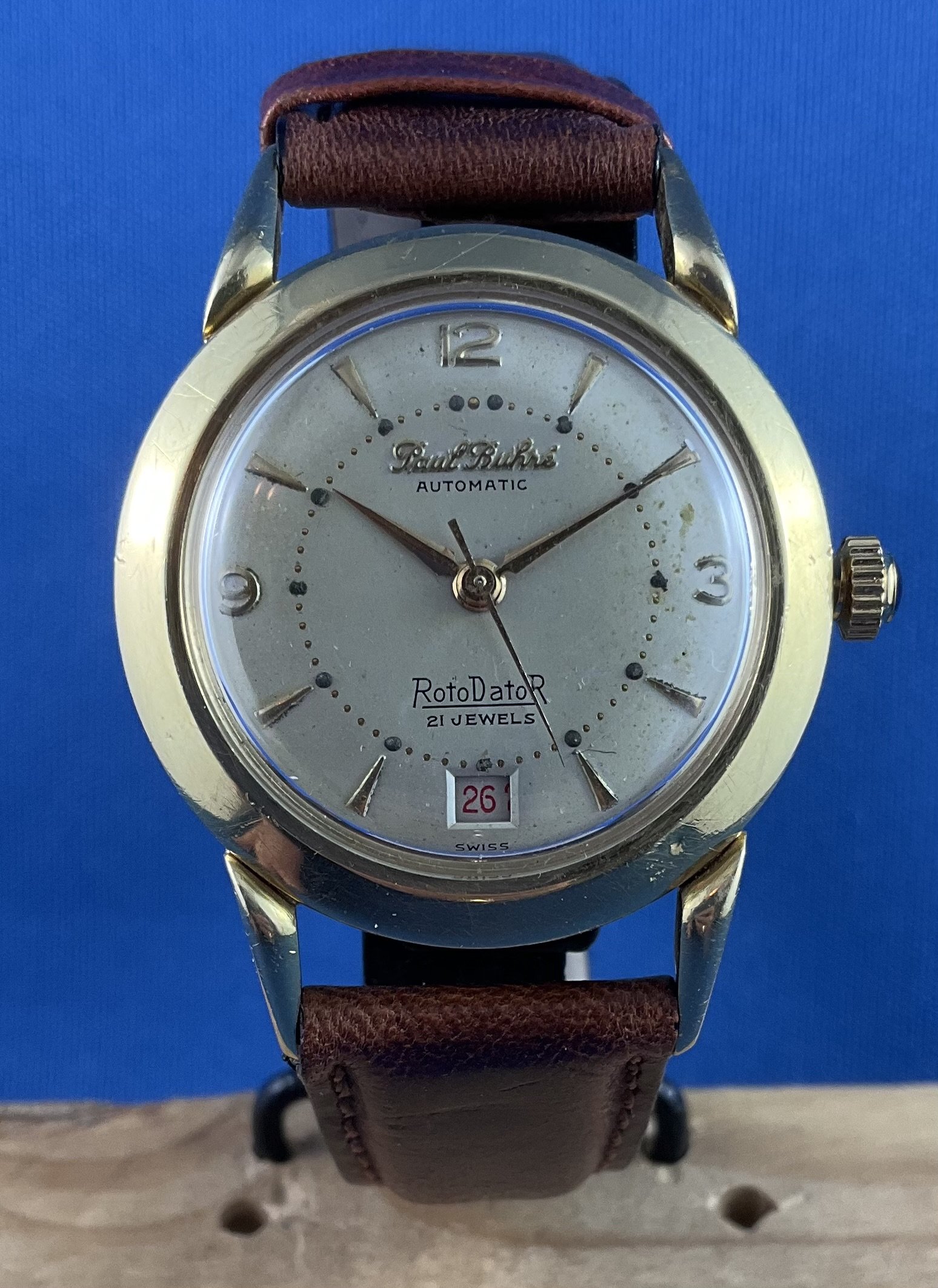

I had an opportunity to take a picture of the Paul Buhre, today.
