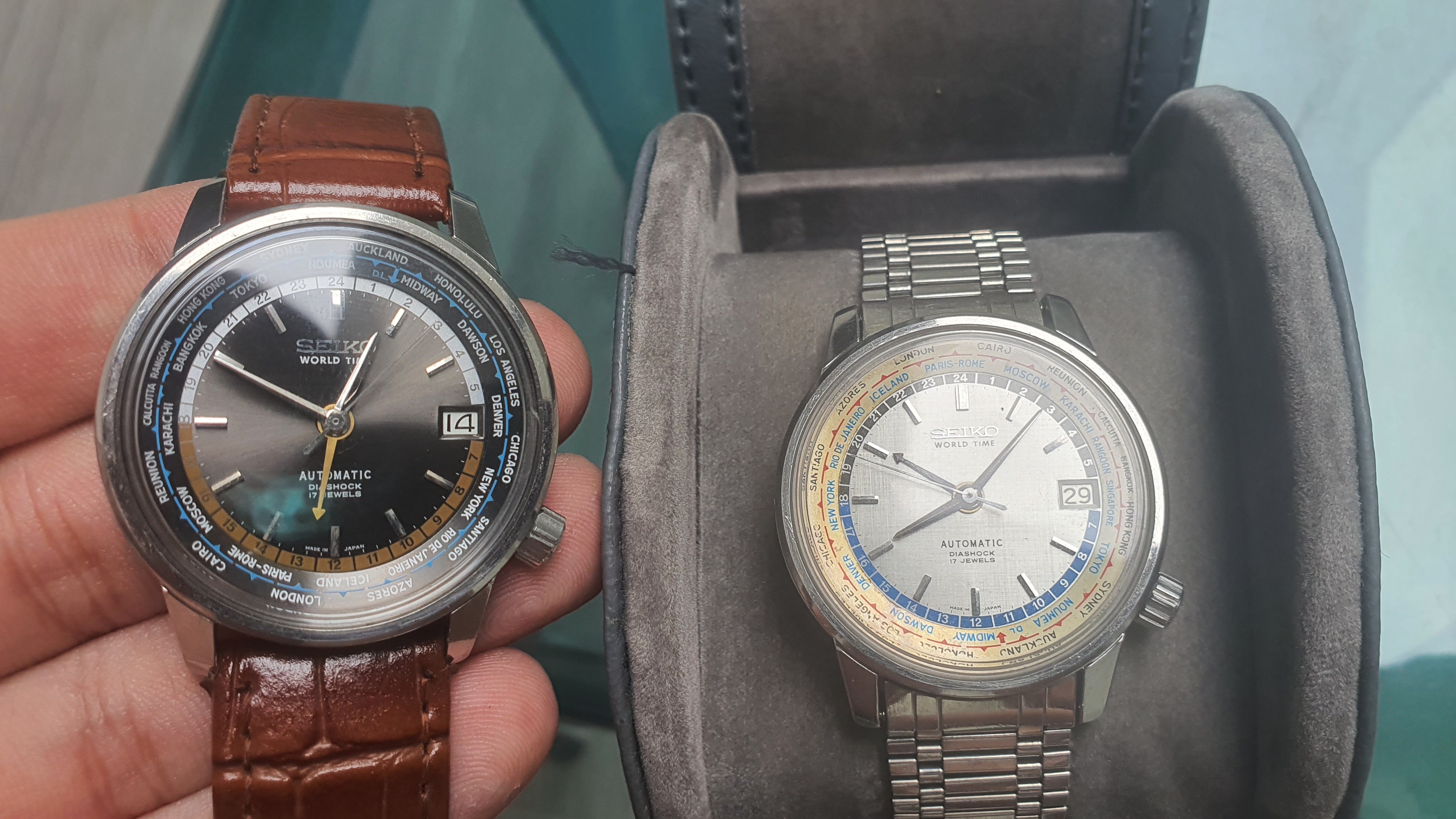

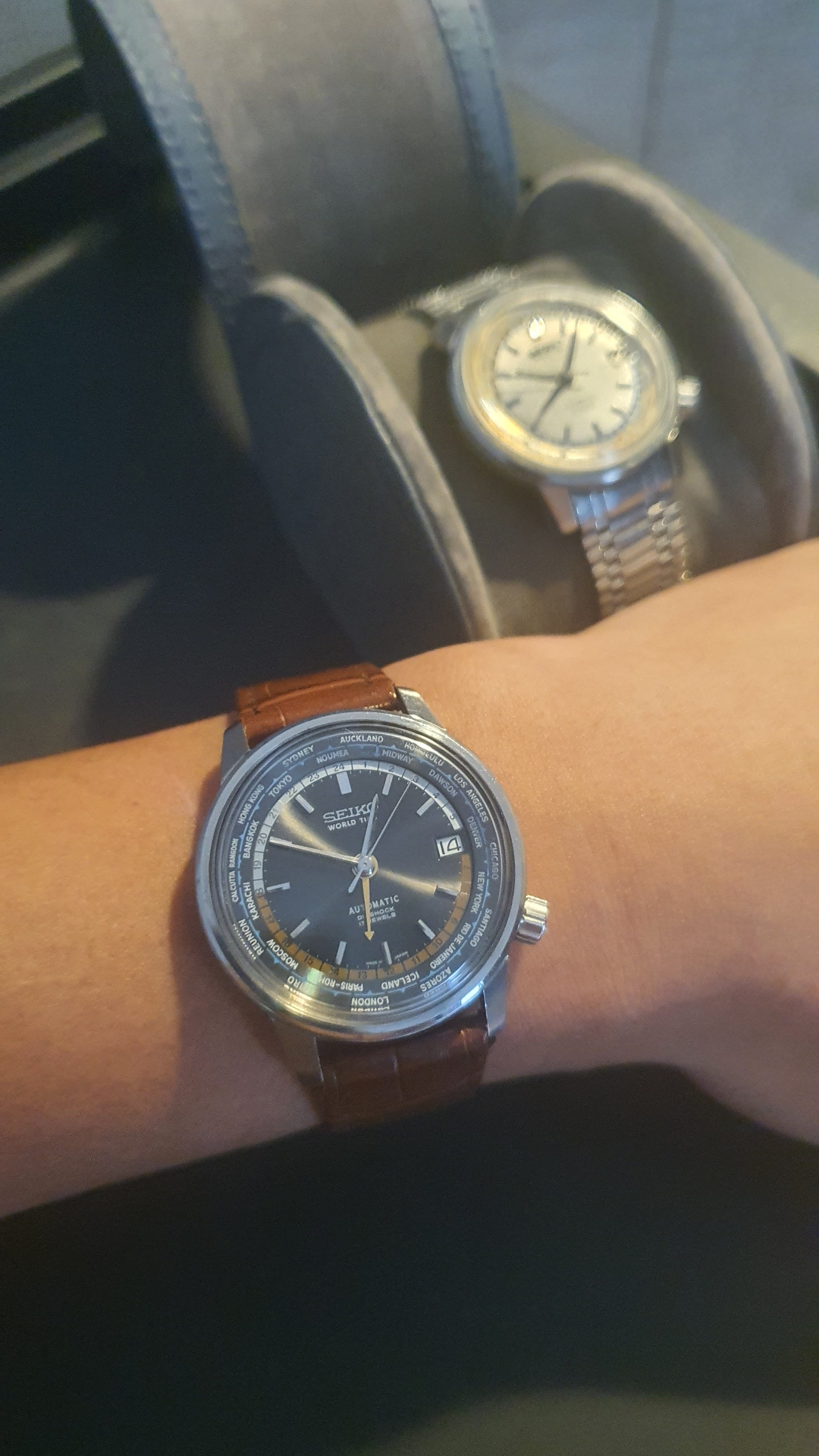

I've been offered the following for about 550 USD including taxes.
I have 3 seiko WT, with one coming in soon.
So I will sell one of them
60
58

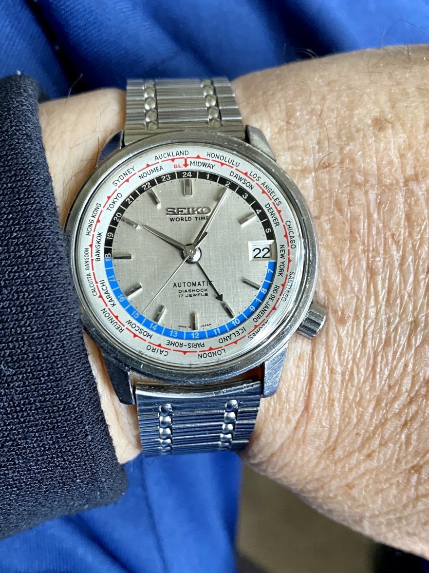

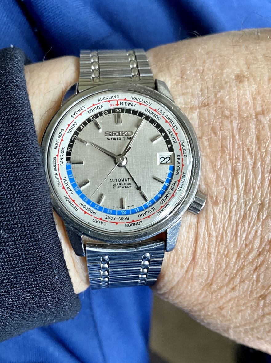

I just got another silver world time, and will compare those twos first.
All three are the early edition, with large crown and black gmt hand for the silver WT
Then I will sell one of them silver WT (just the watch without bracelet)
143
465

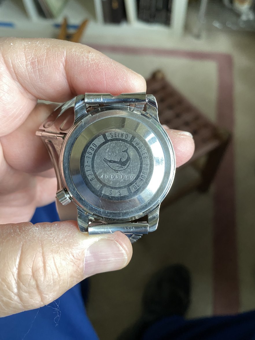

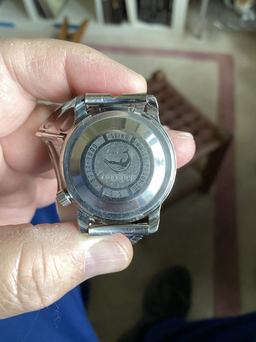

@Eclipse39 very nice. The thick / tapered GMT hands on yours and the MADE IN JAPAN dials indicate earlier production models, likely before August 1964. Your silver dial 6217-7000 has the cities bezel from the 6217-7010 - easiest tell is the addition of Singapore and the inner ring of cities in blue instead of black.
