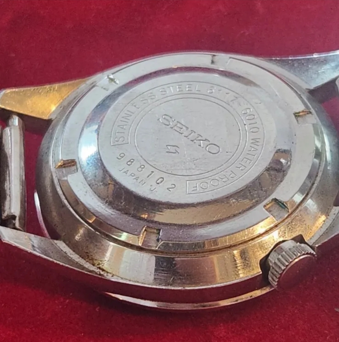

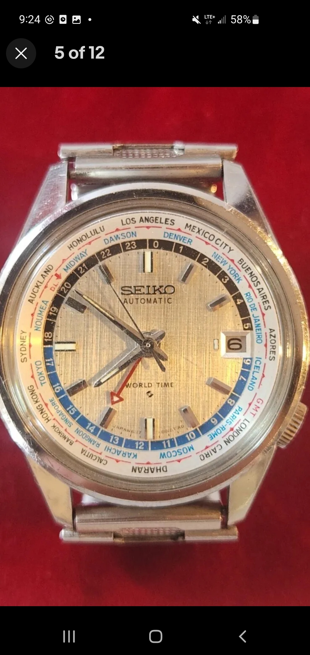

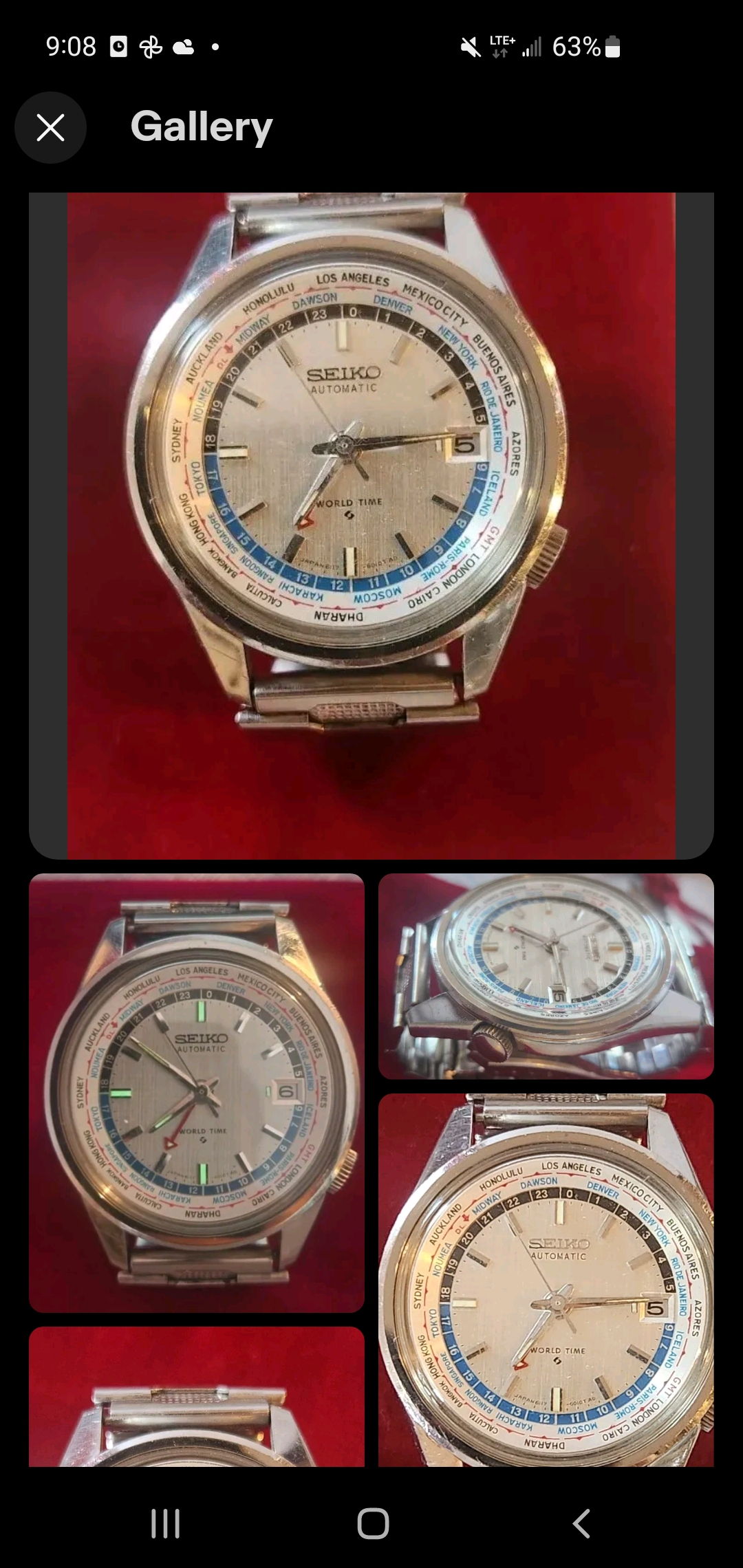

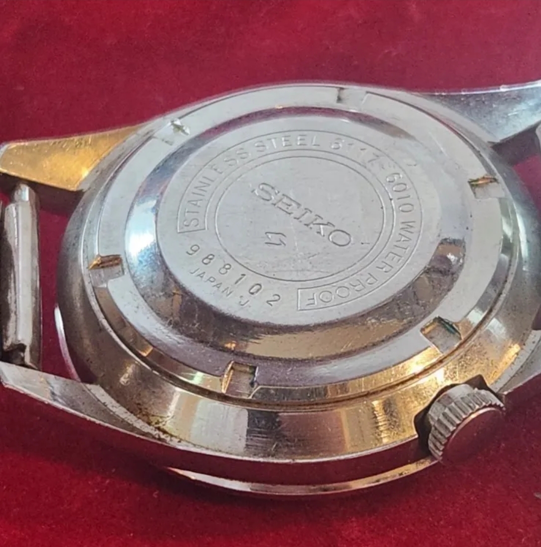

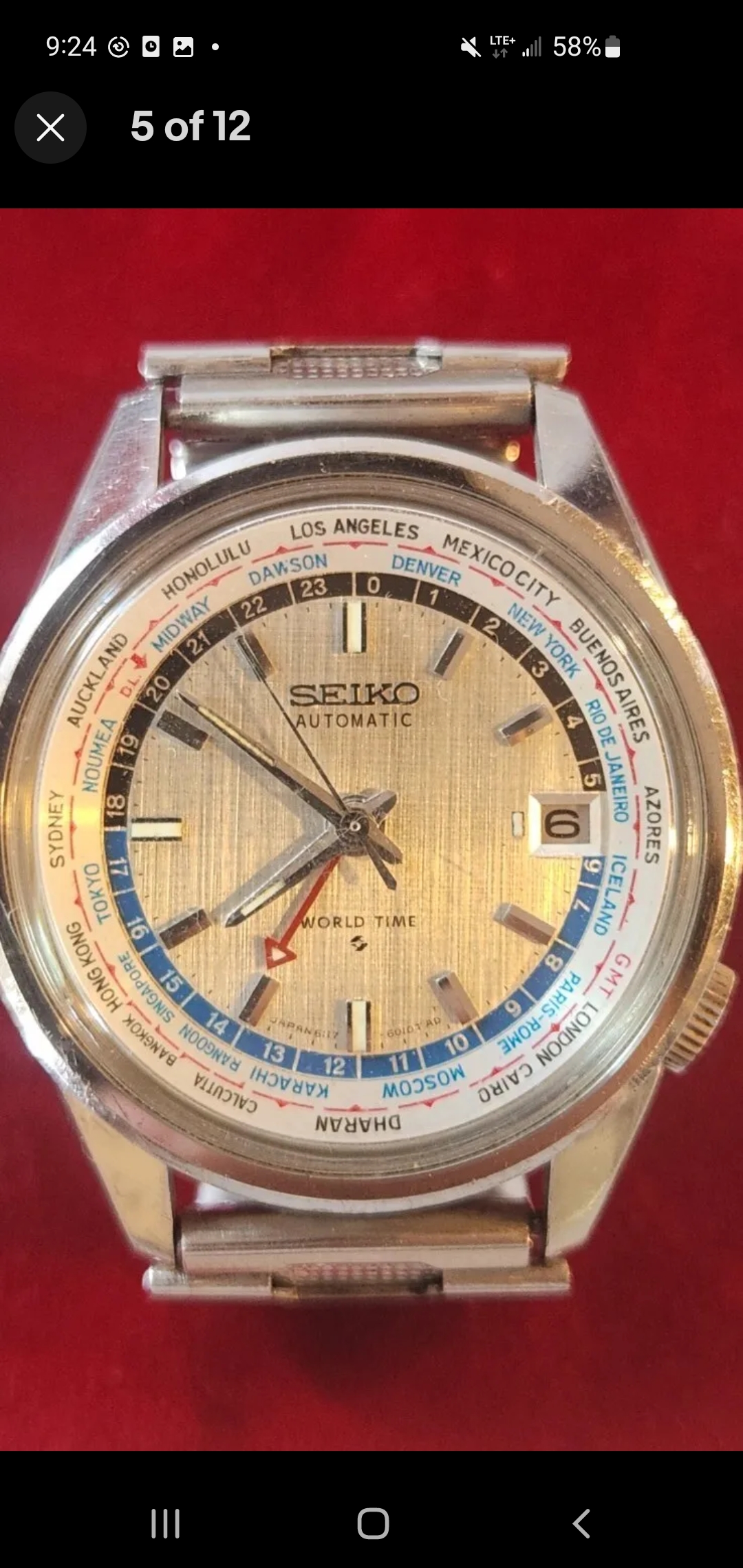

I've been offered the following for about 550 USD including taxes. It's advertised as a 68, but I'm fairly sure it's from August 1969, right? As I understand it, this version of the bezel (with London separate from GMT, Cairo, etc.) would be correct for this time period, right?
If so, what do you all think of the price? The bracelet is probably not worth anything, the case is honest but not great, and although it runs fine, a service would probably be necessary. Also, I'd probably only buy it to pass it along here (at cost, of course), as I can't really justify owning it myself for very long at the moment at that price. But if this is actually a good deal, I'd happily accept the offer or pass along the auction info (although I've been trying to work this seller down to a fair price for a couple of weeks).

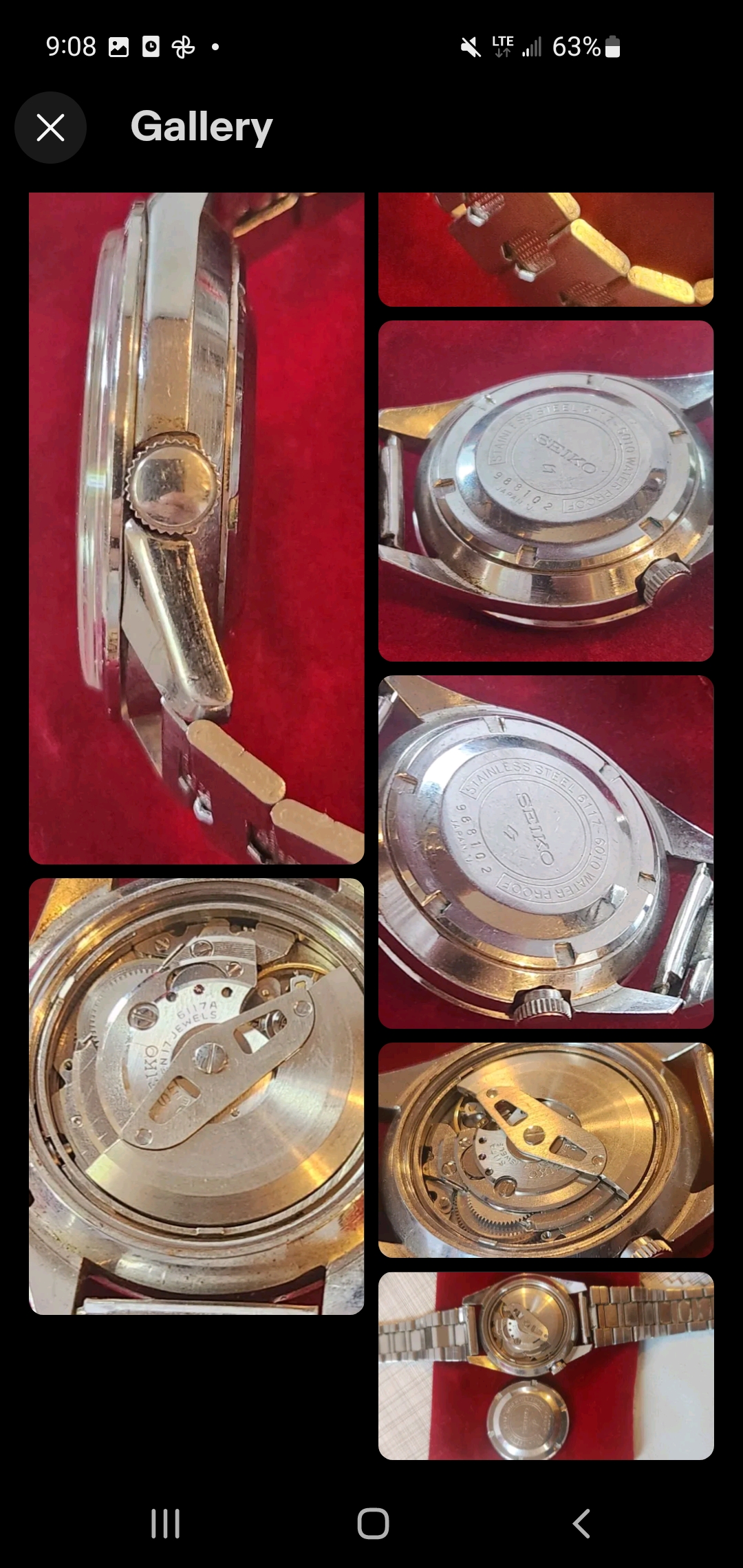

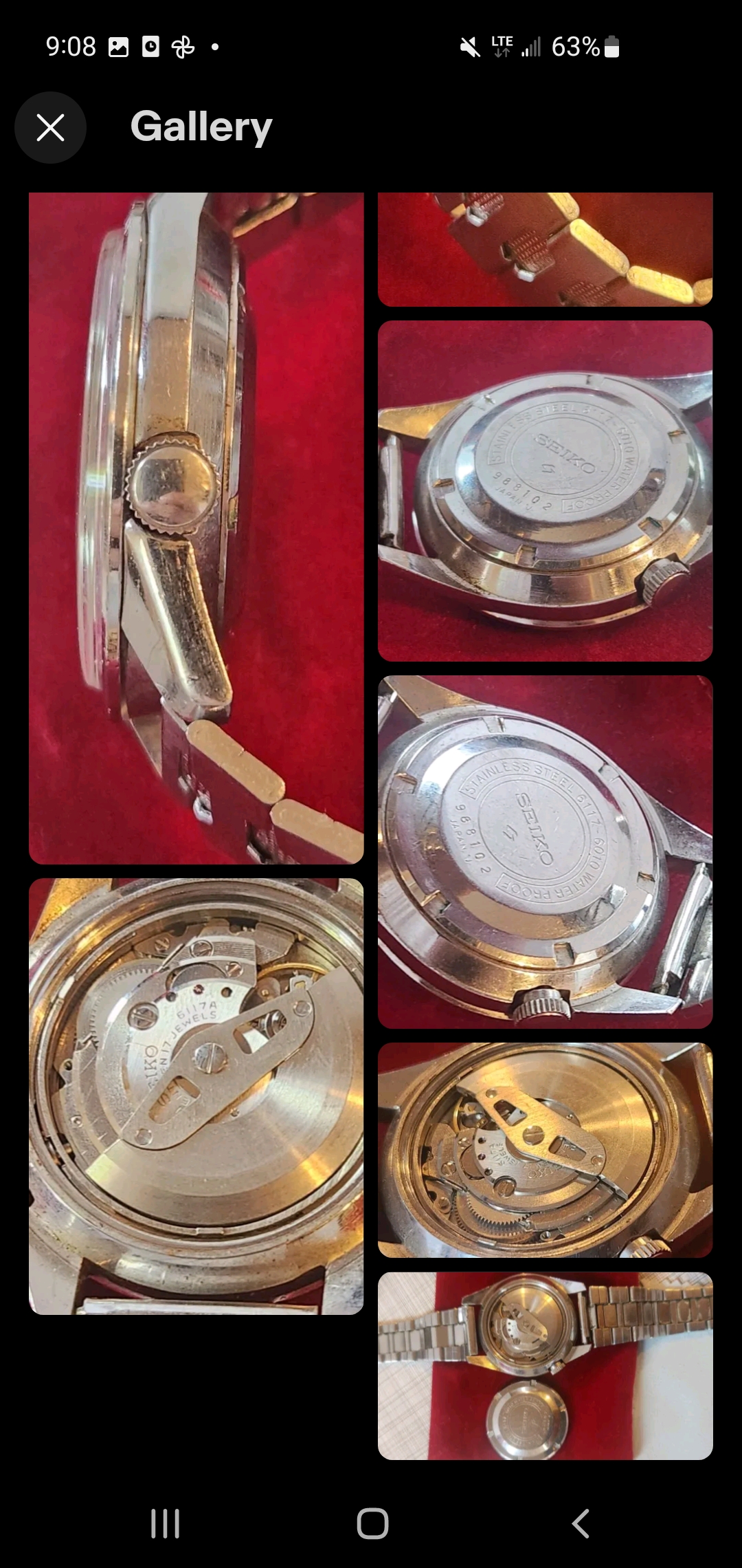

I'm sharing screenshots of multiple photos, but if more detail is required, I can share larger photos.

When you run the serial number through a Seiko serial decoder what’s the date?

550 for a decent condition 6117 seems like a decent deal.

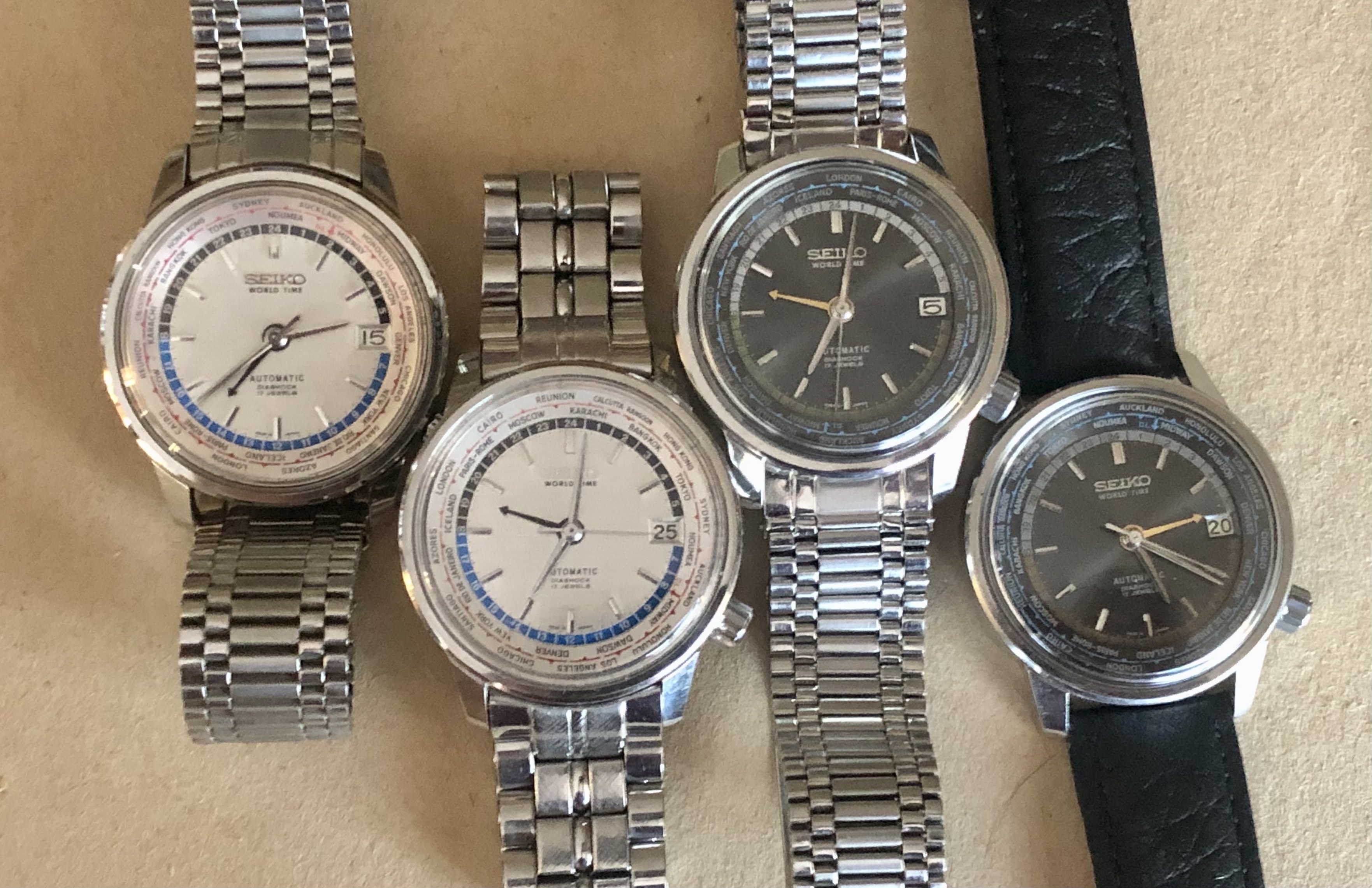

I don’t follow the world timers as much as I prefer the navigator timers.
250
715
Prices have come down a lot over the last few months, but I agree that it does sound fair. If you need to know anything about World Timers check out -
https://www.seikoworldtime.com/
It has a huge amount of info. Dan, the guy who set it up is a great resource and he has more world timers than anyone I have seen!

Thanks for that website. That's very helpful. I had stumbled upon part of the website once before but couldn't find it again.
It seems that the GMT hand isn't moving (I should have noticed that in the photos sooner), so I think I'll probably end up passing unless the seller will come down quite a bit more. Thanks for the help!

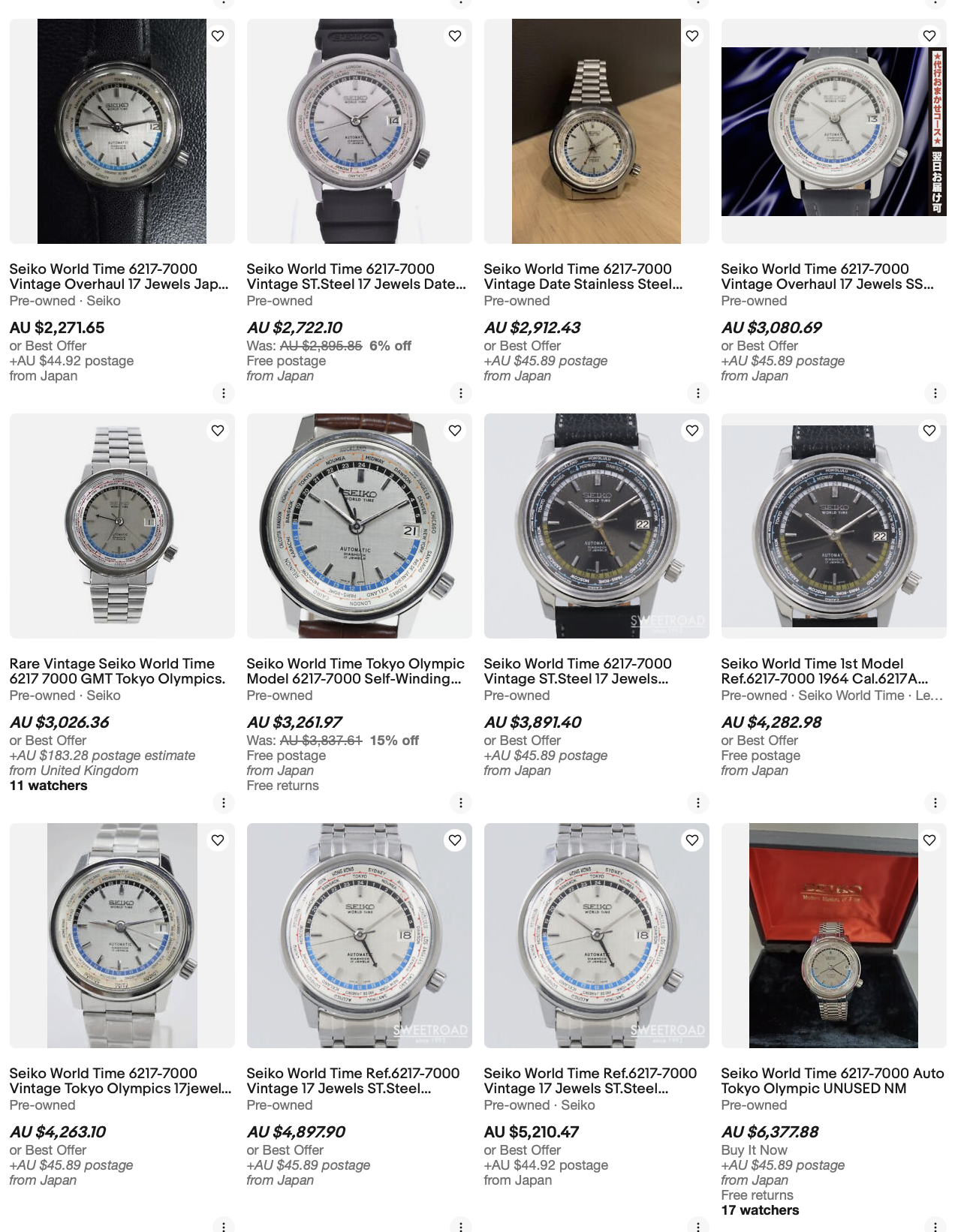

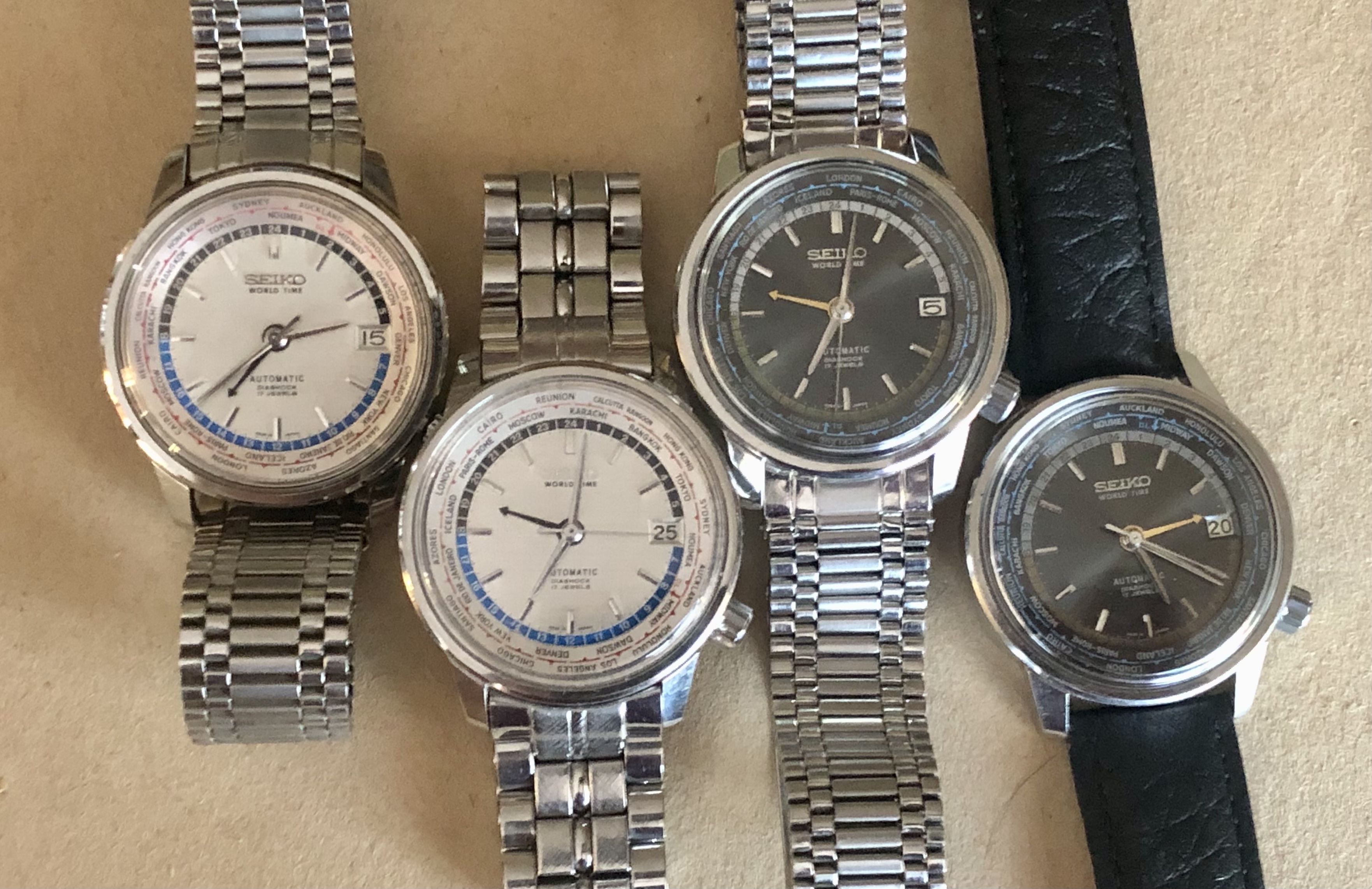

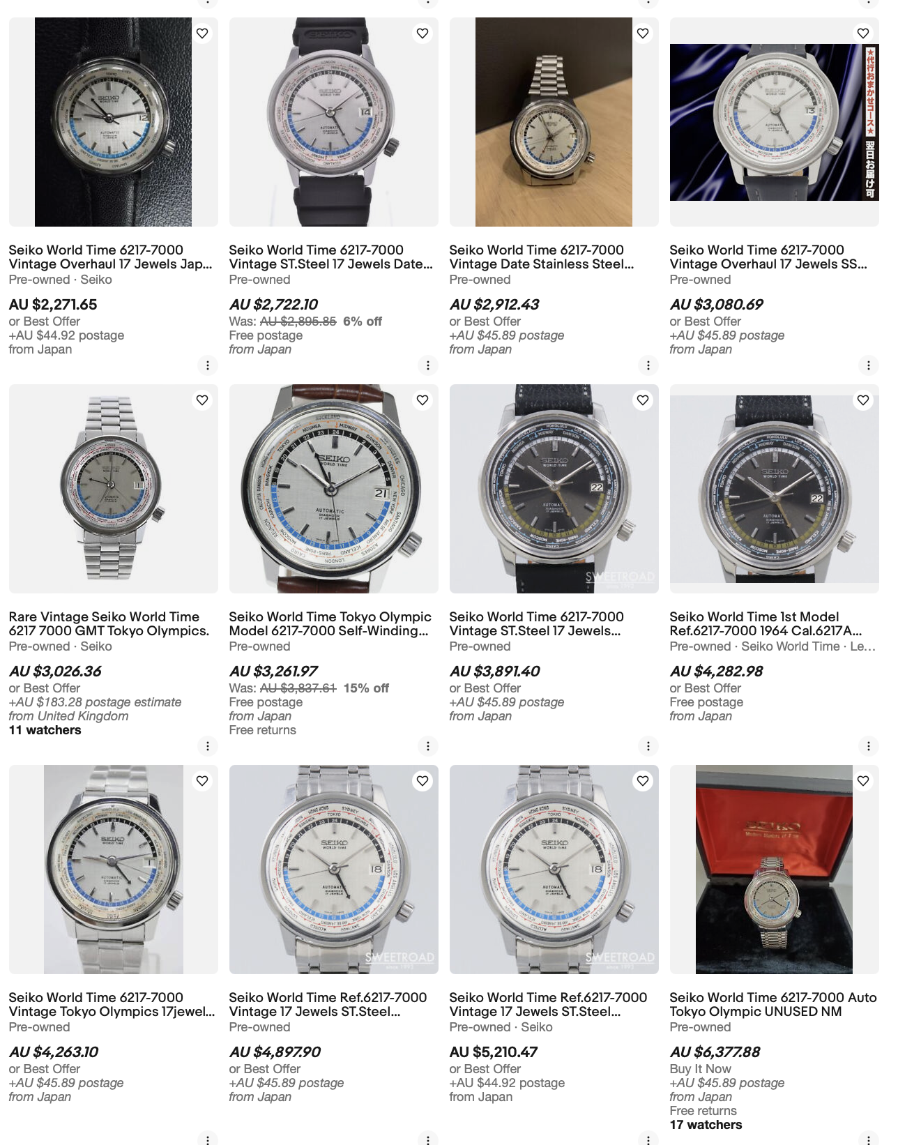

I think you may have missed my point. You put up an image of a page of 6217’s for sale. We are talking about a 6117. Very different price points Also, I’m currently paying a lot less for 6139’s than previously. As in, right now they are cheap compared to 12-24 months ago…

Even for a decent 6217 world time, none of those prices are realistic (now or before the market softened on hot Seiko). $1500AUD tops, but most would trade below $1k.

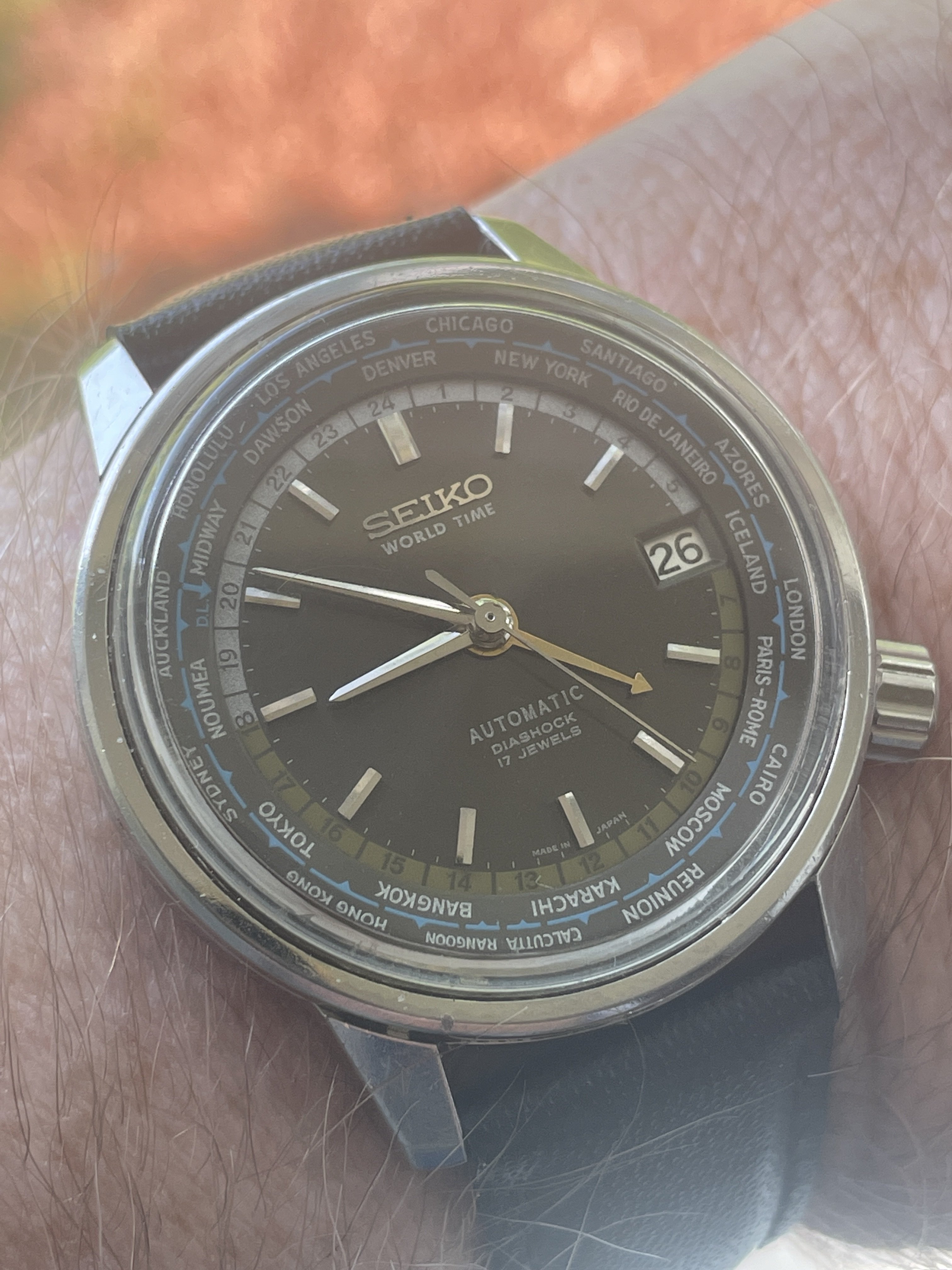

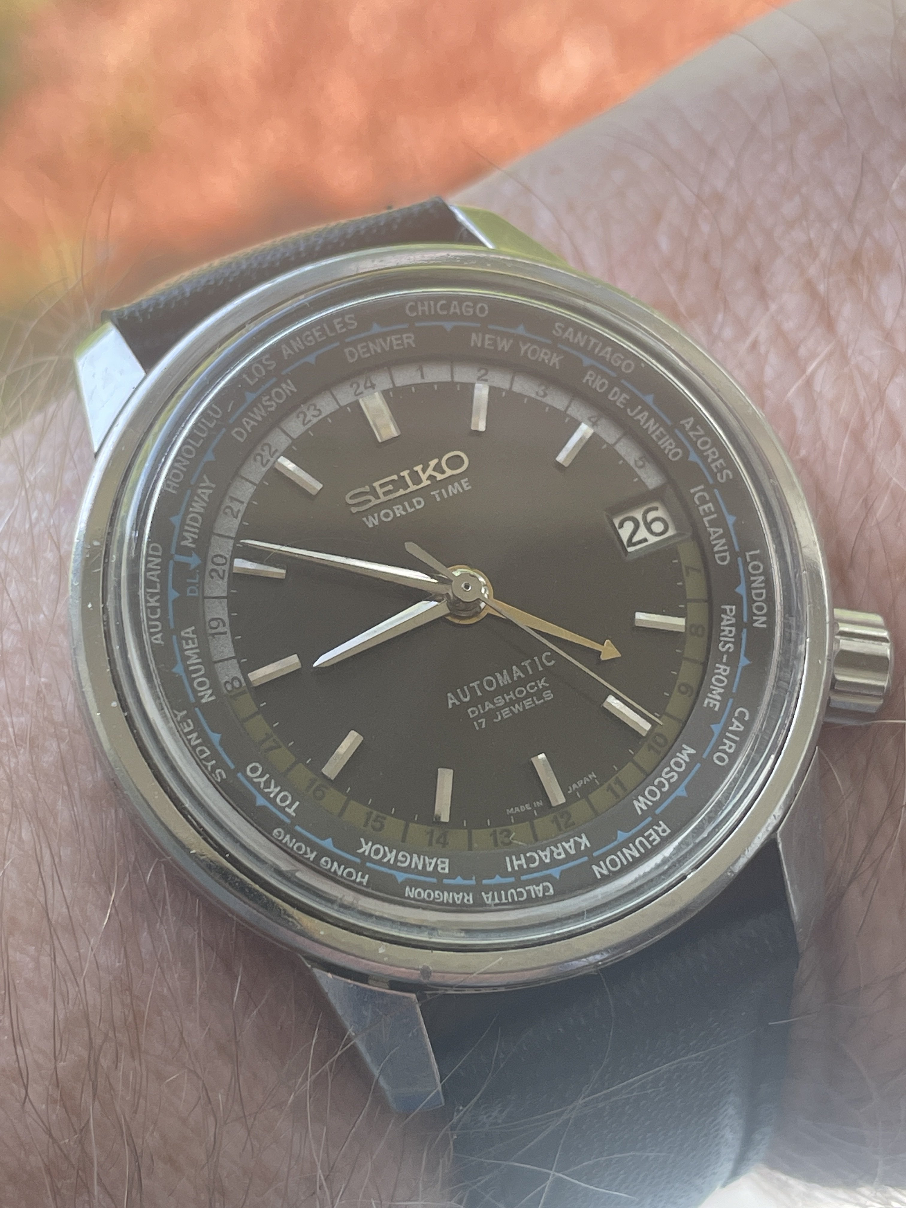

People are crazy. I have a 64 world timer I purchased here for a reasonable price from a cool member. Tbh I just really like the looks of them. The OP’s looks nice as well. Might wear mine today but I know it’s nowhere near as valuable as what these people are asking. Doesn’t matter to me, I get watches I like.

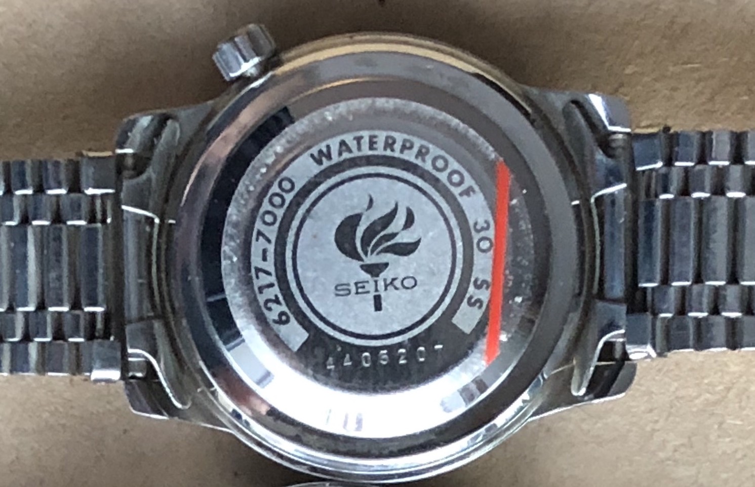

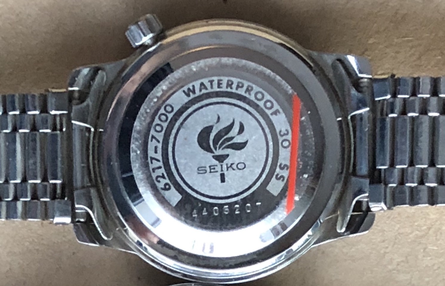

I agree, the 6217s are generally at a higher price point than 6117, especially the examples from 1964 with a decent Olympic torch case-back. And as Ashton noted, they don't actually sell for thousands (even of AUD) in my experience. I think a pristine example with the original bracelet might approach $2k USD between collectors. The condition of the case-back is often the giveaway for condition.
Interesting that you're seeing a drop in 6139 prices. In the references I follow closely (mostly early divers, world-timers, and early 60s sport models), the prices seem pretty flat. I wish they would drop!
