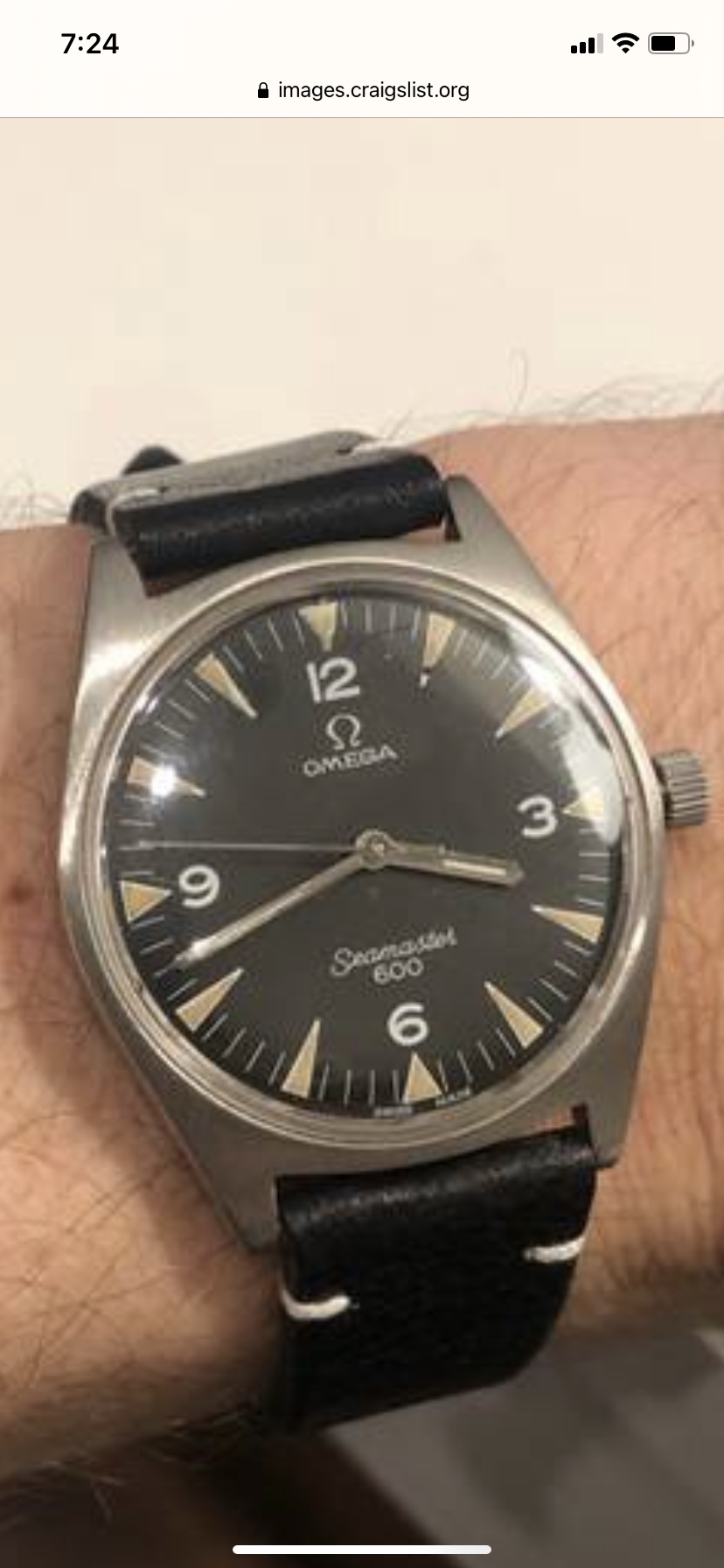

Hi kind OF people! just wanted to run this by you experts. My radar is going off but... I dunno!
thanks very much in advance.
oh and the person is asking CAD 1000 so basically around 780 bucks US
Cheers 😁
553
971

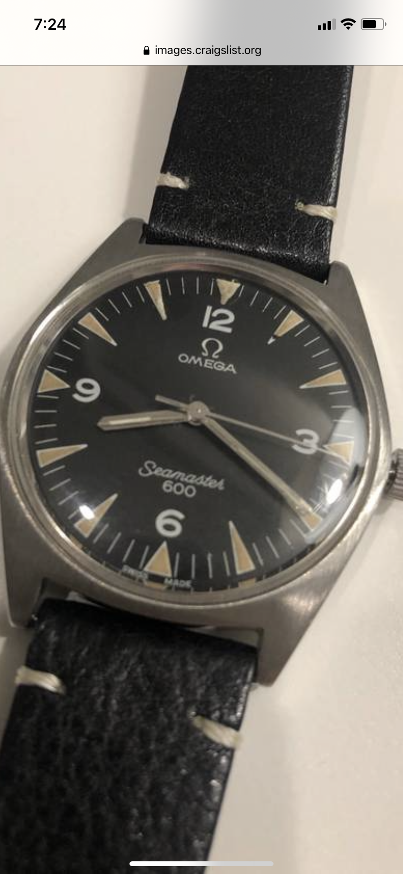

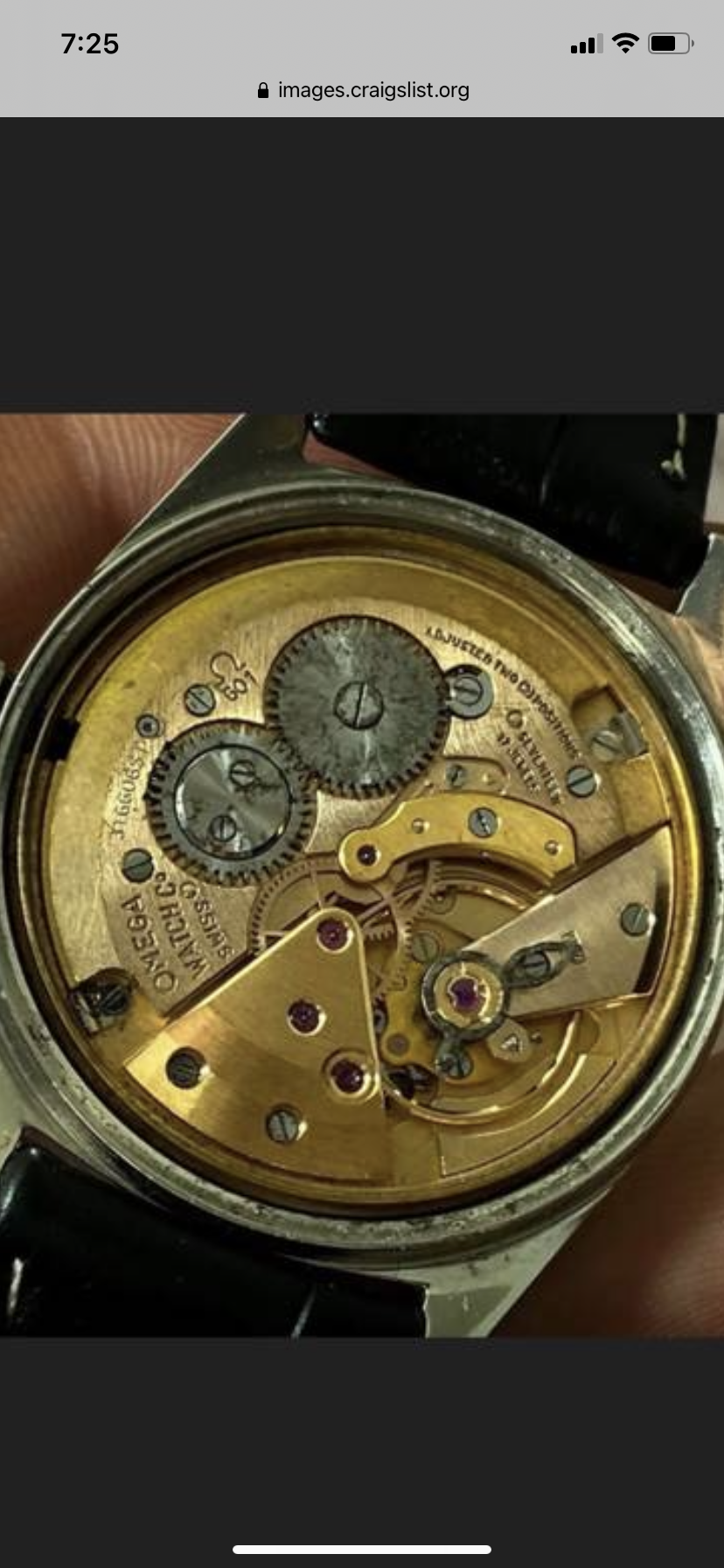

The movement looks real bad/dirty and the lume on the hands looks a little too good. Not to mention no “T” tritium indication on the dial 😒

Seems fishy because it is fishy. Don't get hooked on a shameless redial as I was.

Shoot really eh!?!
What gives it away so quickly? In order to further my education. Thanks!
7,159
57,810
That style of dial never appeared on an Omega having a 601 movement just as it didn't appear on any Omega with a 520 movement such as mine is. Omega produced dials are better finished than either your find or my watch.

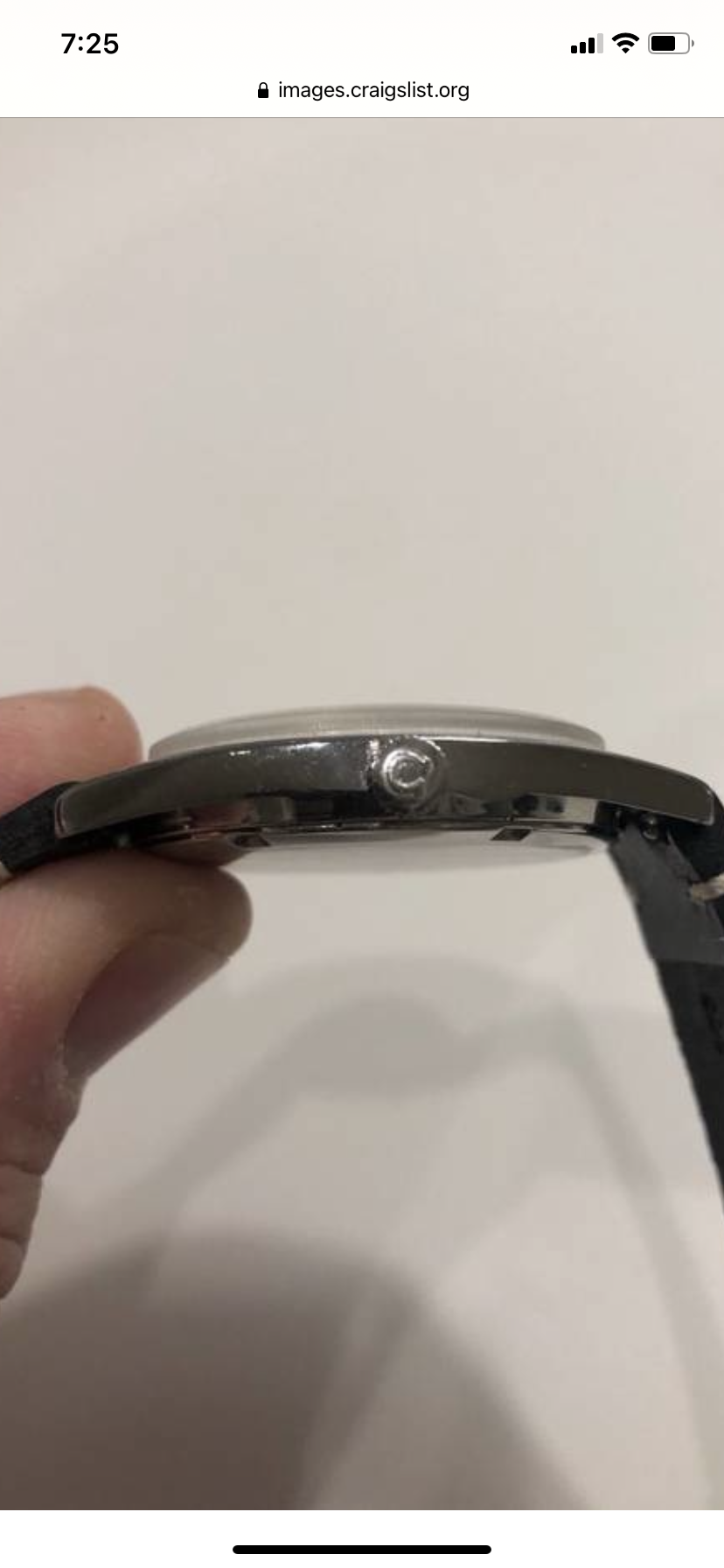

Looks like a Geneve case...
I was thinking that too. It's easy to get so caught up in evaluating the dial that one is missing that a Seamaster 600 should not be in that case. At least as far as I am aware of.
Exactly right. Looks like a 135.041 which is powered by a 601 movement. And this 601 is rough my friend.
