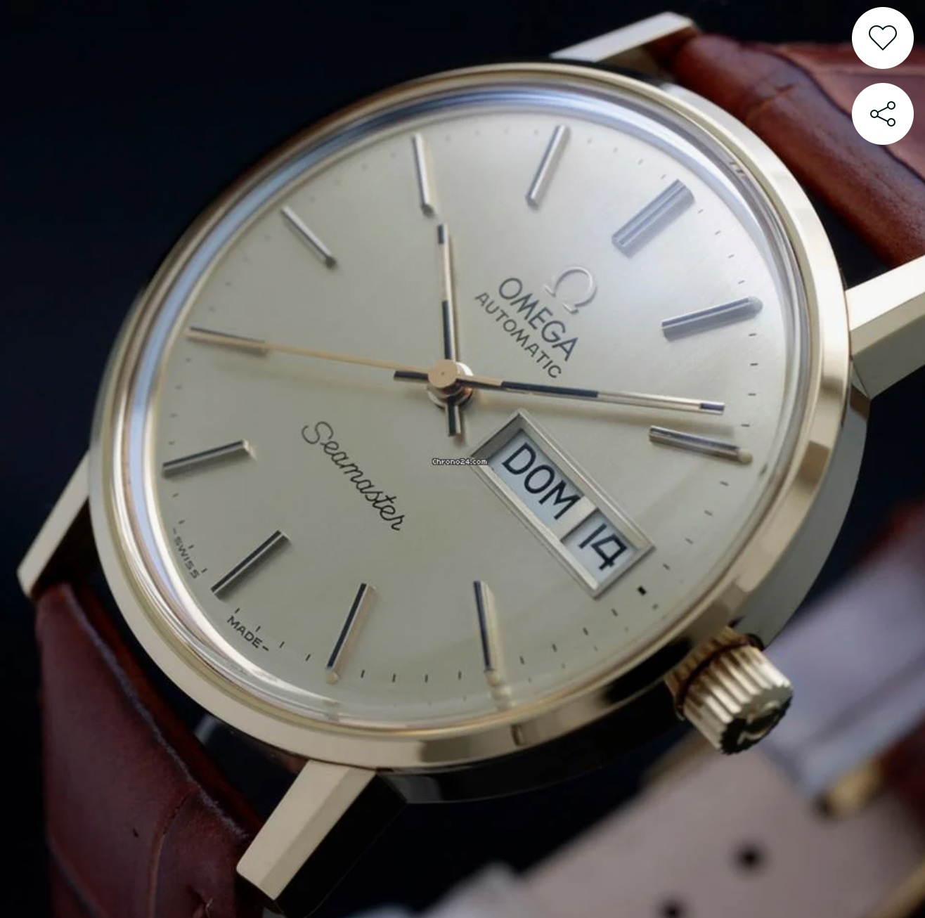

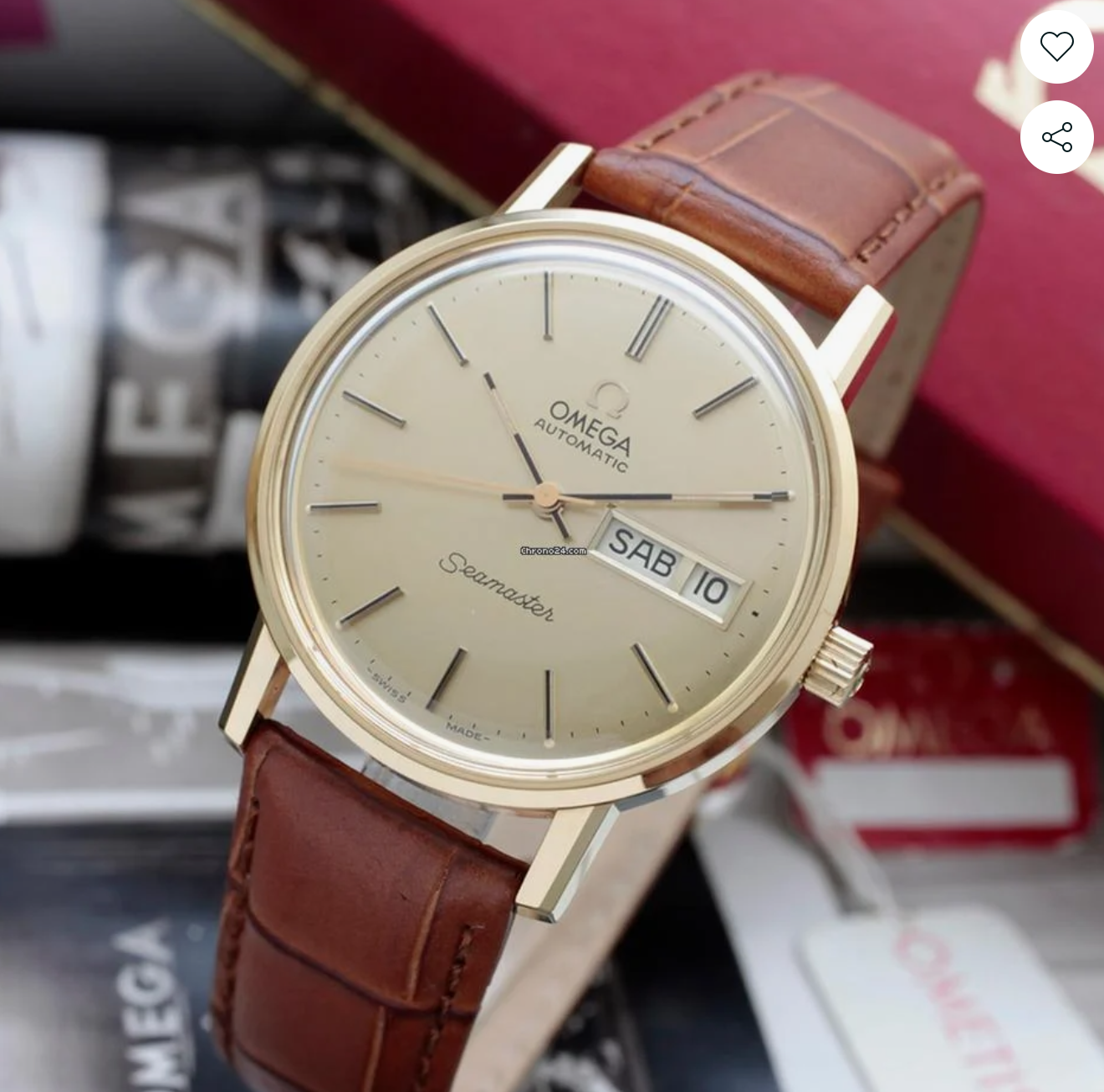

As someone who knows nothing about watches, I’m on a mission to find a special watch for my Omega enthusiast boyfriend. I'd ask him, but I want it to be a surprise for our wedding in a few years.
I’m looking at vintage models similar to the Seamaster DeVille, Seamaster 600, or Seamaster 30, but I could really use some guidance. He loves pieces with a clean, simple look, and having a unique feature (like neat history or French/Spanish writing) would make it extra special. Budget is 2-3.5k CAD.
What should I watch out for (pun intended) when choosing the right piece (so I don't get ripped off online)? I'm even starting to think I should just keep an eye on the pinned "Recommended Vintage OMEGA WATCHES" thread for the next few years and buy from there!

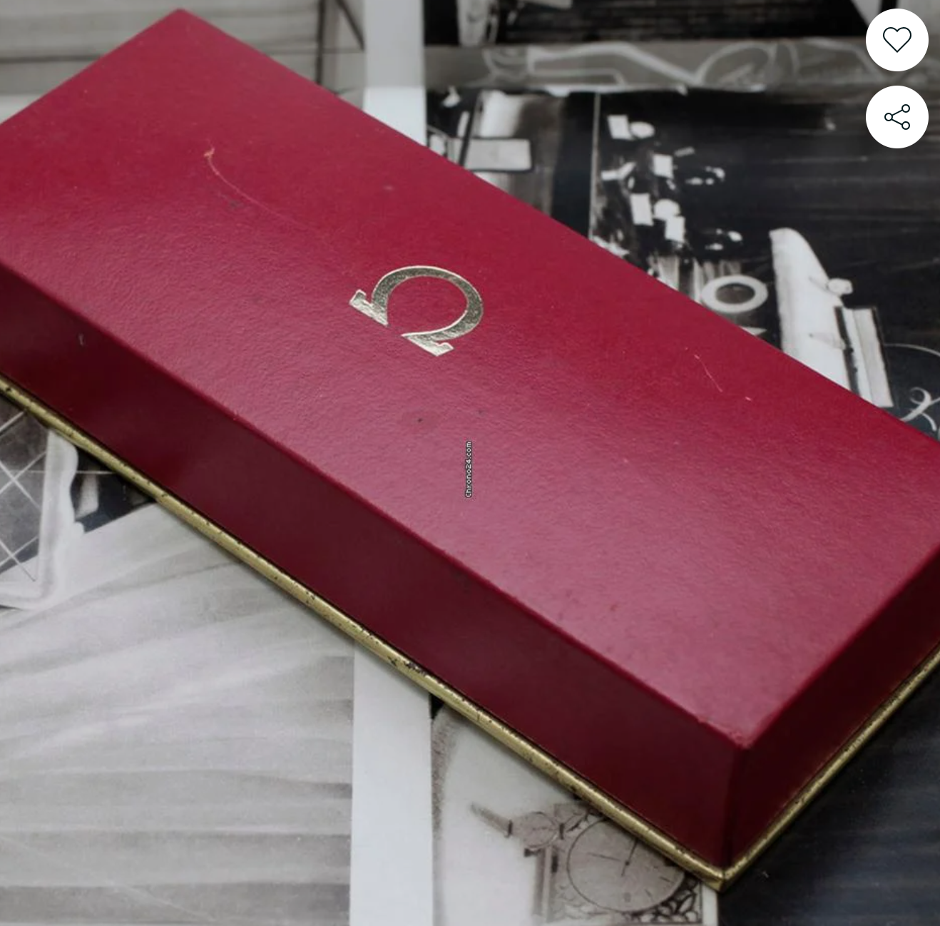

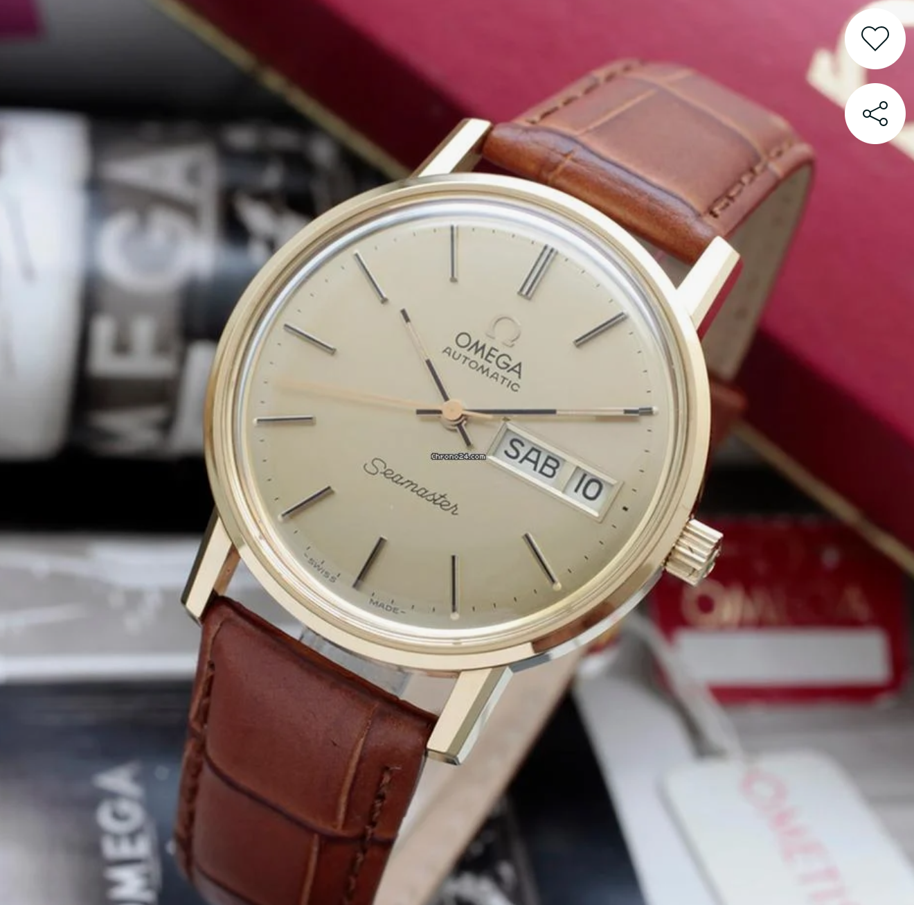

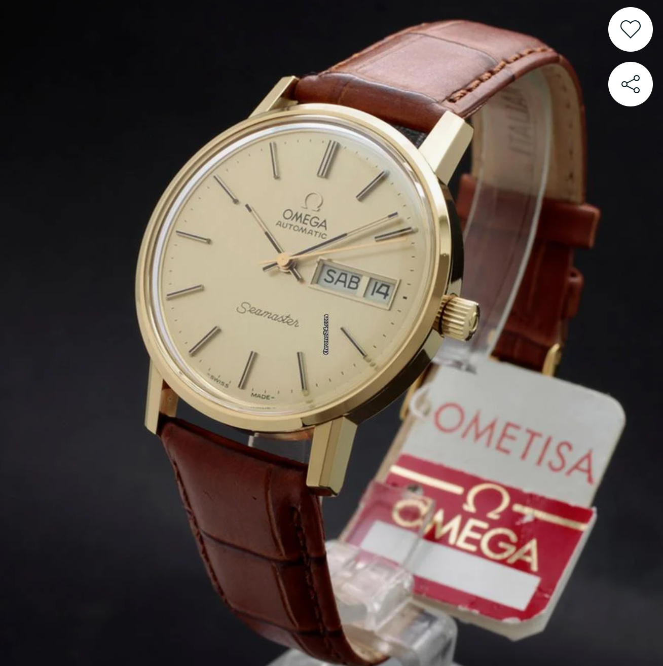

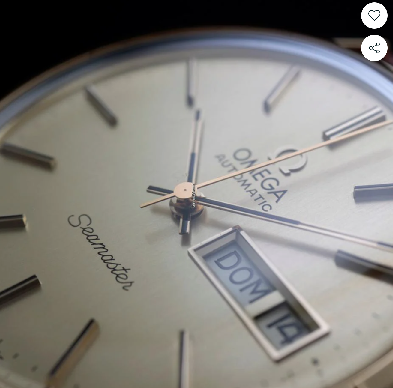

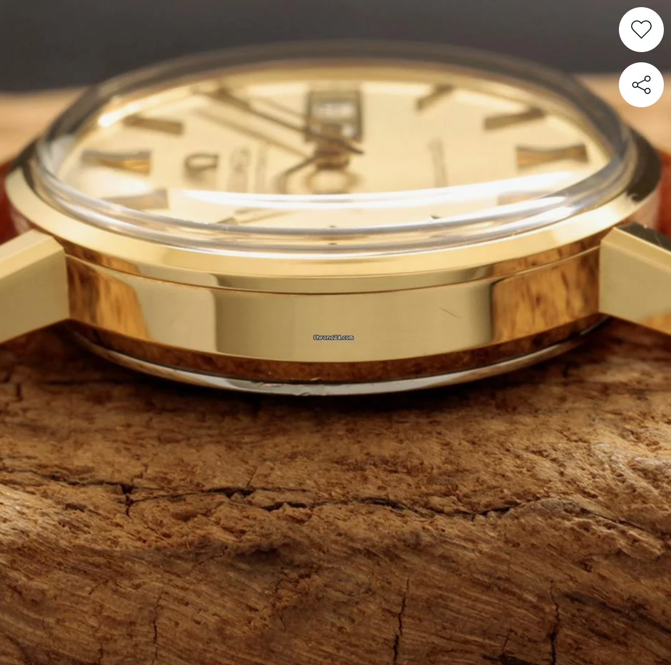

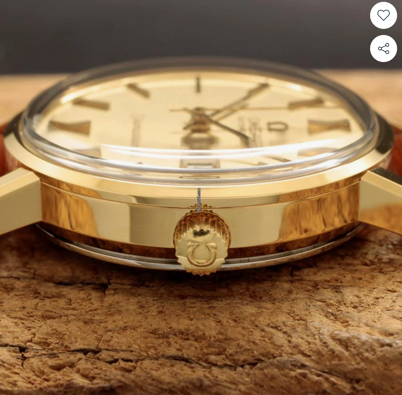

For example, I found this one today: https://www.chrono24.ca/omega/omega-seamaster-time-capsule-new-old-stock-vintage-last-one-untouched-since-manufacturing-nos--id34830296.htm

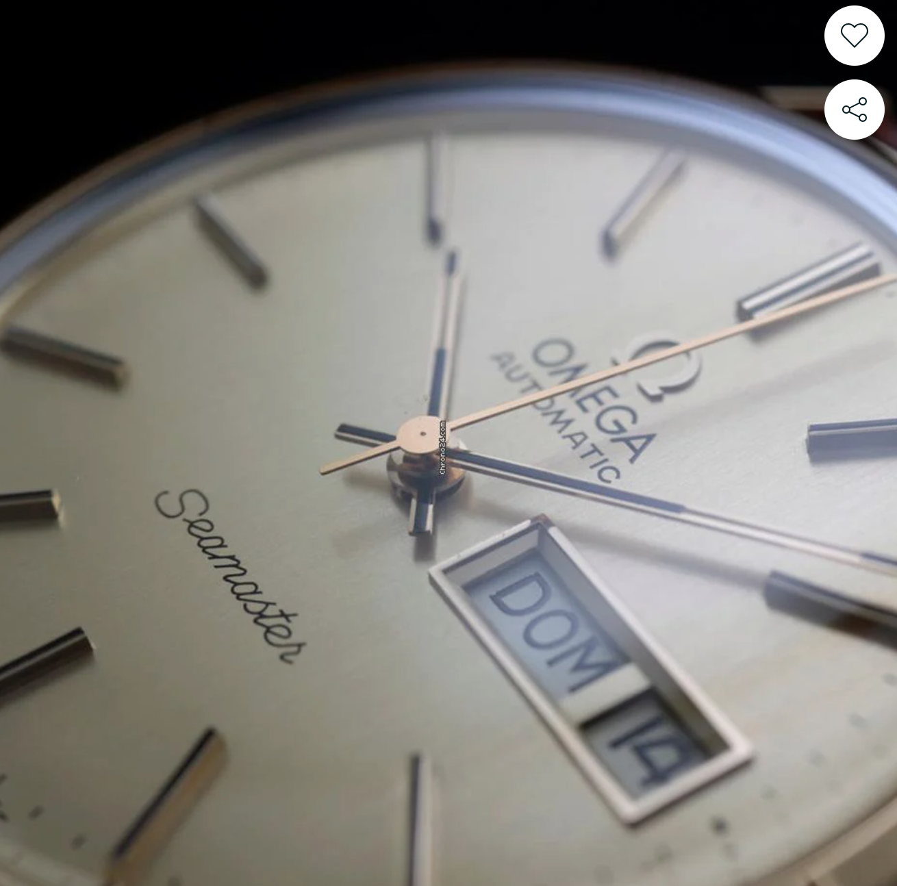

It seems like a nice option with a sleek look, clean lines, and a thinner case (which is important for him). Plus, it’s a collector's piece with NOS condition and original box—definitely fits his style! He also speaks Spanish, so the dates being in Spanish would be a fun touch. What do you all think?
Thanks so much in advance for any advice you can share! 😀

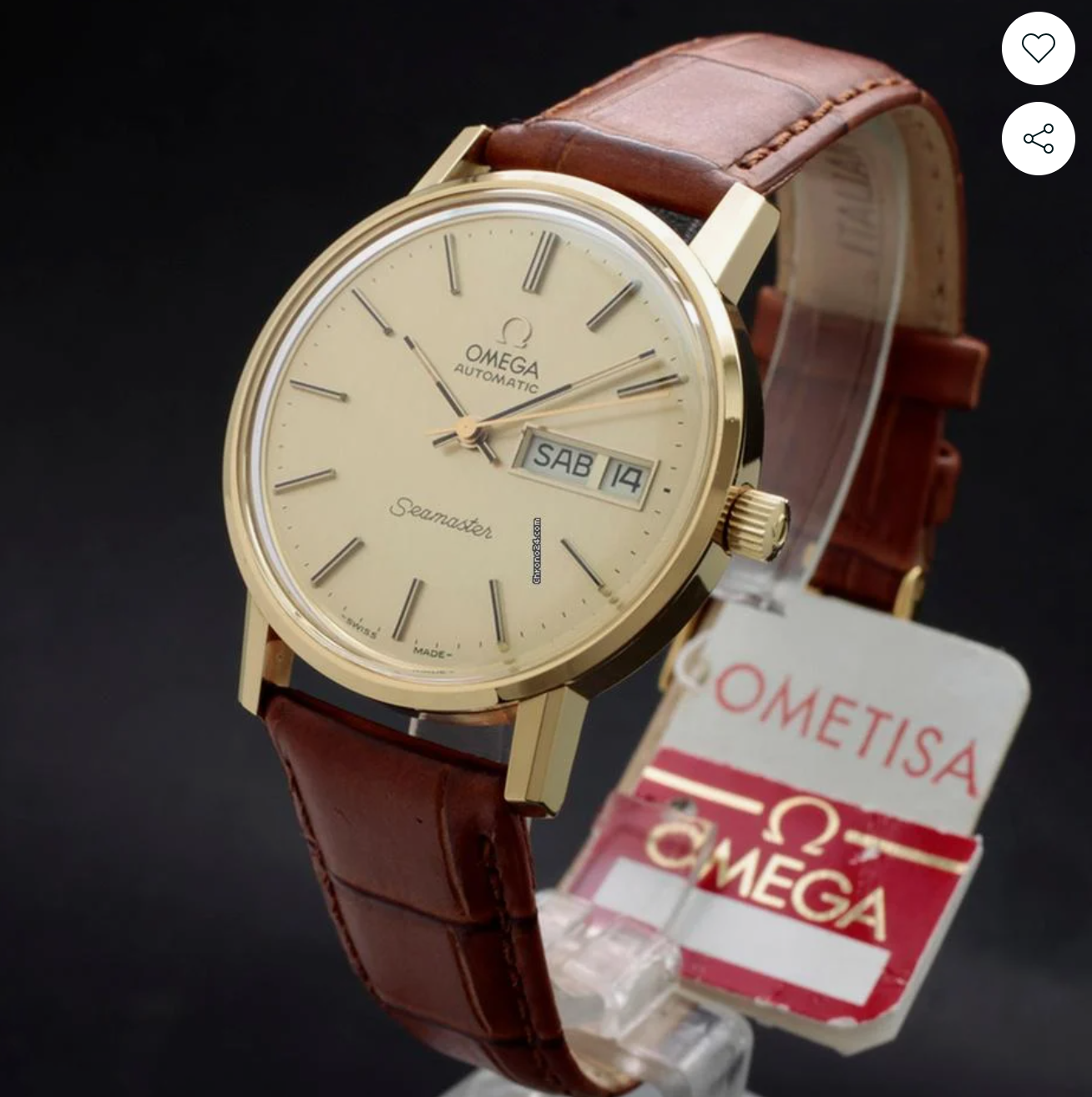

The thing about a NOS watch is that 1) it is rarely true, and 2) once you wear it, it’s no longer NOS and there goes the premium you paid.
632
2,137

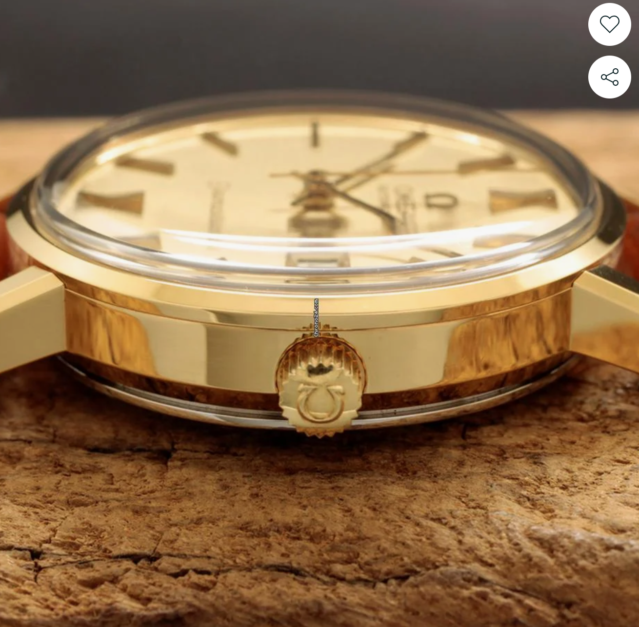

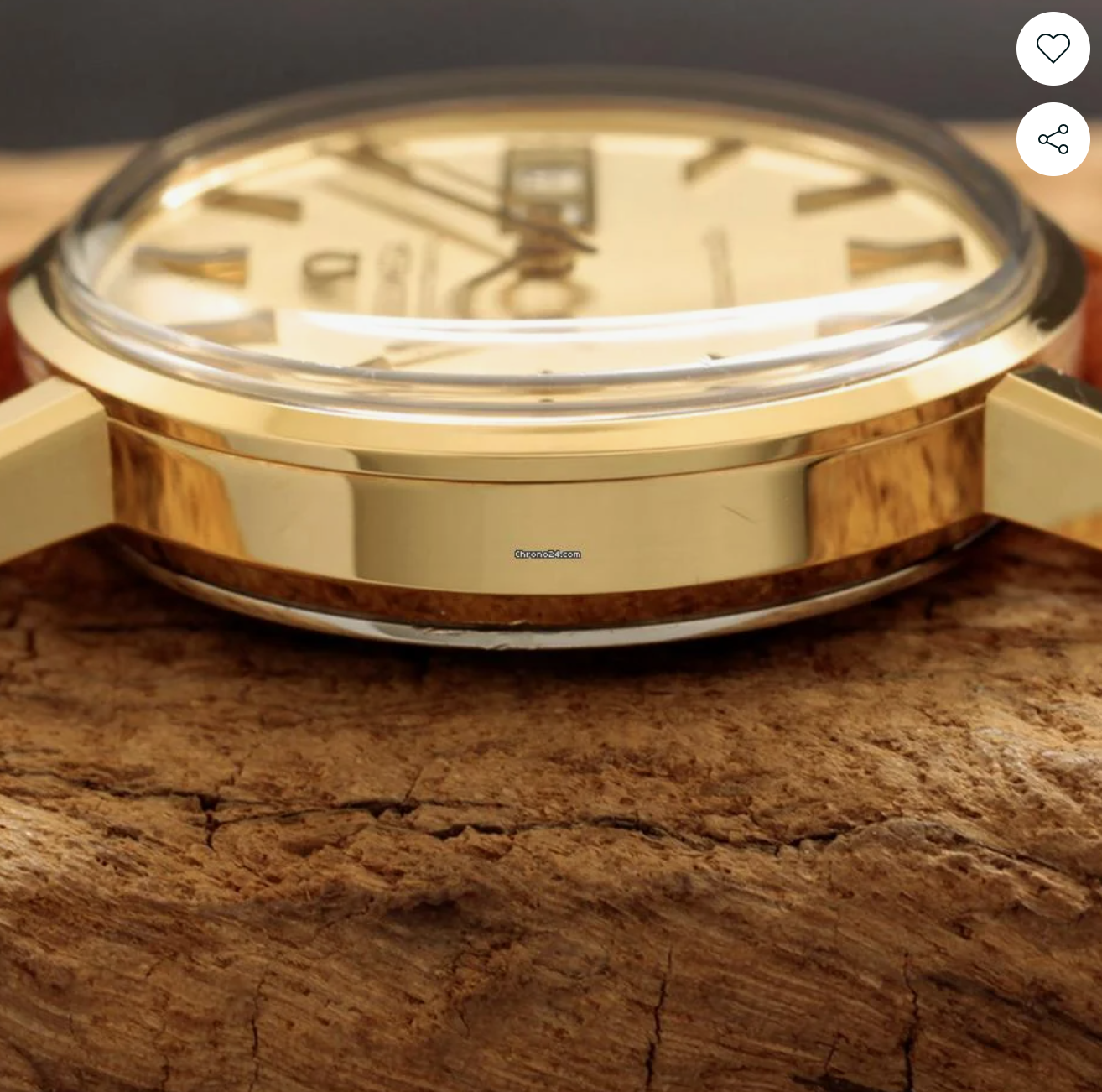

While the watch you posted is lovely it is very expensive for a 20 micron gold plated watch or any gold plated watch for that matter.
While I agree that it is not cheap, if it really is unused (I tend to doubt this, because a new braclett has been fitted instead of retaining the original one), literally NOS, then I would not consider the price excessive. Compare with the prices new modern ones.
@DaveK That (2) is true for most new bought items. Except perhaps for a Rolex bought decades ago and used with some care.

A couple pieces of advice. First, avoid gold plated watches. Typically, the plating is very thin, usually 20 microns, and that eventually results in the plating wearing through and exposing the base metal -- usually brass -- beneath the plating. You're left with an ugly watch and the only recourse is to have it replated which gets expensive when you have to do it repeatedly. Gold capped watches, on the other hand, are fine. They are made by bonding a much thicker layer of gold to a stainless steel case. They are durable, long lasting, and can be quite attractive. Here's an example of a gold capped Seamaster that I used to own:
Second, you did well by coming here and asking the community to assess a watch for you before you pulled the trigger on the purchase. Continue to do that and you won't go wrong. Third, continue to educate yourself by reading everything that you can about the models that interest you. You'll learn how to properly assess a vintage watch, what a fair price is, and how to distinguish an authentic example in good condition from one with a refinished dial or an overly polished case. Last, you may find that the best place to purchase a vintage Omega is right here on the private watch sales forum. This is a community of Omega enthusiasts and collectors and good watches at fair prices come up for sale frequently. Good luck with your search and what a thoughtful gift for your soon to be husband. He's a lucky man.
