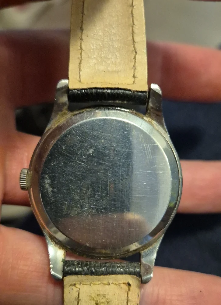

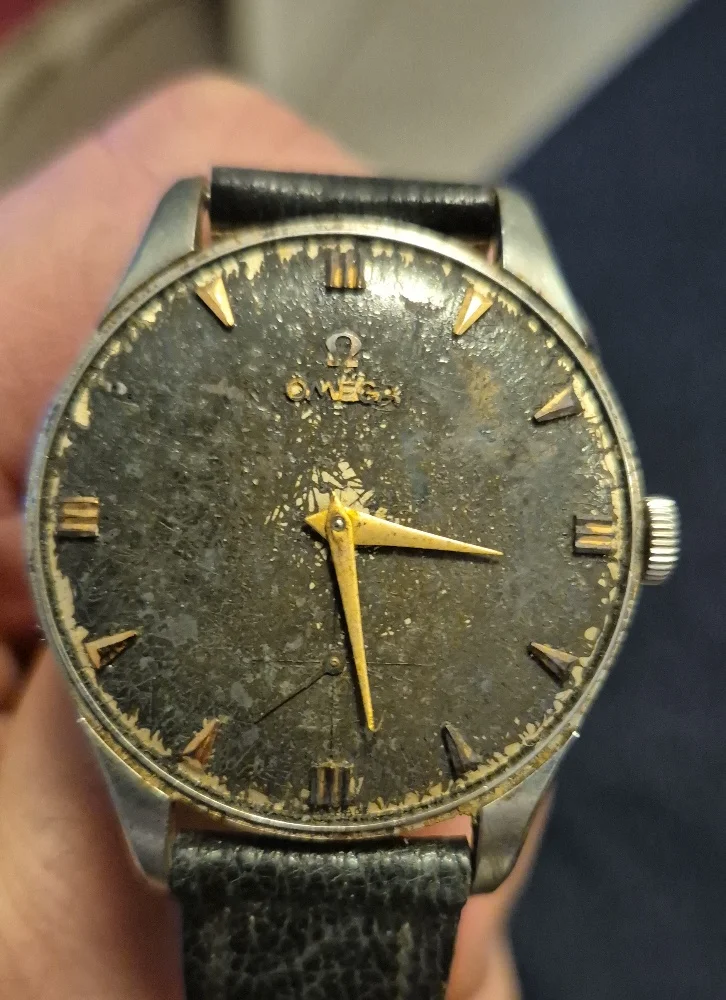

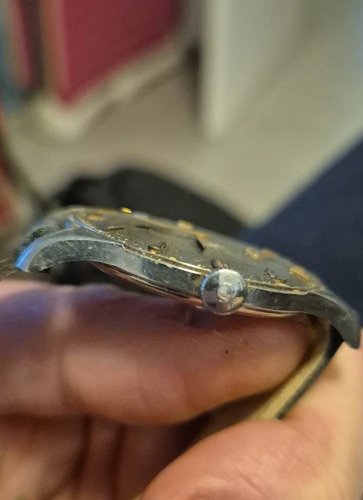

I recently found this Omega in my grandfather's house and I’m looking for some help with its identification.
It measures larger than typical watches from that era, so I suspect it might be a 'Jumbo' configuration (possibly a ref. 2505 or similar).
The dial is beyond 'patina' and is actually flaking/heavily damaged. I am considering a high-quality redial to make it wearable again.
Any information on the reference or movement would be greatly appreciated!
Thank you and best regards

You are also missing the bezel, one applied dial marker, and the hands are wrong. Is it running? Can you remove the back and show photos of the inside? Buying a parts watch would be a good option for you.

Yes, you'll need a donor watch for the parts. The case reference, inside the back, would be a big help. And I'm definitely curious as to how the movement looks, as I expect moisture intrusion.

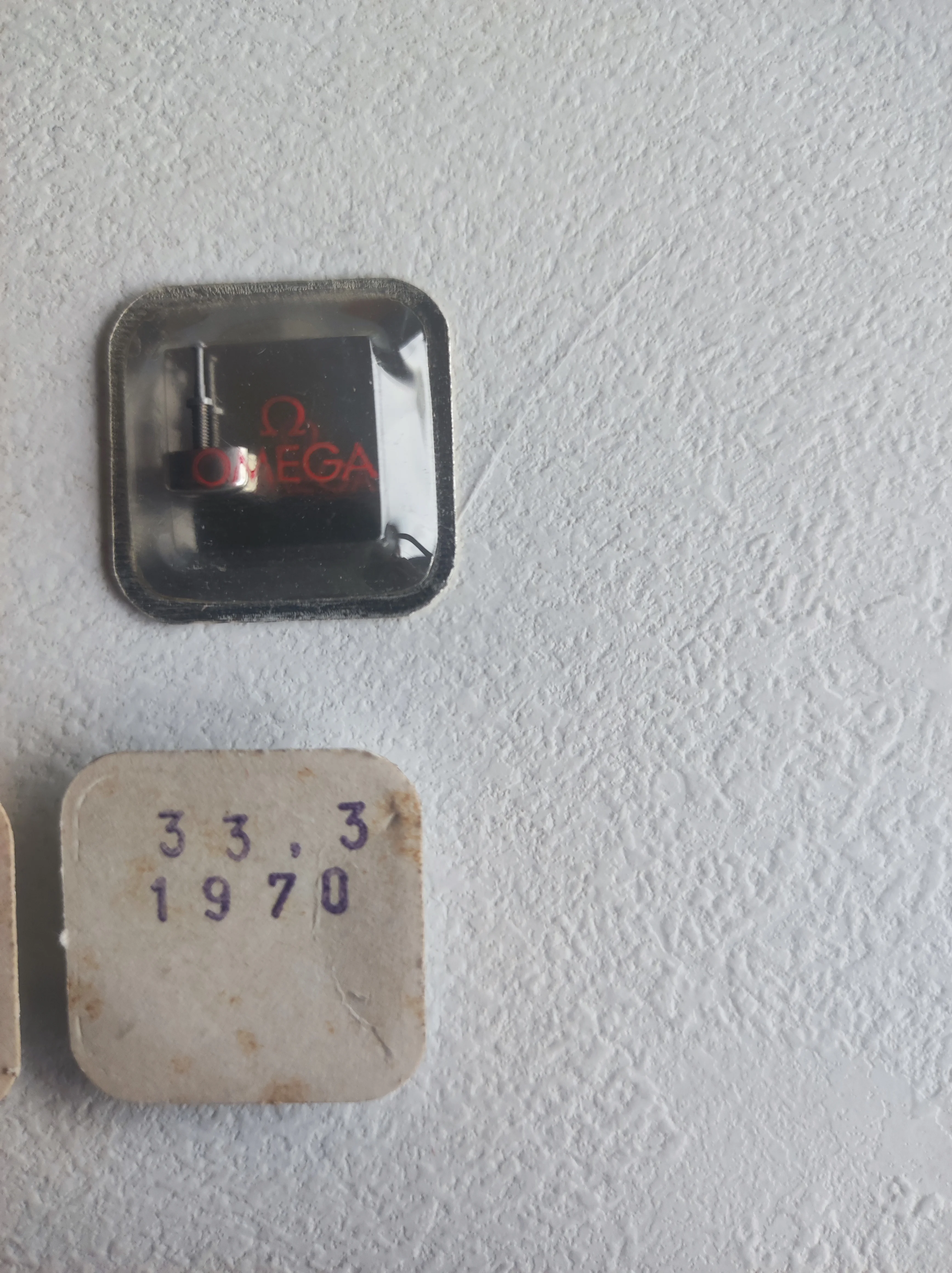

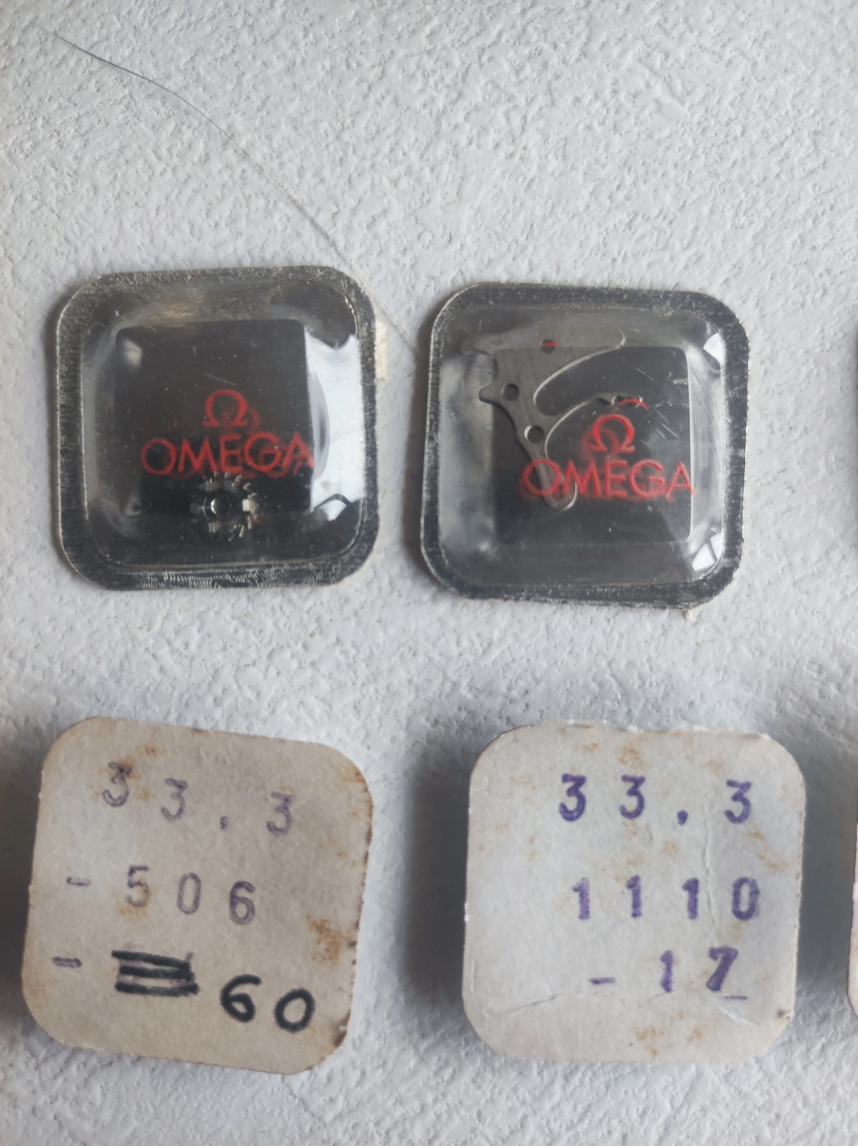

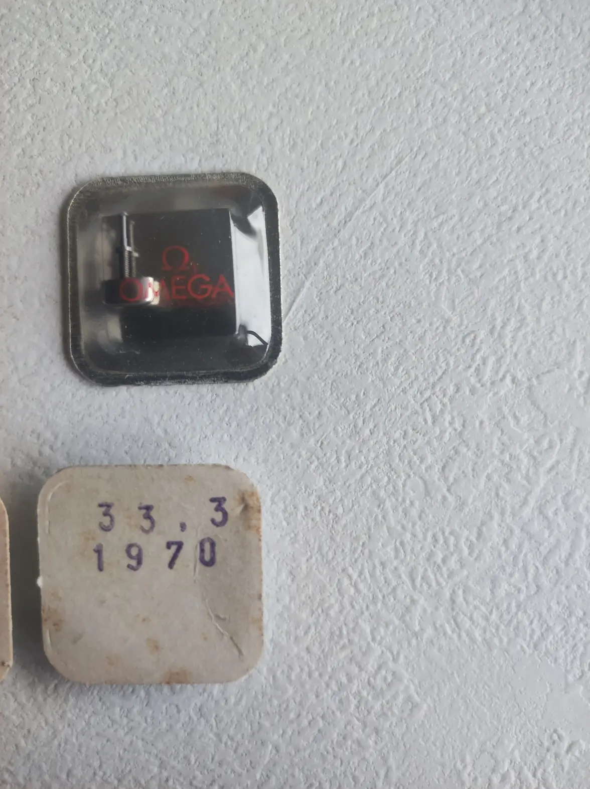

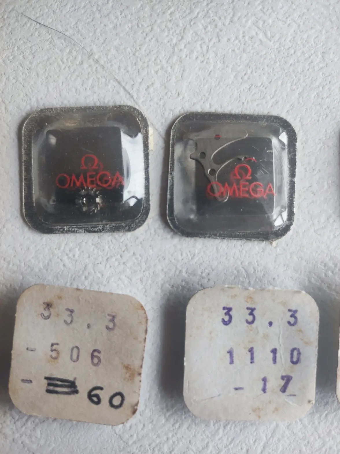

Buenas tardes. No sé en qué hilo poder publicar una serie de fornituras NOS que tengo del calibre 33.3. Subo un par de fotos. Pedir disculpas sino es el sitio y agradecer si alguien puede ayudarme para dirigirme al sitio concreto. Gracias de ante

As Dan said, but trying to find an exact reference. 2- using a bezel from another watch. Even if same reference could be iffy. Precision back then is different than today
