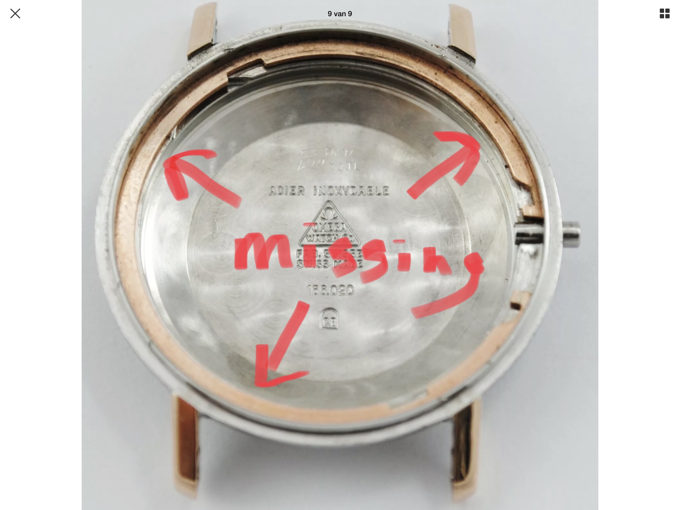

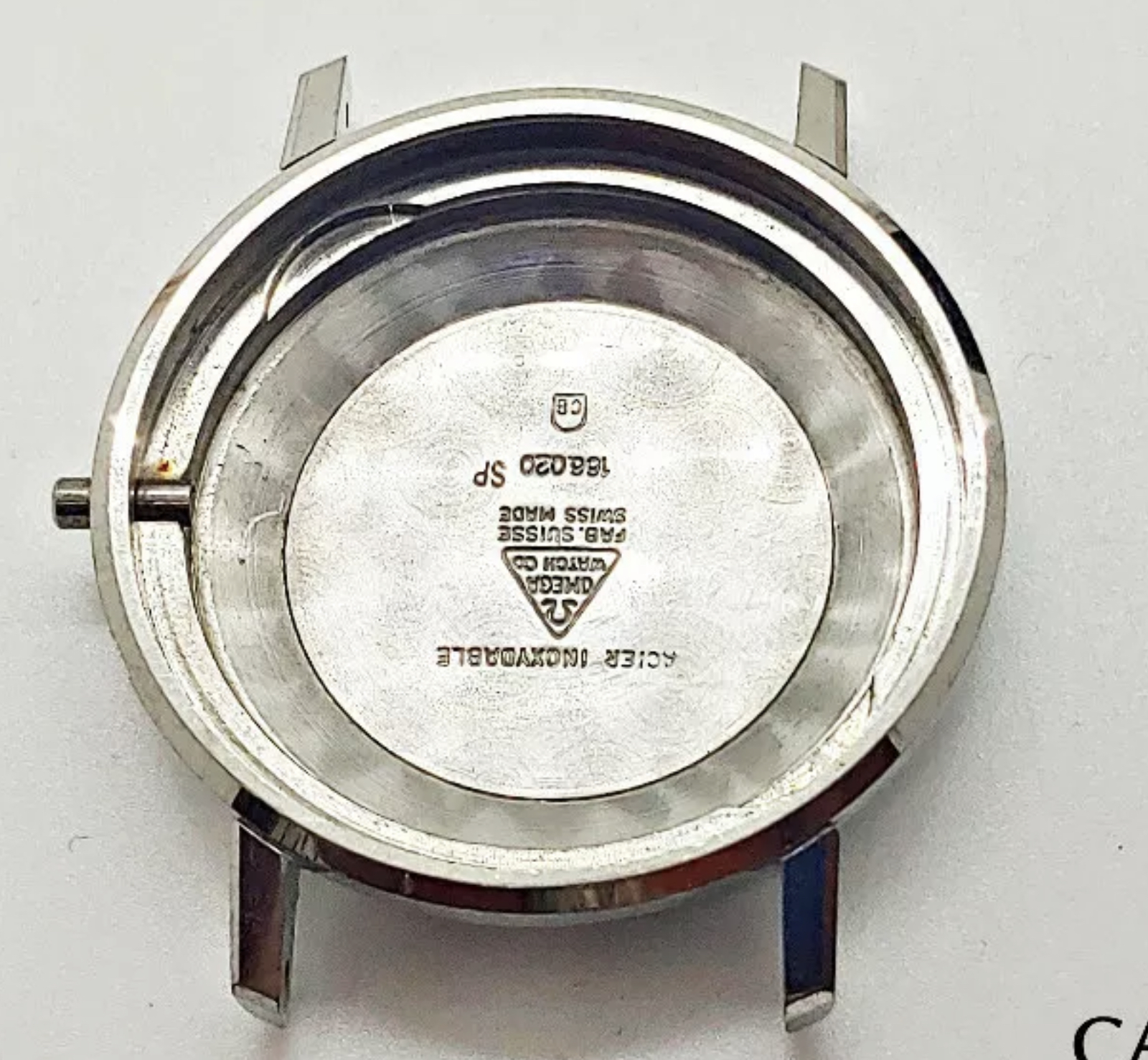

I however see I need something else. There is this ring in the front loader. Can anybody tell me what the name of this ring is. It is my first front loader and I understand that the movement “clicks” in this ring?
since this is the one I bought:
