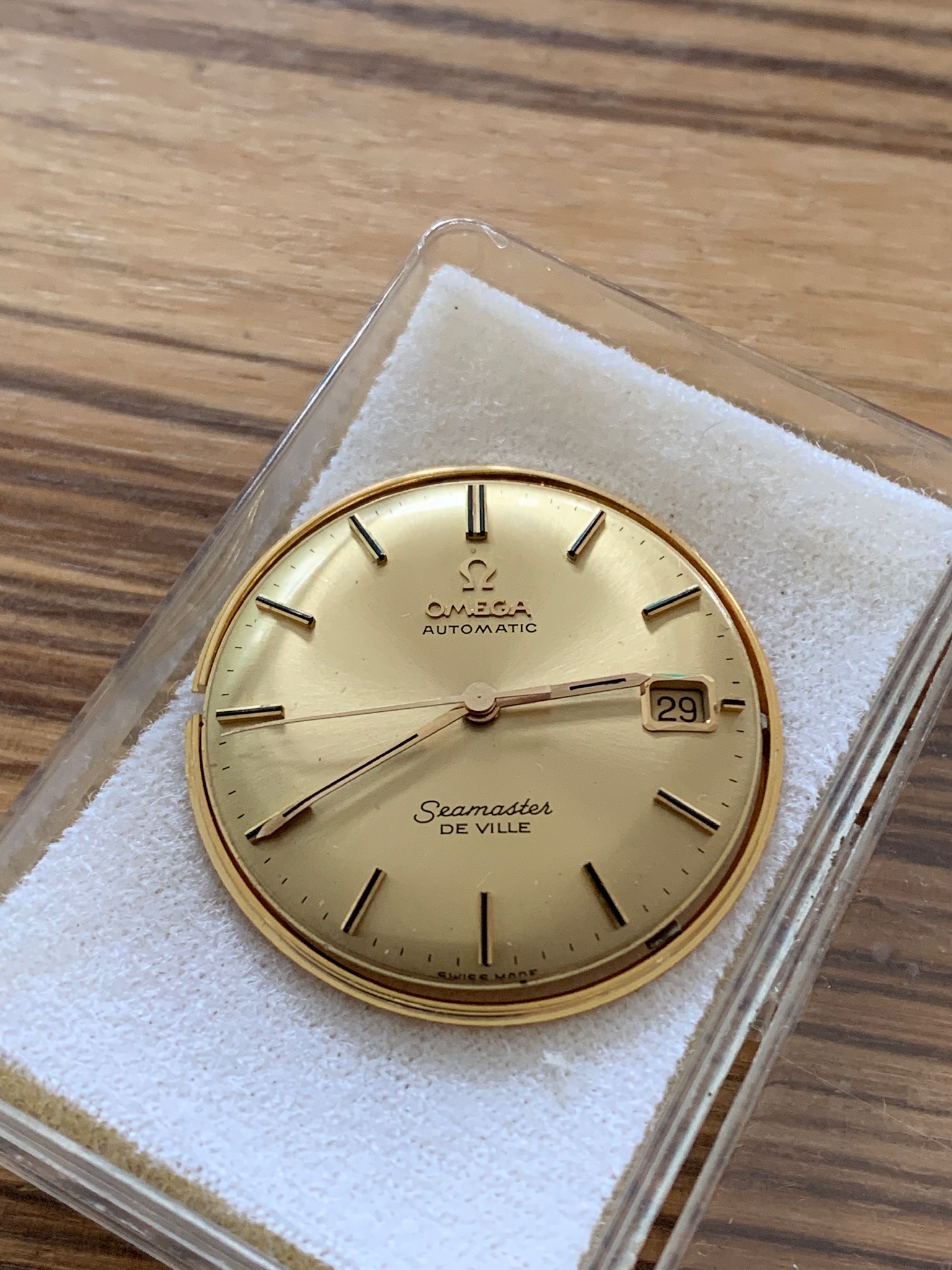

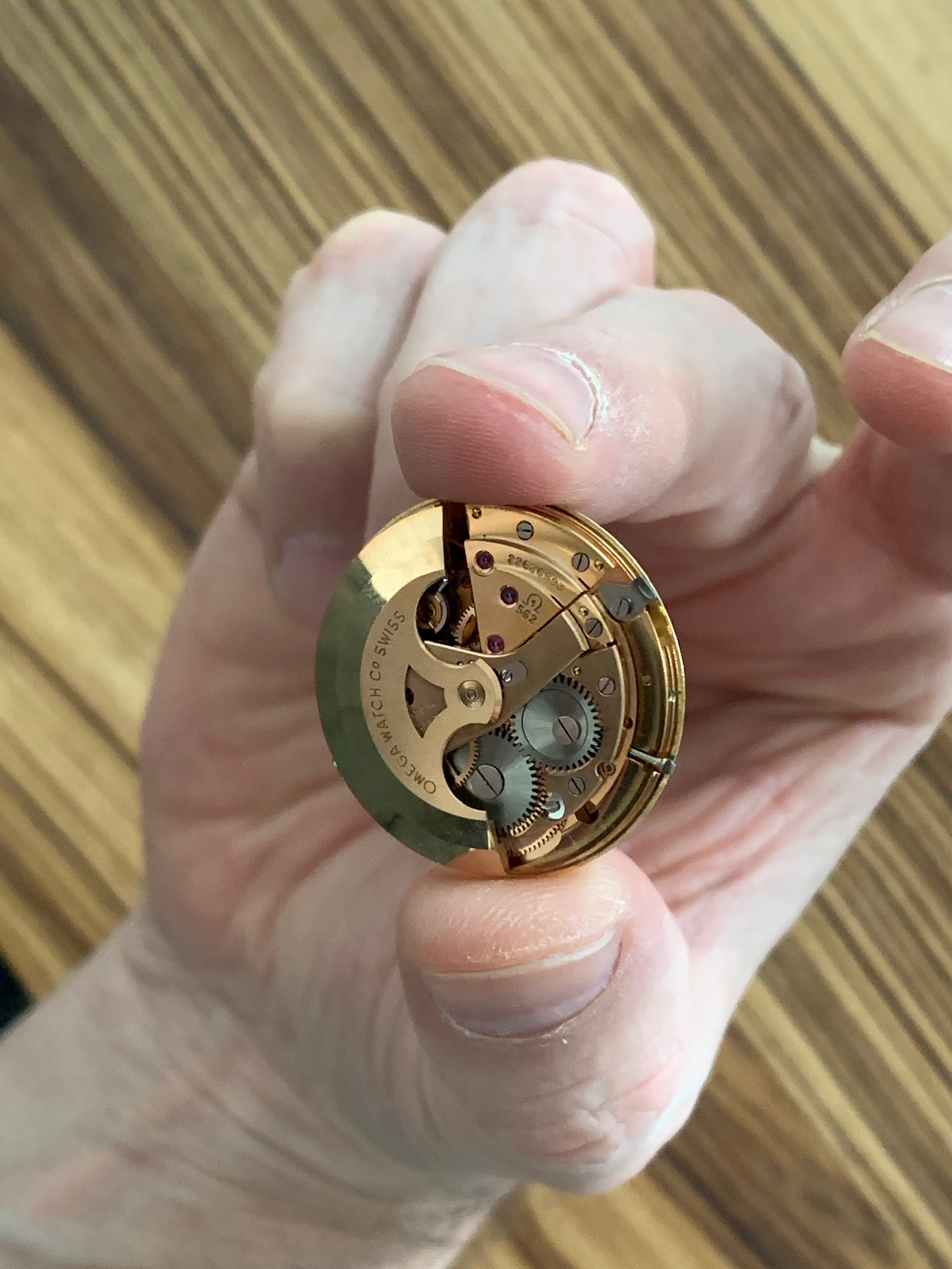

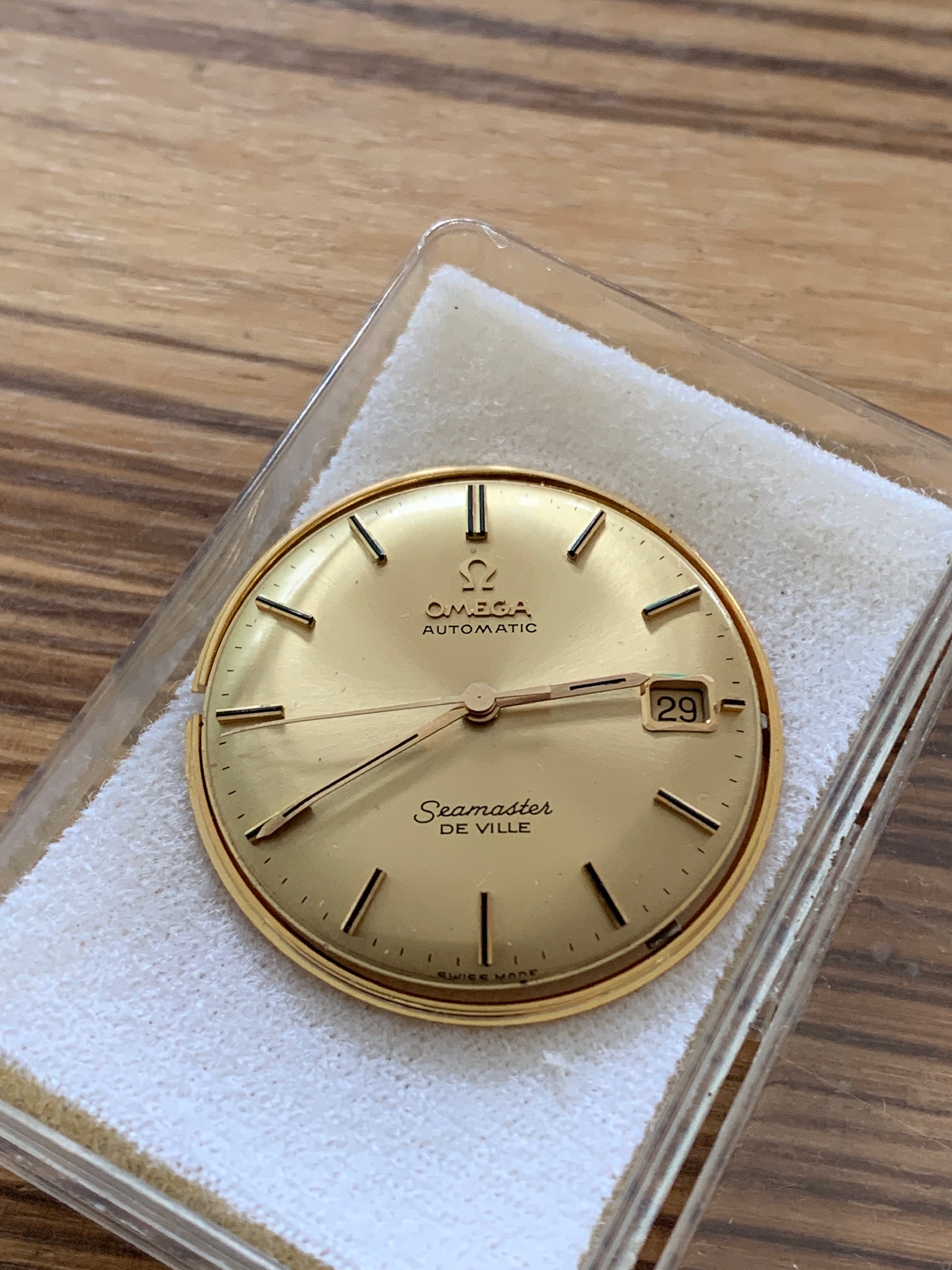

Hi there. I just acquired this 1965 Seamaster dial, crown and 562 caliber only. Now I need to source an appropriate case and crystal.
It is pretty easy to find matching cal. numbers with a case number. Anybody any idea how I can do it the other way around? Hence, what cases have originally been used for this watch?
Thanks!!!!

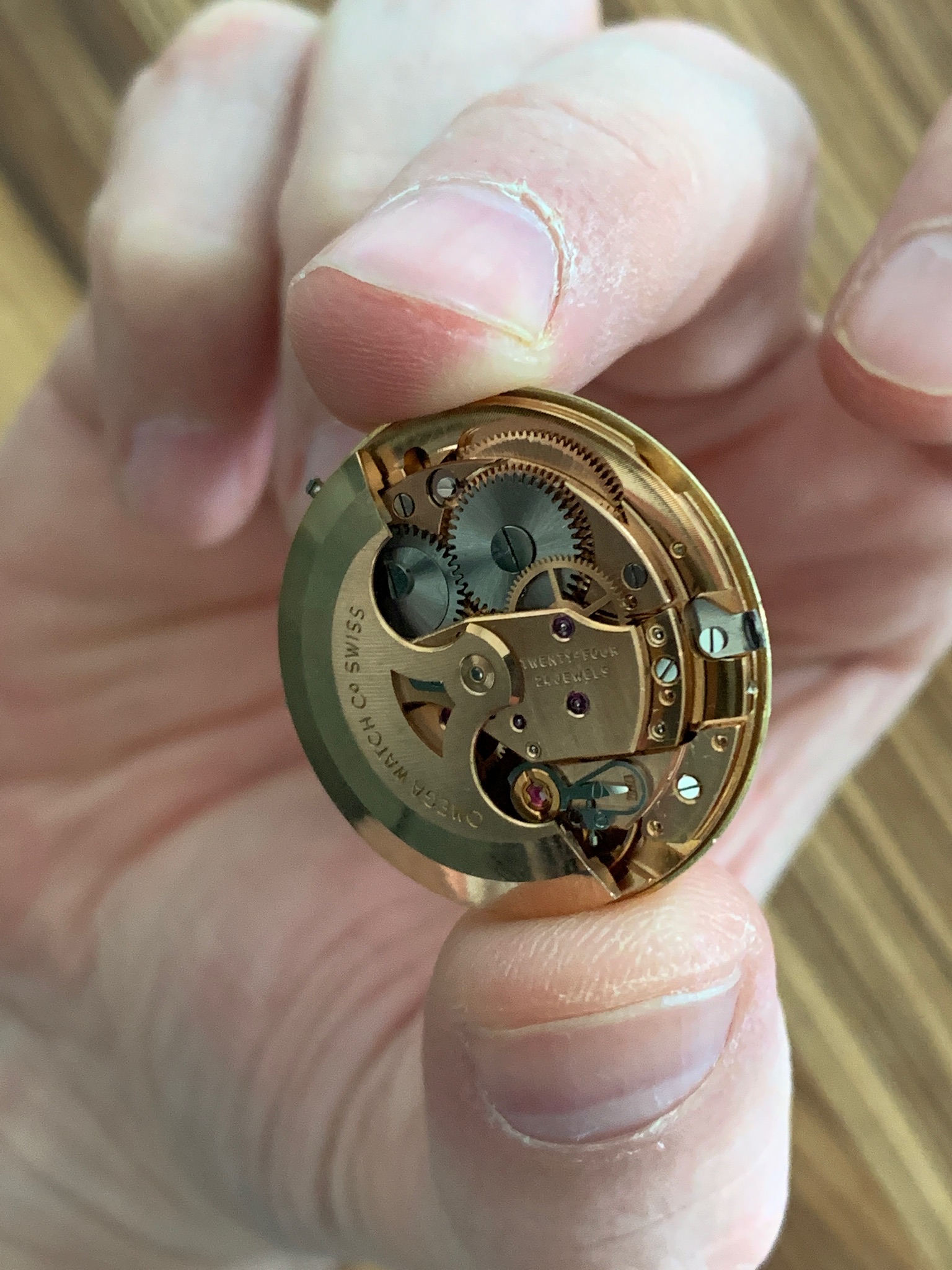

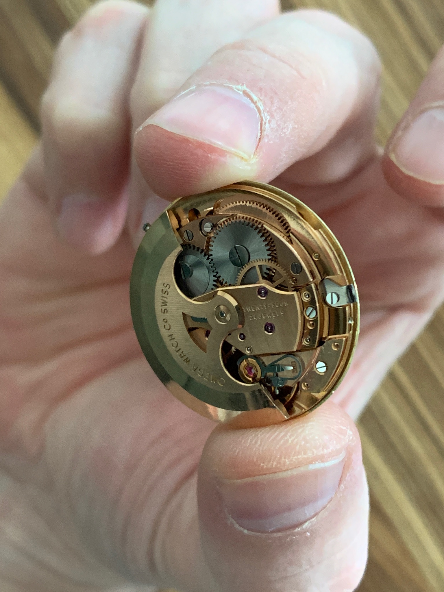

With the split stem and those case clamps, I'd suspect a 166.020 front loader. You can't say for sure without trying it or getting some dimensions so, it will not be easy to buy a case with certainty.
And @aps26469 don't handle the movement with bare fingers - you'll not do it any good.

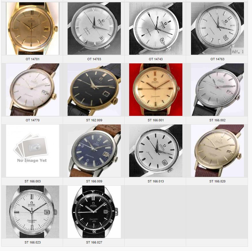

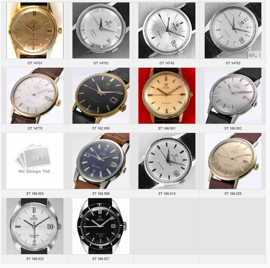

Up to now I have the list below compiled but no idea how correct this is
14701
14910
14743
14763
14730
14760
166.0001
166.0009
166.0013

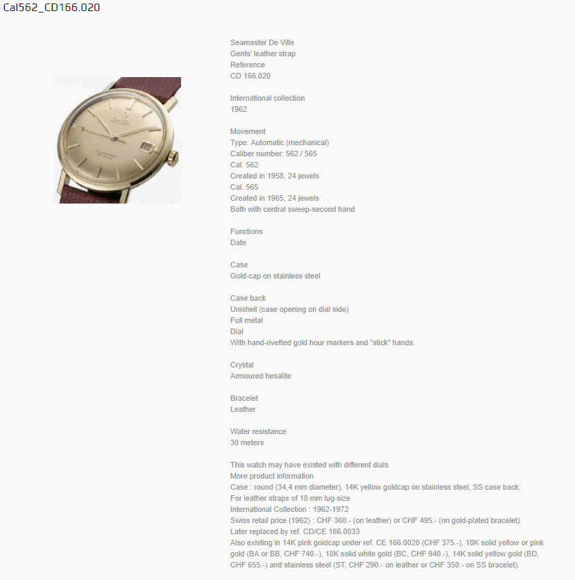

If I search on 166.020 I end up with a mid 70’s watch. This cal has a 1965 serial number.
edit: ignore, wrong observation
107
154

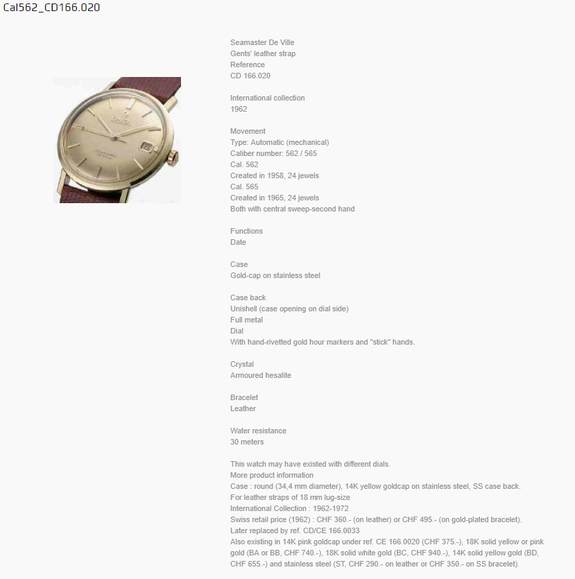

I vote for ref. 166.020

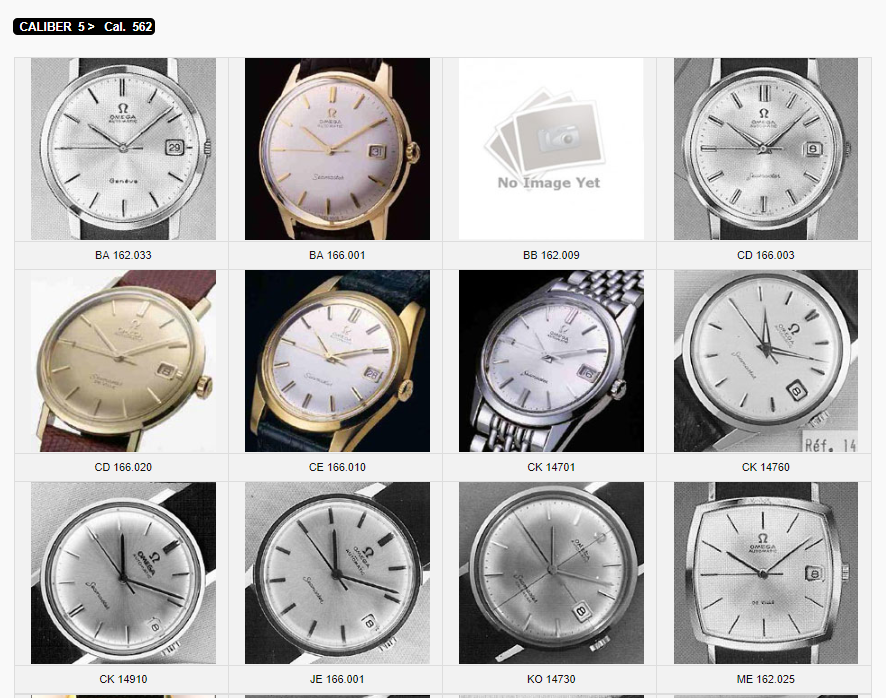

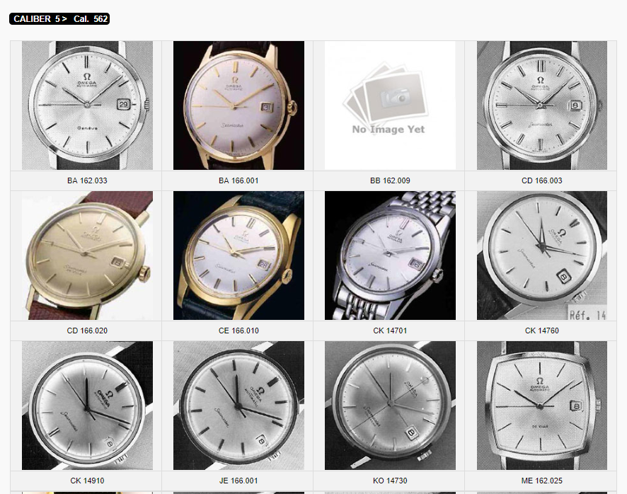

Here 562 caliber references.
Where do you find such ressources ? The vintage omega website isn't this in-depth

Great. It seems indeed that the 166.020 is the correct one. Cannot find this however.
I found one 166.002 which also seems like a fit. And the. Have it gold plated. Not 100% original but still not period wrong.
opinions?

You could always pick up the 166.022 so you could wear it for a while and save an ebay search for the 166.020. I'm sure one would pop up eventually.
Guessing you'll need the other half of the stem and a crown too?
That dial is in really nice condition. Congrats!

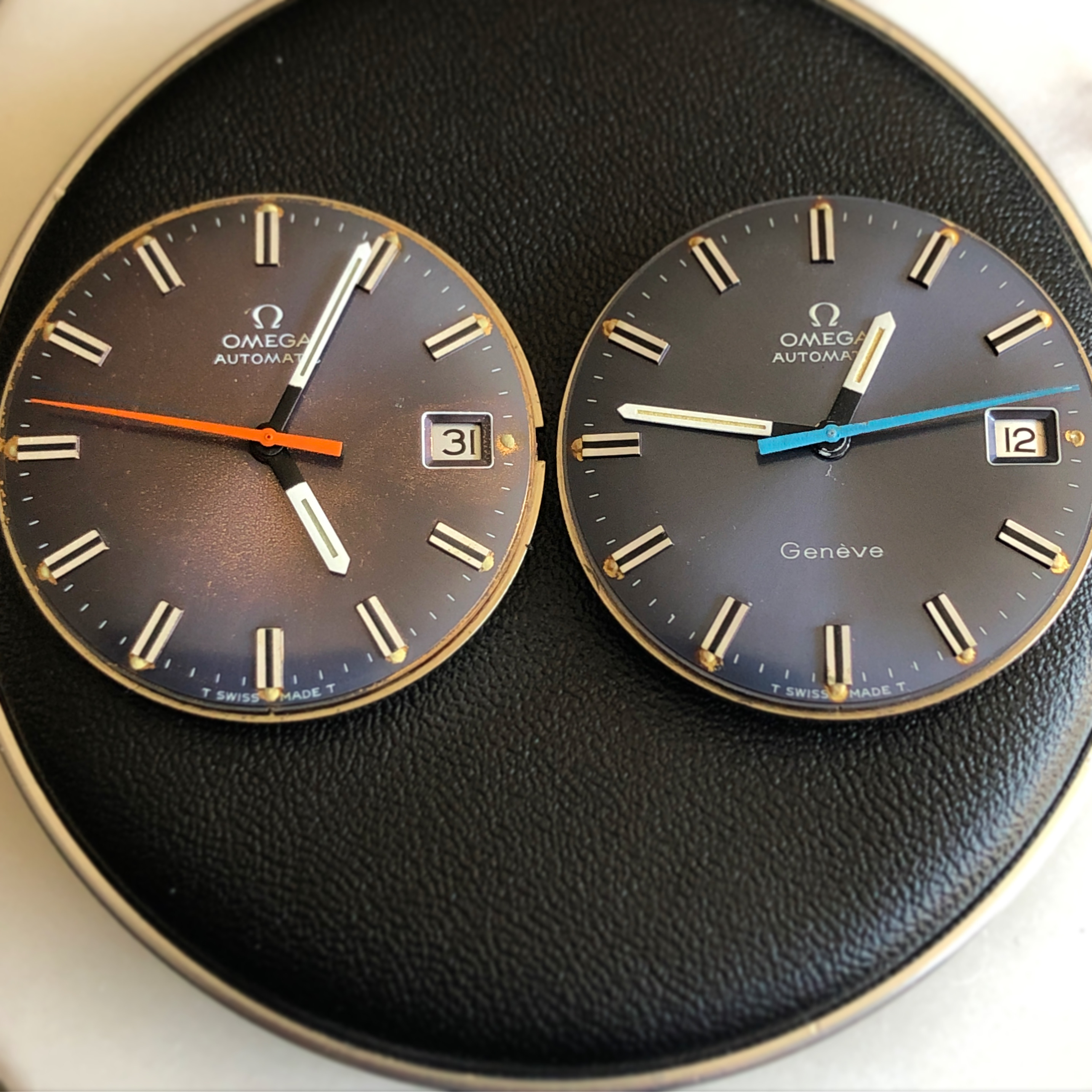

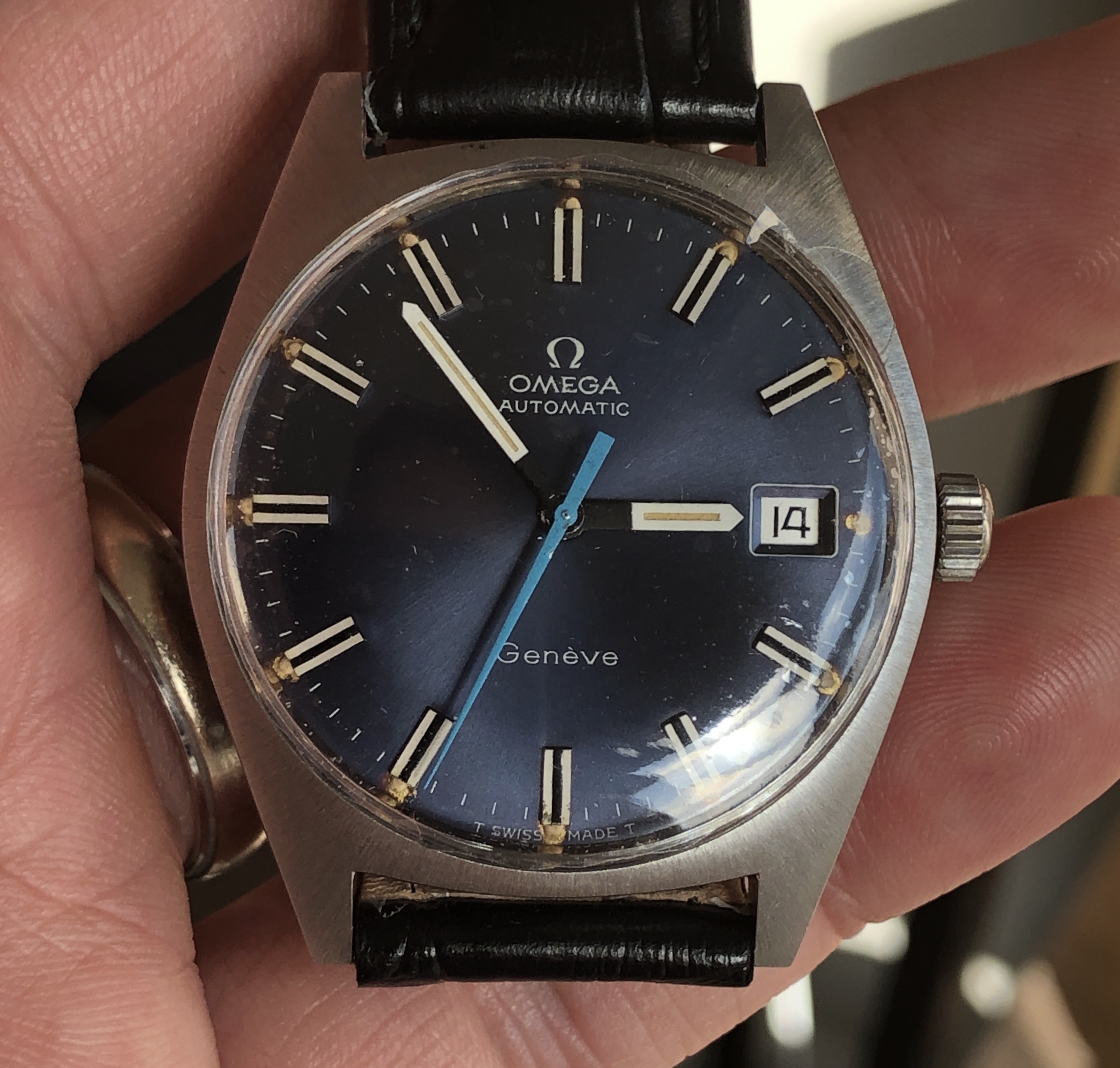

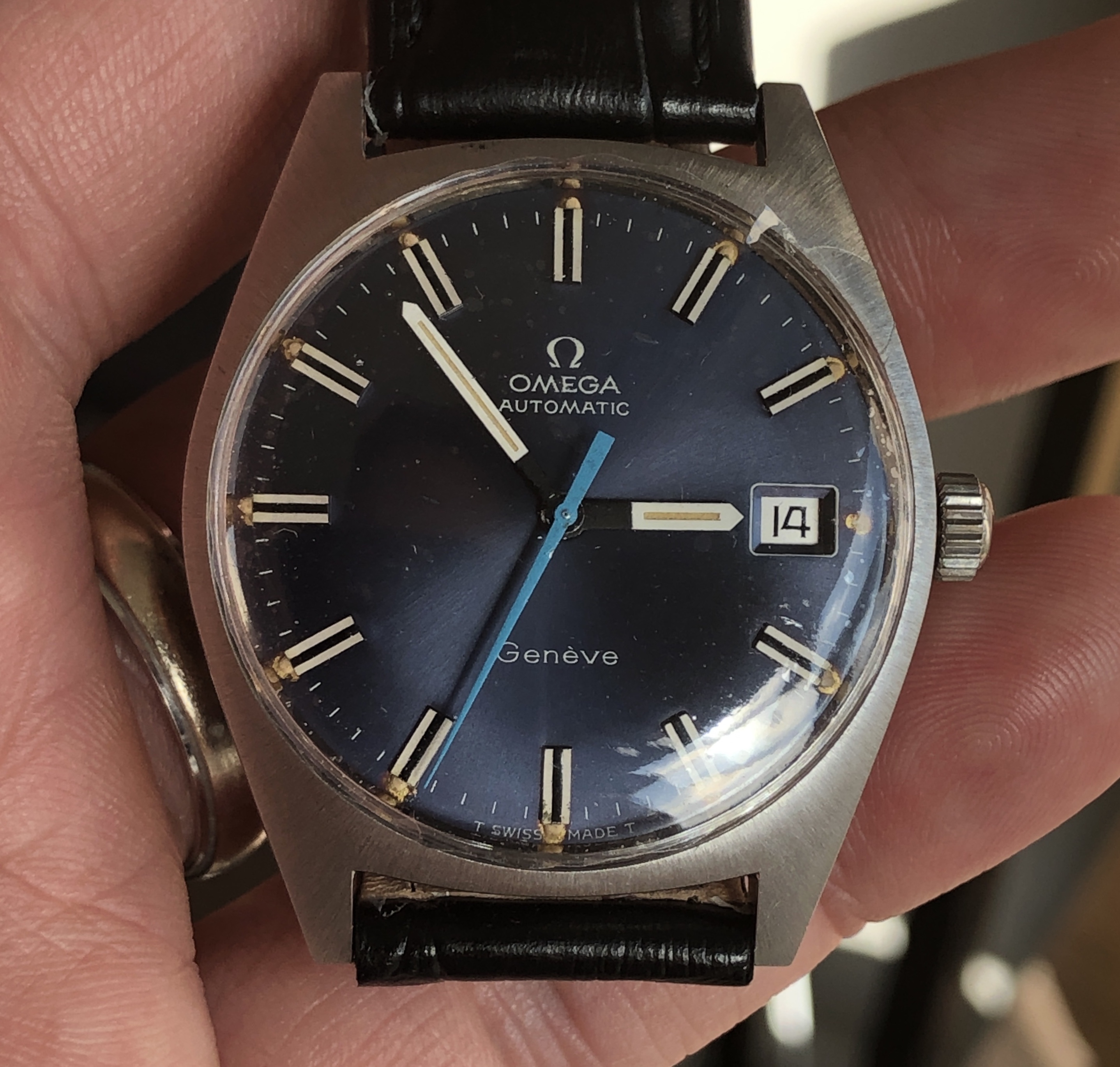

Here is a 166.041 I just finished putting together and am planning to take in for a service next week:
383
349
Nice. I love projects like this.
Nice, is this now blue or black?
1,050
2,618

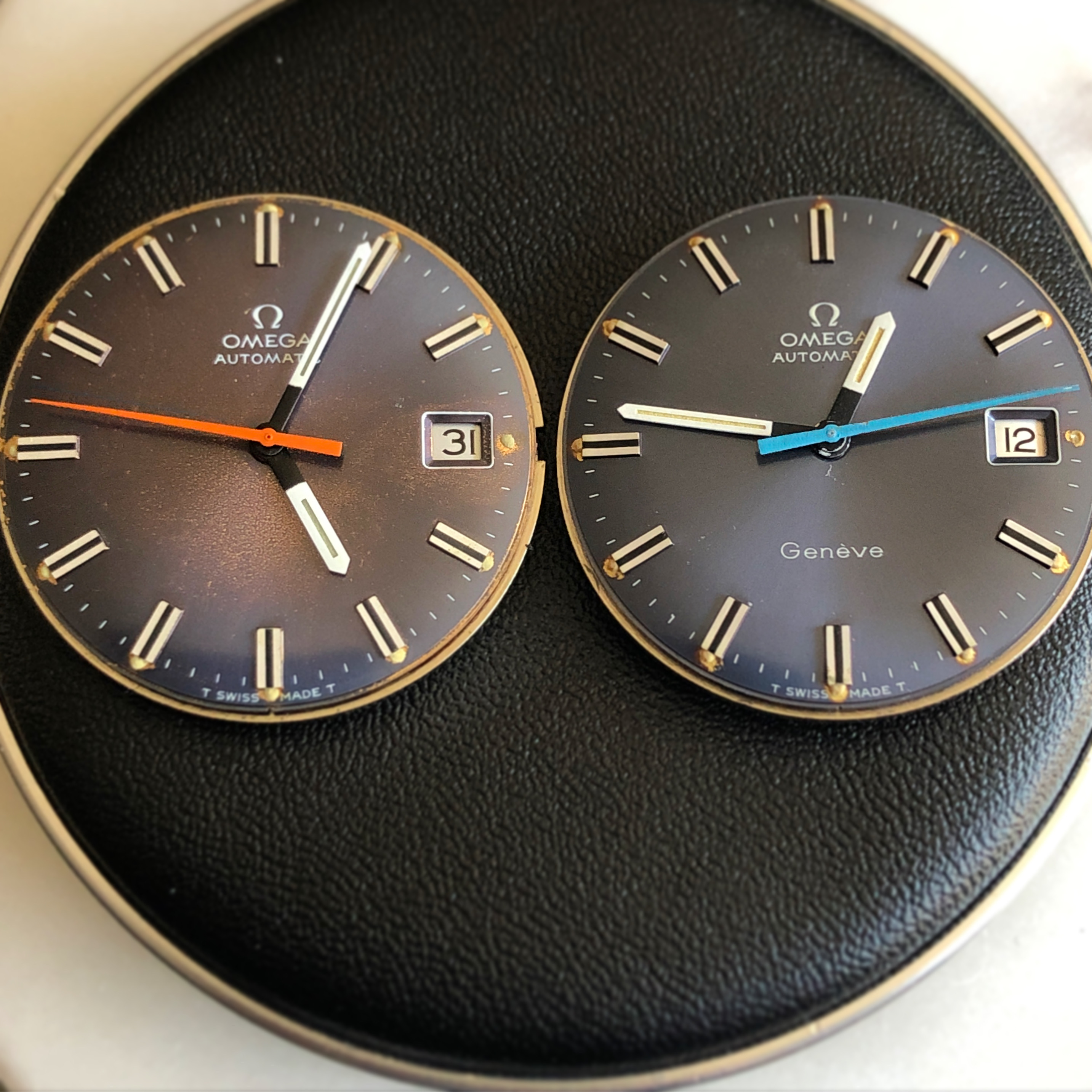

It's blue, still has the film on the crystal which might be dulling it a bit. Looks great when the sun hits it. Here's another pic next to a more aged / patinated dial. I believe the orange second hand is correct for this reference / dial combo, but I really like the blue on blue.

You have a 2 piece stem (one part in the movement and one in the crown) because this movement came from a front loading case. Also the case clamps are for a front loading case.
For a case such as a 166.002, you would expect a one piece stem and different case clamps. You can find out which parts go with each case.
You are also assuming that the dial is the same diameter for both cases and I wouldn't guarantee that.
All I'm trying to say is that you may not find it easy to fit a 166.020 dial/movement to a 166.002 case and may end up spending additional to do that. Better to get the correct case and save any possible hassle.
Good luck, Chris
