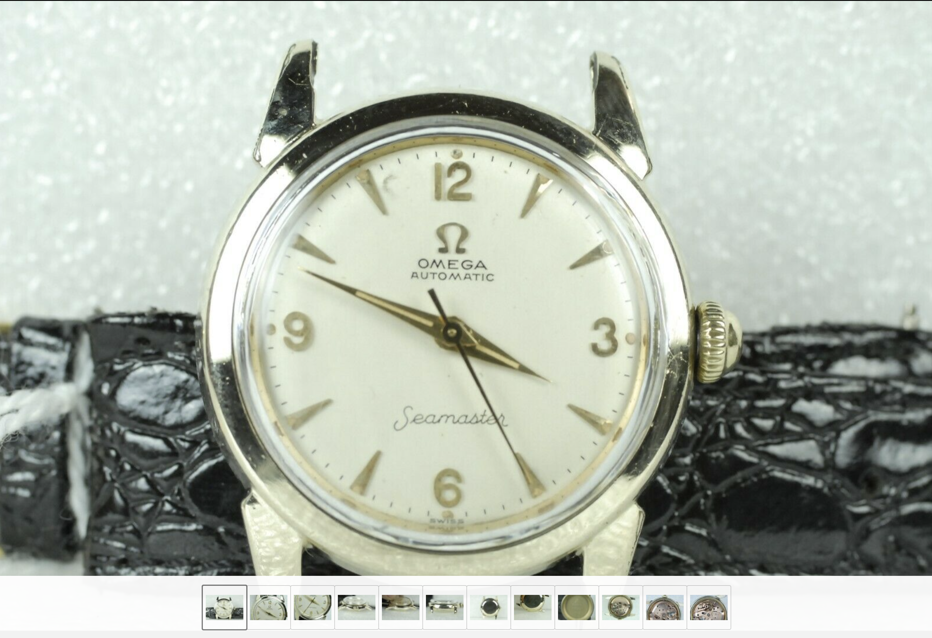

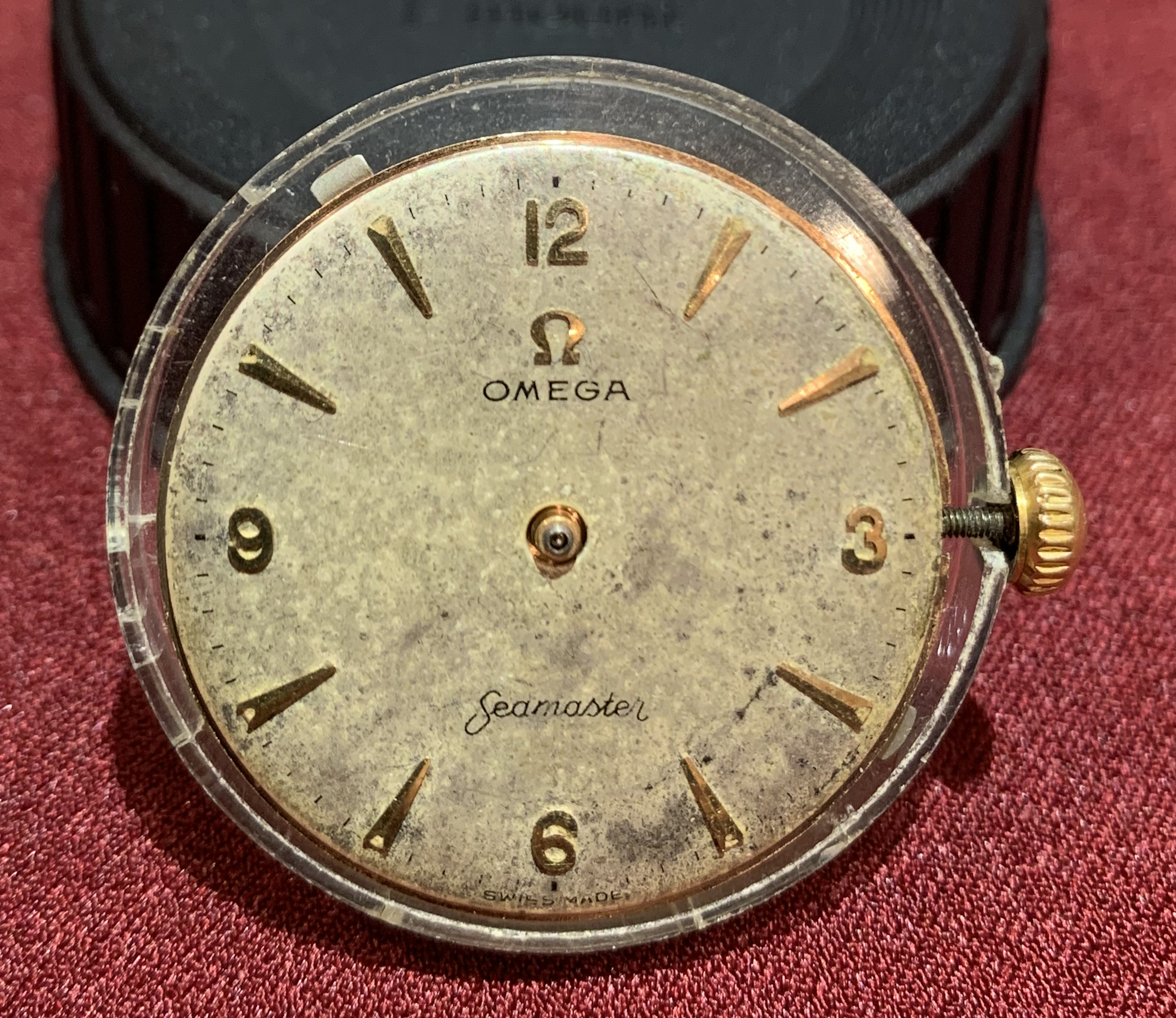

Hello everyone,

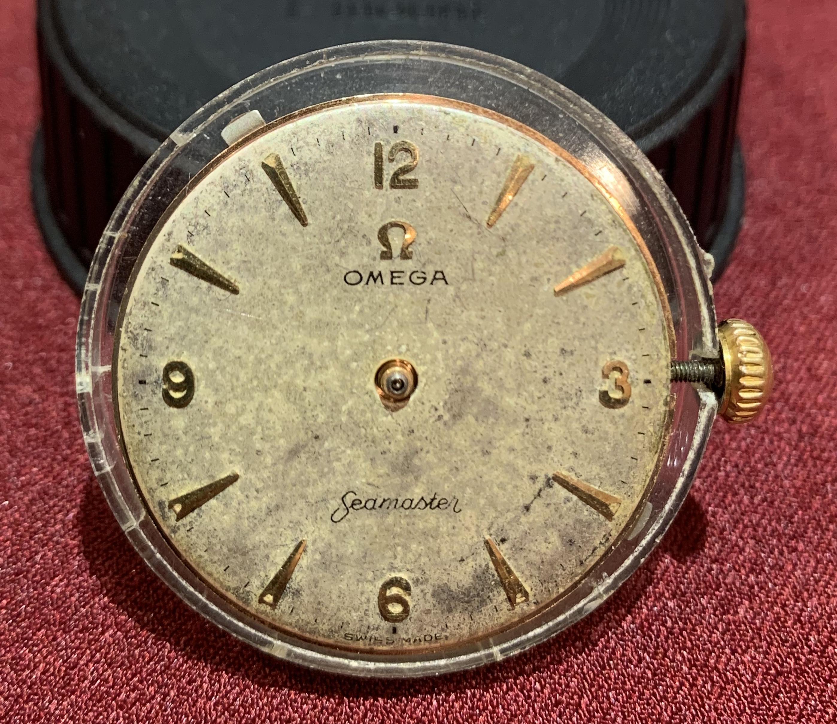

I am just wondering if I am getting this right? I'm trying to date this dial?
I went to the Omega site and as far as I can tell by the indices and the words this dial should be a fifties vintage? Is that right? I can't find the exact dial on Omega but the closest ones seem to be in the fifties?
thx

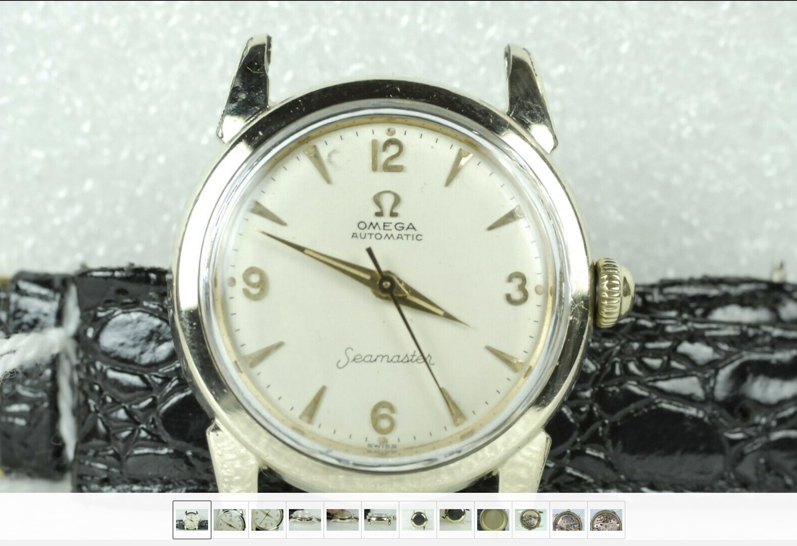

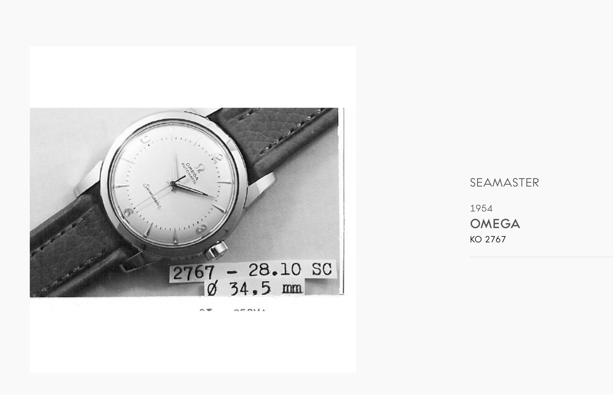

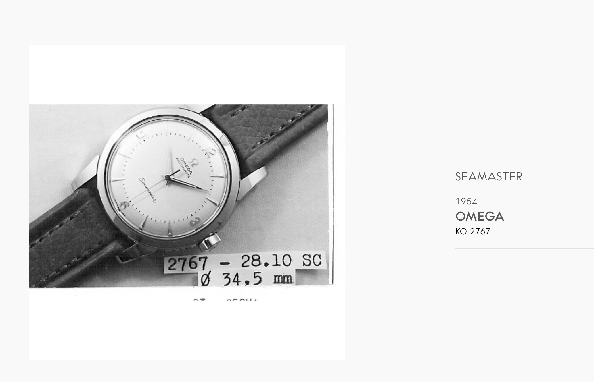

This is close but not the same minute markers and two tone but would this dial be around this time? Same arrows and number pattern and same Seamaster logo?

If the movement belongs to the dial You can find the year from the serialnumber on the movement.

I don’t think the movement belongs to the dial it’s a 286 and I tried looking up based on movement and the dials that came with that movement did not match.

There are only one shown dial variation of each reference i the Omega Vintage Database. For every reference there several different dial variations normally.

The Seamaster font is different in the two you’ve shown. Note the coat hangar S on yours, and the rounded S from the Omgea archive. I always thought that the coat hangar S was late 50s early 60s, but someone else will know more detail
617
2,986
@CaliberKingPin , the image for comparison you took from the Omega archive is for a 2767 reference. It is a Seamaster reference with bumper movement and yours is a handwind movement, surely not the 2767 as it came only with bumper movements.
And like said above, the images found at the archive are just one example of many many more other possible dial variations.
It will be hard to give you a very specific year without knowing the movement and/or serial number!

@hoipolloi is probably right on date-wise. This dial variant both as a manual wind and an automatic came in several different references, though.

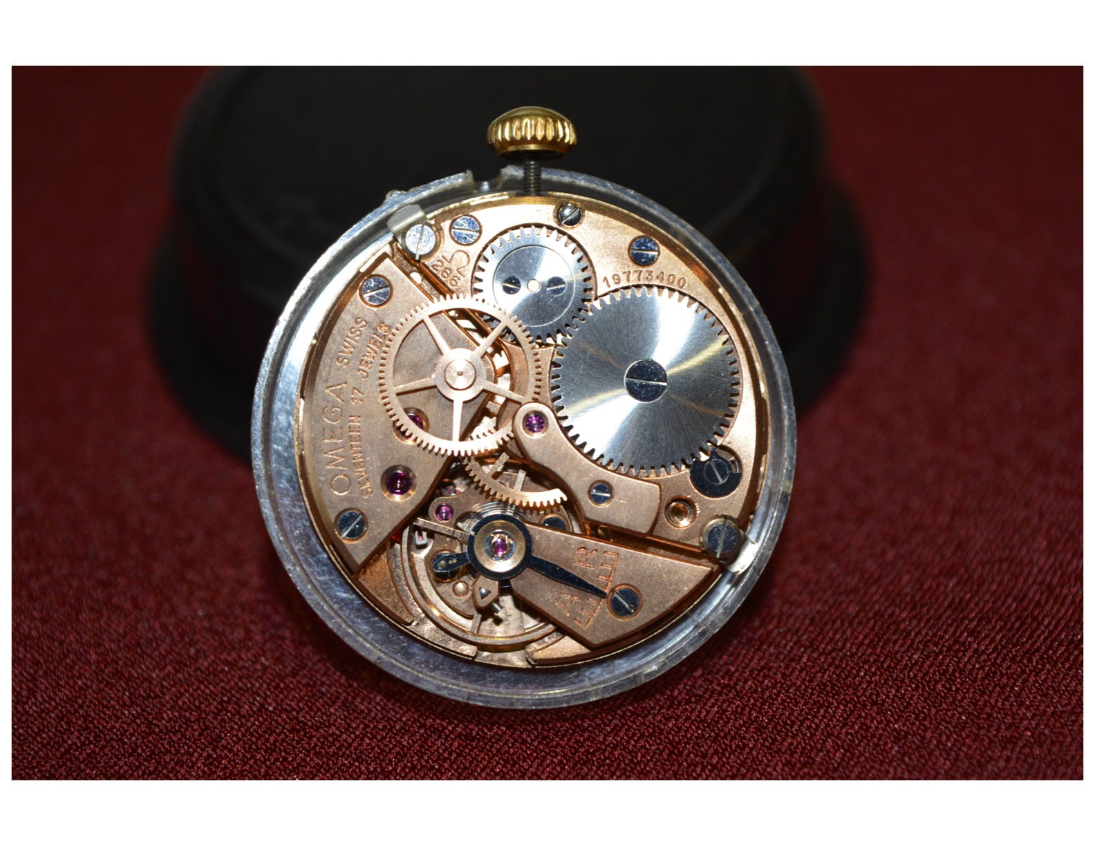

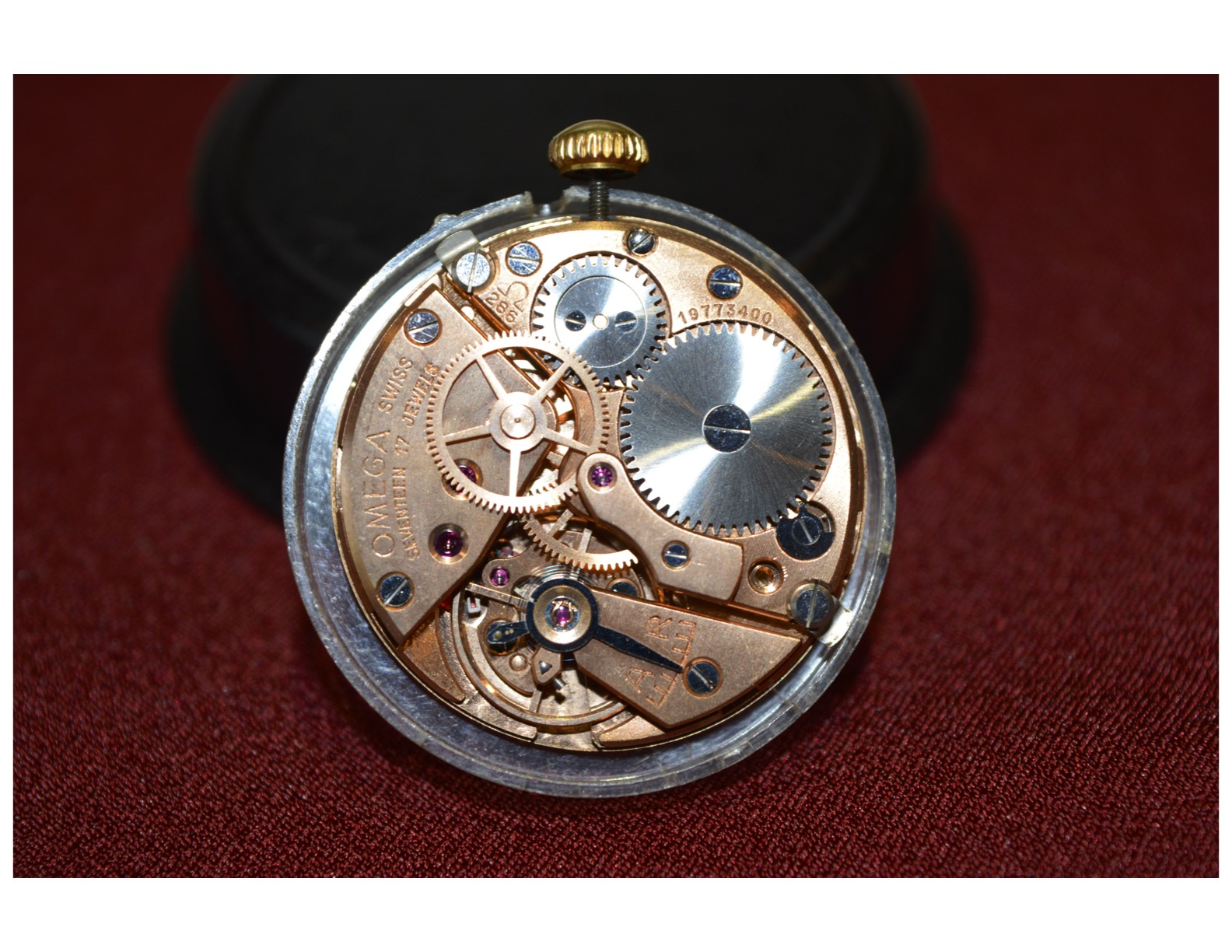

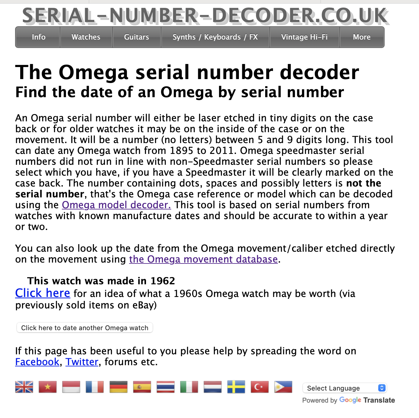

The problem is Rudi the dial does not go with the movement I’m almost certain of this so I can’t use the serial number to date the dial.
When I decode the serial number it tells me the movement is from 1962 which does not match any of the dials from that year when I look on Omegas website.

Don't count on the Omega website for much of anything, especially dials. There could be a dozen or more dials for a given reference or movement.
24,836
55,255
I wouldn't be so sure. You really can't use the OVD for the type of research you are attempting. Are you sure the movement isn't original? Are you sure you have the right year for the movement?

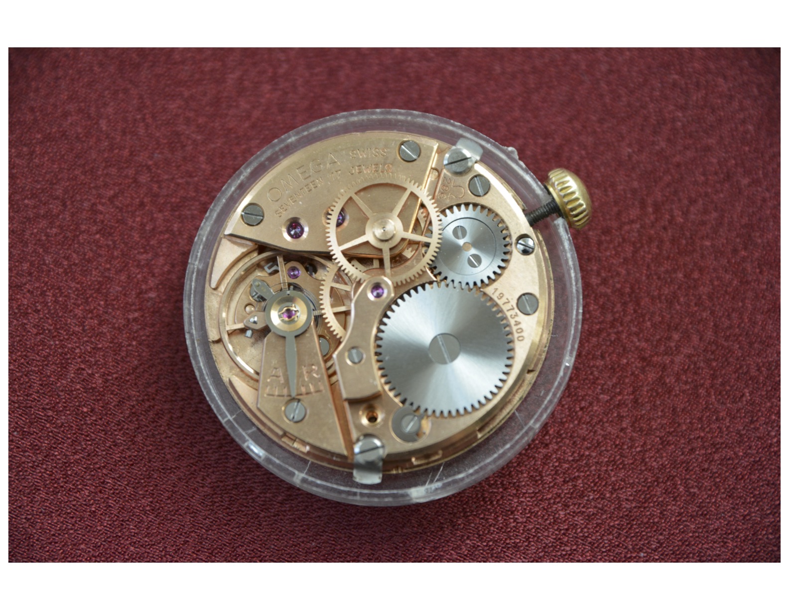

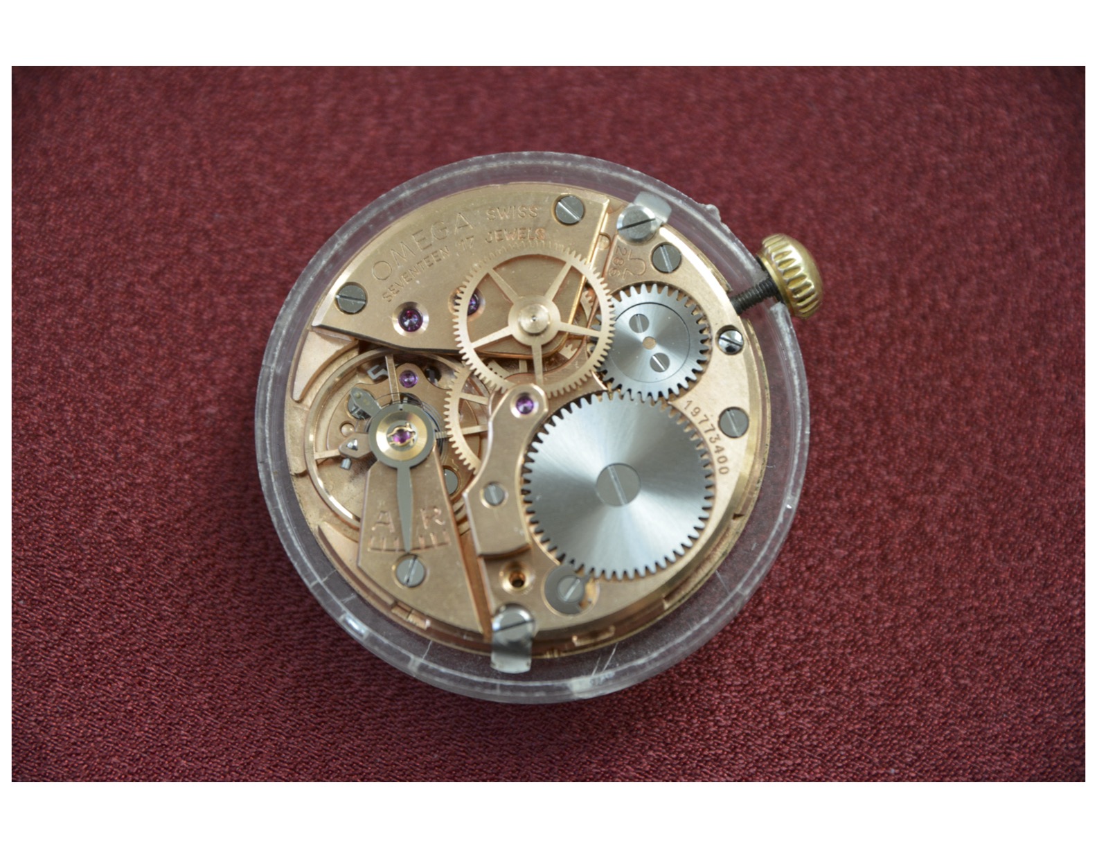

It would be more helpful if you could just give all the information you have instead of parsing it out bit by bit. What is the serial number on the movement?
10,804
16,814
So is this a movement and relatively junky dial that has come out of a scrapped gold watch? What is your plan for it? If you want the full lowdown, like the man says above, give us full disclosure, pictures of the movement will help.

Here is the whole story,
Bought the movement off of ebay was considering using it for parts but when I received the movement and dial the dial was actually in better shape then the pictures showed on ebay and the movement is in really good shape runs well, very poor pictures on ebay listing. I am in no way saying dial is a nice dial don't get me wrong it is not.
My plans for this movement have changed and I would now like try to build a watch for my 11 year old son out of this dial and movement.
That's the whole story nothing to hide.
So I am trying to figure out the date of the dial so I can try to source hands and then a case.
I think the dial does not go with movement by looking on Omega site and not being able to find this dial in 1962 the movement year is based on the serial number the decoder which shows 1962.
If anyone has insight in what hands go with the dial and which case model number go with it I would greatly appreciate the help.
Thank you for your help.

Does anyone have any thoughts on the if the dial is matched to the caliber?
Or are they mismatched?

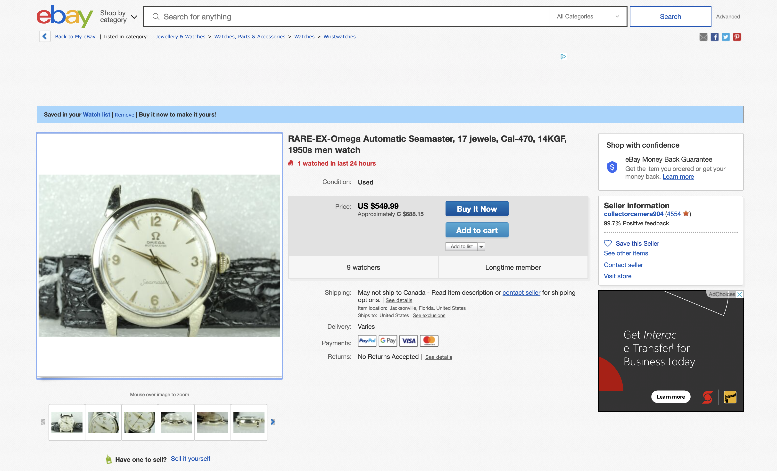

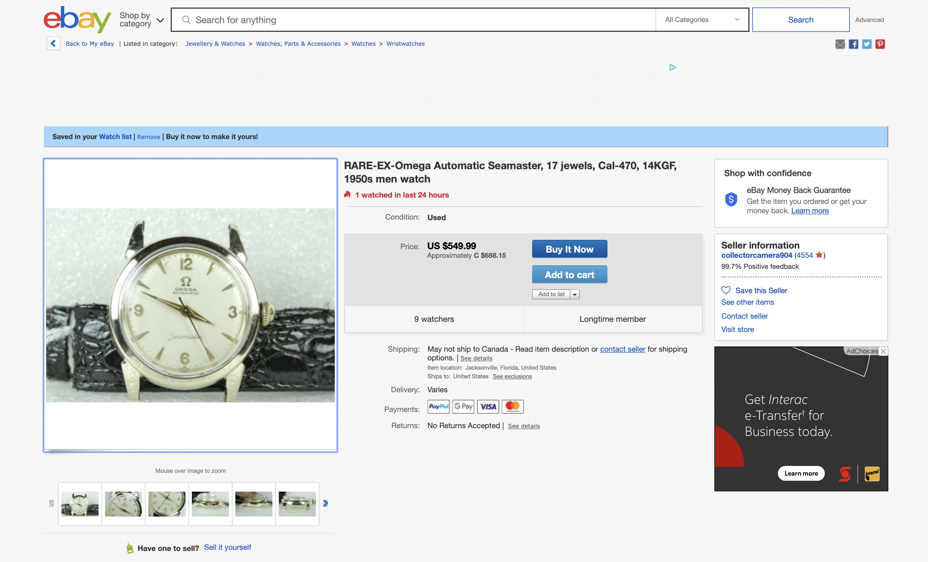

I have been going through Ebay to try to find a something close to that dial and this is the closest I have been able to find so far.
The dial is very close the S in Seamaster is sightly different, it's an automatic, at the bottom it only says Swiss instead of Swiss made and the Ebay one has lime dots on the numbers. So a few differences but closest I have been able to find so far.
Most of the examples of this dial I have only been able to find in an automatic.
Did Omega offer a lot of their vintage watches in both automatic and manual?
Thanks for your help.
https://www.ebay.ca/itm/RARE-EX-Ome...ls-Cal-470-14KGF-1950s-men-watch/224286179899
2,816
6,951
As mentioned here, this dial could have come in several different references and trying to figure out which case the dial fits in will be a challenge. Not a challenge I would personally undertake for a dial that isn’t all that attractive.

Your right great advice so for what Im planning I should probably just stick it in a 30mm case and slap some 286 cal hands on it.
Appreciate the insight sometimes one can lose sight of the objective! lol

As noted above, the original case was probably gold, but it will look fine in a SS case with the correct color crown.

Lots of headaches are waiting for you.
First, you have to find a water proof case for it then a 28X movement coming with a retaining ring, a waterproof crown and a set of correct lengh hands with lume stripes.
Why don't you collect dials only?
