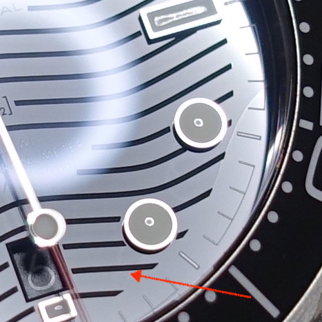

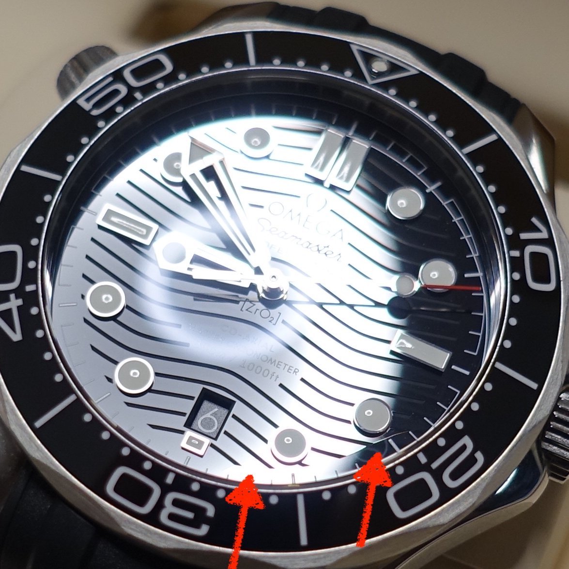

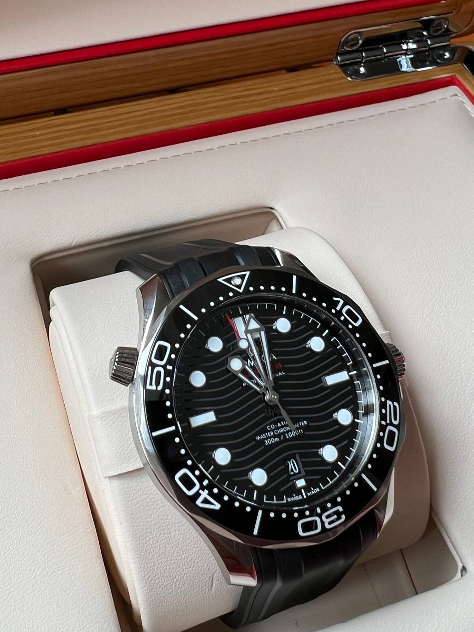

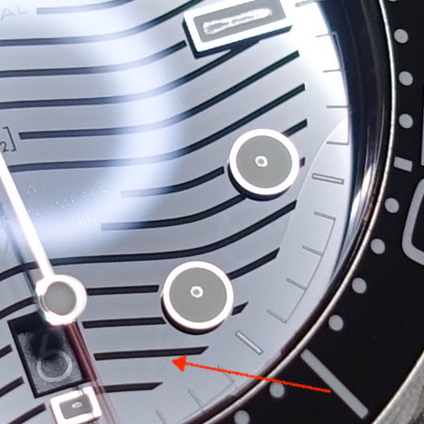

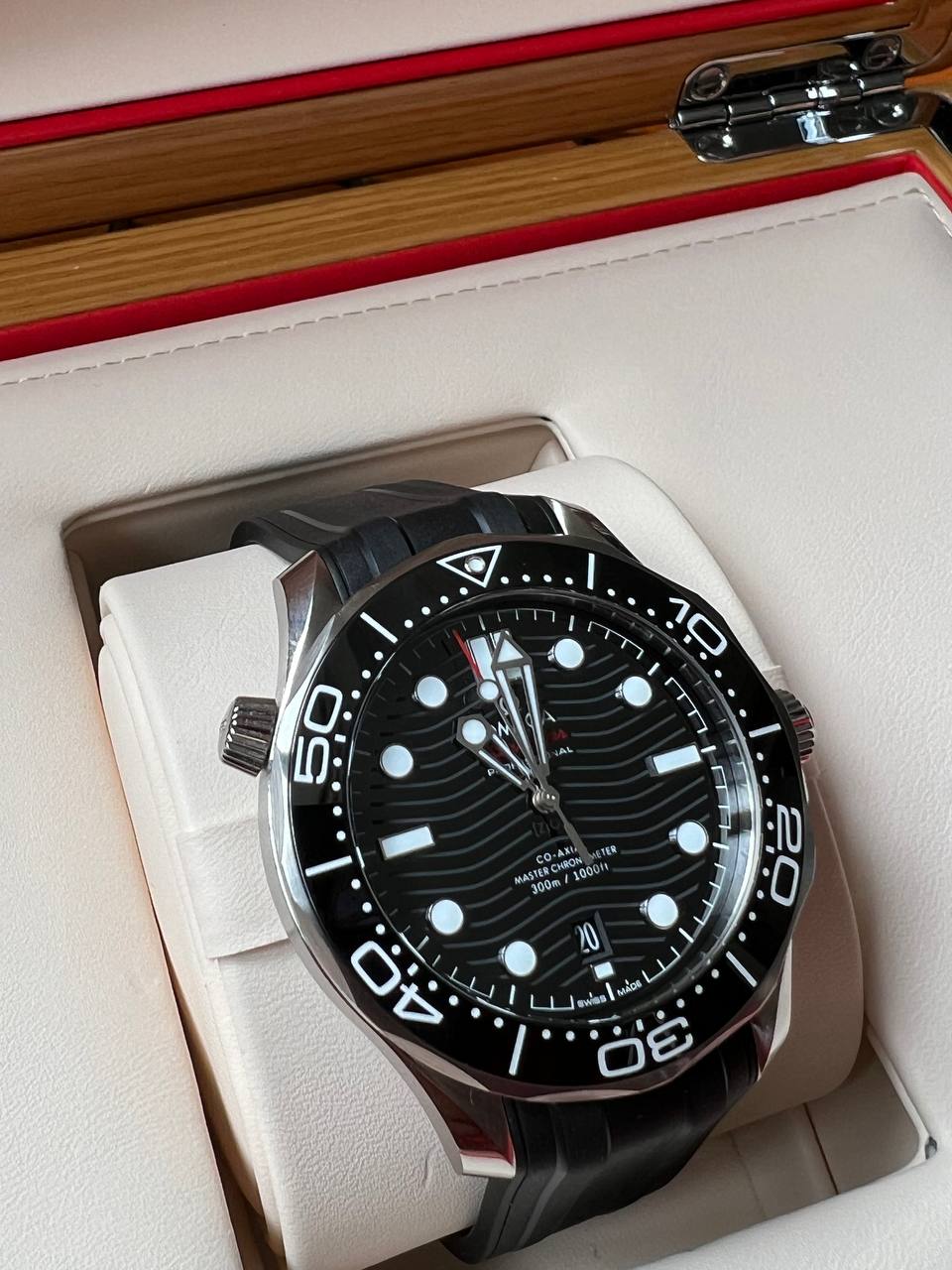

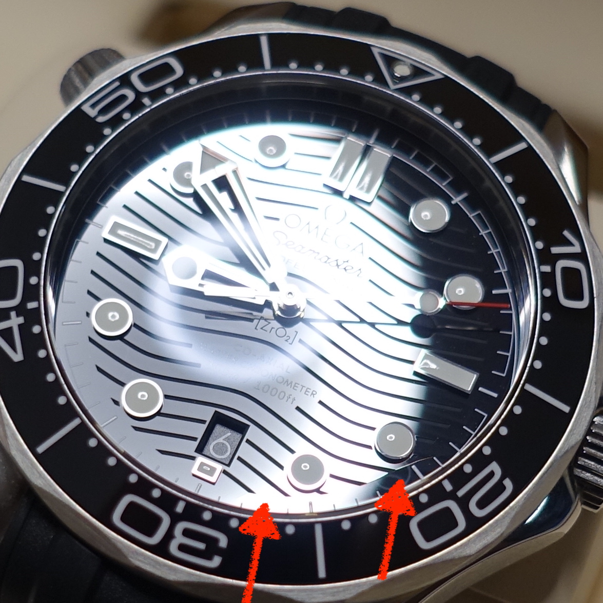

Hi, have you encountered this problem?
I received the watch in August 2022. They were on hand 5 times. While working under the light, I saw that there were some lines, I wiped the glass, but it didn't help, then I took a closer look and the ceramic dial is cracked.
The watch is like new, only on hand 5 times, no scratches or drops
I sent them for a services, so I believe they will replace it under warranty

Are you sure it's the dial that's scratched/cracked? looks from the pictures it might still be the crystal.
30,292
78,209
Yes, definitely cracked dial, as you can see the abrupt change in the reflections. If you haven't yet sent the watch in, take photos of the watch case to prove that there is no impact damage on it, as that may come in handy.
Hopefully they will swap this under warranty...
that's what I thought at first, but the glass is clean

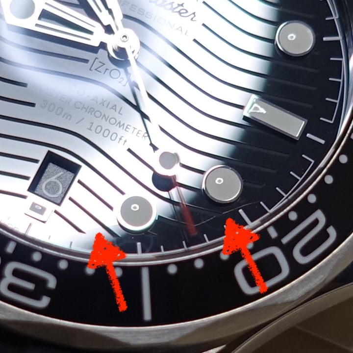

It wasn't that easy to notice, even the seller didn't see it until i pointed the watch at a certain angle, it's hard to see, but it's cracked

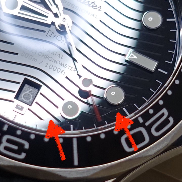

the first part is clearly visible in the photo, but here the second part is almost not visible at all because the light falls differently

For painted or enamel dial, it is not surprising, since there is only a thin layer of material on top of metal. The top layer will degrade and crack as it ages.
It is a bit surprising that a ceramic dial would have cracks like that though.
I guess the dial was shocked at some point, or there was a flaw in the ceramic during the firing process.
Ceramic/porcelain artists always have a small fraction of their wares fracture or shatter after the final firing.

mine have 3 long lines propagating from the hands outwards to the edge of the dial, as can be seen in the pictures, btw mine is from late 2020
