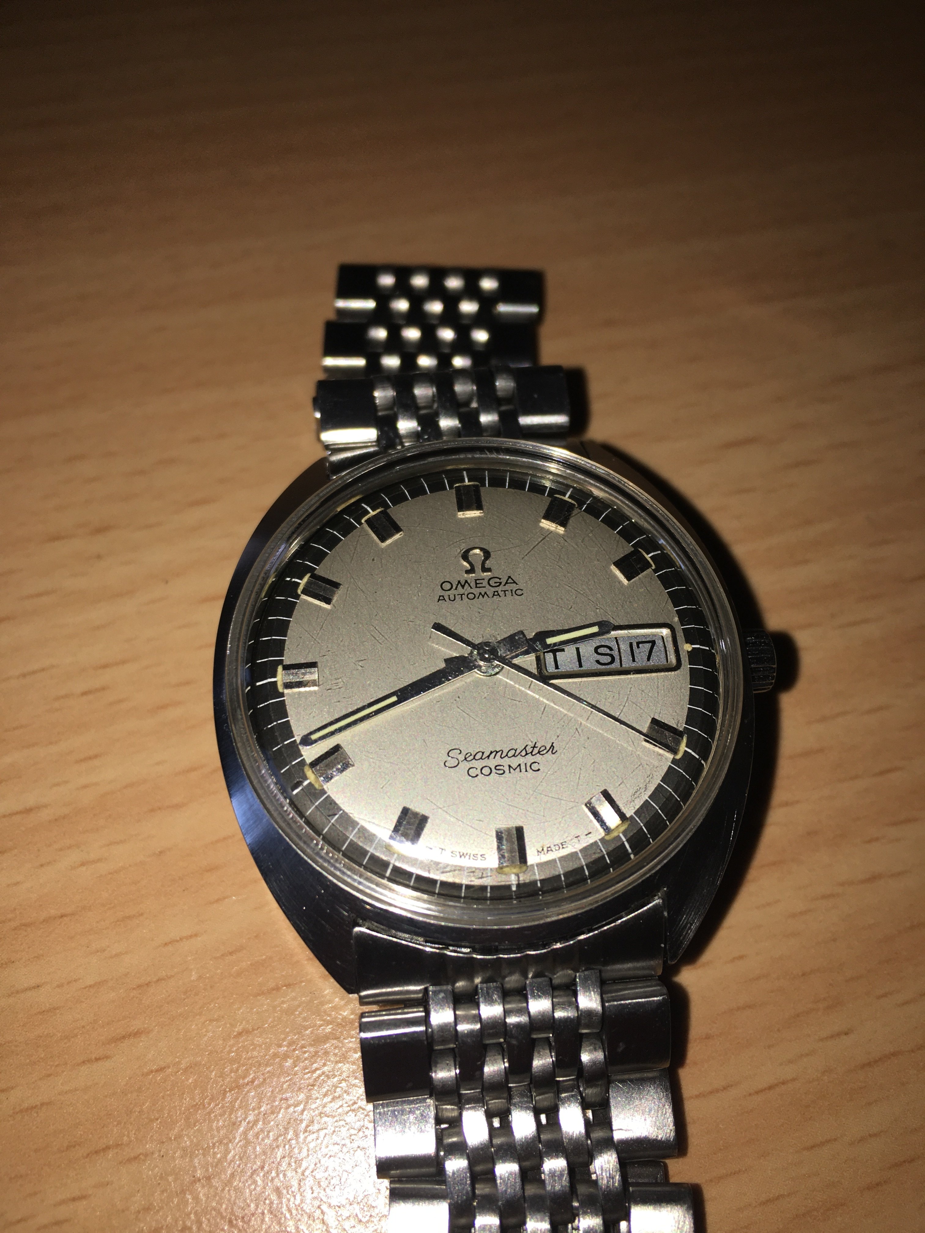

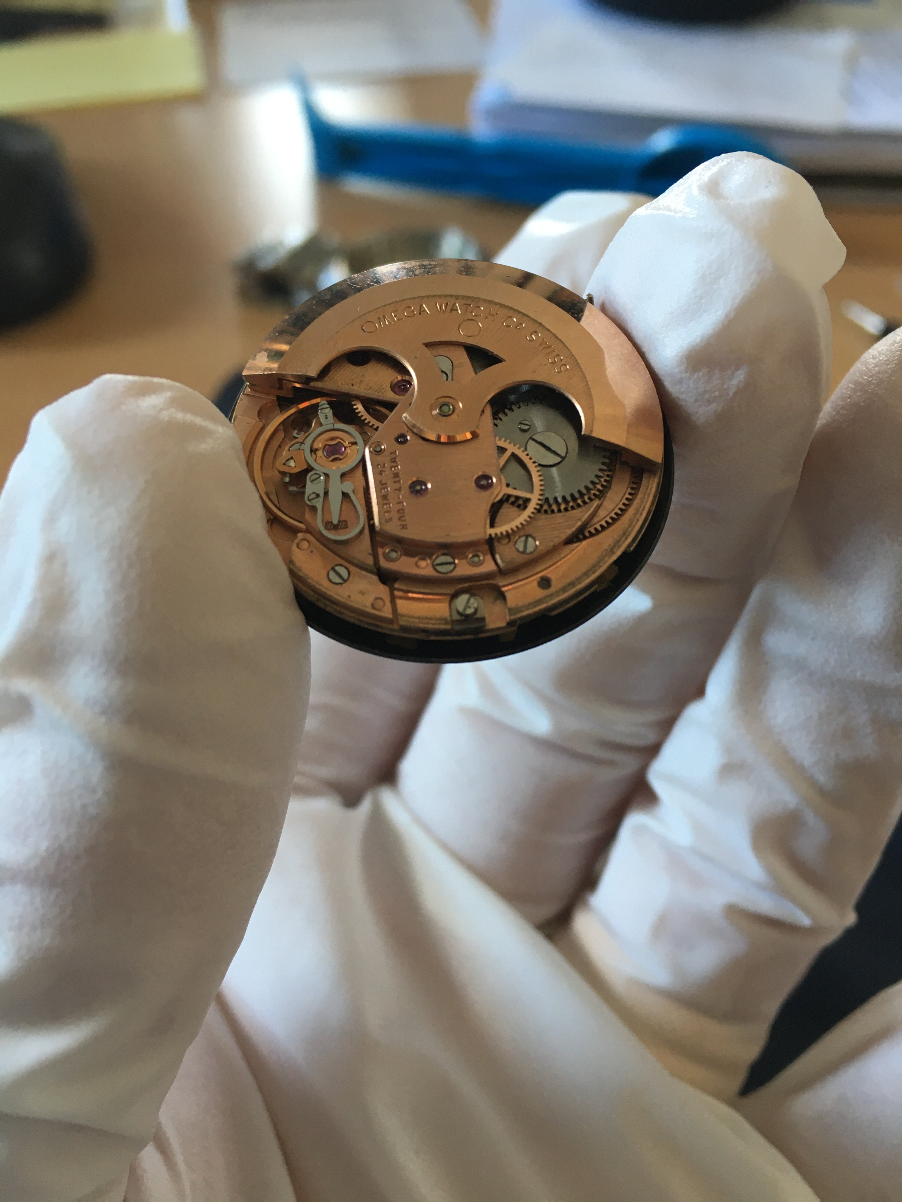

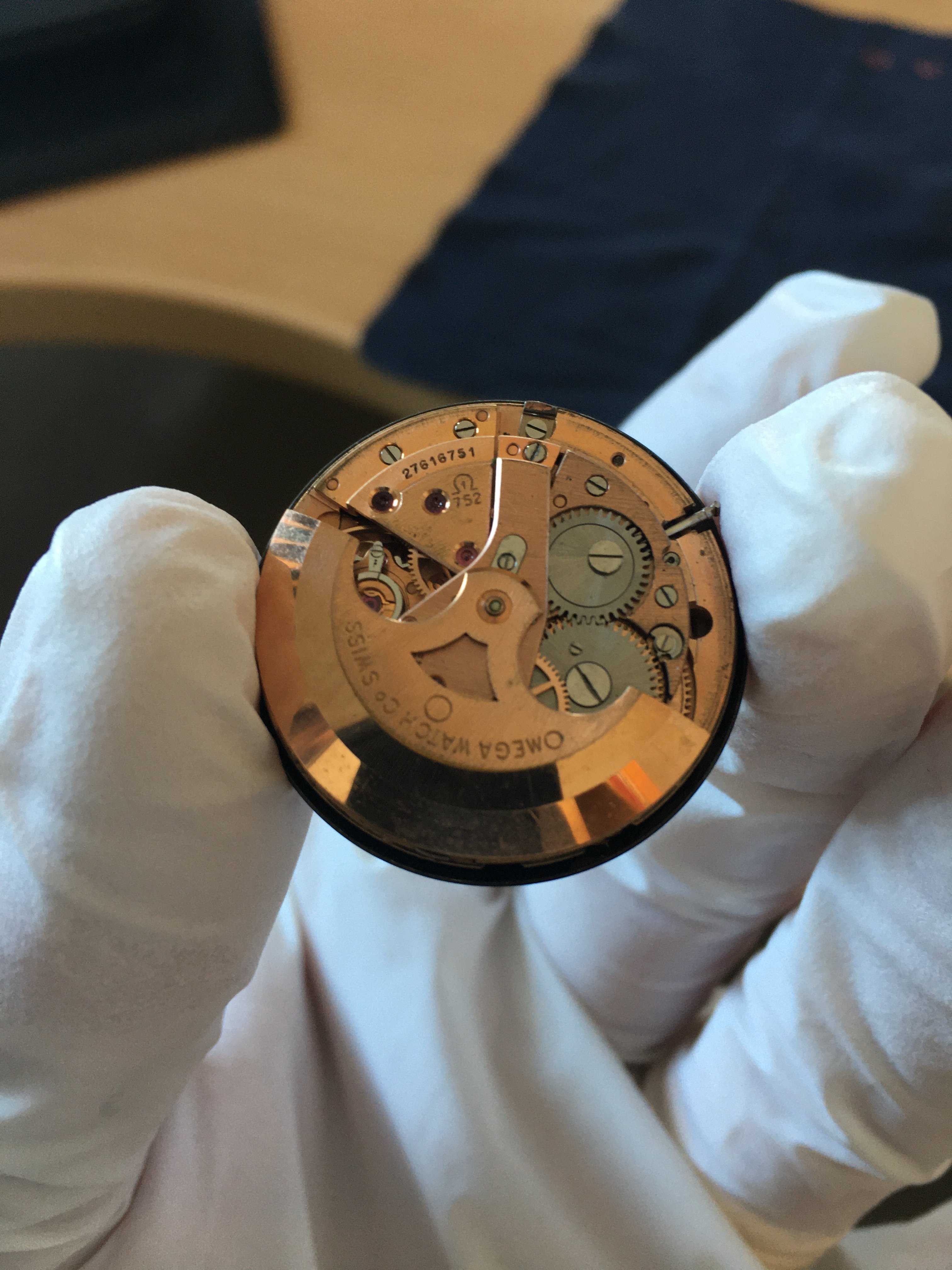

Hello all!

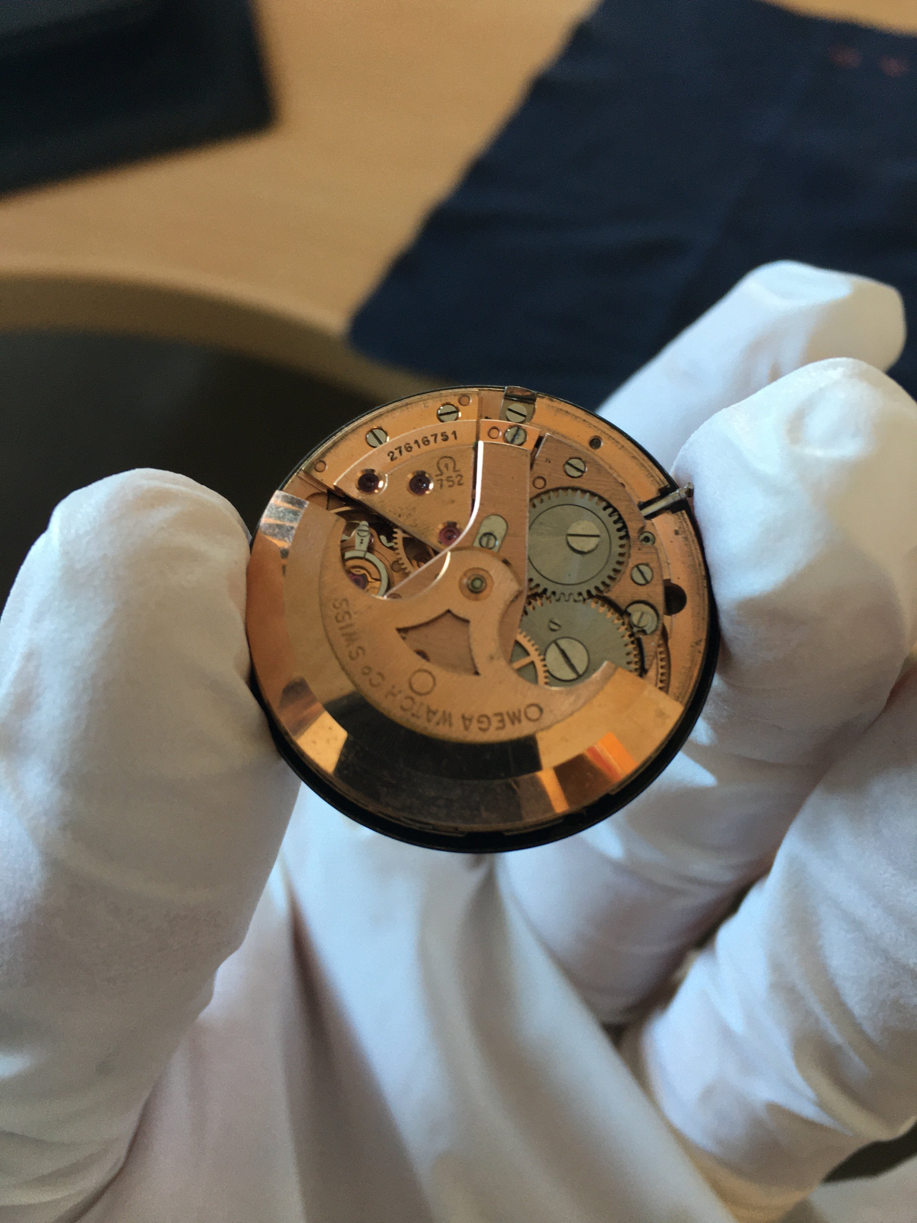

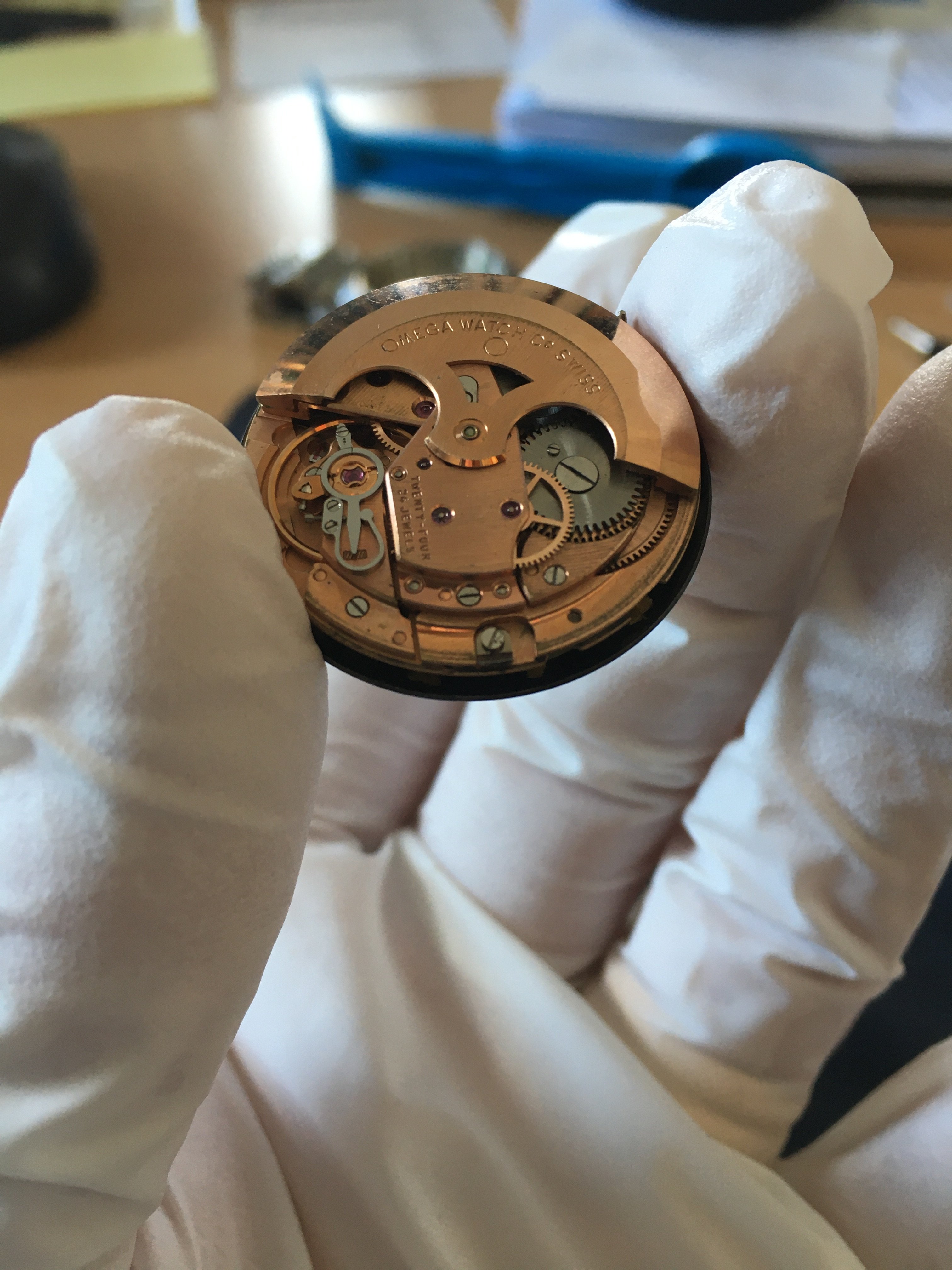

I’m brand new in The forum and also new at collecting Omega watches. I recently purchased a Seamaster Cosmic ref. 166.136 with a 752 movement. I immediately noticed that the movement was a little loose inside the case. When I shake the watch I can hear the movement bumping in the case.
As you all know it’s a solid case back so you open it from the dial side. I opened it and could not see anything strange. A video on YouTube tells me that the movement with dial just slides in to the case, turning it a few degrees clockwise, and then the crystal goes back on. Still the same problem...
Anyone here who might know where the problem might be?
All help deeply appreciated!

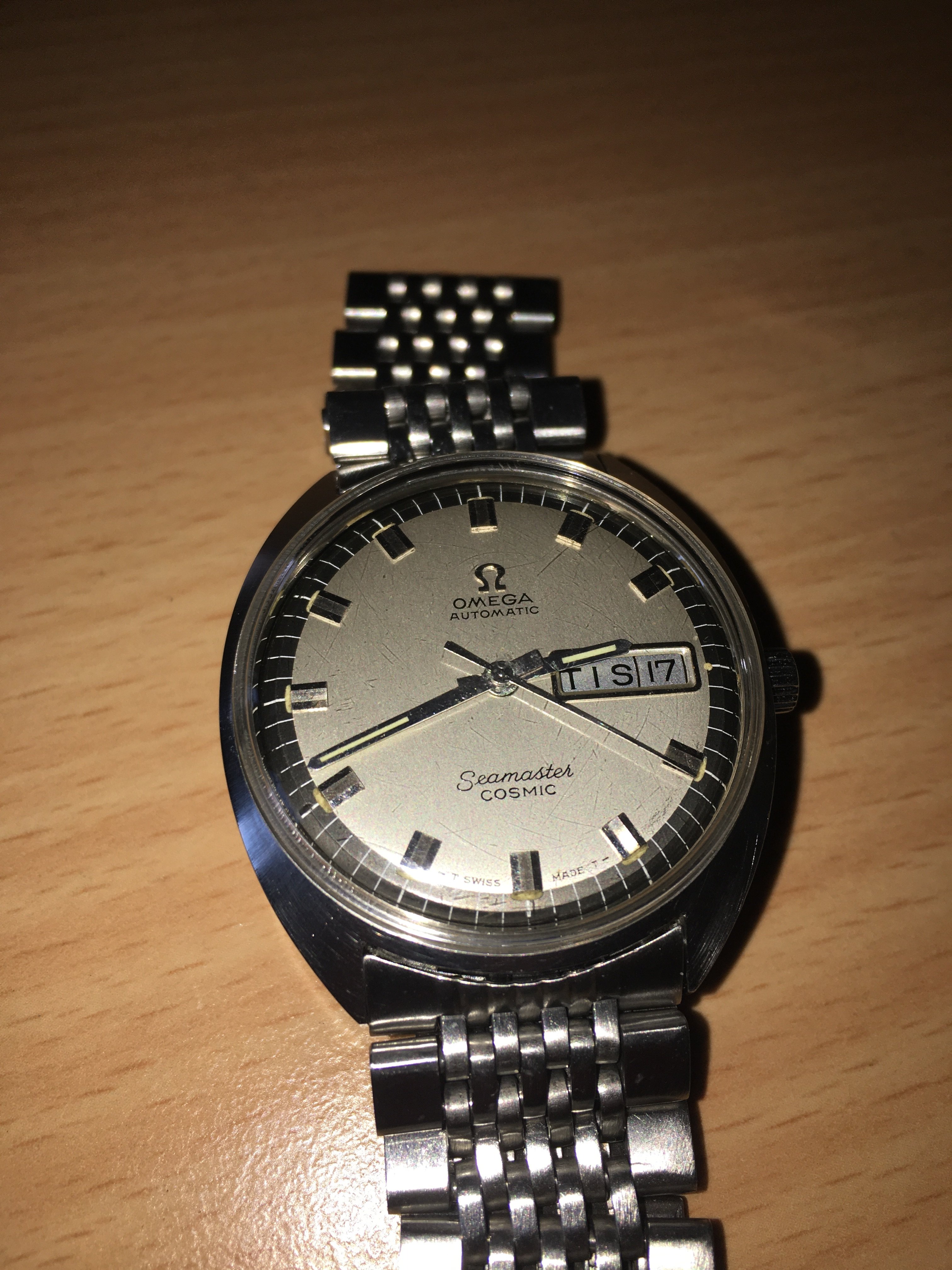

Based on photos hard to tell, but it appears that the crystal may be lacking the tension ring. Can you show just the crystal itself?

You’re absolutely right, there was no tension ring... But should there be one on this model? I couldn’t see one when looking on a restoration video on YouTube. The crystal seem to fit tight to the case.

Yes, 100%
You have your answer. Case number should be 166.036, so crystal is - 063PZ5123
Description from Omega for that crystal is - MATERIAL: GLASS PLEXI STEEL RING

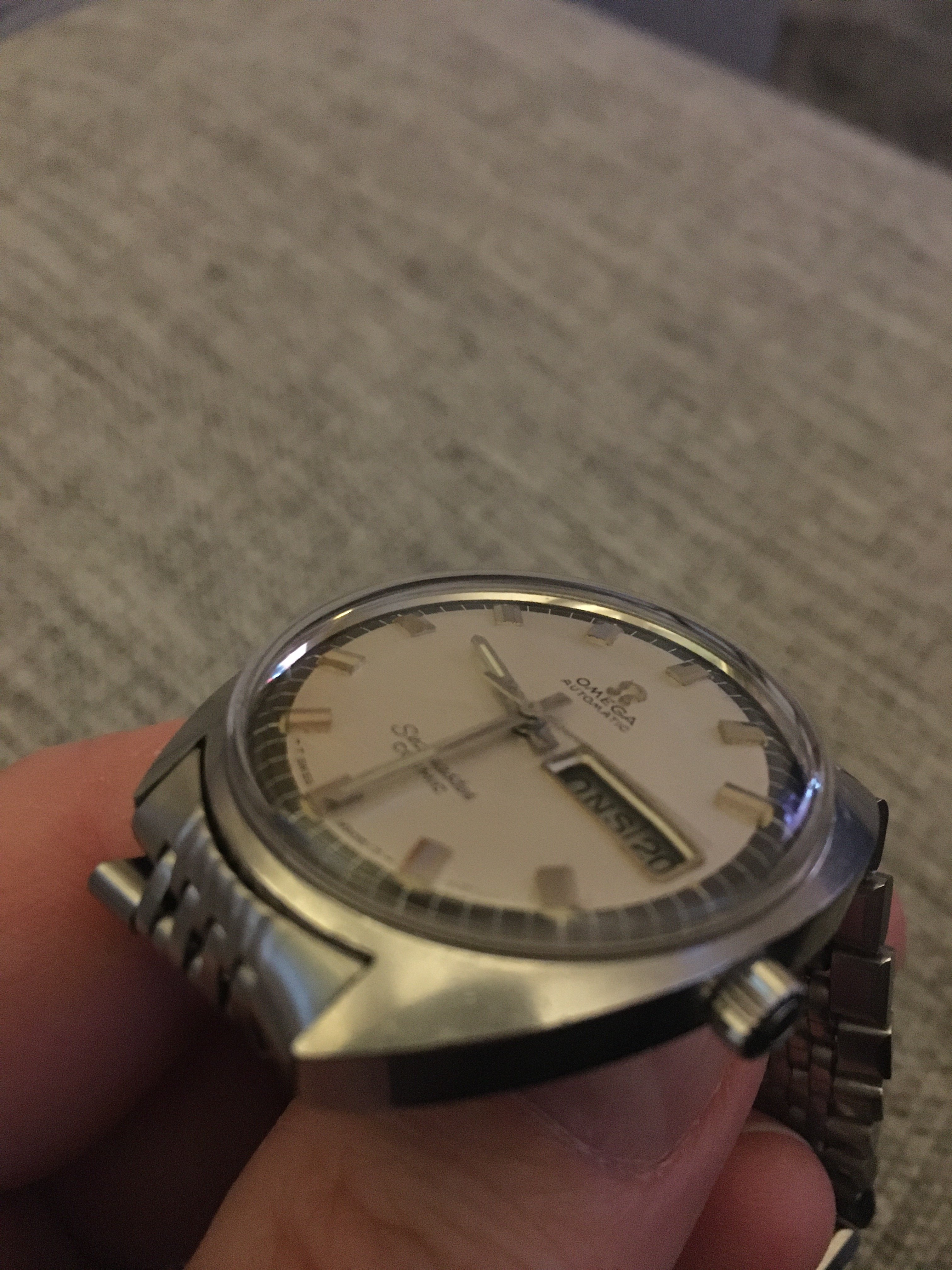

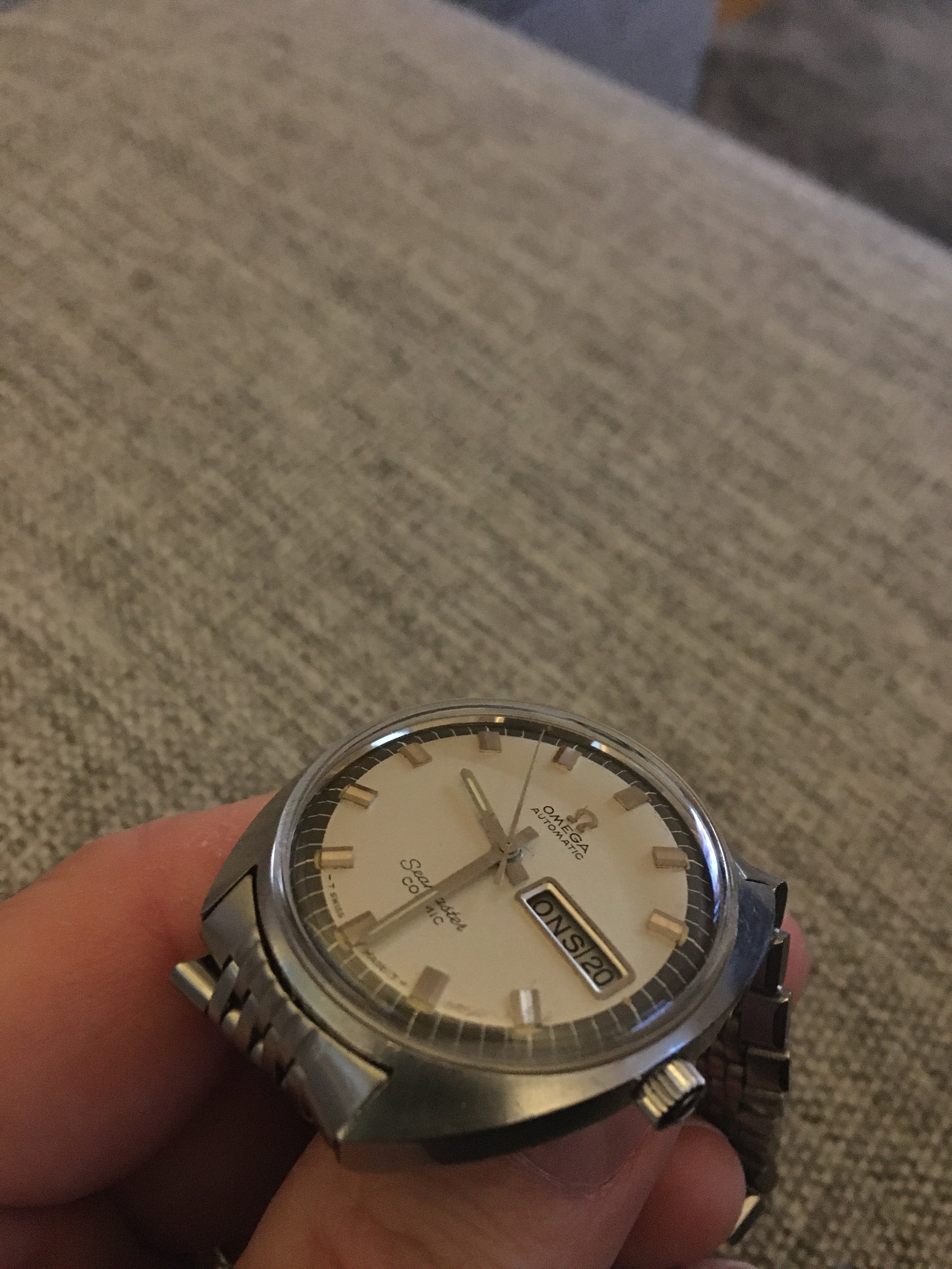

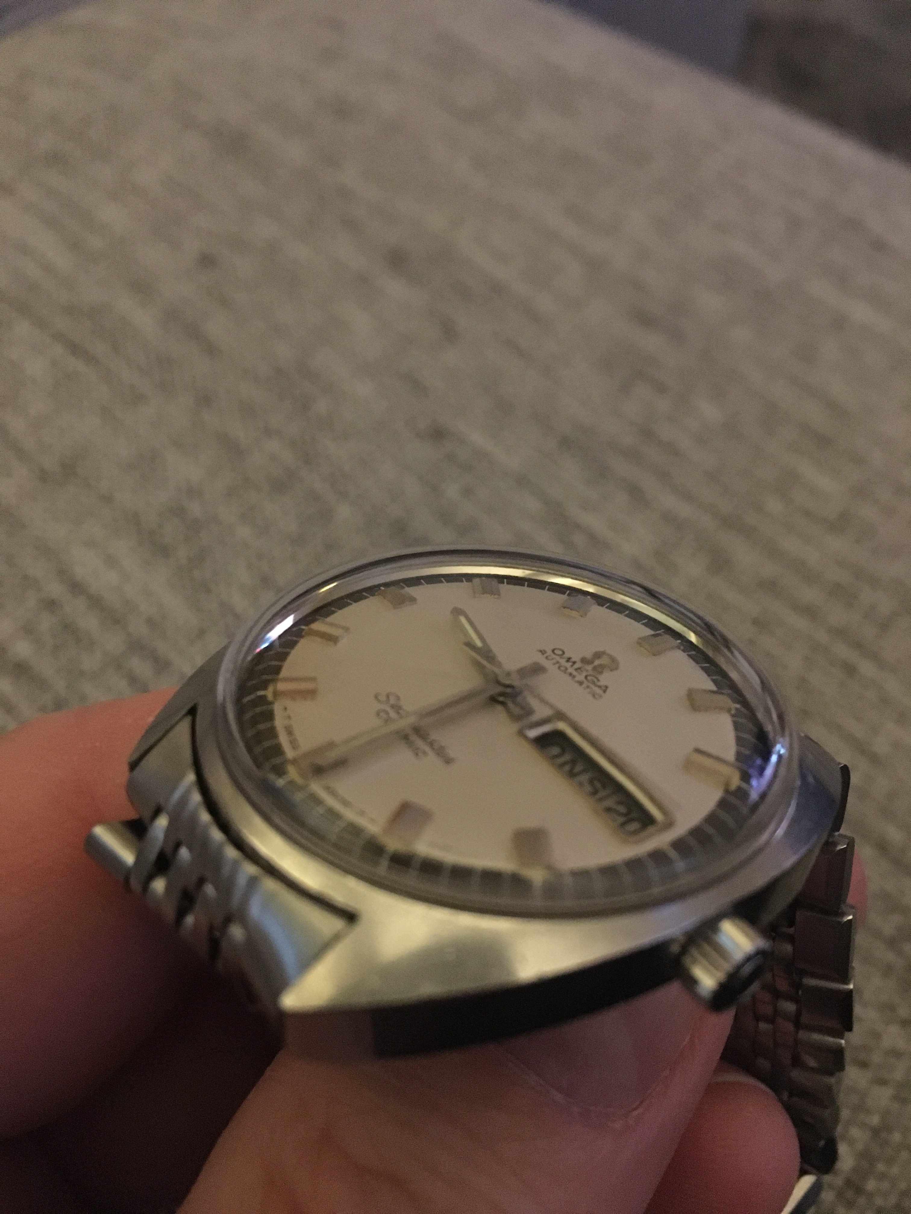

Ok, but If the ring is mounted on the crystal I might have missed it. I know I saw something chrome-metal at the edge of the crystal. Could it be the glossy ring in these pictures that is the tension ring?
13,489
31,804
Yes there is a tension ring you your watch, however I believe the correct Omega tension ring for this reference has a step where as a generic one usually doesn't.
24
4
I see, but the crystal has the omega logo in the middle... I noticed now that when I pull the crown one step (time setting) and move it a little in and out, the dial moves a little from side to side. Then when I put a finger on the crown, still in time setting mode, and shake the watch from side to side, the movement is not bumping from side to side like it does when the crown is fully in...
30,205
77,994
In your newer photos, the ring can be seen, but it appears to me that it's not touching the dial - I see a gap. If that is the case, then it may be the wrong tension ring, or wrong crystal for this model.
24
4
