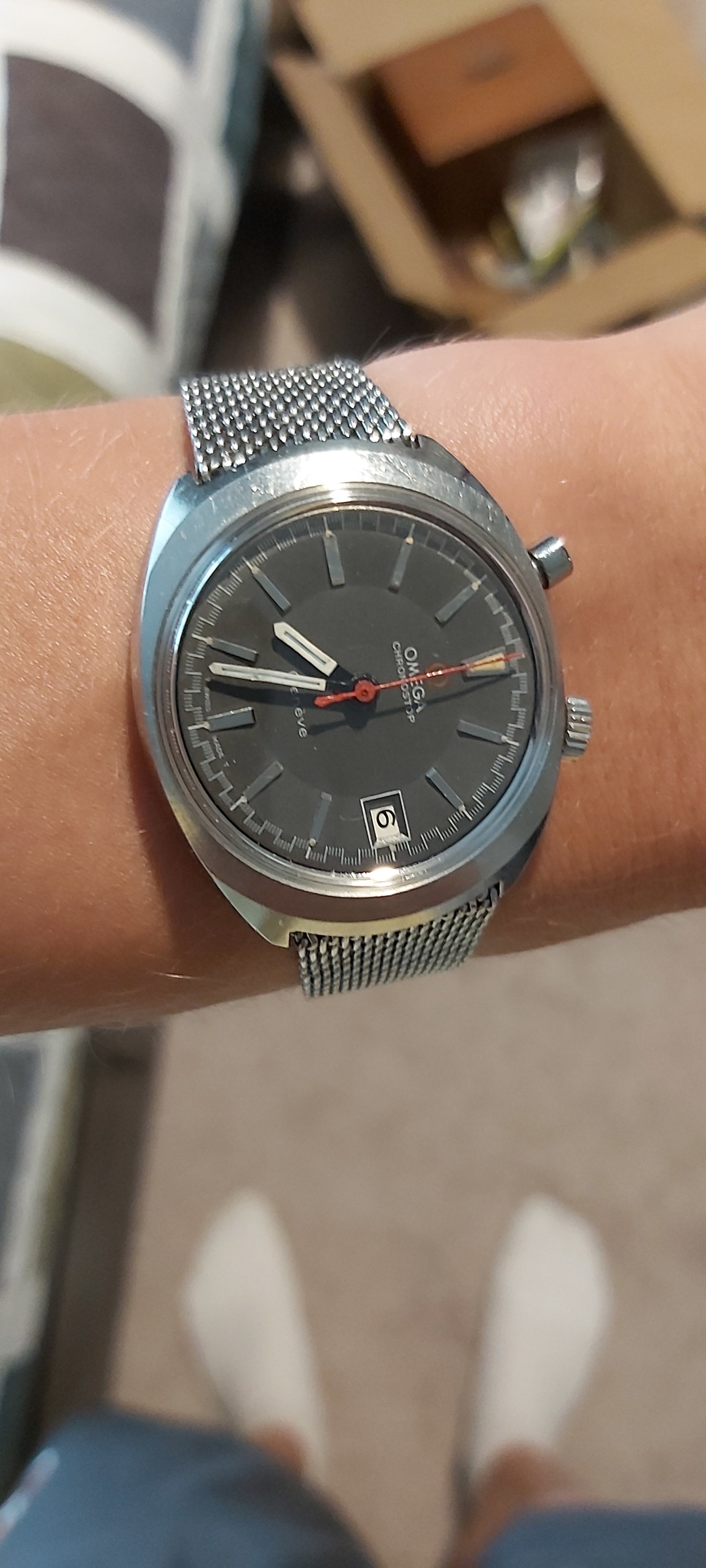

Hello! I have been working on an Omega Chronostop that I recieved from my grandfather a few months ago. The timepiece is gradually coming together, however it seems that the cannon pinion is loose. The two common symptoms that my watch has shown is no resistance when I set the time by pulling/turning the crown and the hands slowing down or even stoping despite the rest of the movement operating normally. I have tried to find either photos or videos online regarding cannon pinions, and I was wondering if anyone has had experience servicing calibre 865 or 920 (the date wheel version) canon pinions. Is it theoretically posssible to tighten the canon pinion so as to not purchase any new/old stock or is a new part inevitable? Also, in the case that a new canon pinion is needed, would it be possible to replace said canon pinion without disassembling the rest of the movement? I will post a photo a little later when I have time.

Just replaced the cannon pinion and it seems to have done the trick. I plan to get the watch serviced once I'm out of college and can afford it. Also, is there any advice on a good brand of brass tweezers? My last pair started to bend too much for the force applied and I feel like they are going to break before I really want them to. A few weeks ago they were solid as can be...
