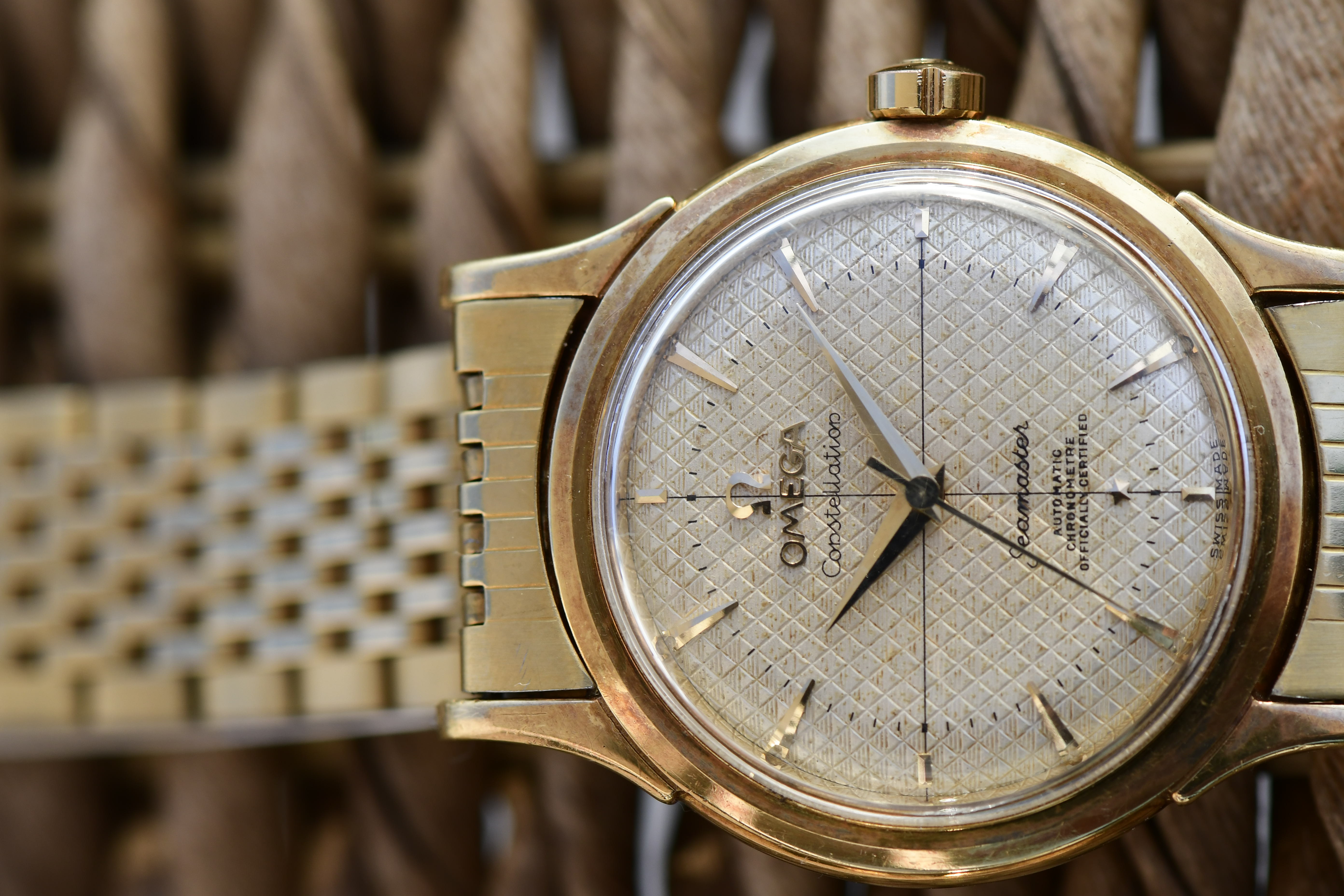

Dear forum members,
Hi! I am new here. Joined a few days ago, took one look through the vintage section and was immediately hooked. Almost like porn!
As for me personally, I am fascinated with all 1950s and '60s Constellations. They are, to my eyes, the best watch designs ever.
So, coming to the matter at hand. The other day, I came across this watch and i have never seen one with this dial before. I searched the internet and couldn't find a single photo or any kind of information. Please take a look.
I am going to stop talking (typing) and let the pictures speak for themselves. Any thoughts will be really appreciated 😀

The dials actually have different indices, I think the one thing in common with them all is that they are coming out of, or have been through, Indonesia/Jakarta.
The early "Constellation" printing is very convincing though, especially with the double crossed t's
The cases are different too. OP's is solid gold while the older one is good cap. Same ref 2782 and very close serials though.
2,876
1,962
Here's another one from Asia, but not Indo/Philippines. Don't think any of them are redial, but possibly custom ordered or national/regional concoctions.

.... or possibly done in a batch once they arrived from Omega by a local jeweler.
Confirmed, my friend's is yellow gold capped, so it is different from OP. With your newest picture then there are AT LEAST 3 similar specimen dials exist. At this point I expect more will surface....
While we need to maintain healthy skepticism, a bit of open mind may actually help us discover what story really happened to these Seamaster Constellation. Just my 2 cents
5,753
2,939
Interesting possibility, but it can not explain location of the star, which is too far low, assuming the 4 line text was added later.

Is there any significance to there being more than just one of these out there?
5,753
2,939
If it is only one, then possibly it is a redial work from scrap dial by a watchmaker or his friend . When there are three or even more,it is less likely just a one off job.
They will need 3 or more similar pattern base dials with complex pattern which I imagine was difficult to source or create/fake .
They will also need high quality ink and print screen to create 3 or more consistent printing. Note that most of us agree that at least Constellation text is high quality, almost like original quality. AFAIK not until recently, recreating factory quality vintage dial printing that able to fool OF experts is almost impossible. (hoipolloi recent Connie Vietnam special redials might be an exception)
So there is possibility that these dial was a special order rather than fake or redial.
Really? I mean, even if I wanted to, Toyota would never ever put 'Starlet' and 'Prado' on the same car, even if I paid them handsomely.
Might think it differs of course with 'specials' like Turler or the pic of a Sjiek for the Omega dials.
Curious as to were those thin lines will be / would have been: what would still have been acceptable for Omega...
Again: unlikely that this will fall within their 'acceptable' brackets.
