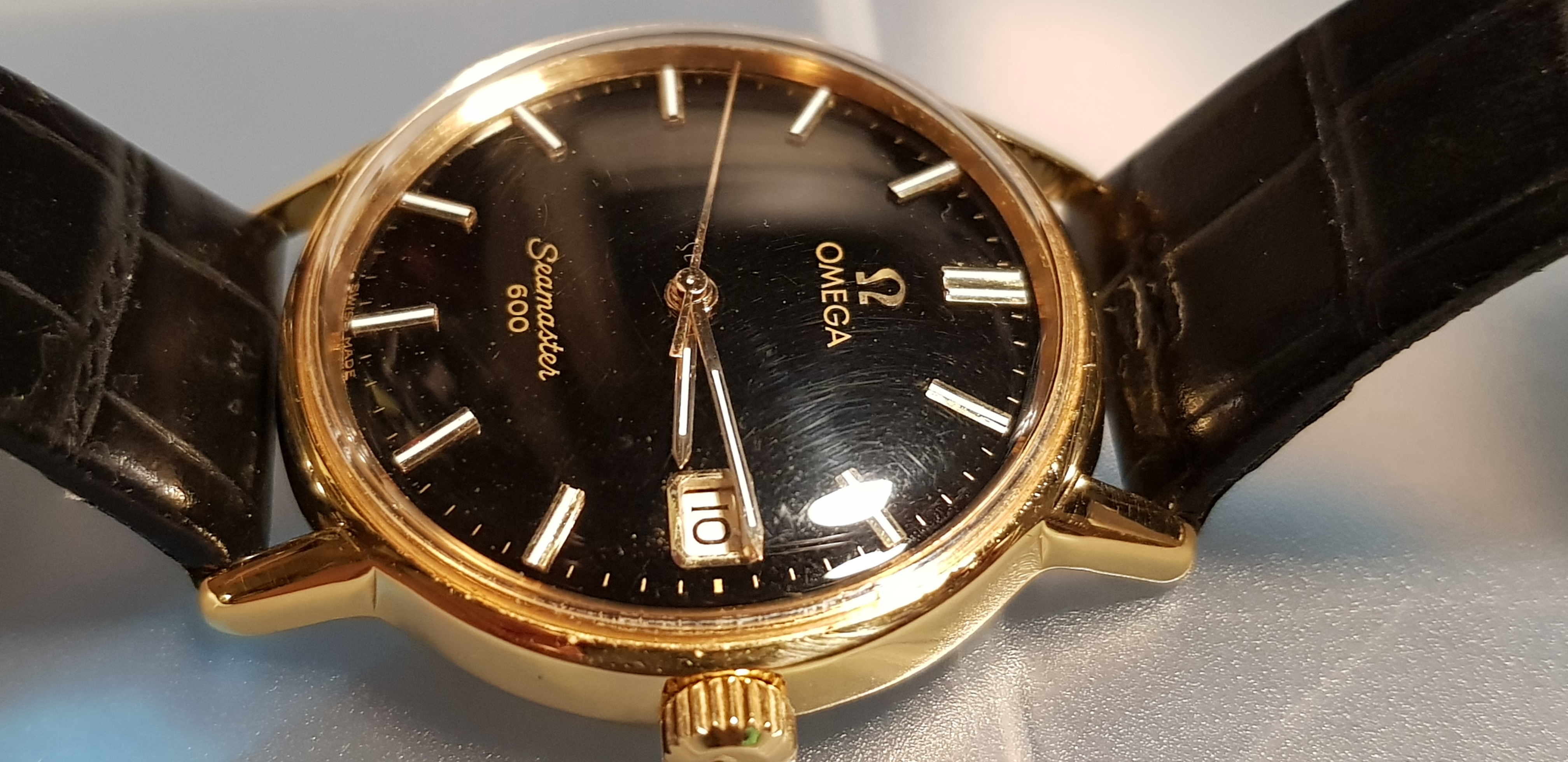

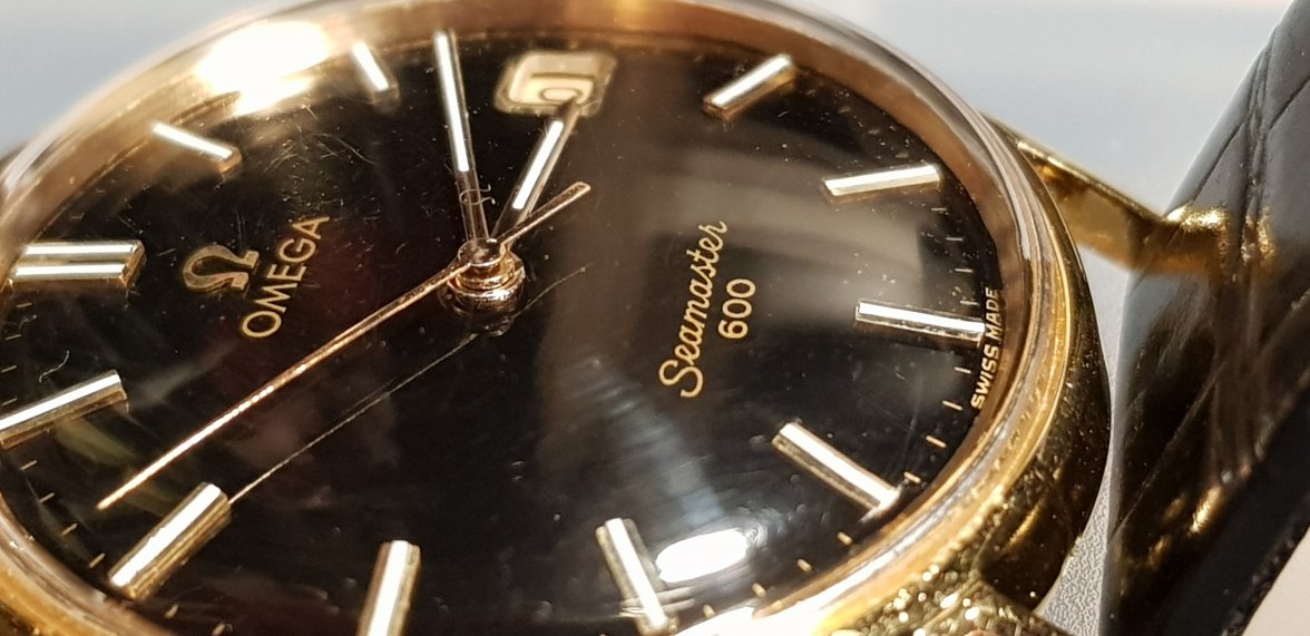

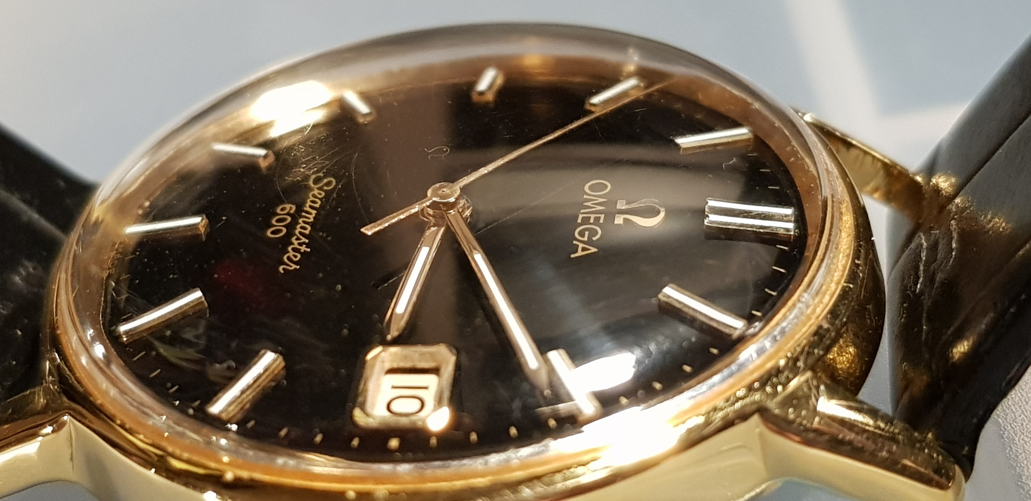

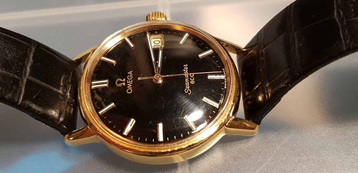

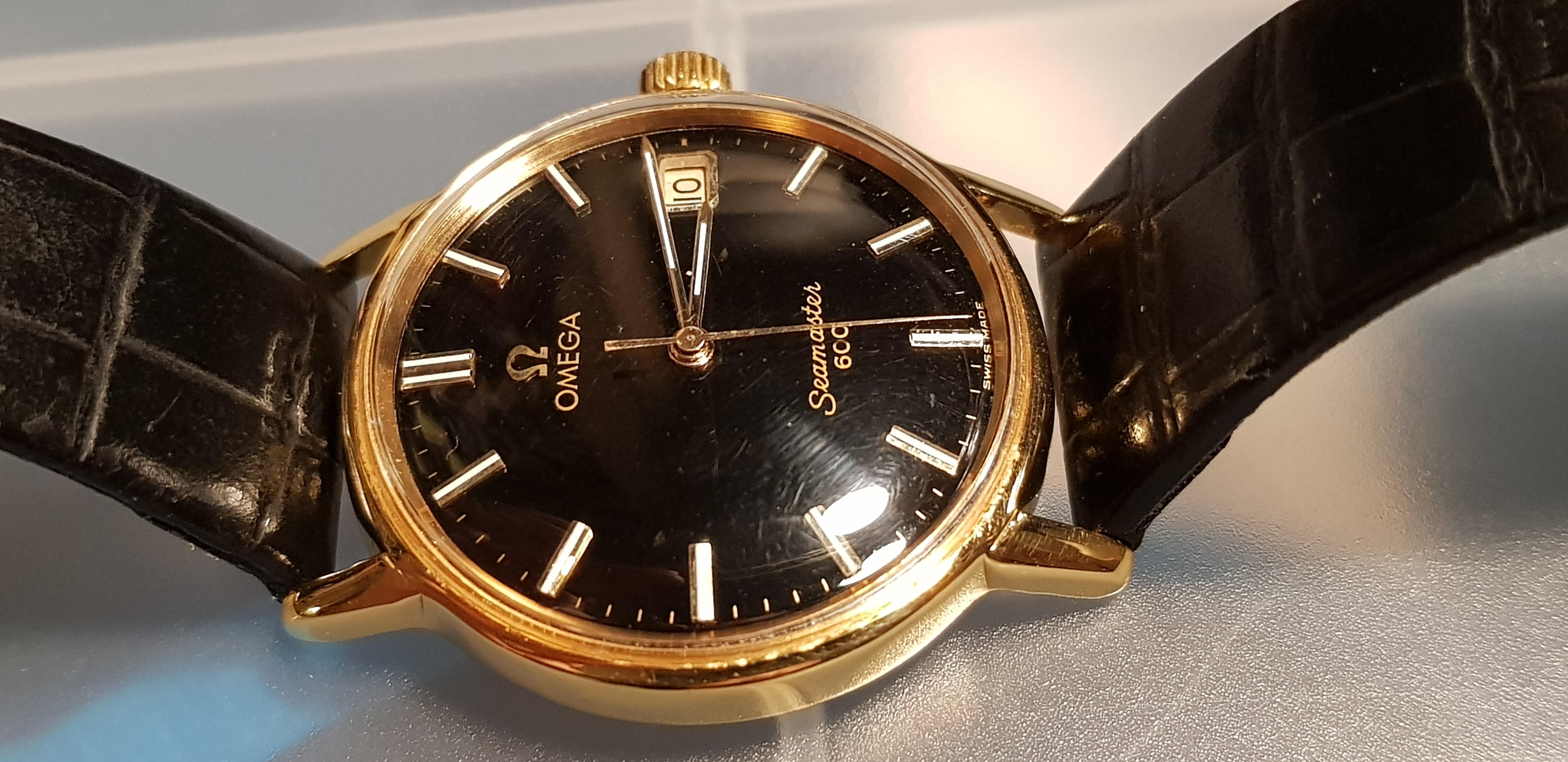

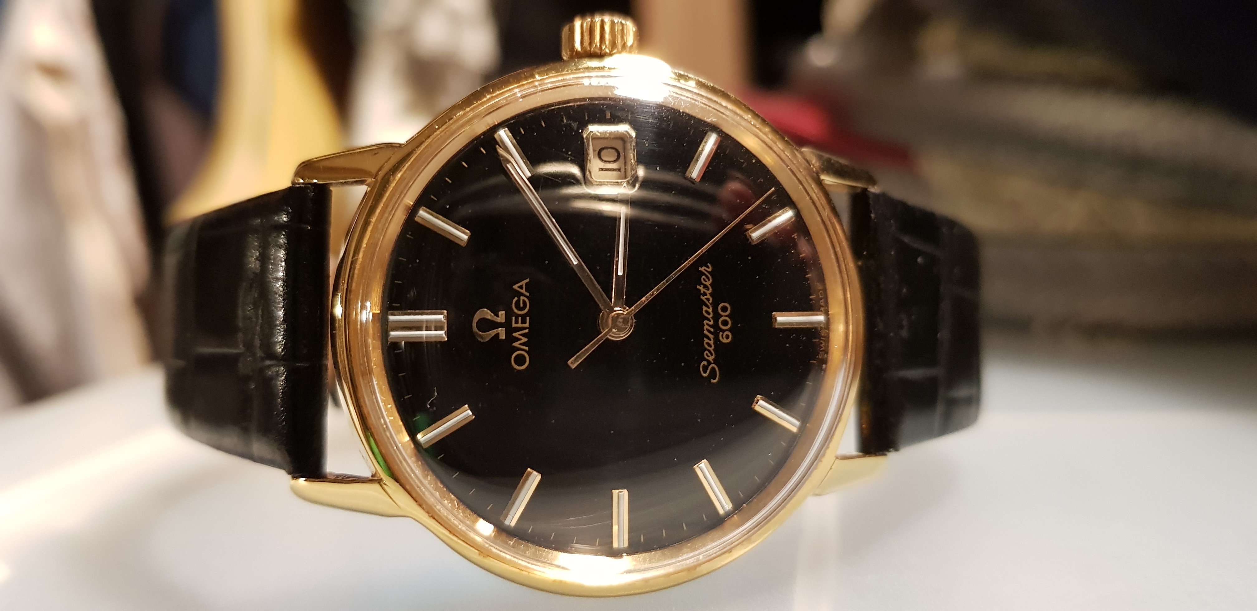

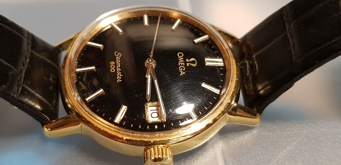

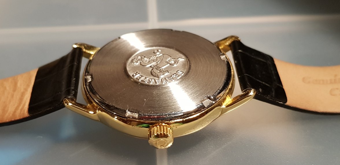

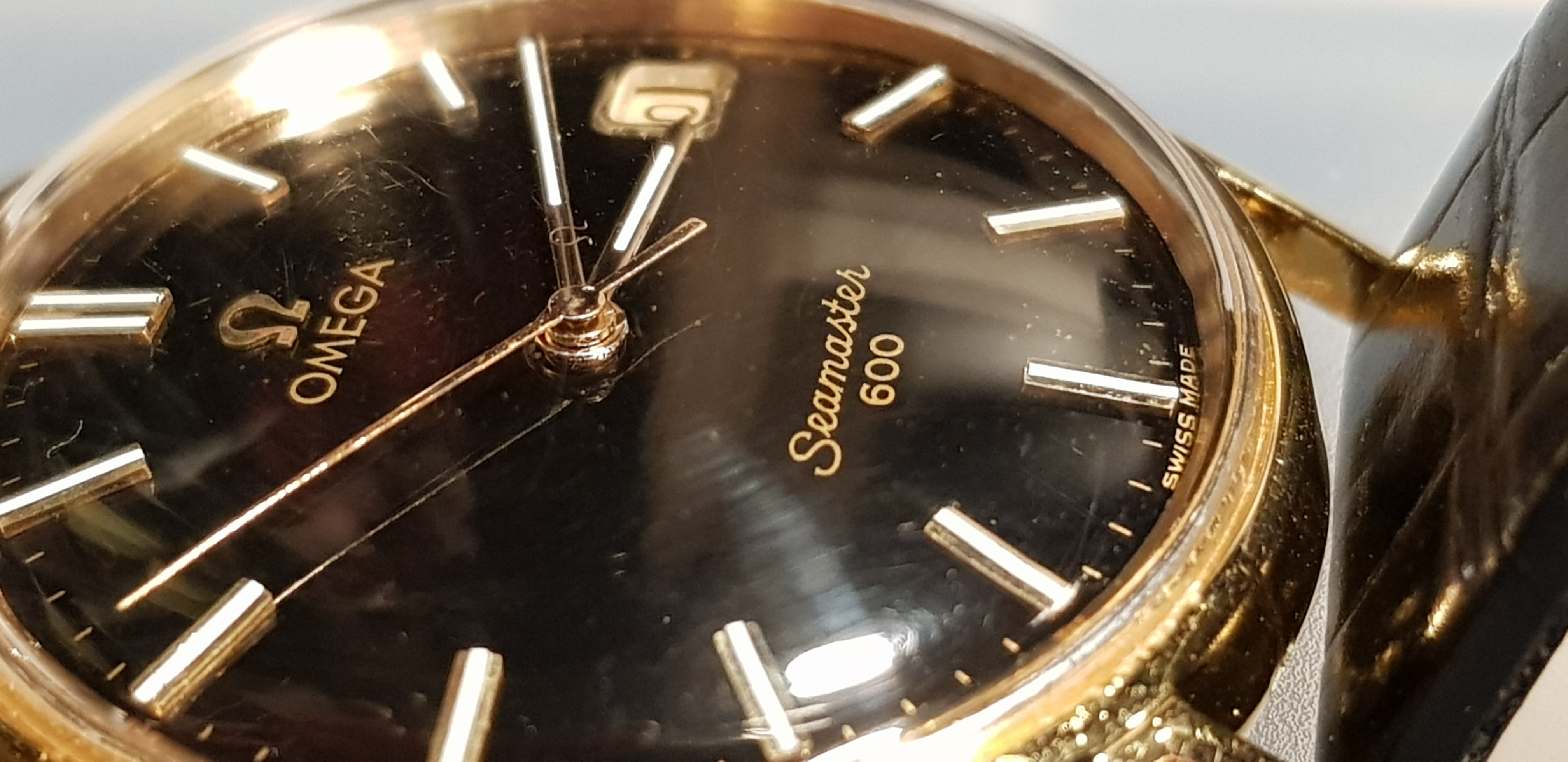

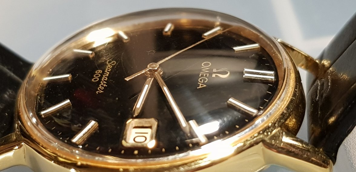

Hi all, would appreciate your opinions on some issues with this watch:
1. This Seamaster 600 dial looks incredibly fresh for a 1960's watch. Does it look suspicious to you? Is it a refurbished dial? If so, how did they get the fonts so perfect?
2. Does anybody know the reference number for this model?
3. Is it supposed to be solid gold (unlikely for this model, according to what I have read in this forum), gold-filled or gold-plated?
Thank you for your insights and opinions 😀

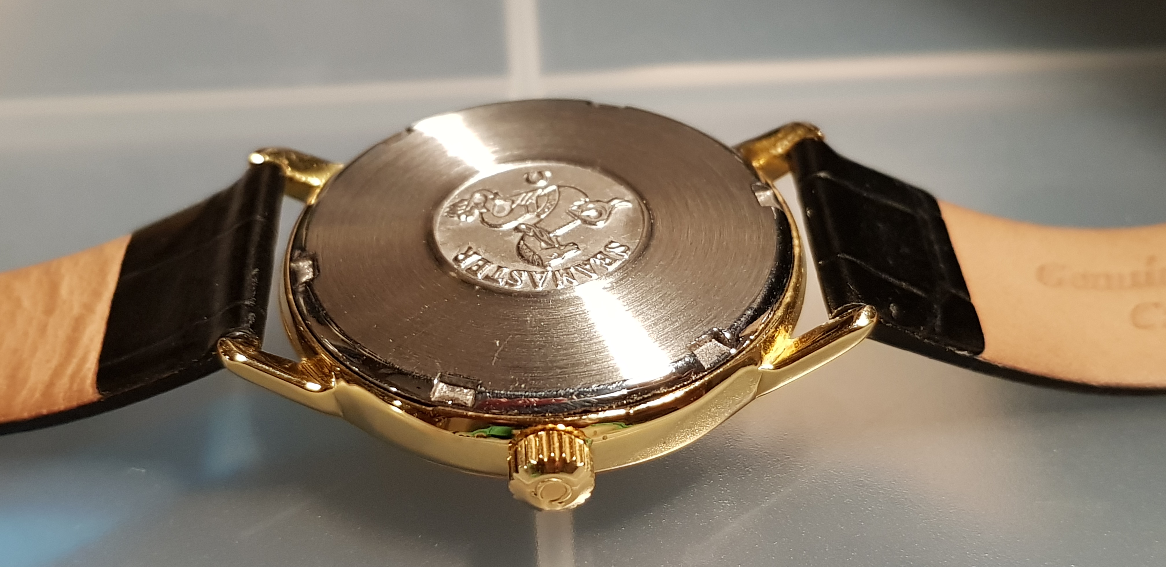

The SS back suggests the case is gold-filled or gold-plated. In my experience, solid gold Omegas (and most watches, actually) usually have gold case-backs as well.

The watch looks like a totally overpolished ref. 136.011 with a refinished dial. I think it has been equipped with a non matching caseback. The crown is most likely a replacement.
I hope you're not intending to buy this watch?

Wow that bad huh. Thanks! 😀

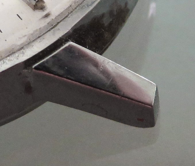

Over-polished piece of shit!
Polished to death and replated to make it look shiny.

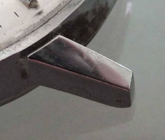

This is what those lugs should look like.

yea I usually don't like to come down too hard on a beginner's posted watch but I gotta agree with my two quoted fellow members. that thing looks like a bondo-ed up NYC taxi cab.

Thank you for your expert opinion and candour. It is truly appreciated. 😀

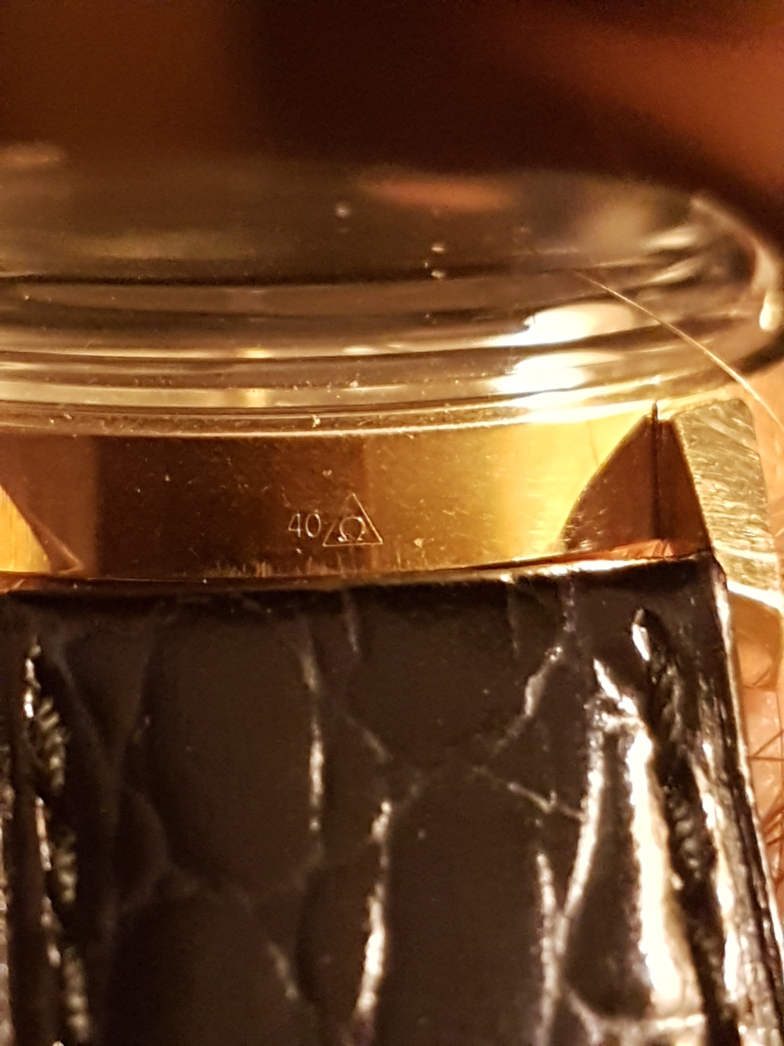

Might be irrelevant if you've decided against the watch - but possibly ask to check for a stamp between the lugs to indicate 40 micron gold plating? Looks to be plated from what I can see.

Have decided against getting it. Thanks guys for the pointers! 😀
