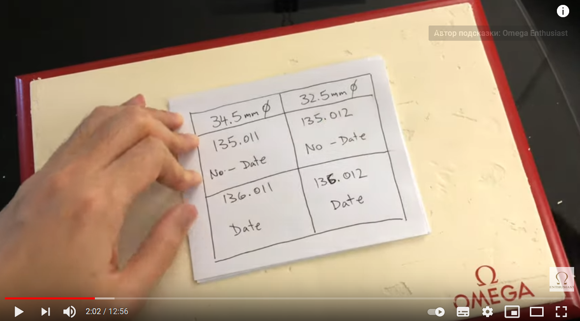

You really should ask the seller. Here is the screenshot from OmegaEnthusiast YouTube video to navigate easier between these Seamaster 600 models.
