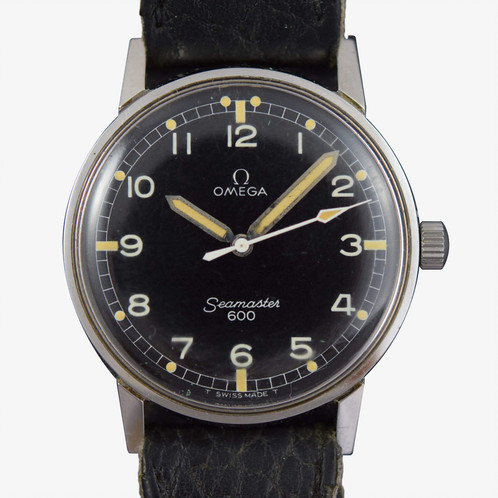

I’ve identified 15 examples with this dial type so far. This included;

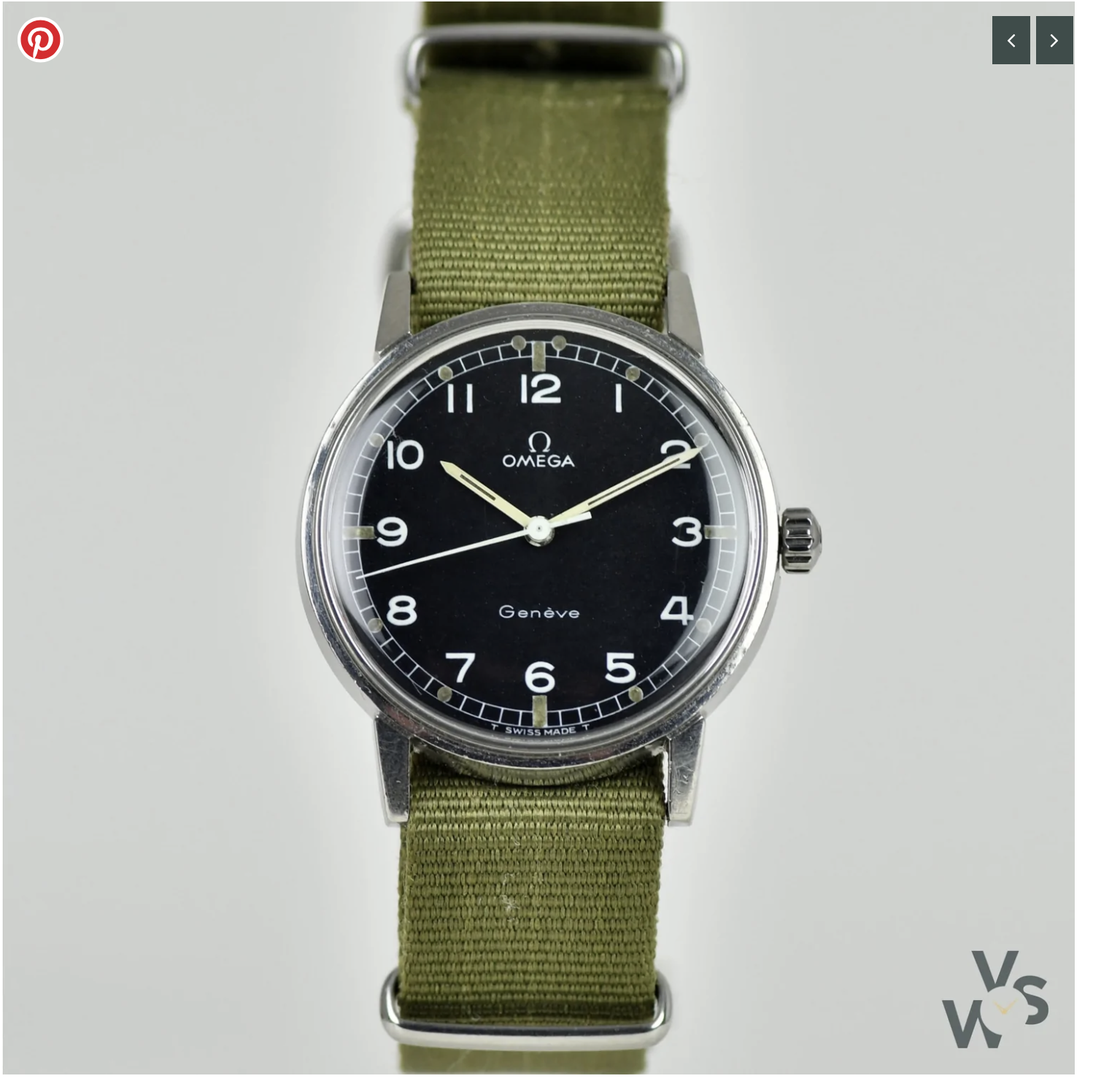

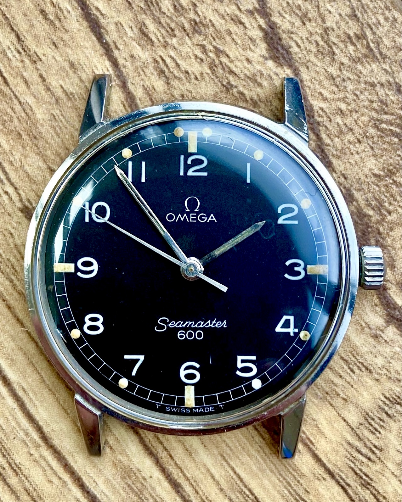

9 Seamaster 600’s (ref 135.011),

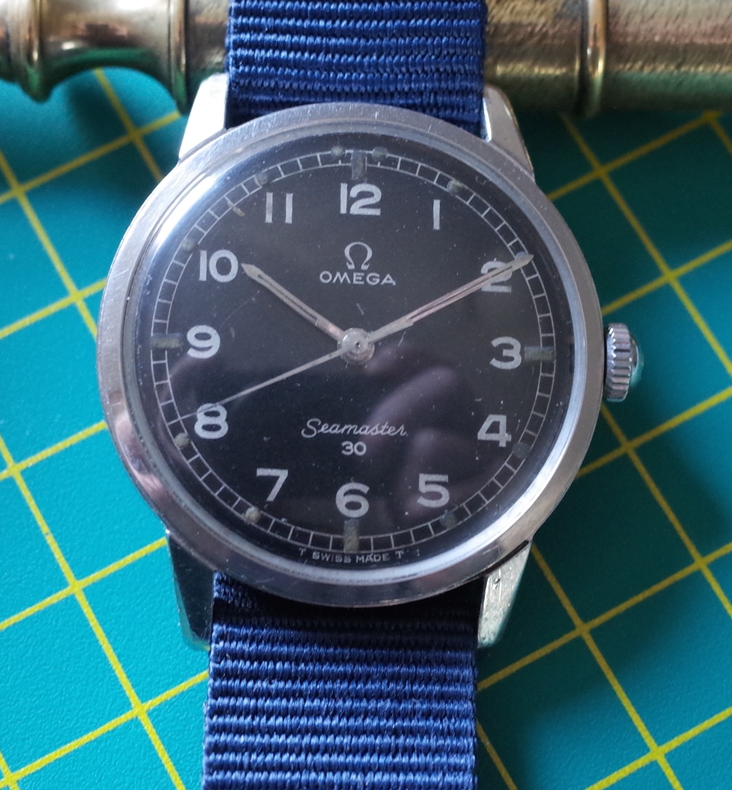

5 Seamaster 30’s (135.007),
1 Geneve (135.011 same ref as the Seamaster 600).
Dials
As can be seen from the picture below, the dials have the following attributes;
Matte black body,
Painted white Omega logo,
White Arabic hour numerals,
Rail track minute track,
T Swiss Made T at 6 o’clock,
Applied tritium lume at each hour marker, hash marks at 3, 6 and 9, a hash with two dots at 12 and single dots at the remaining markers.
The dials are constant whether it’s a 600, 30 or Geneve. The only difference being the white text denoting the model at 6 o’clock.

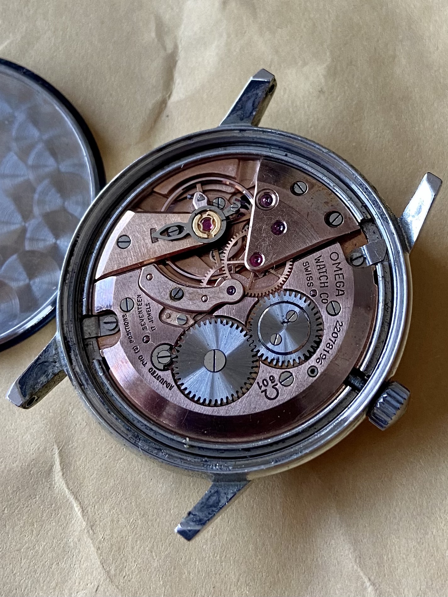

Movements
All movements appear to be manual and without date. I haven’t found a single example of this dial with the date feature.
Seamaster 30 - cal 286. Serial range appears to be 20,77xxxx (2 examples) and 21,35xxxx (3 examples).
Seamaster 600 and Geneve - cal 601. Serial range appears to be 22,07xxxx (5 examples) and 26,1xxxxx (2 examples). I was unable to identify the serial number of 2 examples.
Hands
There are two distinct hand types associated with these dials. Stick and baton (with Speedmaster style seconds hand); both of which are lumed. There doesn’t appear to be any association with serial numbers to identify a change over point between the two as both types are seen on across serial ranges.
I can say that the baton type seems to appear later (and then run concurrently with the stick type) as I observed no baton hands on the earlier Seamaster 30’s.

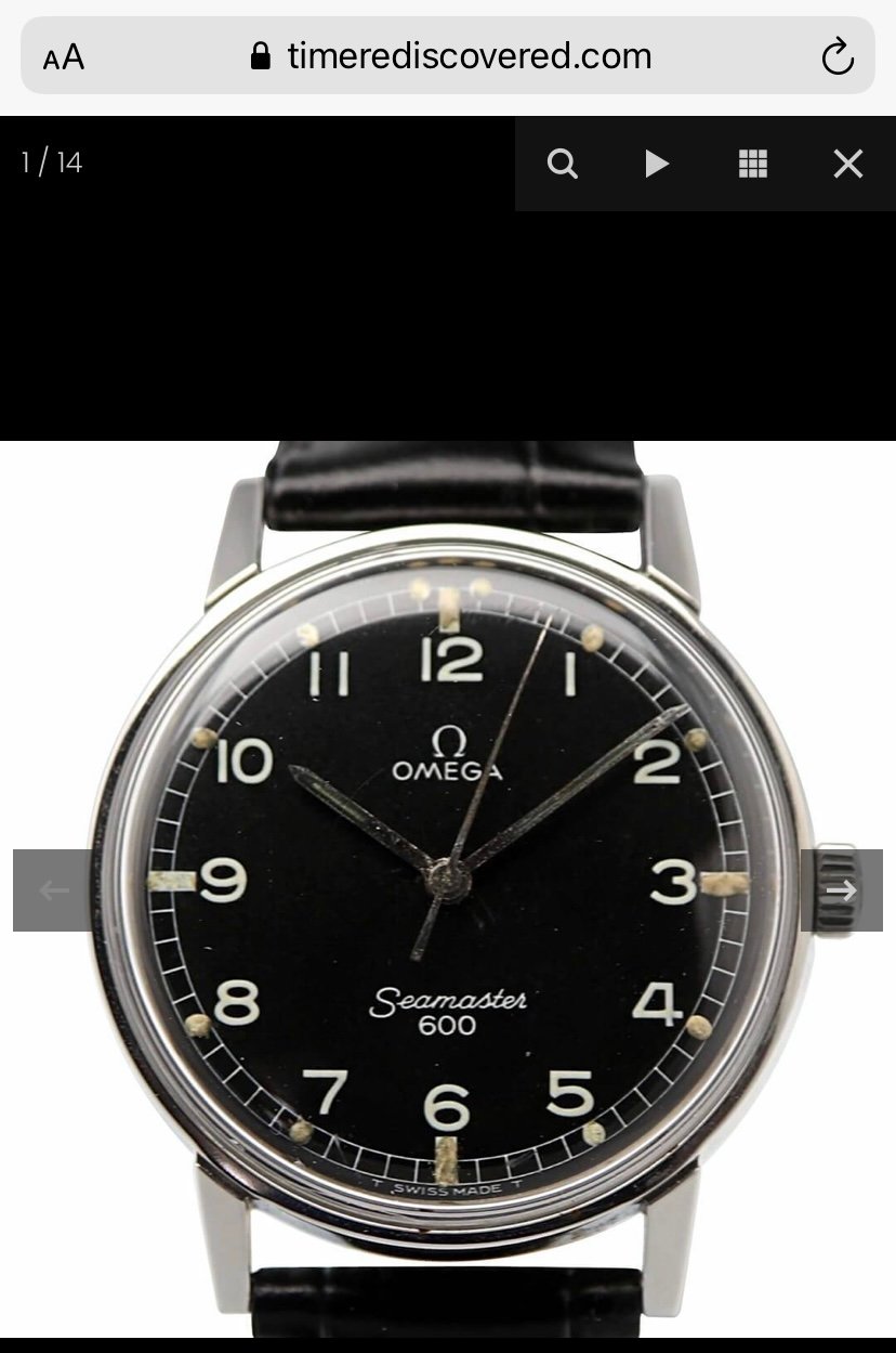

Stick hands. Credit: timerediscovered.com

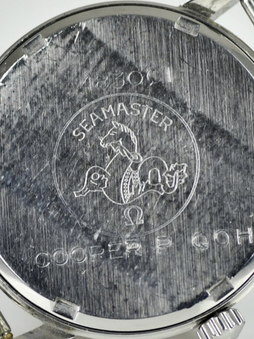

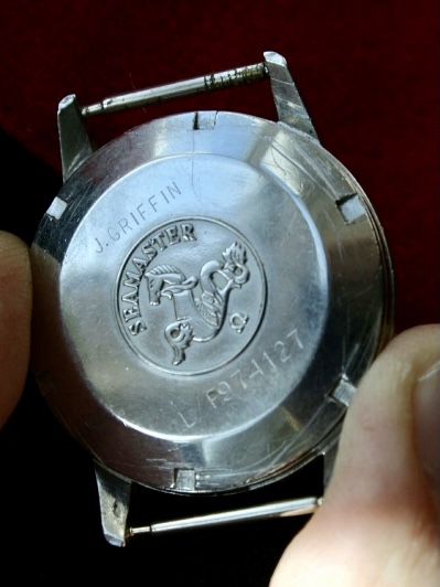

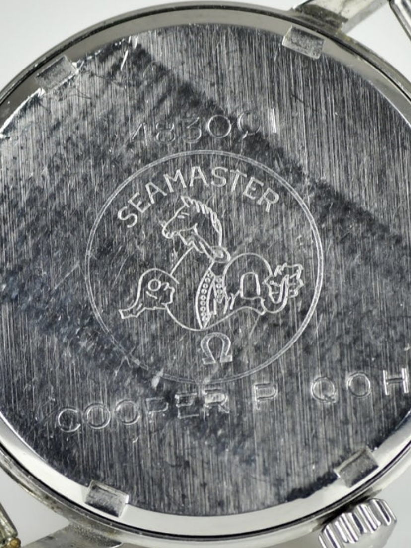

Interestingly a significant number of these appear to have names and numbers engraved on the caseback. Out of the 15 examples I’ve found, 9 had a name and number engraved. Of the 6 that did not, 2 had caseback a that appeared to have been polished to remove an engraving.
Credit: vintagewatchspecialist.com
Credit: corevintagewatches.com
If you’ve made it this far, thanks for reading. I’m intrigued by these dials as 1) they’re quite uncommon, 2) they’re great looking, and 3) I wonder if they were some kind of special order due to the apparent tight serial ranges and the fact that so many appear to have engraved casebacks with some kind of ID number. I’ll shortly apply for an extract for mine to see if the delivery location and notes shed any light.

Finally, beware when considering purchasing watches with these dials. The black colour and style are ripe for redialers, so make sure you’re looking at an original dial.

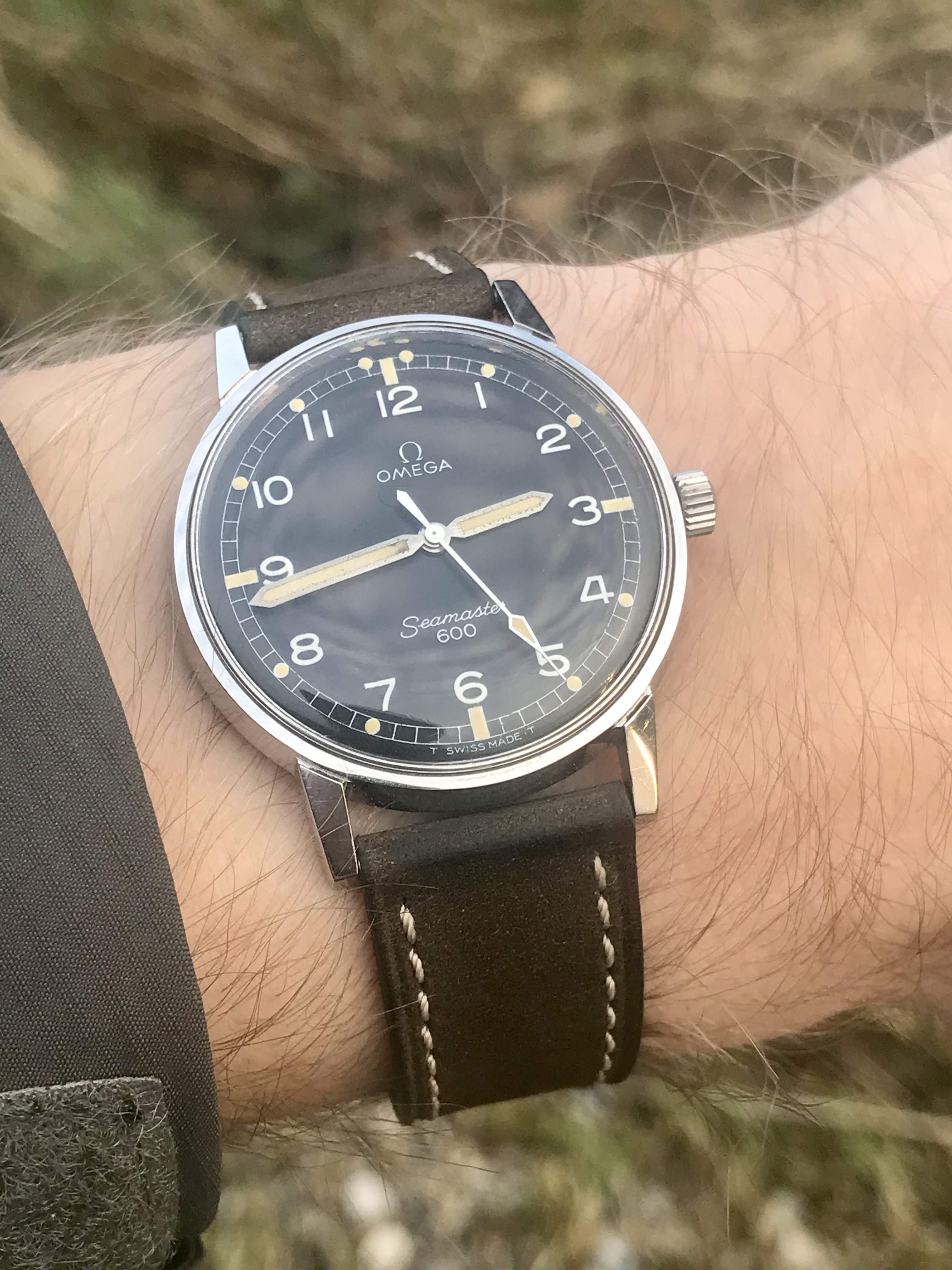

Baton Hands. Credit: @Nla91

Interestingly a significant number of these appear to have names and numbers engraved on the caseback. Out of the 14 examples I’ve found, 9 had a name and number engraved. Of the 5 that did not, 2 had caseback a that appeared to have been polished to remove an engraving.

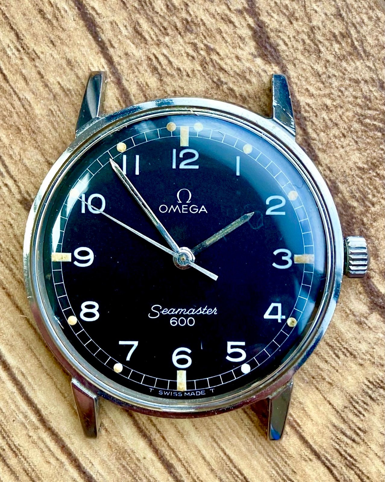

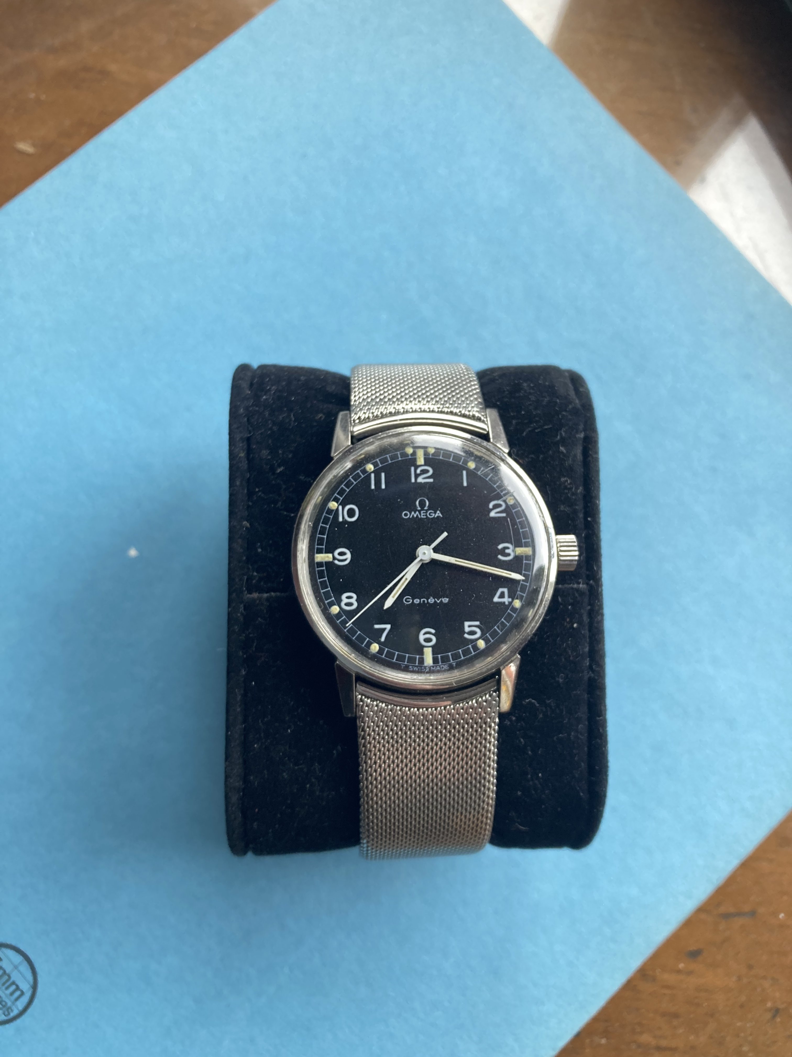

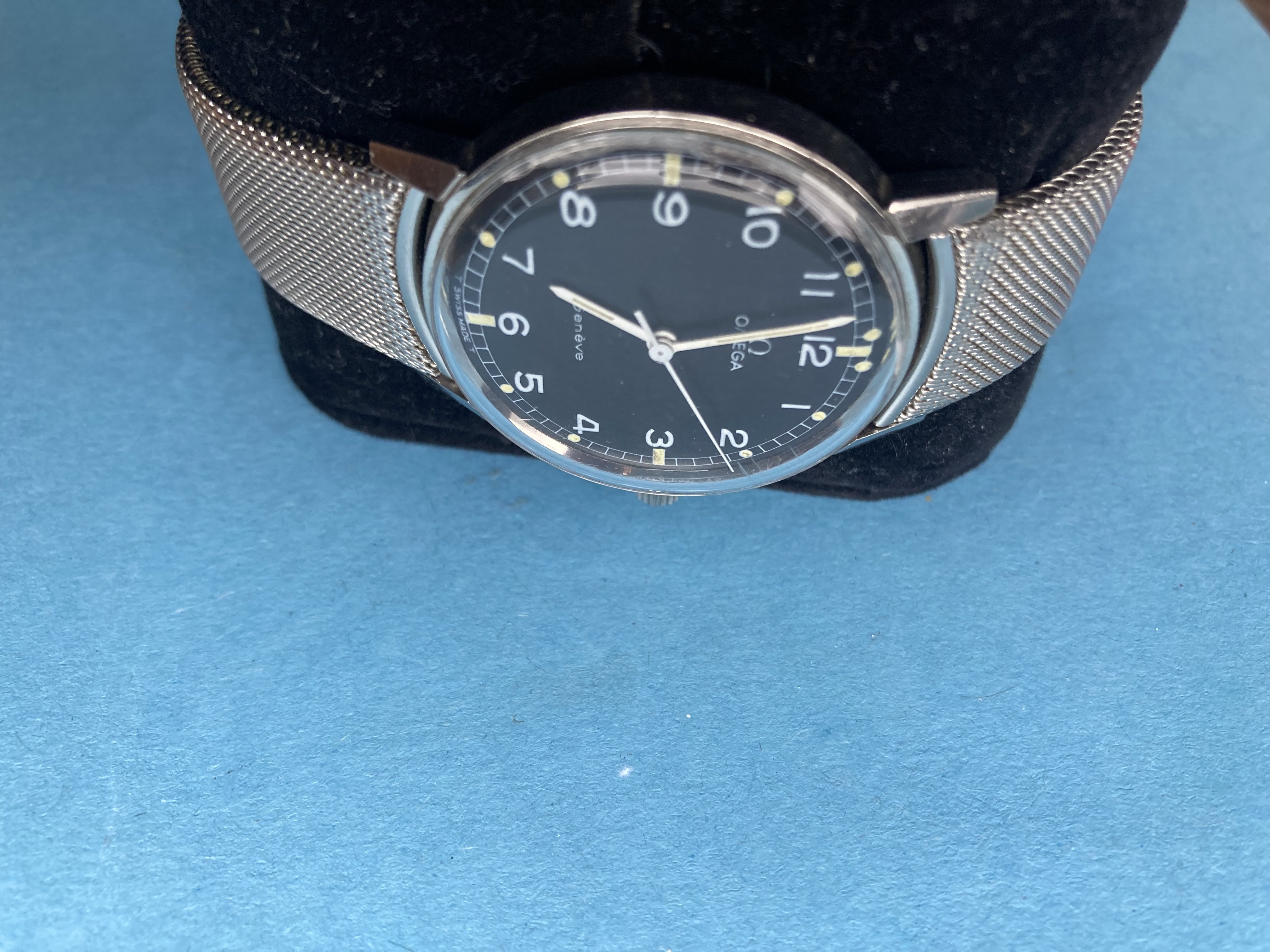

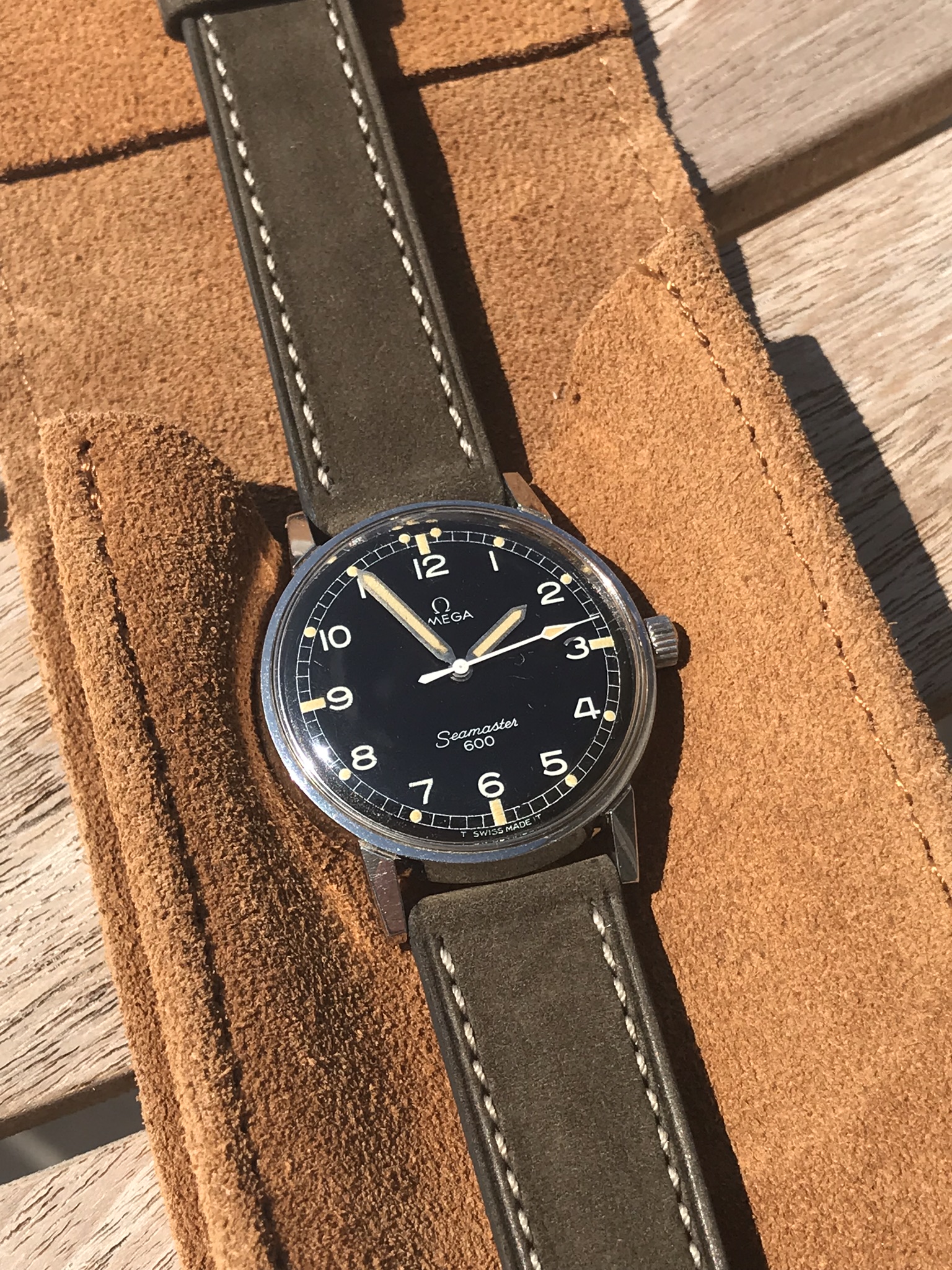

Yes cool research David!

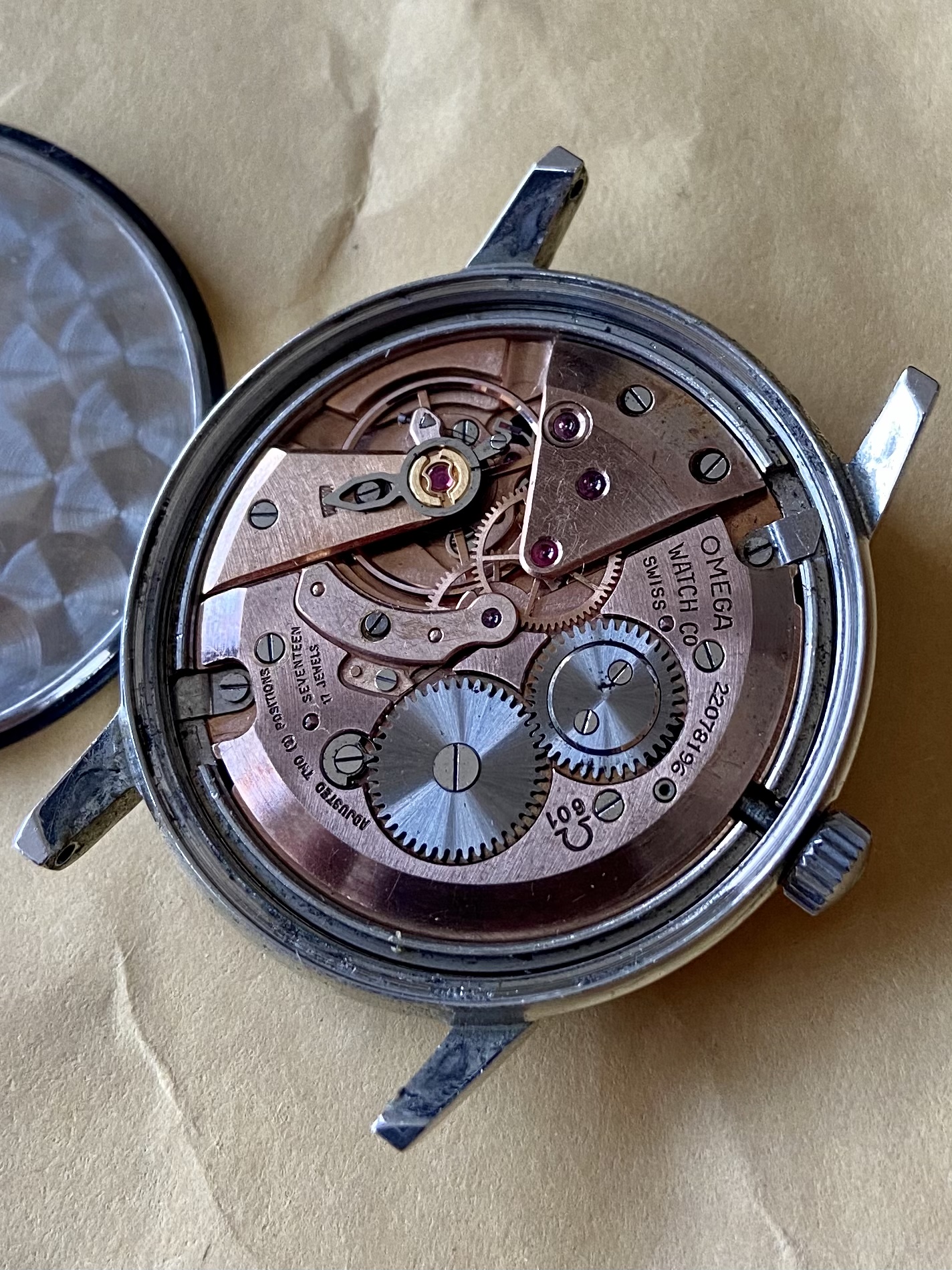

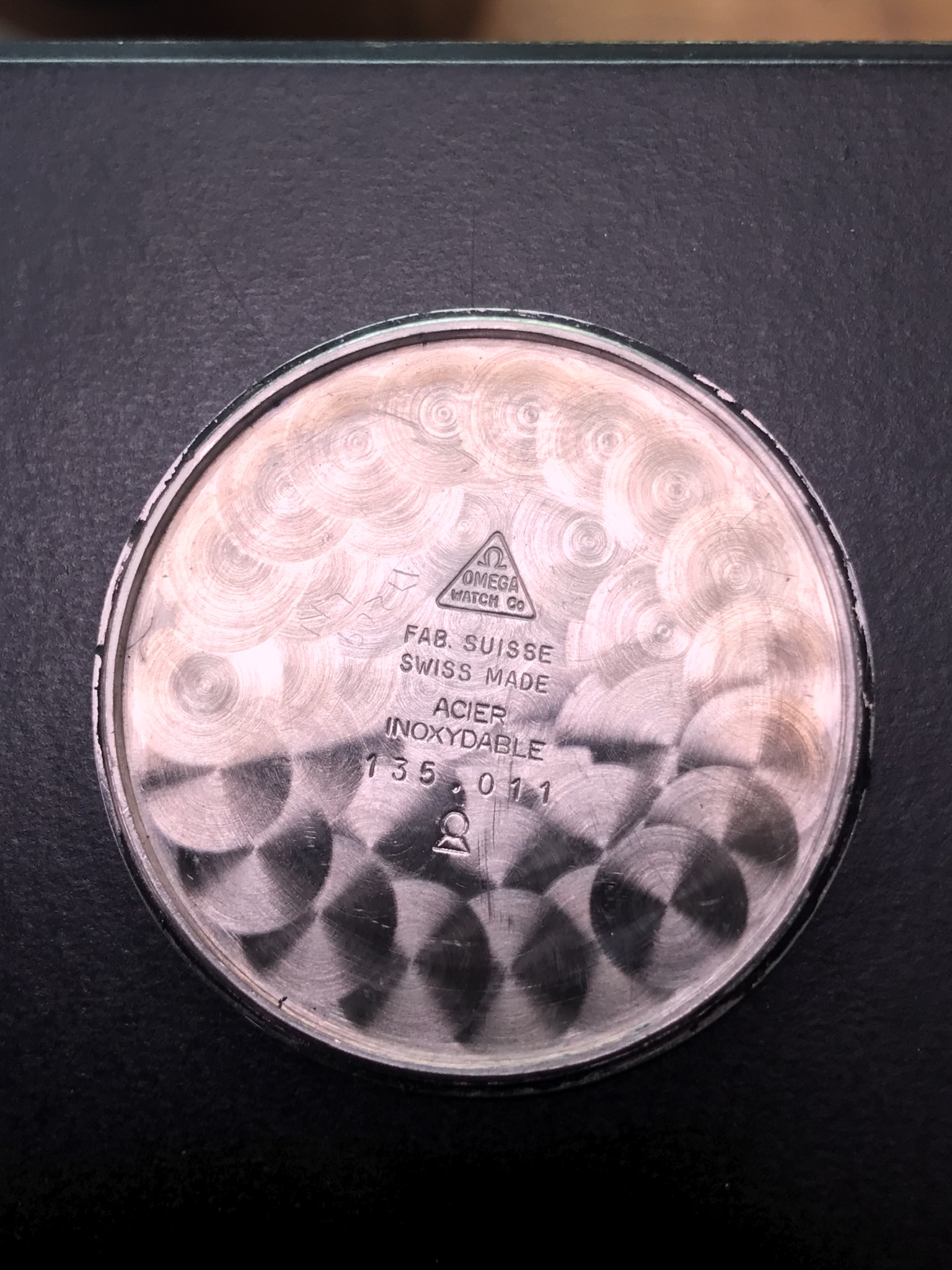

I own this 135.011 with serial 22.07.xxxx
No caseback engraving and looks unpolished.
I have no info about the history to the watch but it looks like a pretty honest example with little use.
I’m planning to order an extract in the near future.

Excellent, many thanks @Nla91.
Post now updated to reflect your watches info. This adds further evidence that there was a batch of this dial issued with 22,07xxxx serials as we now have 5 in that range from a sample size of 9.

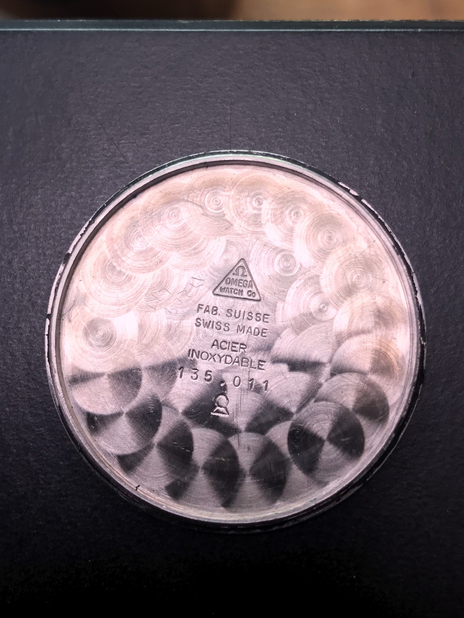

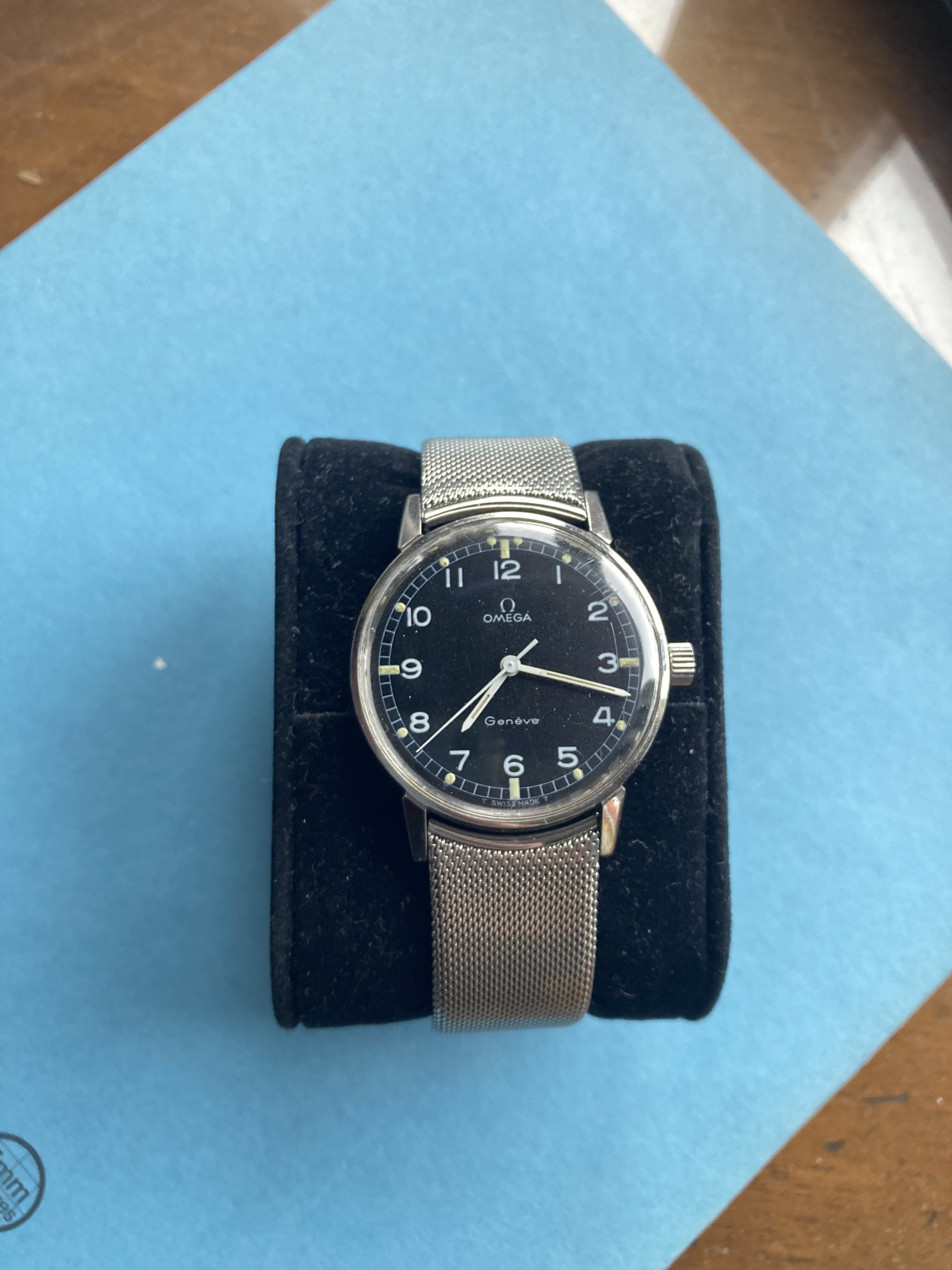

Just scored an absolute mint one, that is a ref 135.011. Have you identified this ref yet? Listing described it as a Geneve, but this example posted by Craft + Tailored calls it a Seamaster 600. It has a 601 movement inside, will post more pics once I receive.
Reference: https://www.craftandtailored.com/products/1966-omega-seamaster-600-ref-135-011-black-dial
Your fingers were a fraction of a second faster than mine- it went to ended as I was trying to buy it. This would fall more under the technical dialed than the military style. Check out the 600 thread for more like this, and I beleive there was another thread on technical dials specifically.

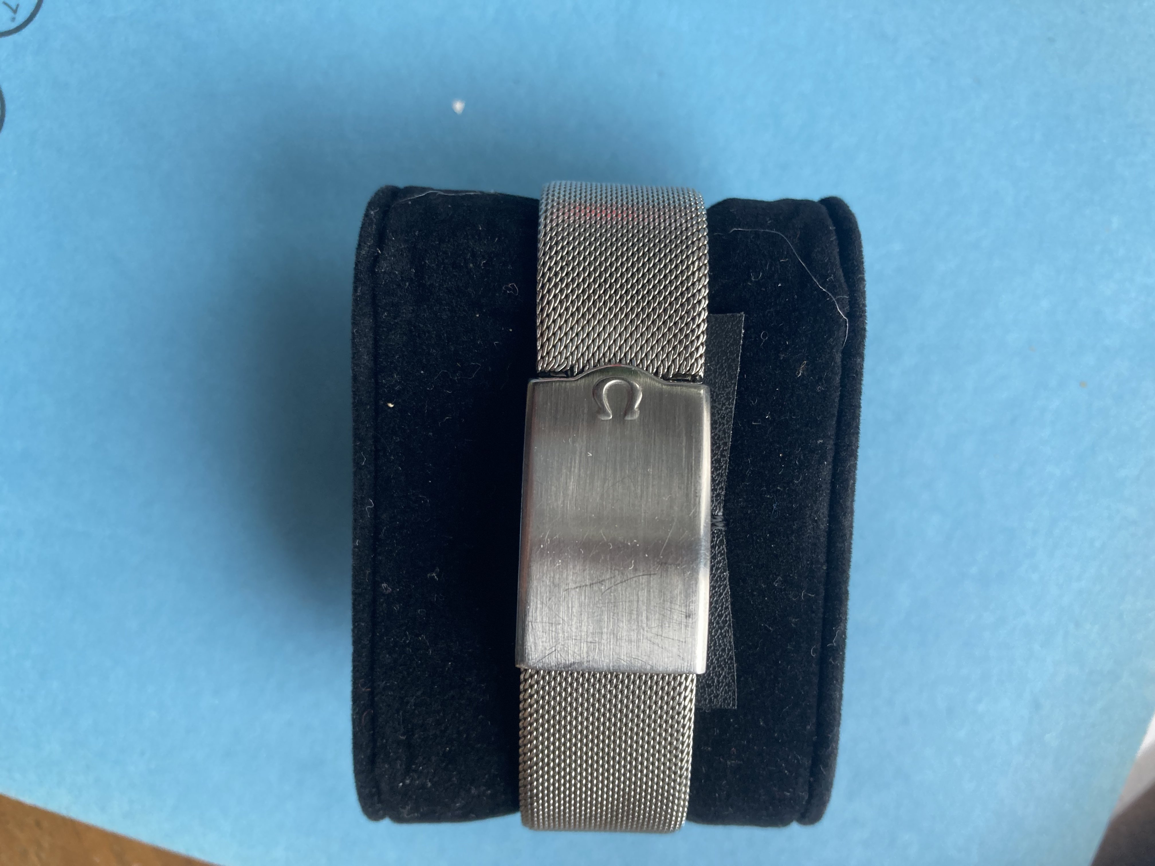

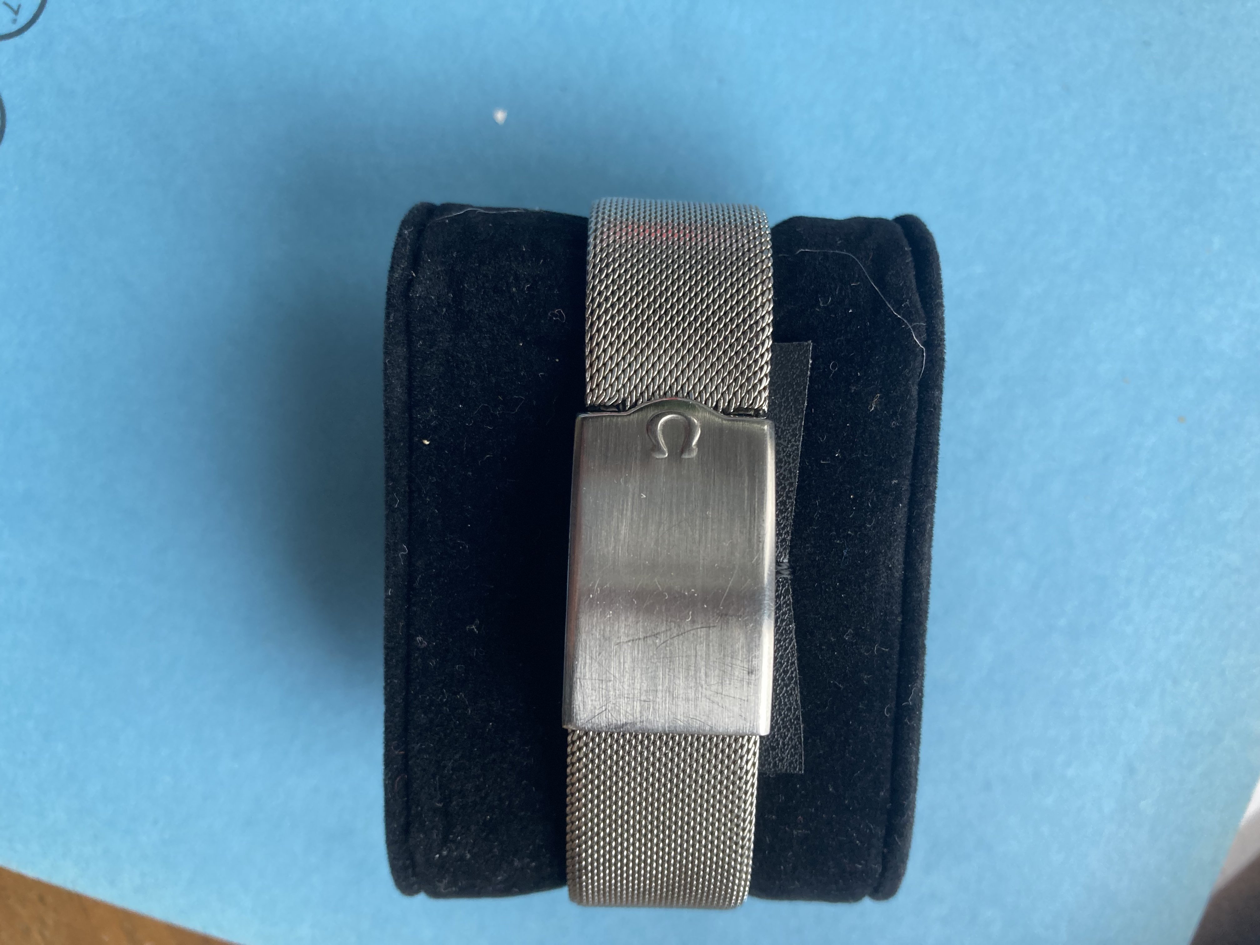

Got something here - often wondered too. Put it on a ds&s bracelet which was as hard to find as the watch. Has the Seamaster logo on the back
13,532
23,475
Have you got a picture?
10,757
16,747
I have that bracelet, it's quite rare. Known as Shackman 1501 or 1552 I believe, It was made under licence in London so wears the Omega marked clasp legitimately. Mine came on a steel Connie. They have 2 locating tabs on the back which are usually broken off as they are very fragile.

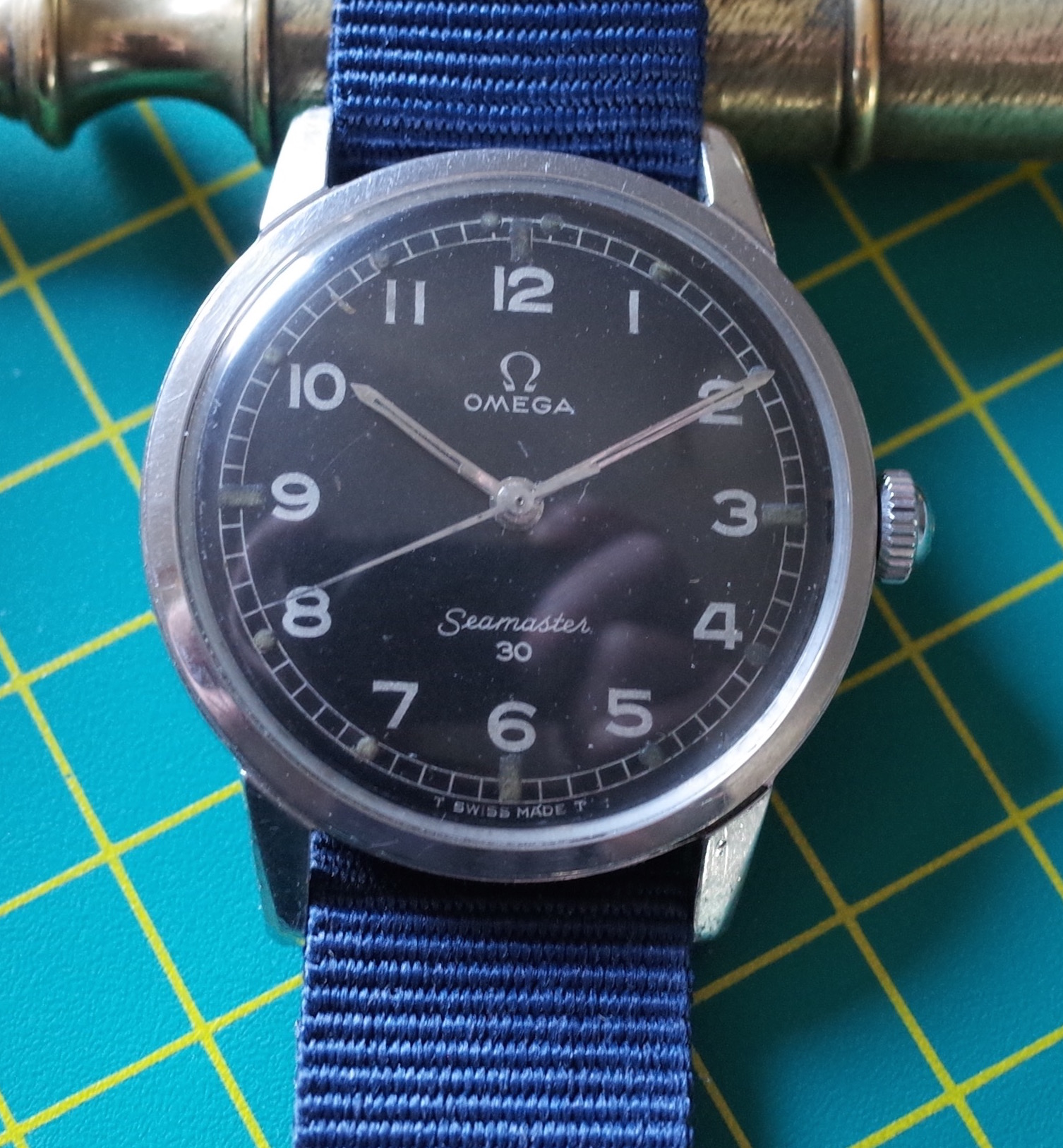

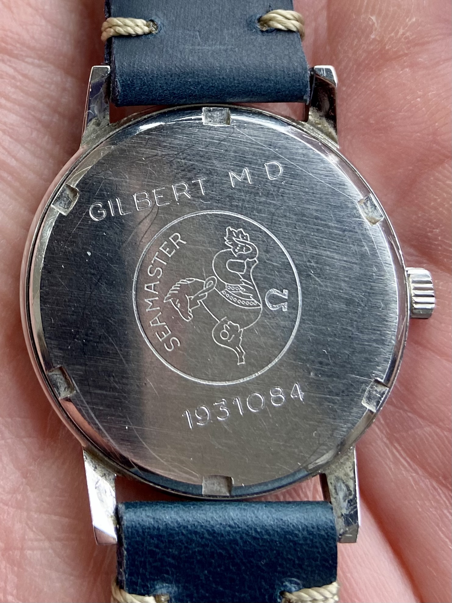

Nice research David. I used to have a Seamaster 30 with an enlisted chaps name self inscribed on the back, passed it on a few years ago.
Ref 135.007-64
mvt cal 286 - 21351917
13,532
23,475
Ref 135.007-64
Thanks @size11s ill update my database.
Interesting that yours also had an inscription on the caseback. Makes me wonder if these were issued or perhaps bought in bulk by the stores.

I think I have a Shackman Milanese in my drawer so will try it on mine. That combination has never occurred to me.
