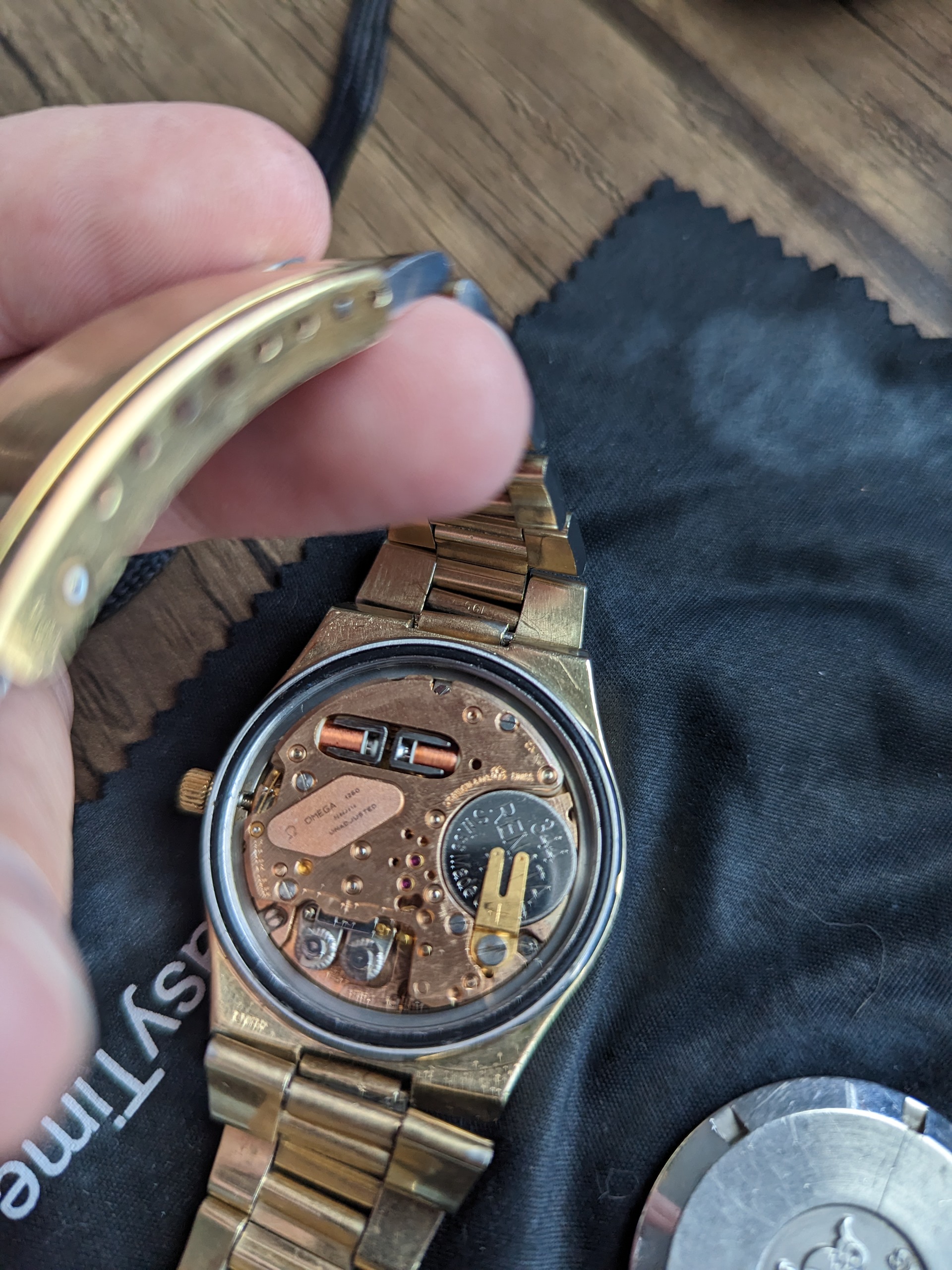

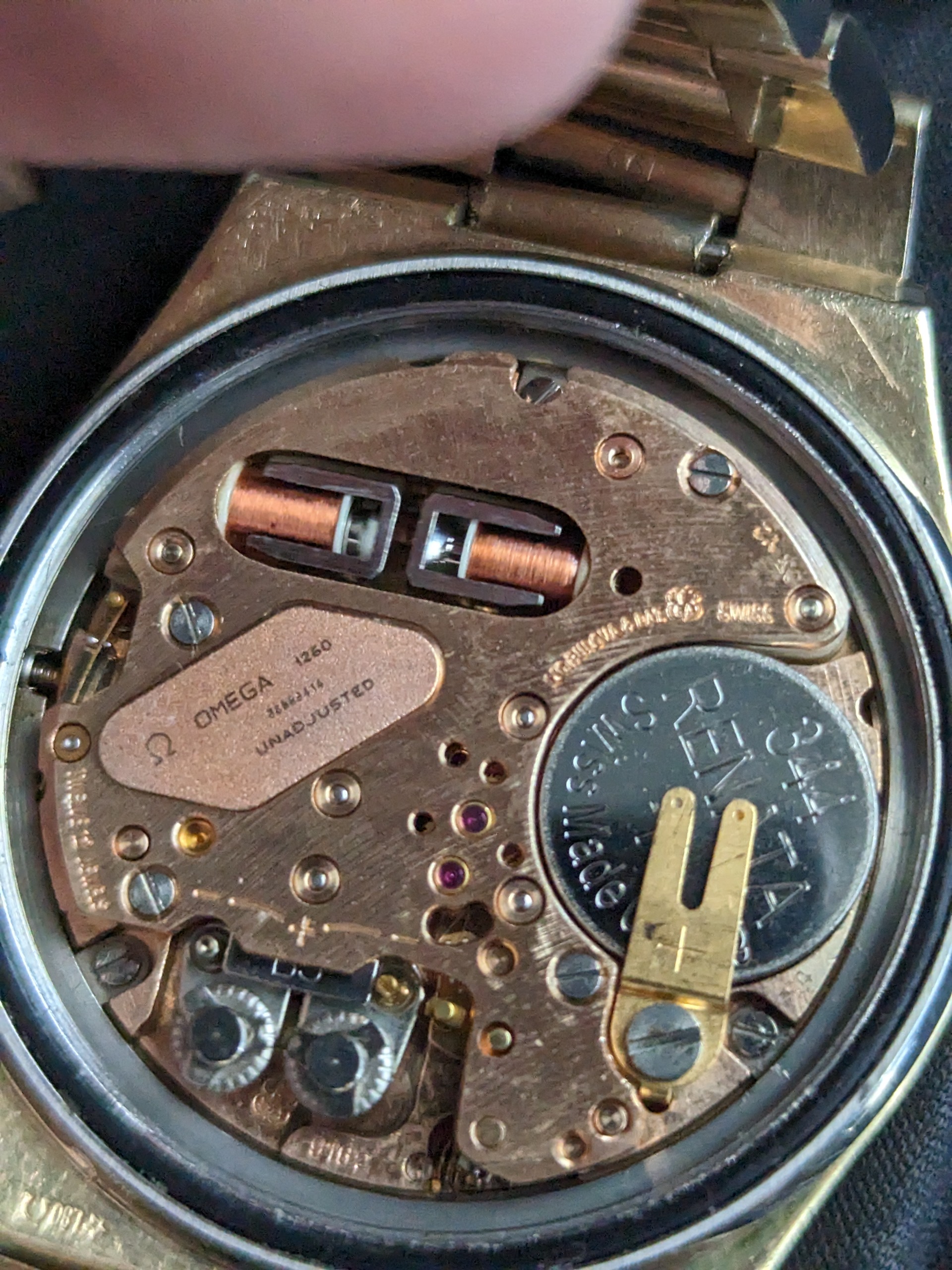

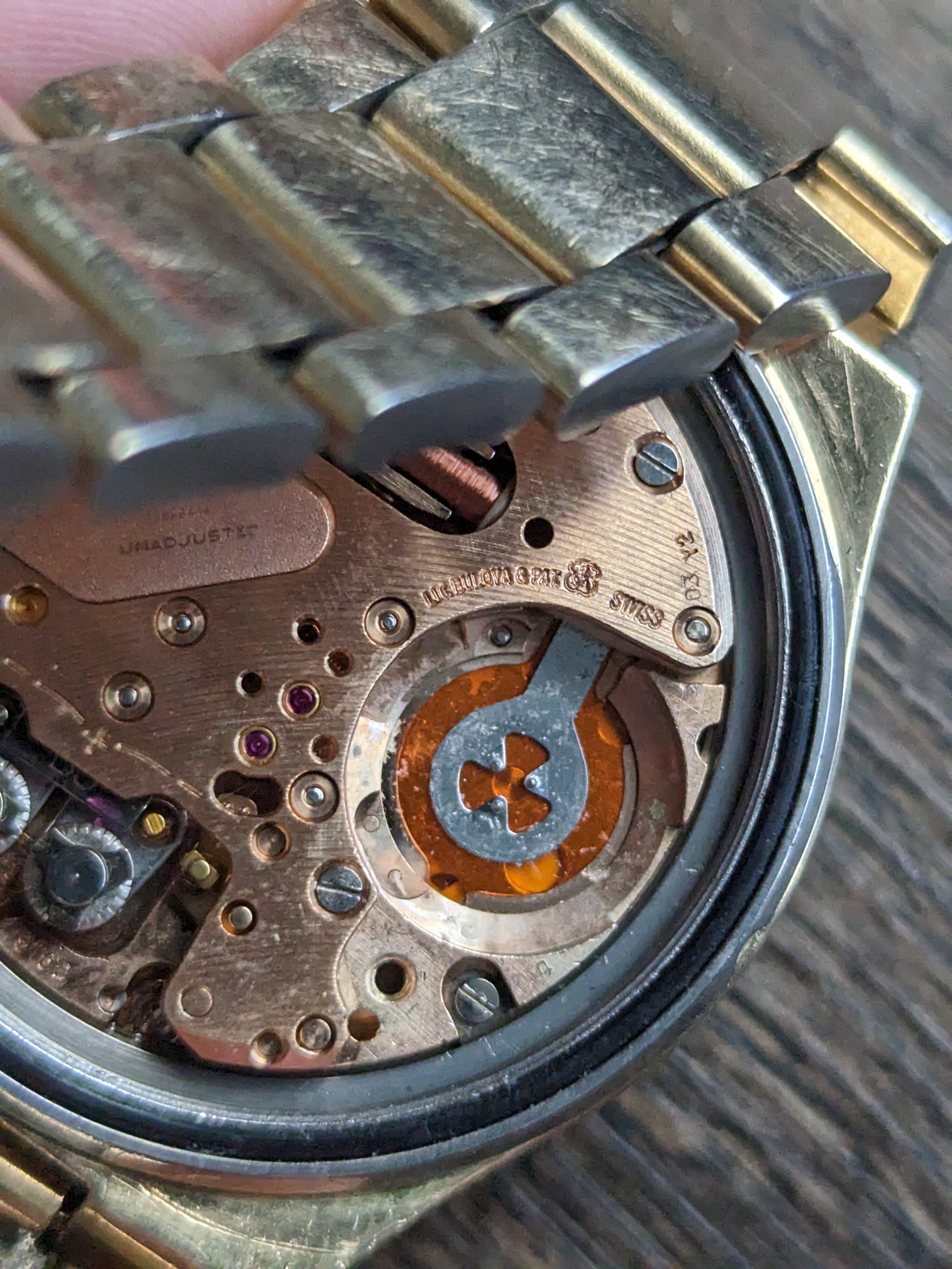

Hello I have a seamaster 300hz that's not working. When I opened it up I saw it had a renata 386 not the 344 and I was worried it short circuited or the battery leaked.
I replaced with 344 and no new movement.
How do I figure out how to fix this and/or what's wrong?
Thanks for your help I inherited it from my father and I'd love for it to be ticking again
I've added some photos

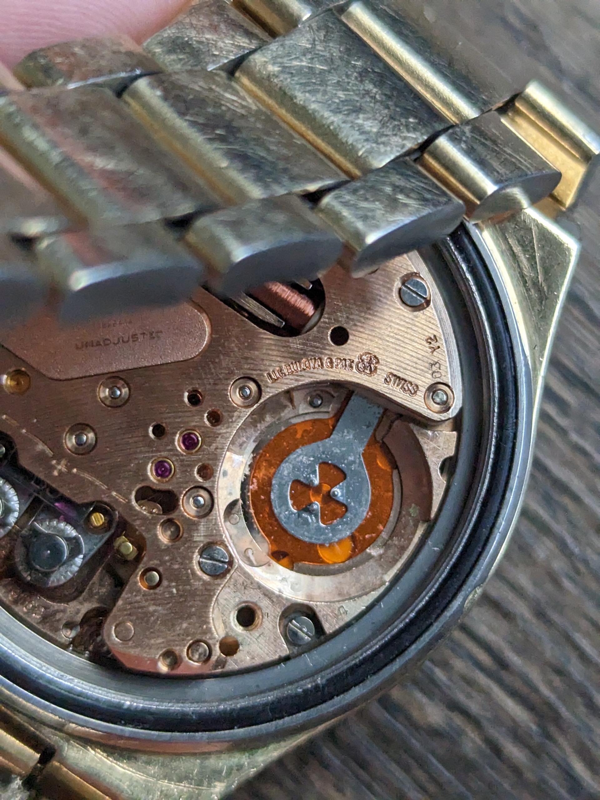

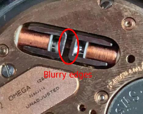

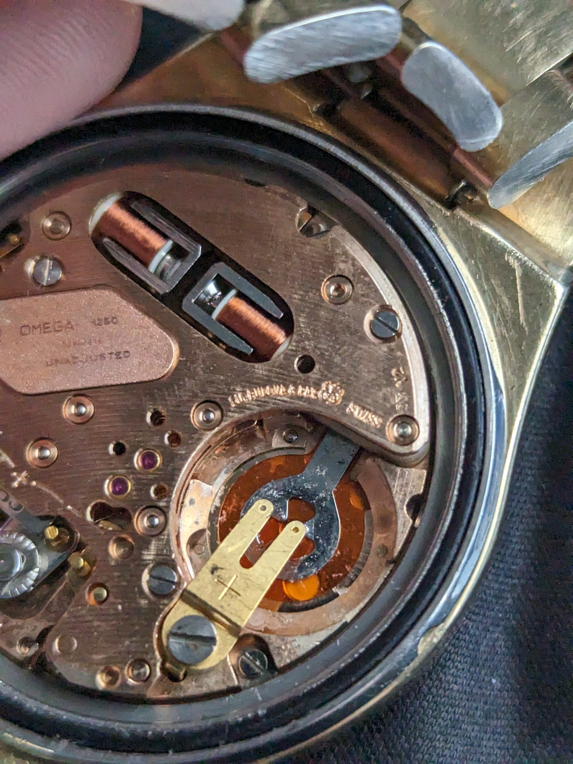

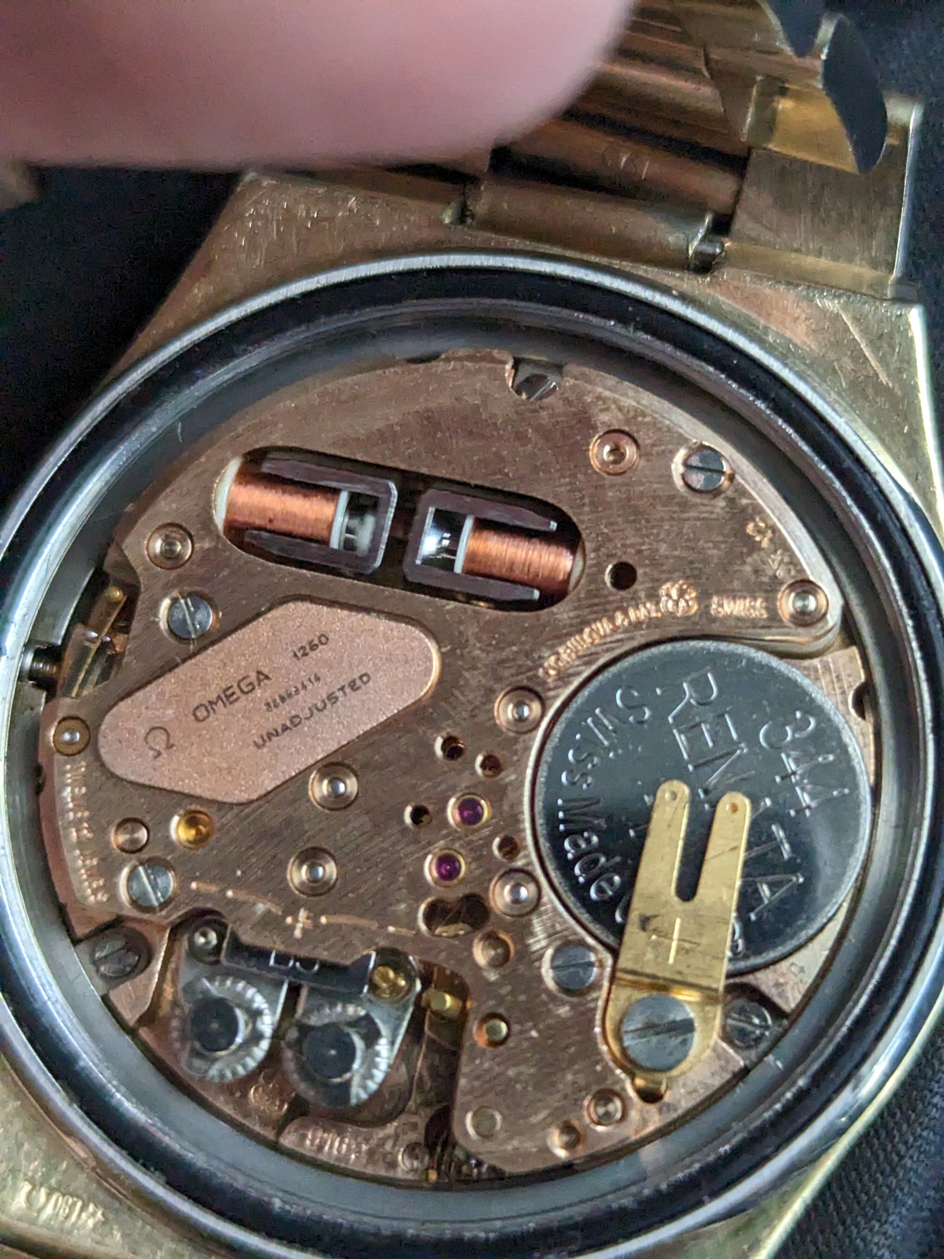

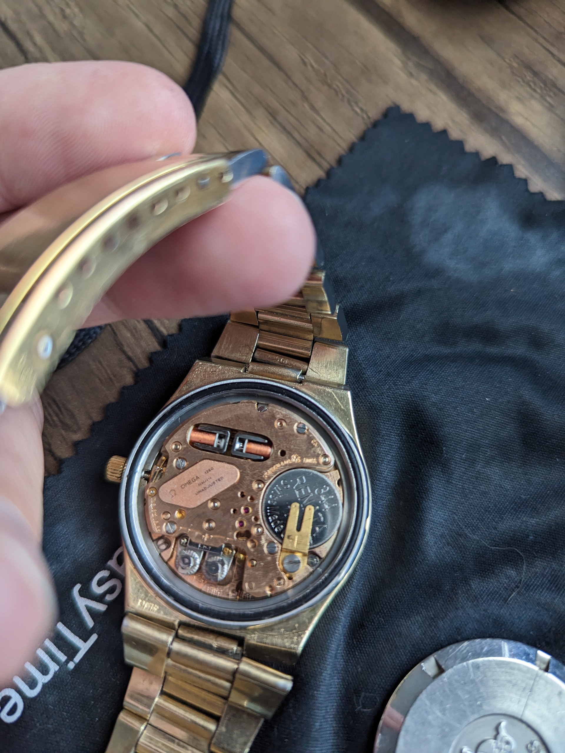

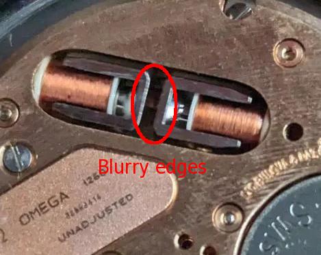

You should hear a humming sound if you get your ear near to the watch, and from the 3rd photo you show, the tuning fork looks to be humming. If it's humming but the hands don't move, then something is likely wrong in the index mechanism.

How can you tell it's humming from the photo?
He may think the tuning forks look blurry in the photo at magnification implying movement?

As Bruce235 said, you can tell from the motion blur cause by the vibration of the fork. Comparing the 2nd and 3rd photo, you'll see it. It's not always reliable of course.
