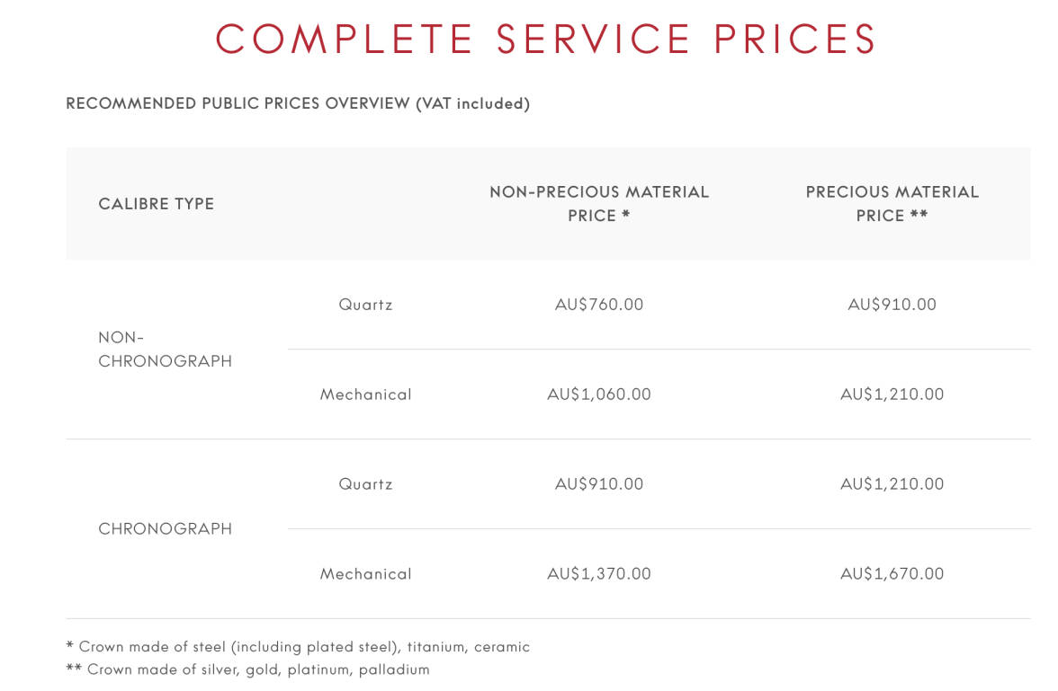

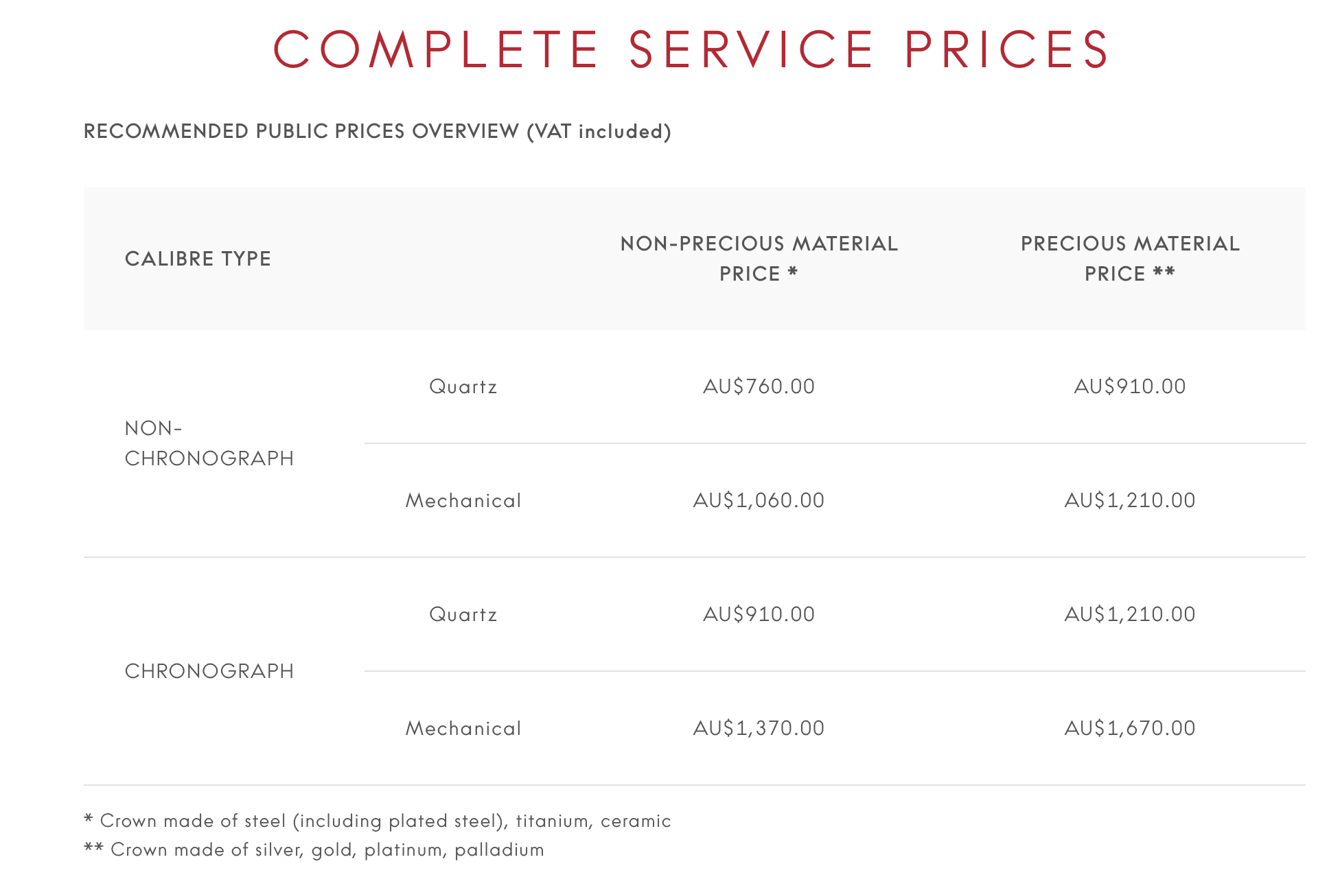

An Omega full service for a quartz watch should be about NZD$870 (Edit: Anout NZD$820).
I would expect them to replace the circuit if it's failed as part of the service. If they charge, it will be cheaper that "some bloke's price".
See the Aussie equivalent prices.
Thanks so much for your advice both. I'll contact partridges in Auckland they are official omega sellers. 800 serviced and fixed seems more like it
