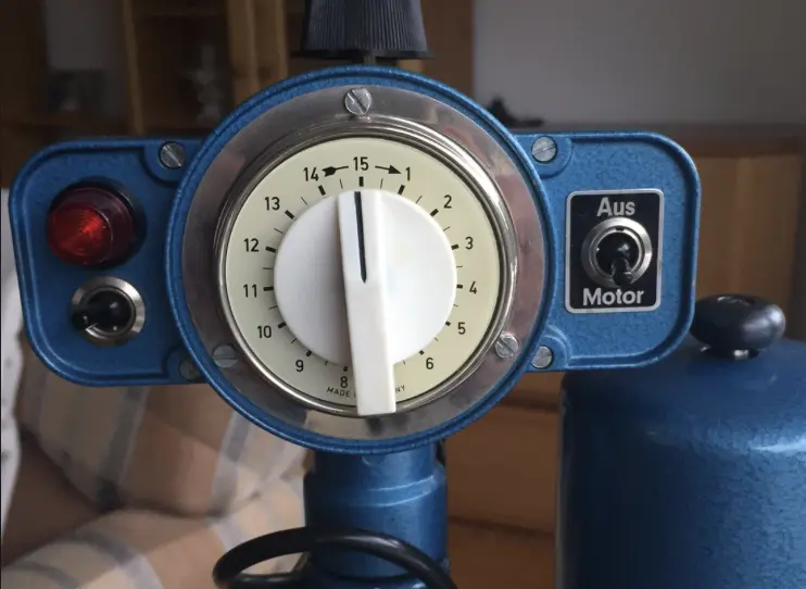

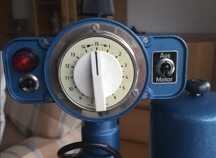

Does your machine look like this?
215
248

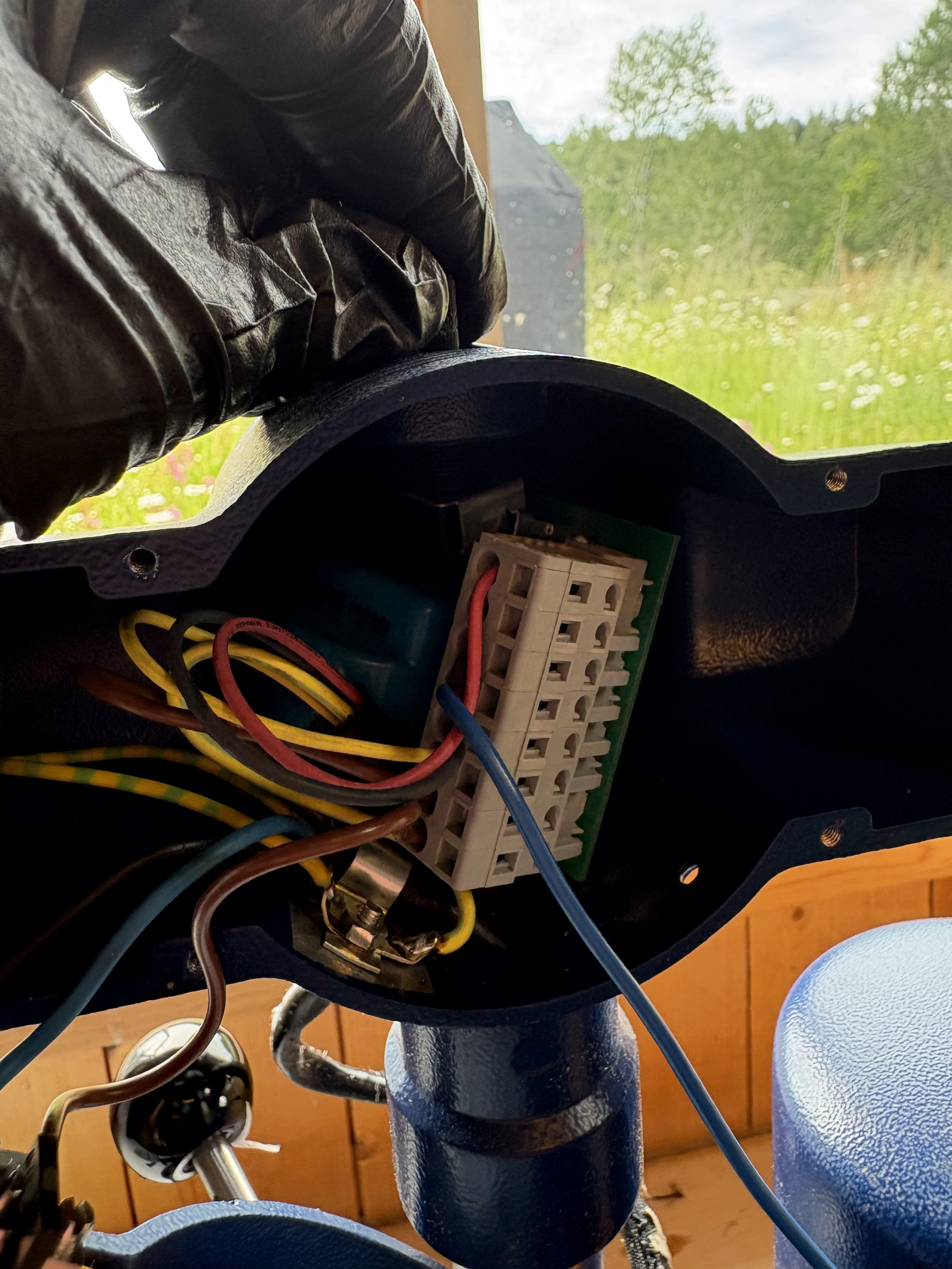

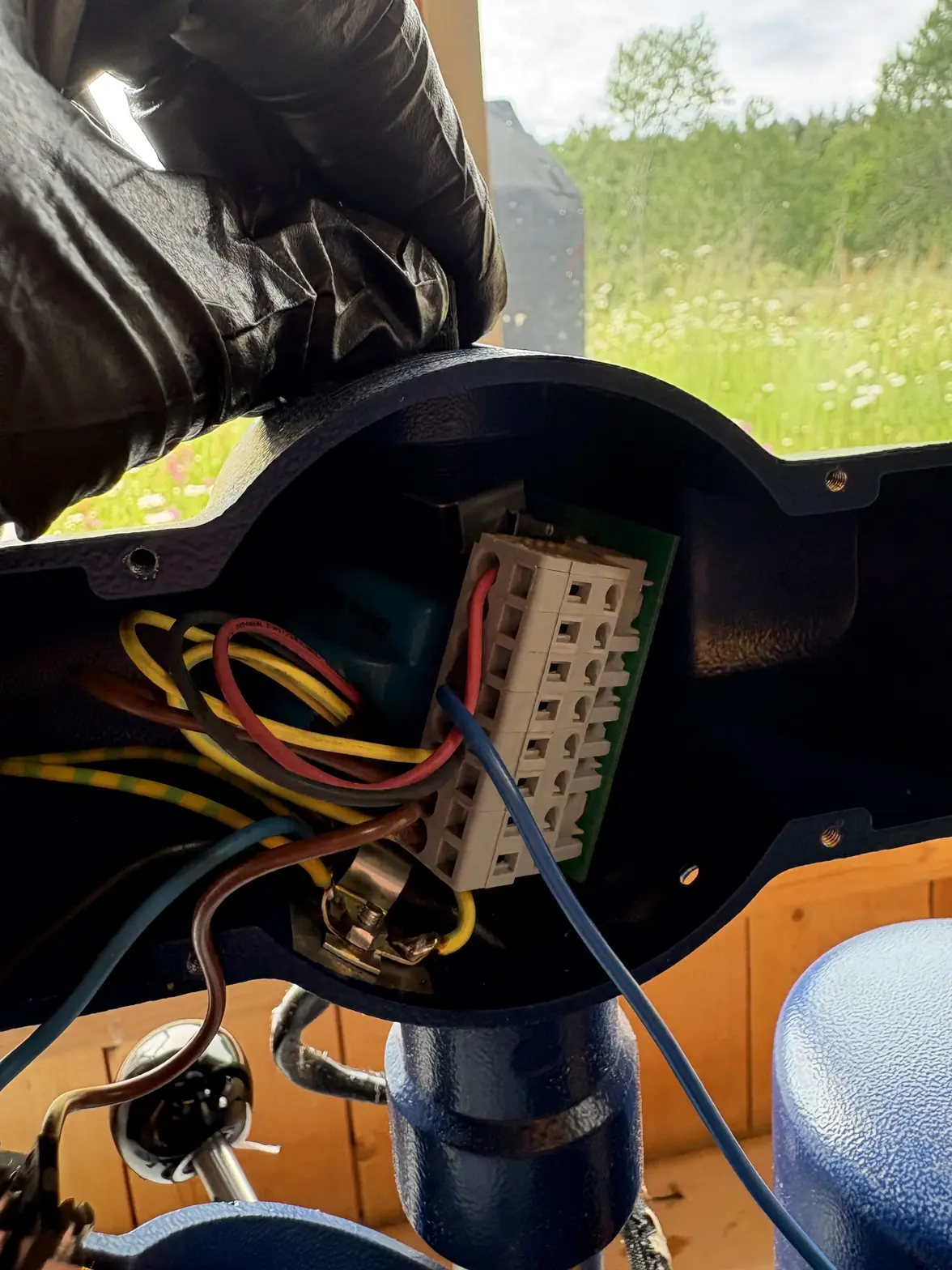

Yes pretty much. I think this one is the last version of the machine so the internals are a little different from what I have seen in other discussions.
There is quite a bit of side to side play in the shaft so I am wondering if it is shipping damage. The seller is promising it was working when they sent it. And from what I can see the wiring is in good condition.
