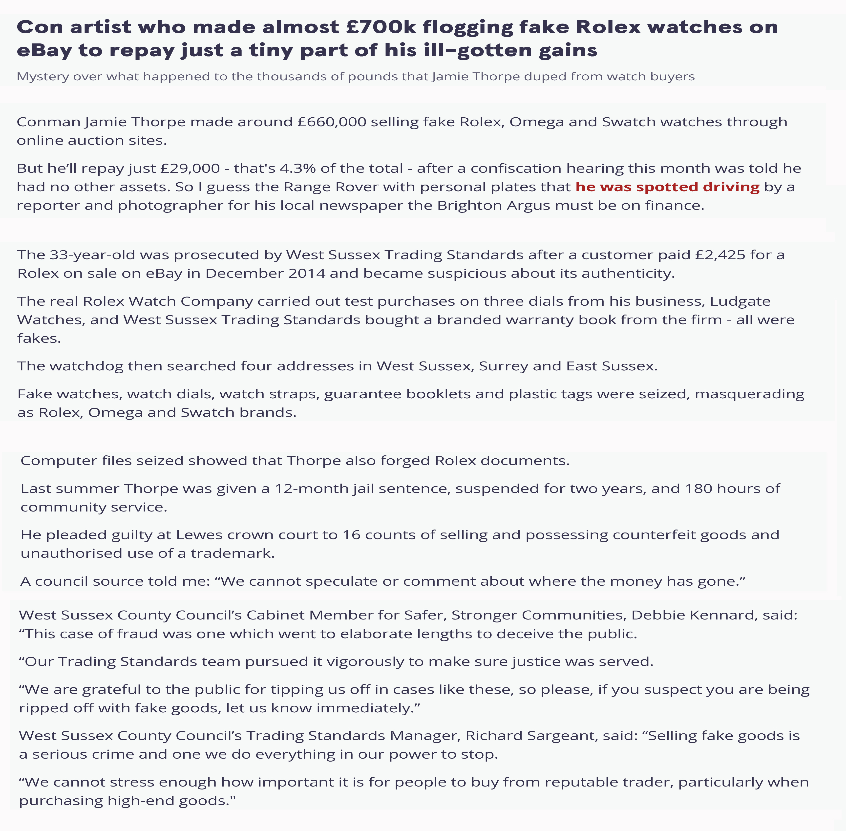

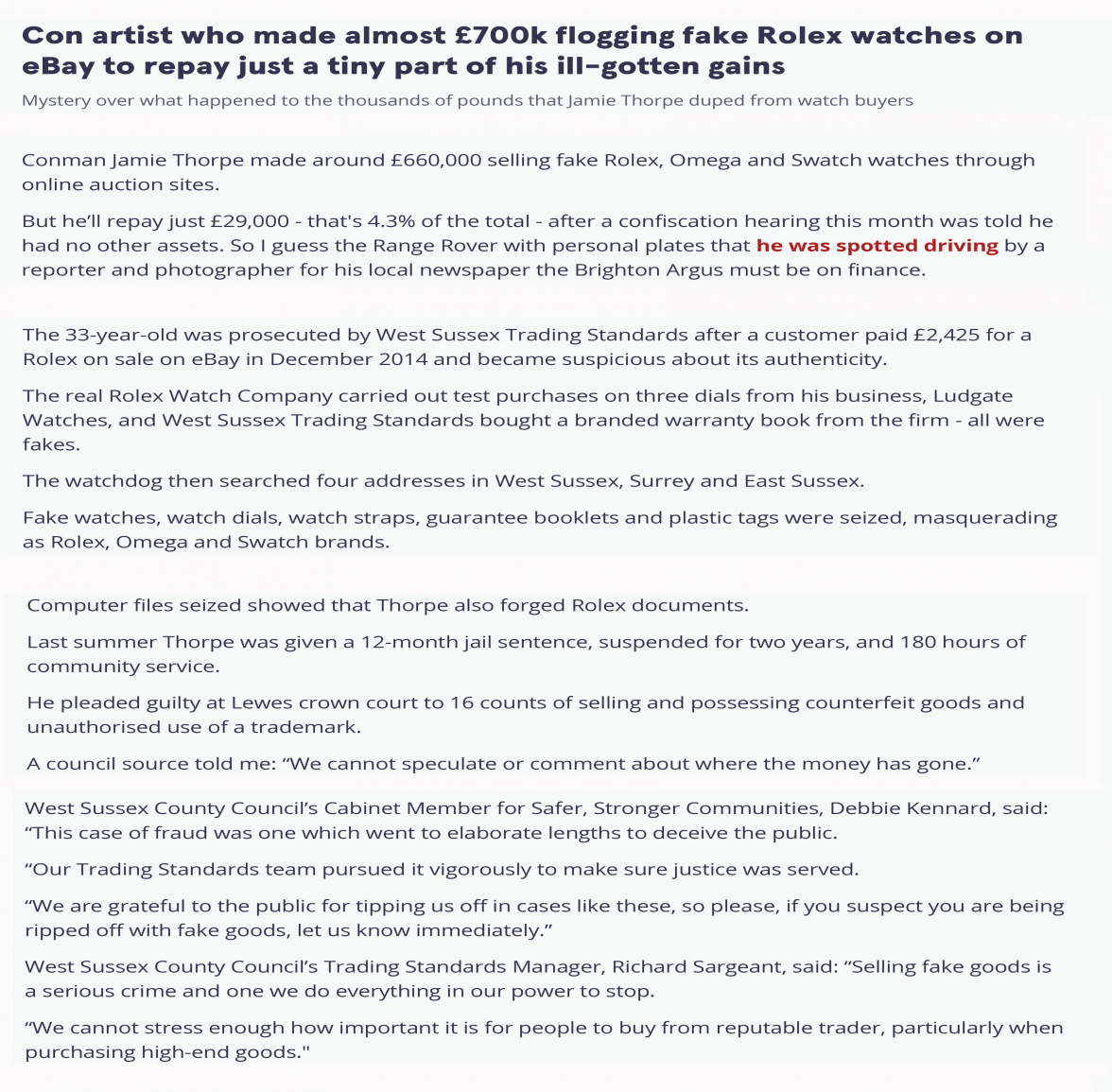

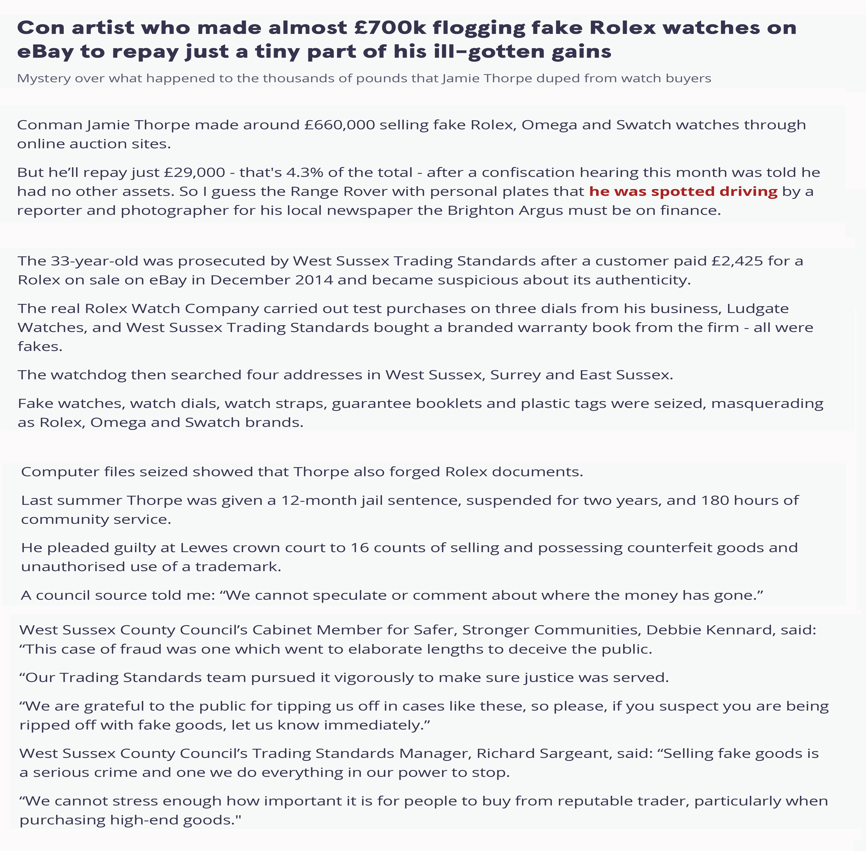

There has been several court case wins for the manufacturers over the last few years with millions in fines and compensation.
But while the "punishment" of individuals is so light compared to the gains they make there will always be the con men. The below is an example of what I mean, this was a court case in 2018 after four years of investigation.

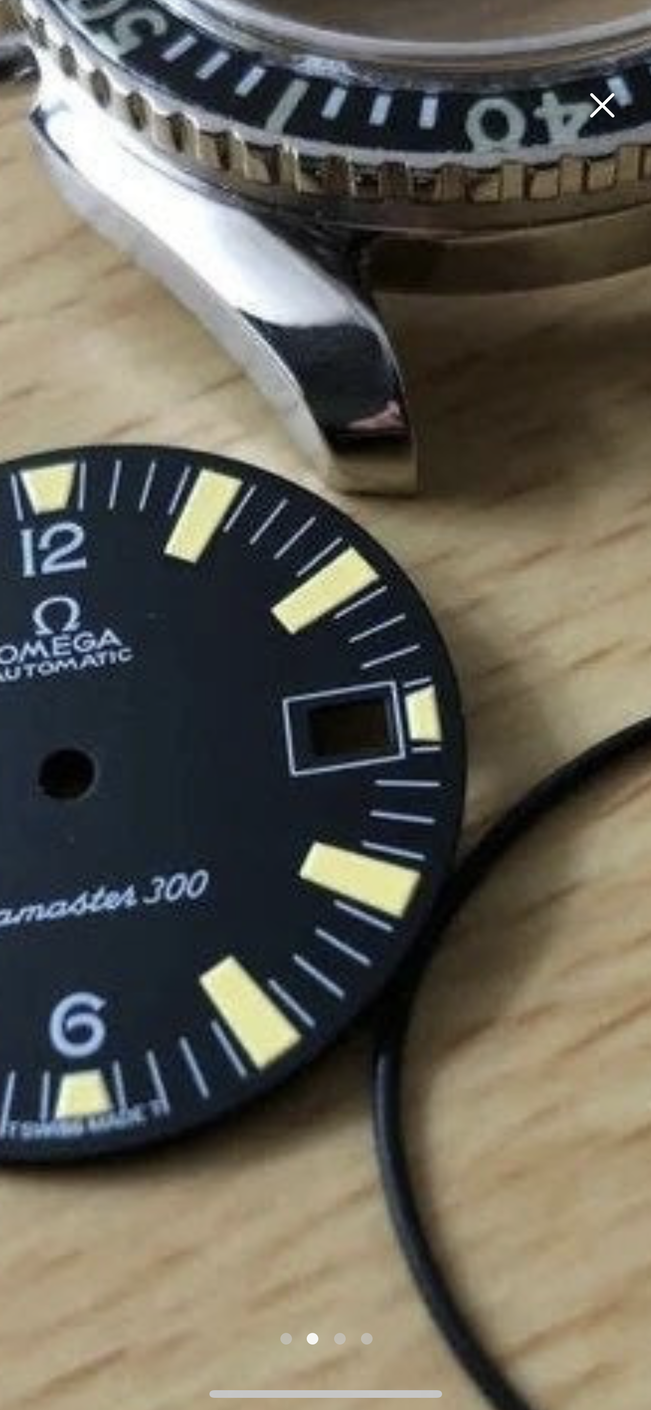

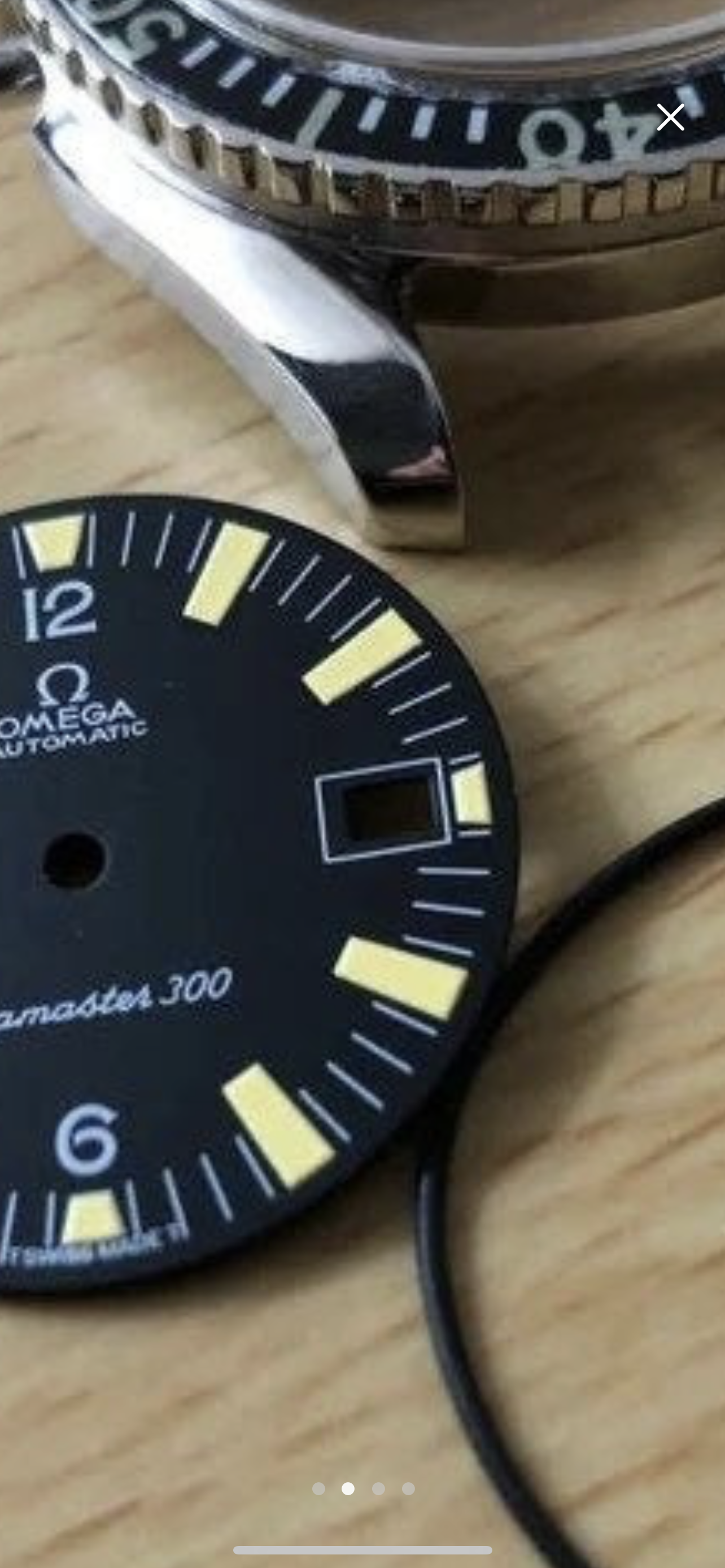

Hi, I literally just saw this one on eBay, could it also be dodgy?
https://www.ebay.co.uk/itm/313686636181
Kr
Stephen
The photos show no Omega branding. However, my guess is that this is simply an end-around eBay rules. The parts they ship are probably branded as implied in the listing title and text.
109
105
Thank you, I had a feeling, but the seller told me they were Omega service parts via eBay messages, so I was actually thinking of going for it, that could have been very messy.. Thanks guys, appreciate the help.
