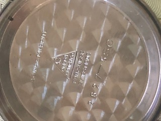

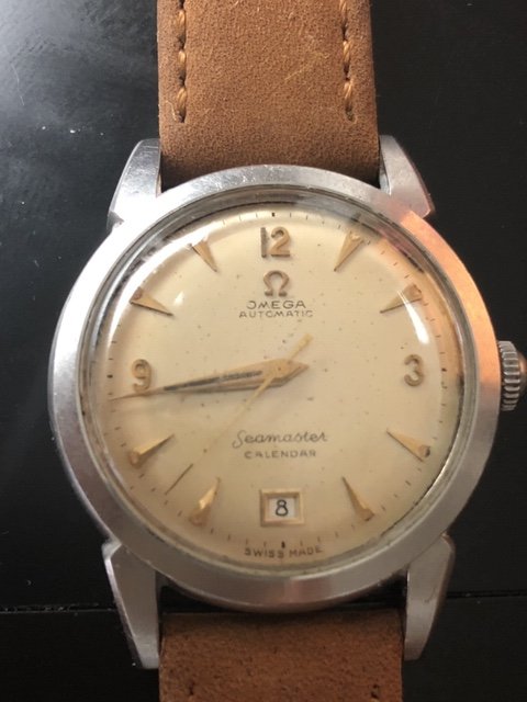

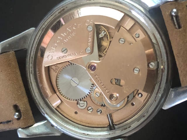

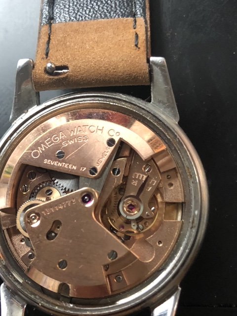

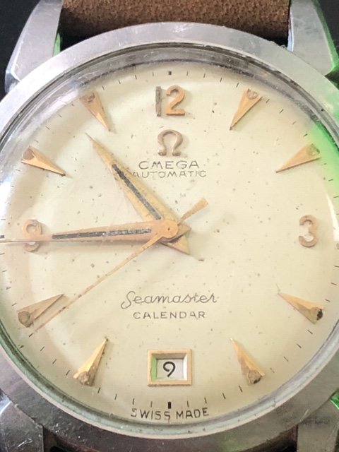

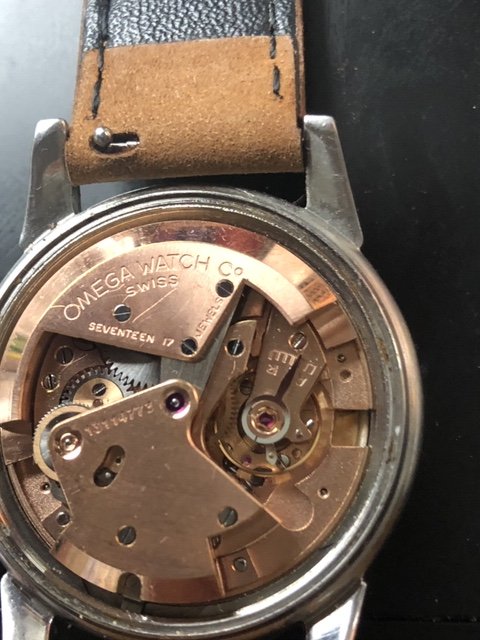

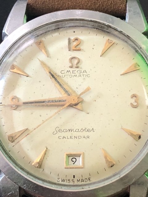

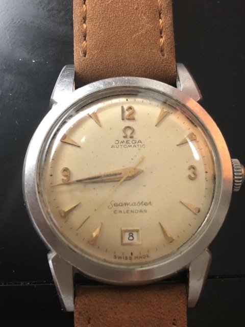

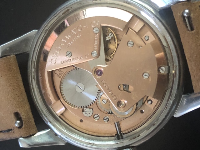

I bought a Seamaster at auction without seeing the movement. I think it looks fine externally, given my limited knowledge. I opened it up, though, and I'm concerned about the movement. It looks brand new. Movement serial number is a 13.
It seems to match the caliber .353's I've seen pictures of, but it's as shiny as a new penny.
I'm new to the forum and vintage watches, but the knowledge here has been invaluable. Thank you for any insight!
Interestingly, this came with what is purported to be the original papers. I know that these papers were often filled in later, but, if so, they were filled in with a serial number that does not match the movement number.

Congratulations! A quite fine and genuine watch (crown is replaced). Movement and it麓s serial is correct and 353 or 355 were used for this reference. And you have the papers which gives the watch a certified provenance! It麓s a bit hard to asses the dial by yours pictures but maybe a new crystal or a polish will improve the overall impression. The case seems to be very well preserved, and the movement has not experienced moisture.
A like these dials with the date at 6. 馃榾
Thank you both. I was concerned about the movement looking so new. I had never read about counterfeit movements, but I don't know much.

Not necessarily. The dome crown is correct for earlier versions of the 2627. That movement has been well taken care of, that is what it is supposed to look like. Bummer the papers don't match the watch.

I stand corrected, the serial does not match. I think that the crown looks almost unused. But never say never.

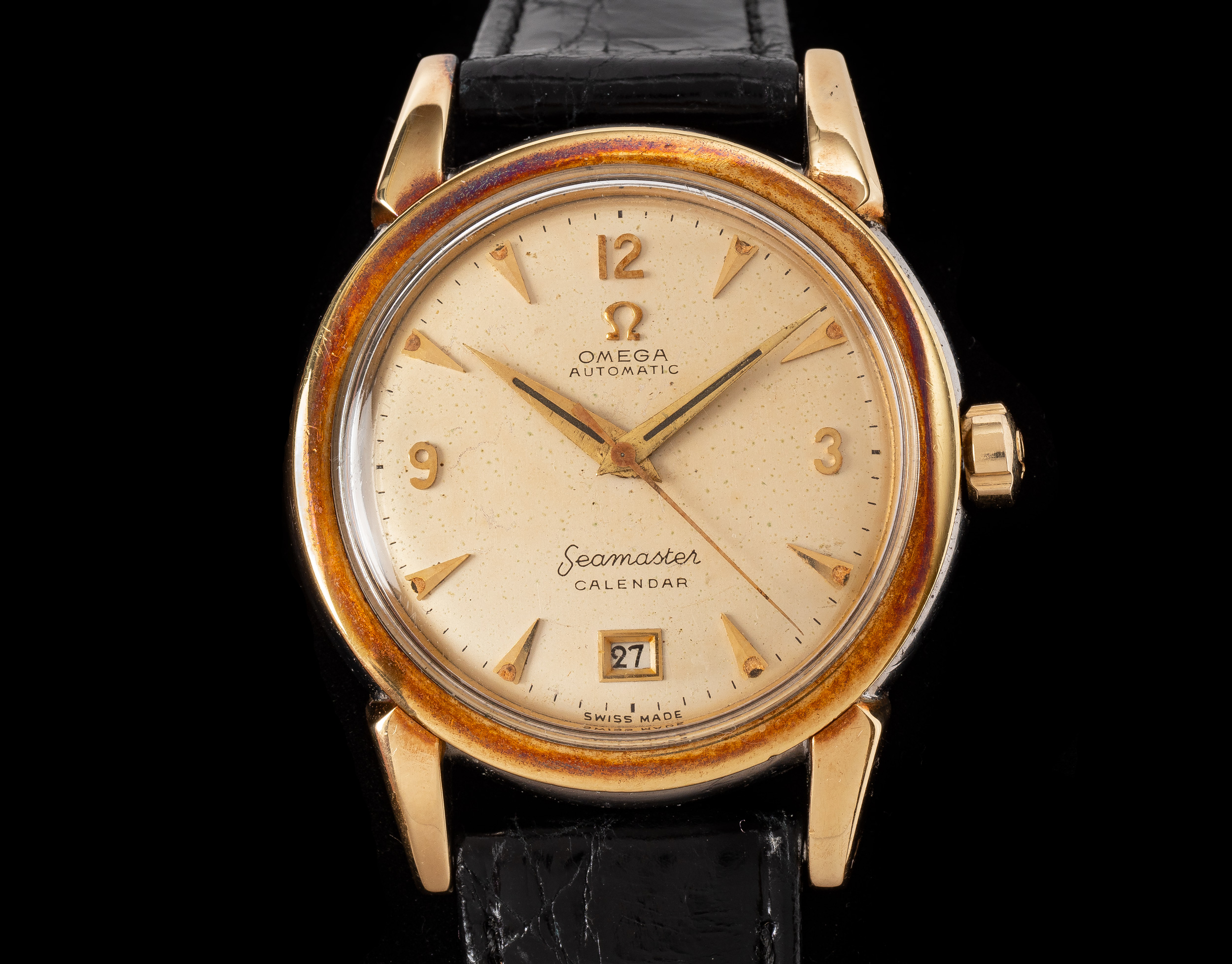

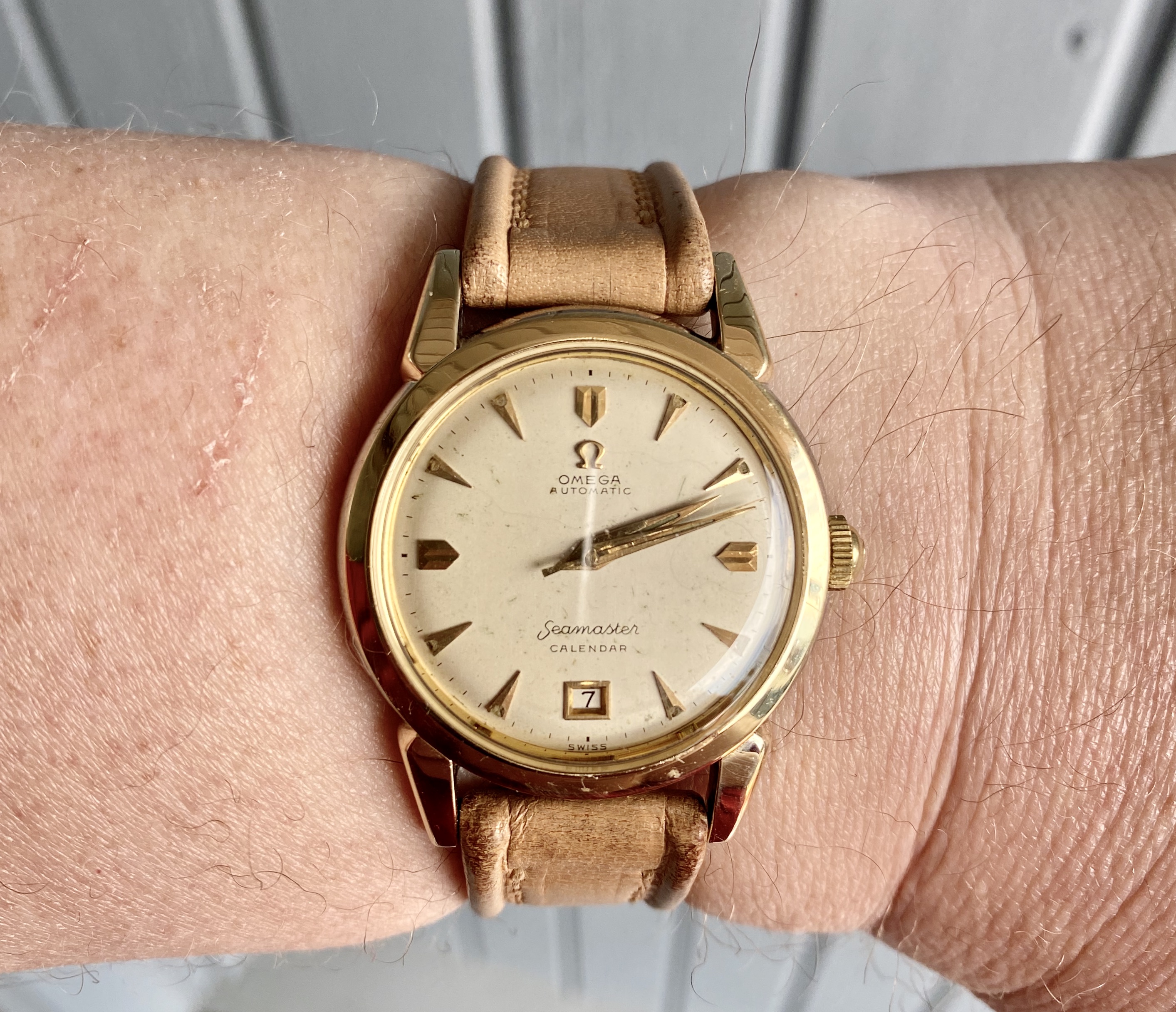

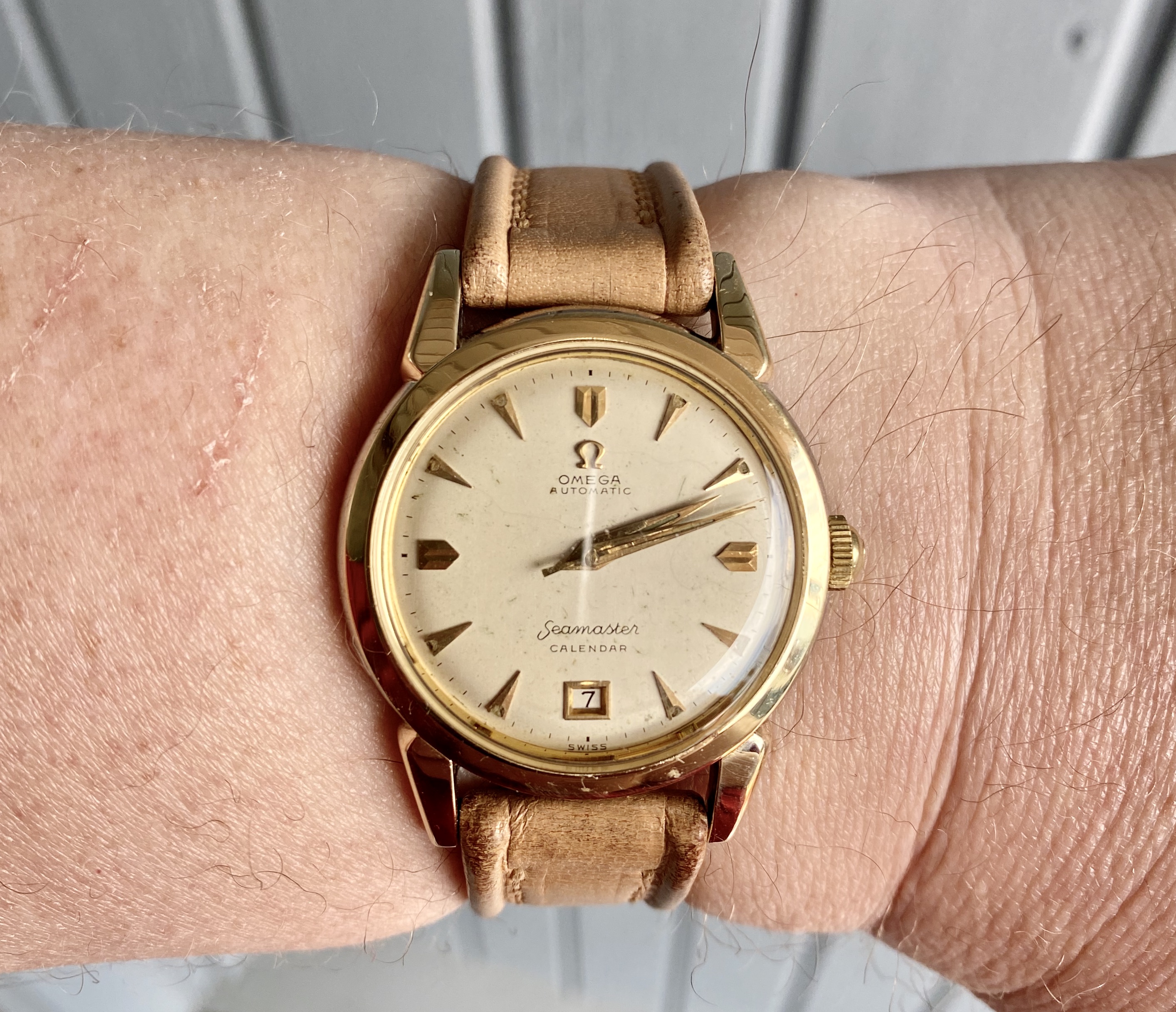

Here is a picture of mine 2627 for comparison,,,

Mine came with a dome crown. Pain in the butt to find a replacement!

Oh, thank you, this IS a replacement. It was difficult to find but once I got the part number, found one on eBay. But thank you for the offer. 馃榿
