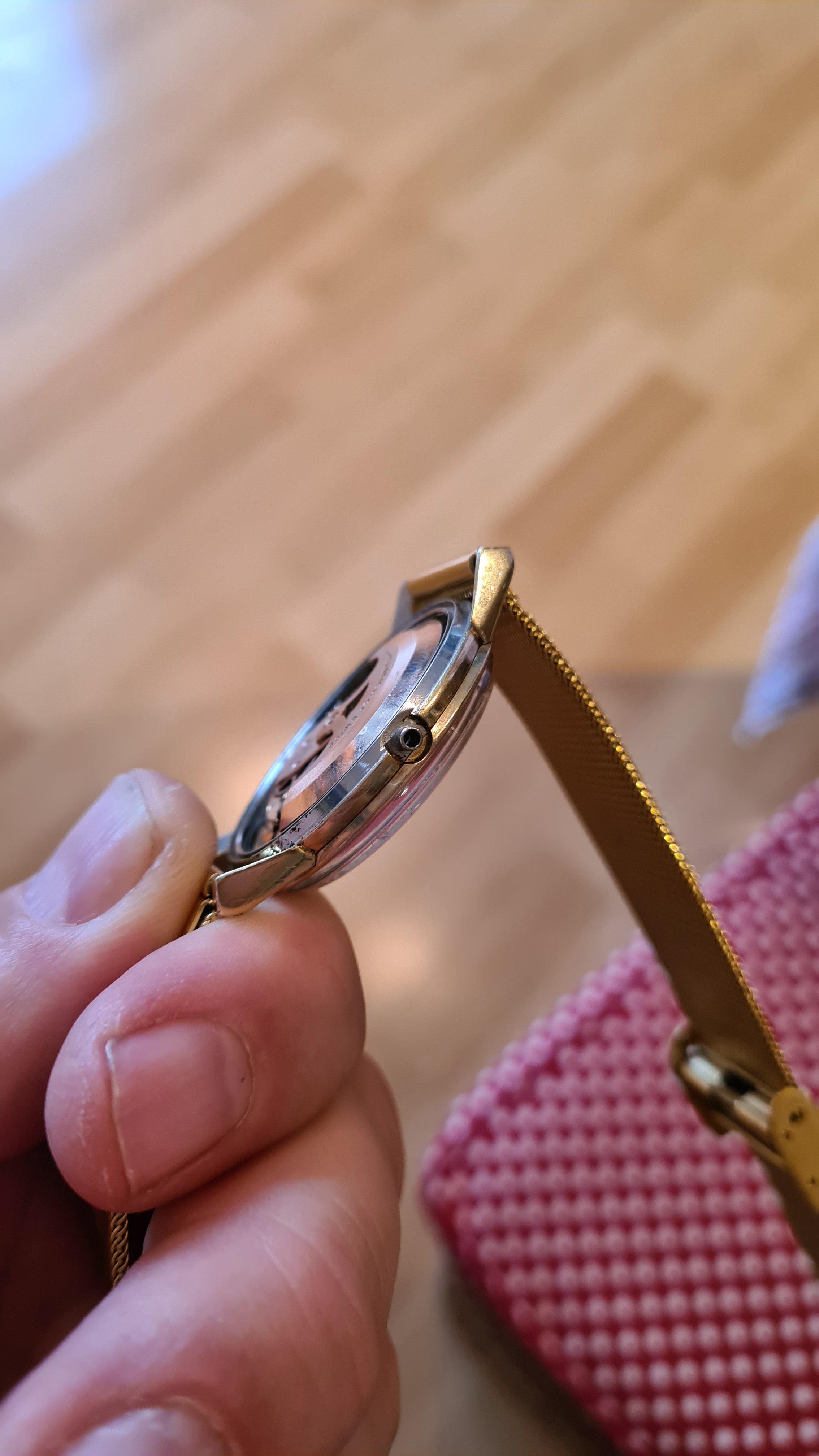

Hallo everybody,
I am new here as so allow me to introduce myself first. I am from Munich, Germany and I recently cought the vintage (sixties) omega virus. I just bought three pieces to start with and have a lot of questions. This amazing forum has been already very helpful to me, so tank you to all the experts here.
I have a Seamaster from 1966, 166.003, cal. 565 and the only thing that bothers me a bit ist that the crown is not original. I was told by a local watchmaker that a new crown would cost about 300 Euros, which I don't want to pay, since I paid around 400 euros for the watch and there are a lot of crowns on ebay, that cost around 20 euro. The problem is, that I don't know, which to buy. So could anyone help me out please? I would like to change the stem as well und would need an advice on this as well.
Thank you very much in advance!

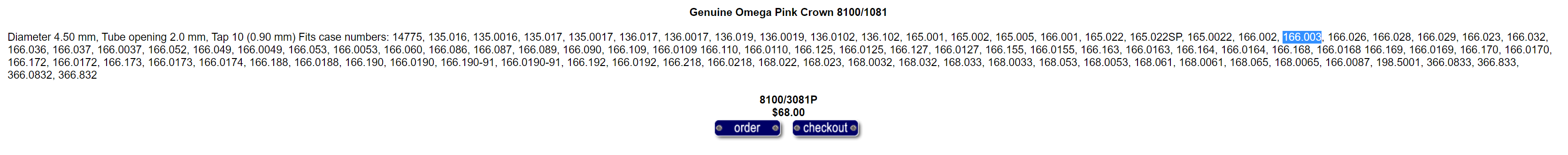

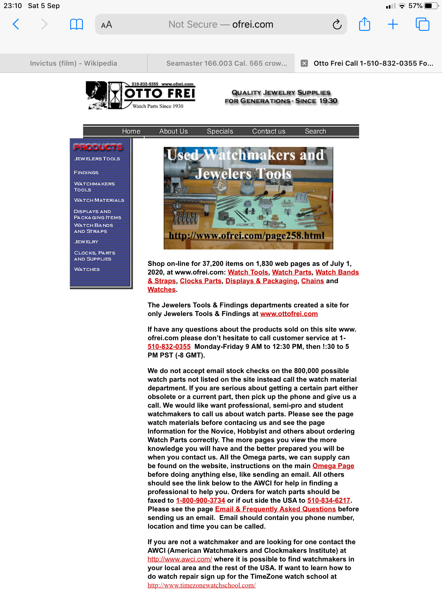

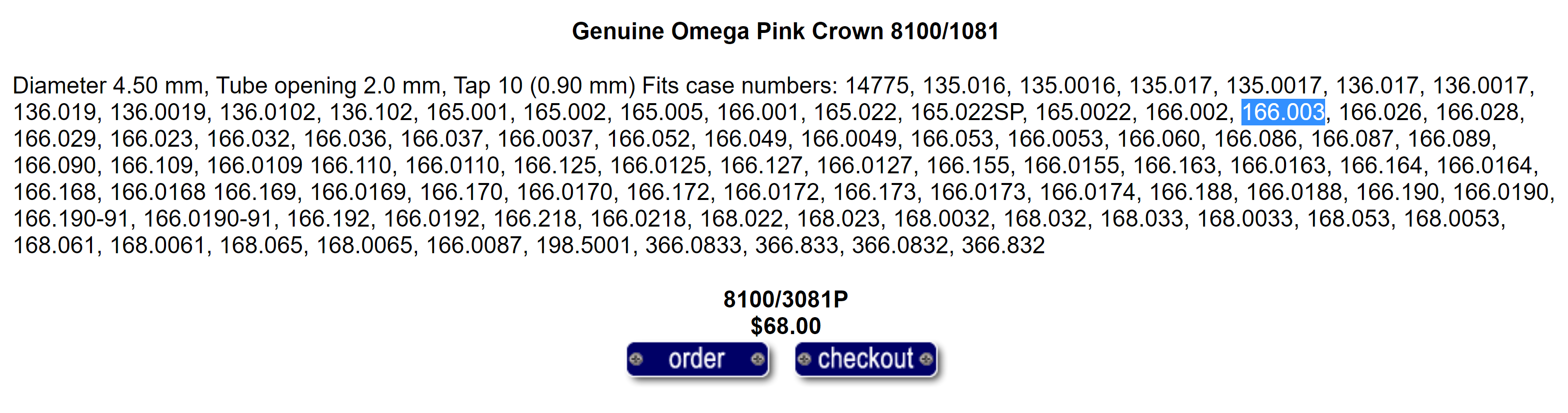

I googled the crown for either the 165.003 (which I have) and 166.003.
I only checked the Otto Frei link because he sounds as though he may be a German supplier, and he seems to have crowns. I am sure there are other suppliers too.
453
682
Thank you very much! I found that too but was confused by "pink", since I need a yellow one
Thats right, the main number should fit.
Thank you, great site!

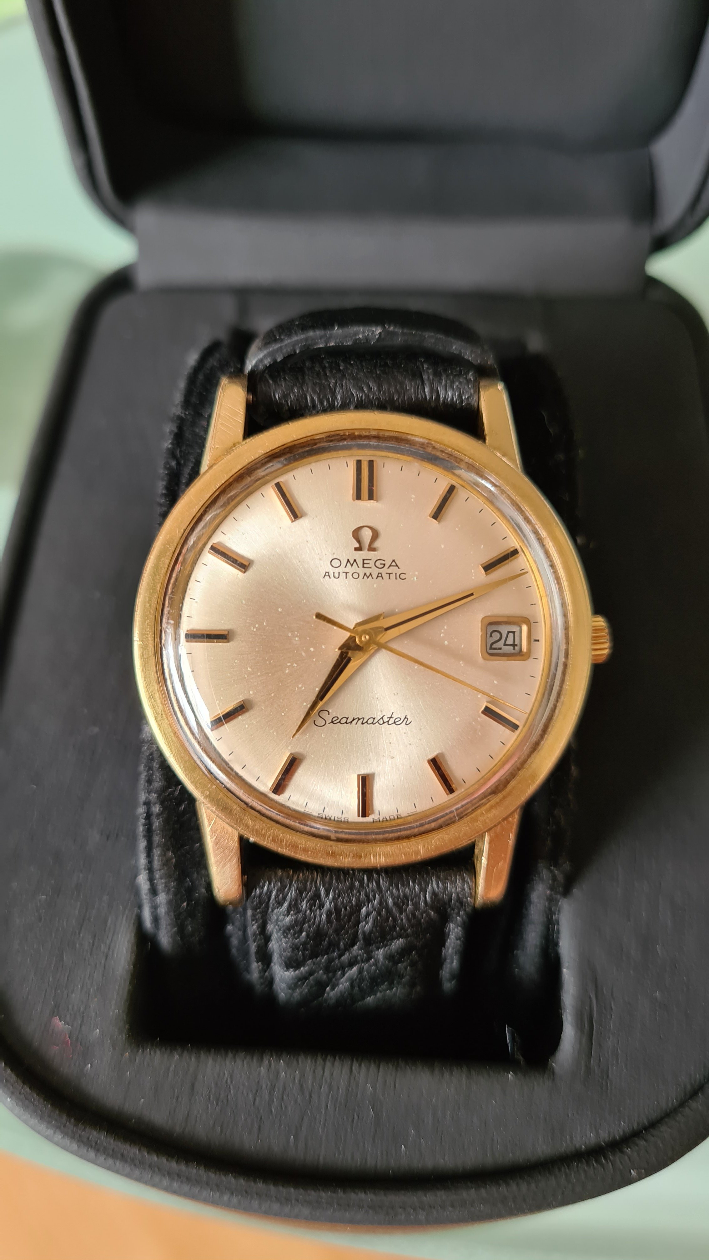

Forget to say ... nice watch 👍
Thank you, I love it although it's a little bit too small for me... But I will pass it to my daughter anyway, so it's ok😀 the crystal is original so I would like to have an original crown as well...
