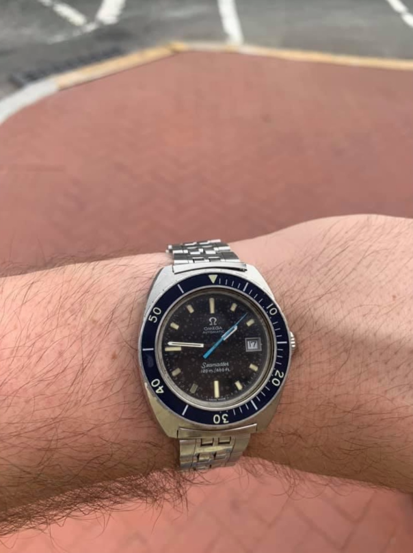

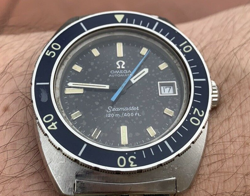

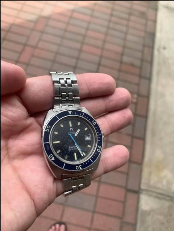

Hello OF members.
Today i have a question regarding a seamaster 120 i am in the works of making a deal for.

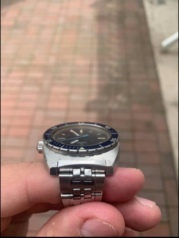

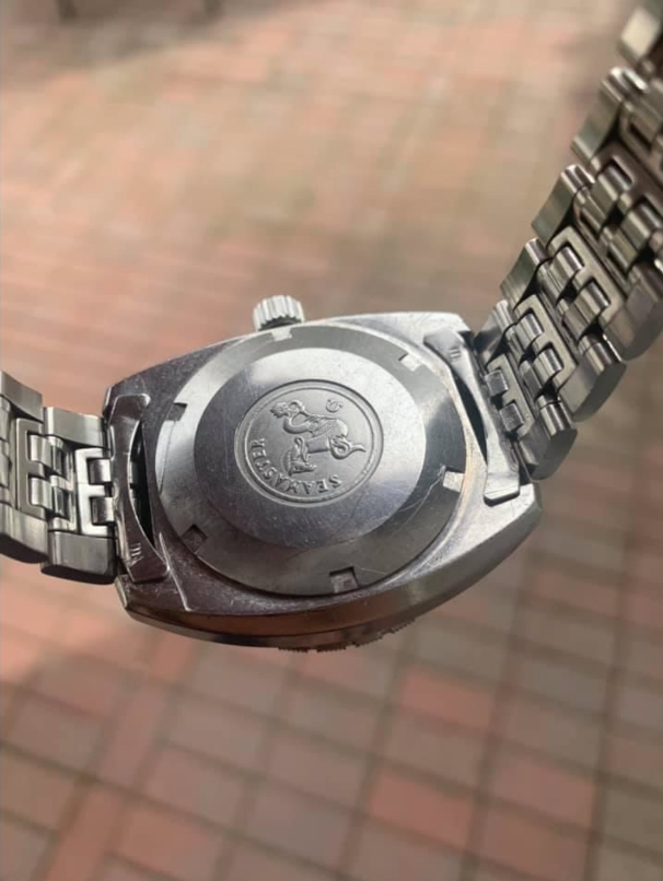

It is a reference 166.088 with blue bezel and black patina'd dial. The bracelet im fairly sure is not correct, (from the examples i found online) i believe the correct bracelet reference is 1162. Im not sure what the reference of the one pictured is as the photo is a bit blurry to make out, though it looks different from what i have seen out there.
Blue second hand looks correct to me the rest i am unsure of.
The price is $1500 USD. Does this seem fair for the condition ?
I know the photos are not fantastic, but i appreciate any and all advice on this one.
Thanks all.

I don't think the thread above deals with this reference and only focuses on the 135.027 - 166.027.
According to this: https://omegaforums.net/threads/case-bracelet-endpiece-list.81618/, the correct bracelet and end link combo for this watch is 1171 / 650.
I used to be after one of these, and I don't think $1500 is a bad price, but I'd definitely want to see movement pics. I would pass on this one personally, because of the spotting on the dial.
