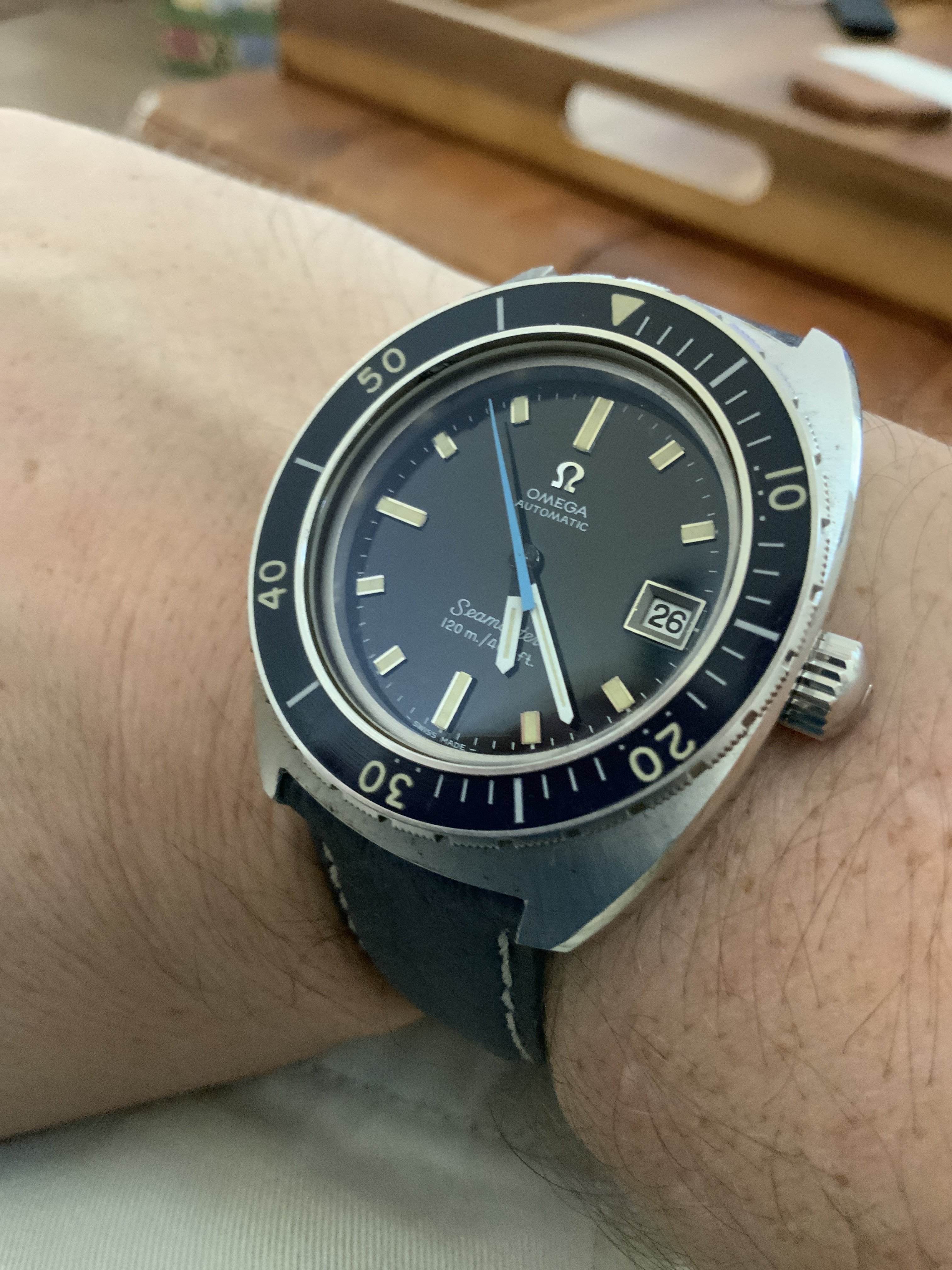

Hi everyone, I’m trying to fit my Seamaster 120 (166.088) with a 1171 bracelet. I did my research, and bought 650 end links. But it turns out they’re not tall enough. Do I have my numbers wrong?

I had the watch looked at again maybe the bracelet is wrong it’s a 1171.

1171 with 650 ends is the correct bracelet for this reference.
Maybe show us the bracelet and end-links you have?
