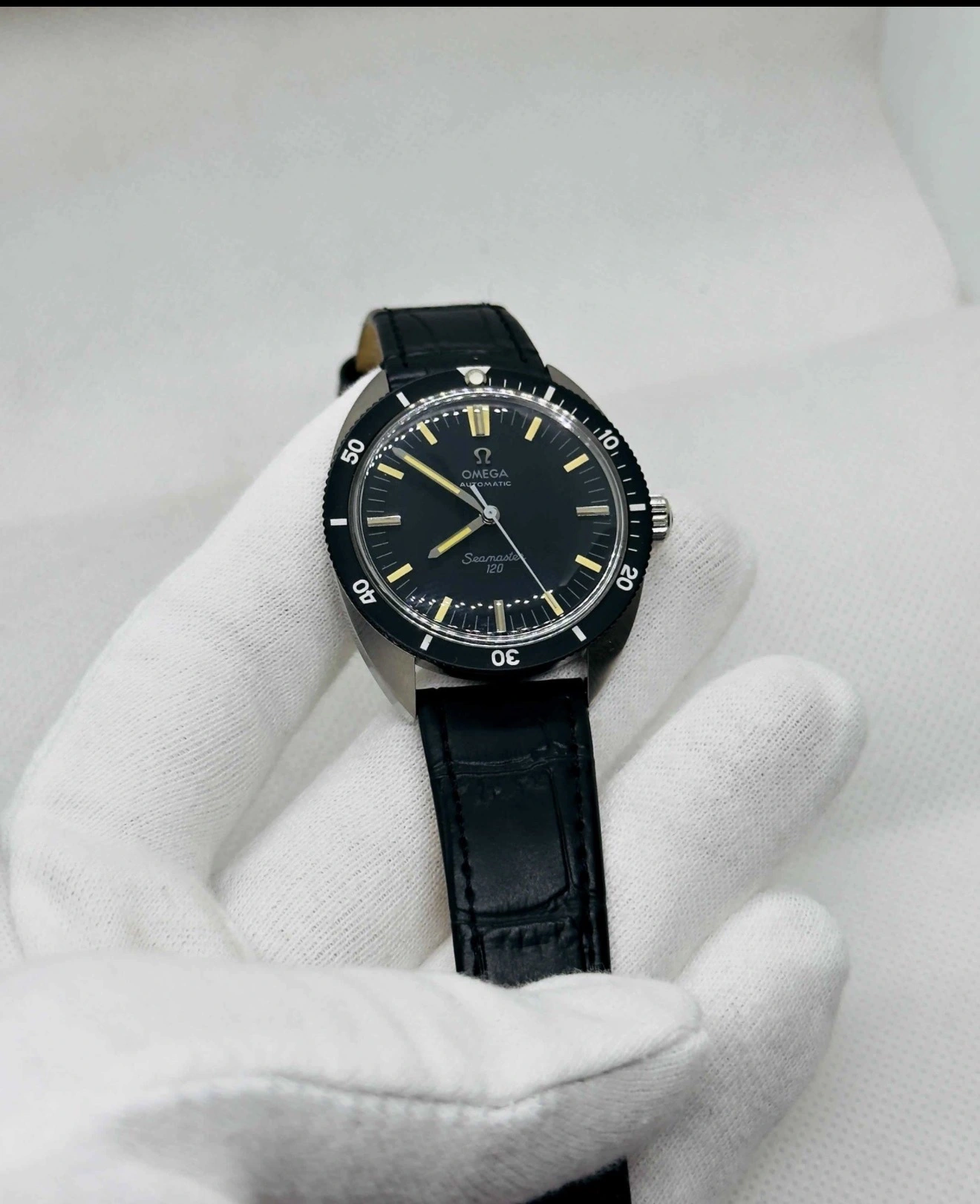

Hi all,
I have a Seamaster 120 166.027 with a bezel that is a little sticky when turning. I was thinking of cleaning out the gunk underneath. Are you able to just use a couple of credit cards to pop it off? If so, does it snap back on like the submariner bezels or would it require a press?
Thanks.
