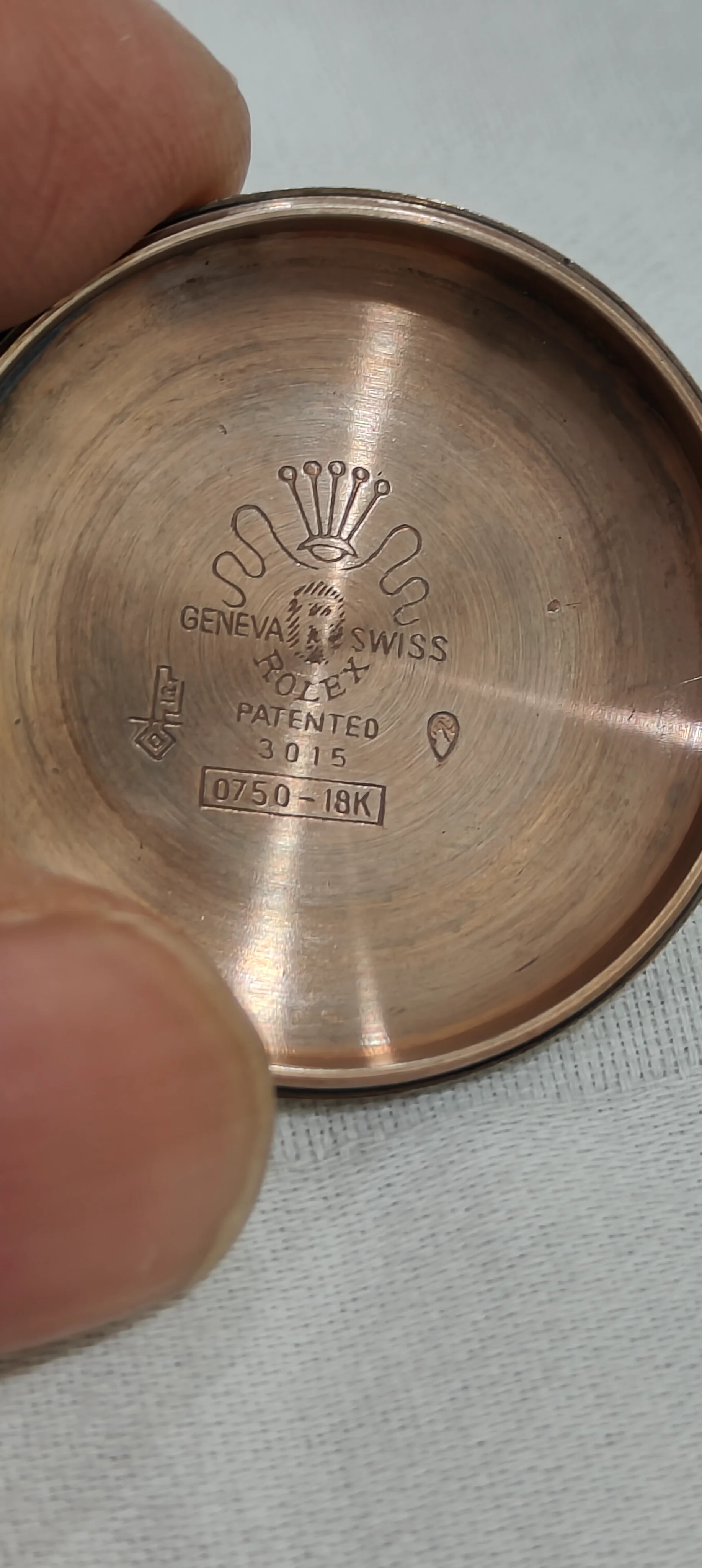

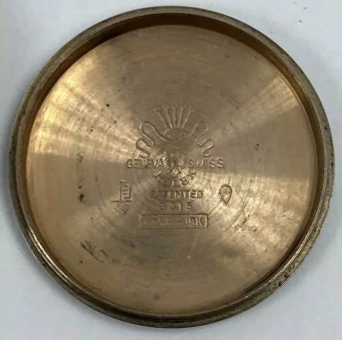

I was considering a Rolex Bubbleback 3015 but what is stumping me is that even though caseback is steel, inside caseback is pink gold with 18 K stamped.
What is the issue here? Is it genuine? Vant find a similar piece online.
Sorry, dont have outside pic of case back but it is steel!! (Or is it polished?)
Thanks

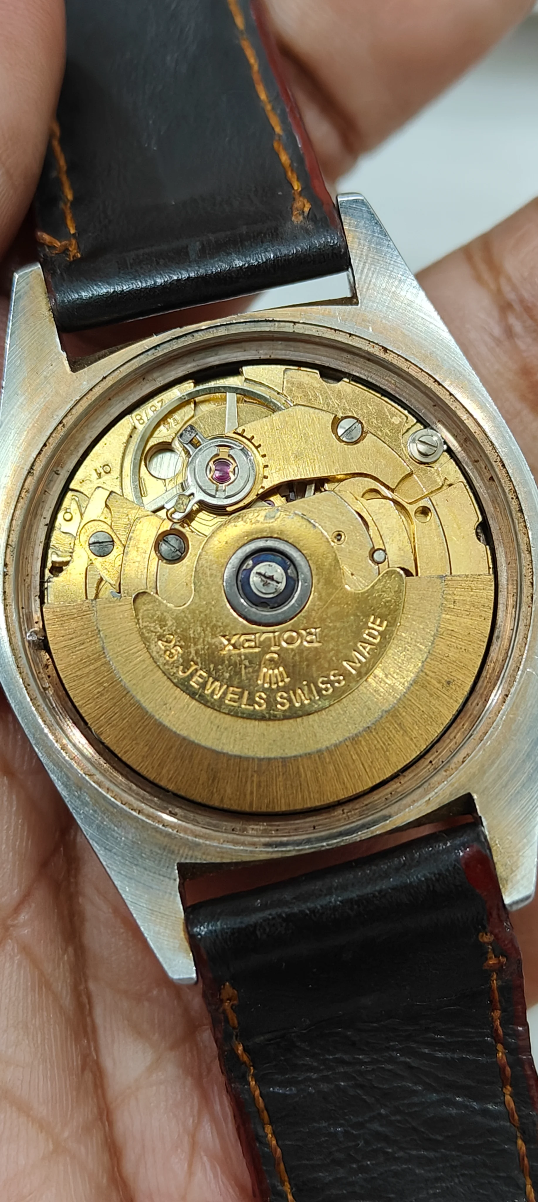

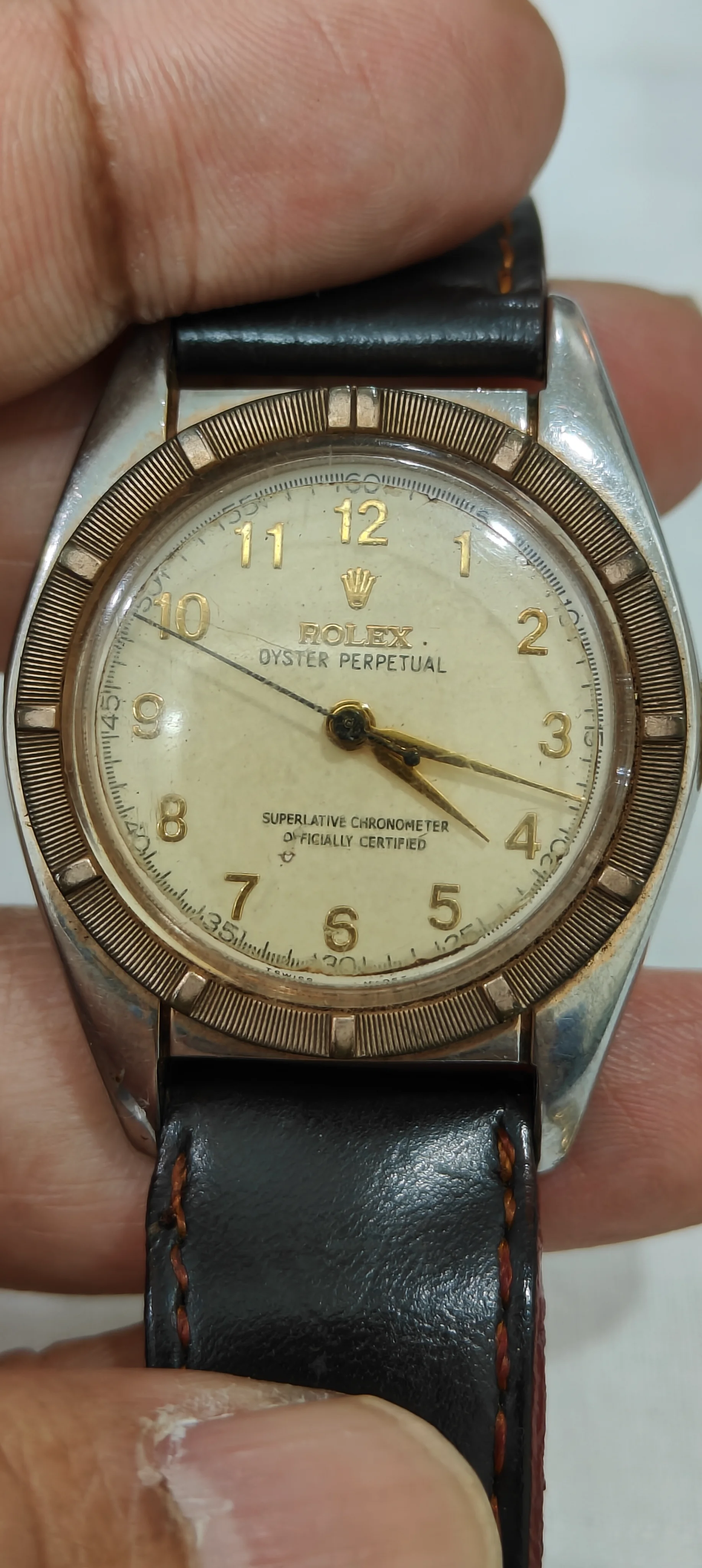

It is for sure a redial. I think the movement is strange as well but that may be just me

Do you have this watch in your hands, or are these photos being provided by a seller? Obviously this case should not have a gold case-back.

Hi, i took these photos myself from seller's home. But forgot to take the back pic, even though it struck me then as well how could outside be steel and inside marked 18K gold. And yes, inside isnt some local stamp, its actual orig stamp.
Is its a redial? Felt orig though.

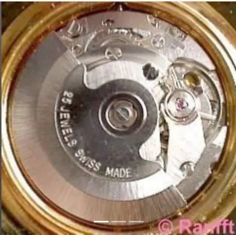

The whole thing is more than fishy. The Rolex movement has been replaced with an ETA movement. TBH, I am not familiar with this reference.

100% chance that the dial is glued or taped in place.
This is a very Nice clue! Thank you!
I had missed an original dial Rolex Himalaya when someone advised it was fake even though 80 year old watchmaker kept asking me to take it.
This i will check out. Thanks

Any thoughts about the ETA movement that has already been mentioned 3 times? That alone is reason to just walk away.

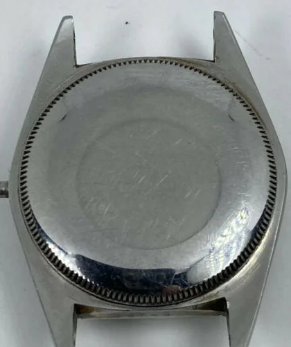

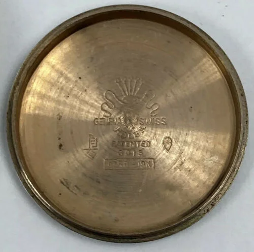

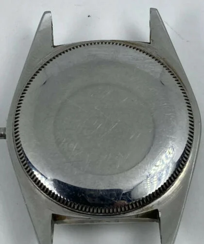

Hi, request the forum to see this link. Exact same case is available there, with steel outside and 18K marked inside
https://watchcharts.com/listing/1843733-vintage-rolex-case-bubble-stainless-18k-ref-545383-5015-3015
Seems as though a think 18K plate is affixed onto inside of case back.
Shall wait to hear from forum. These 2 pictures are from that site with Credit.
Thanks
Sorry, 18k hallmarks would not be on stainless caseback. Something is wrong here. Perhaps someone bought this fake case and made the OP watch from it.

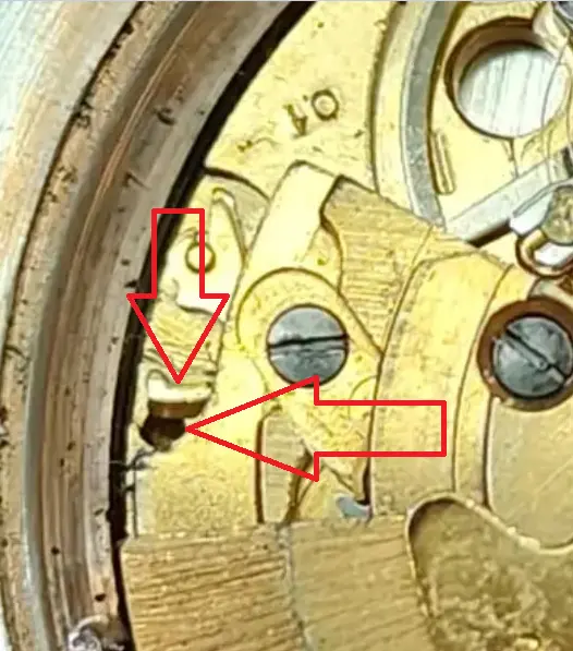

Empty hole suggestive of missing legs, ETA Movement as suggested (i am not an expert but am sure members here are) are red flags enough. Will walk away but would get the dial opened once for the heck of it.
Now i am sure its fake.

Case tube pendant is a dead giveaway! It should be the threaded case tube pendant to accomodate a Rolex Oyster telescoping crown which fits the threaded tube. Electroplated steel case. Rolex stamped into a ETA automatic rotor! Fake stamping on the rotor, fake stamping inside the case back? Case electroplated, steel back yellow inside, steel outside, marked 18 kt? I suggest the case back was electroplated as well, and the plating wore off the exterior of the back! Someone needs more proof that it isn’t real? Put your money where your mouth is!
