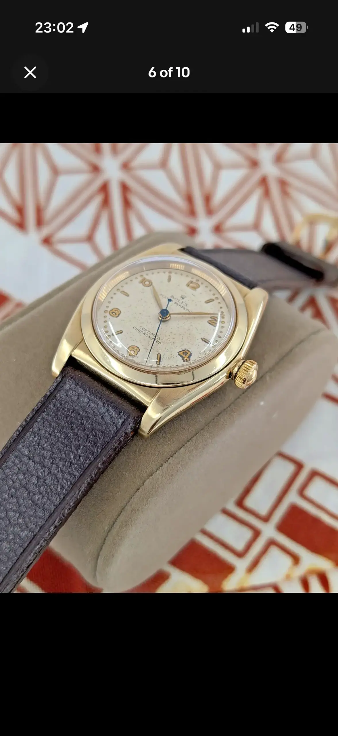

Hello all:
I just purchased a 3696 Bubbleback which is in amazing cosmetic condition, but the movement runs poorly: it runs but in the dial up position it starts “galloping” and slowing down and stopping in the crown down position.
Can anyone point me to a trusted watchmaker who has a particular expertise in Bubblebacks?
Thanks.
Patrick
355
331
Those early Rolex Models have fairly simple automatic movements. A good Professional watchmaker should be able to find the issue. The Problem is the spare parts. Those are hard to find. But maybe he doesn‘t Need spare parts.
6,829
10,652
Where do you live? And indeed parts can be a PITA
65
58
I used michael young in hong kong for my bubbleback. It took about 18 months though to source a reversing gear for the automatic winder. It was ticking at the time but I didn't realise it had teeth missing on some gears. At the time I had given it a service and couldn't get it right so decided to use a rolex pro.
