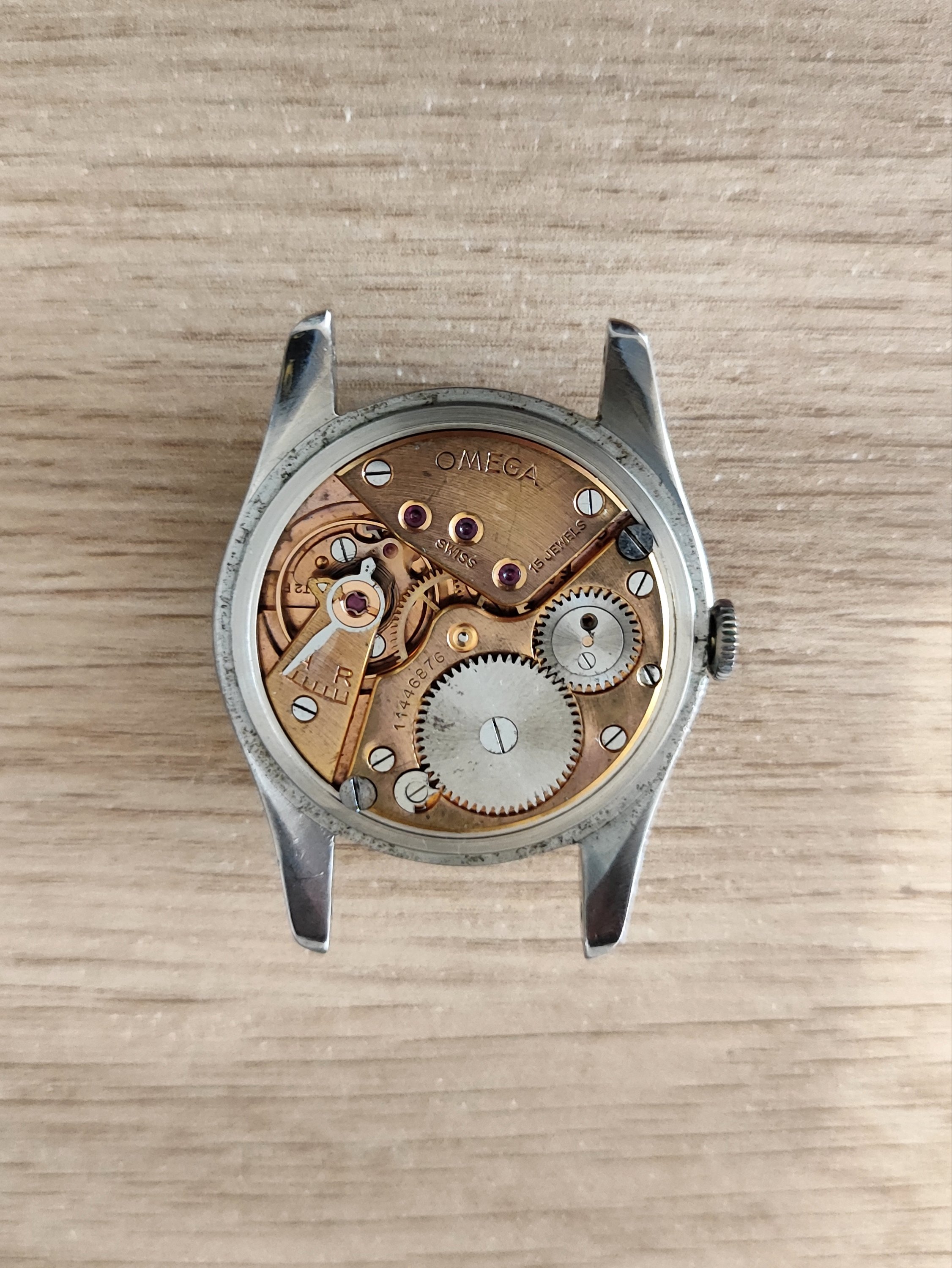

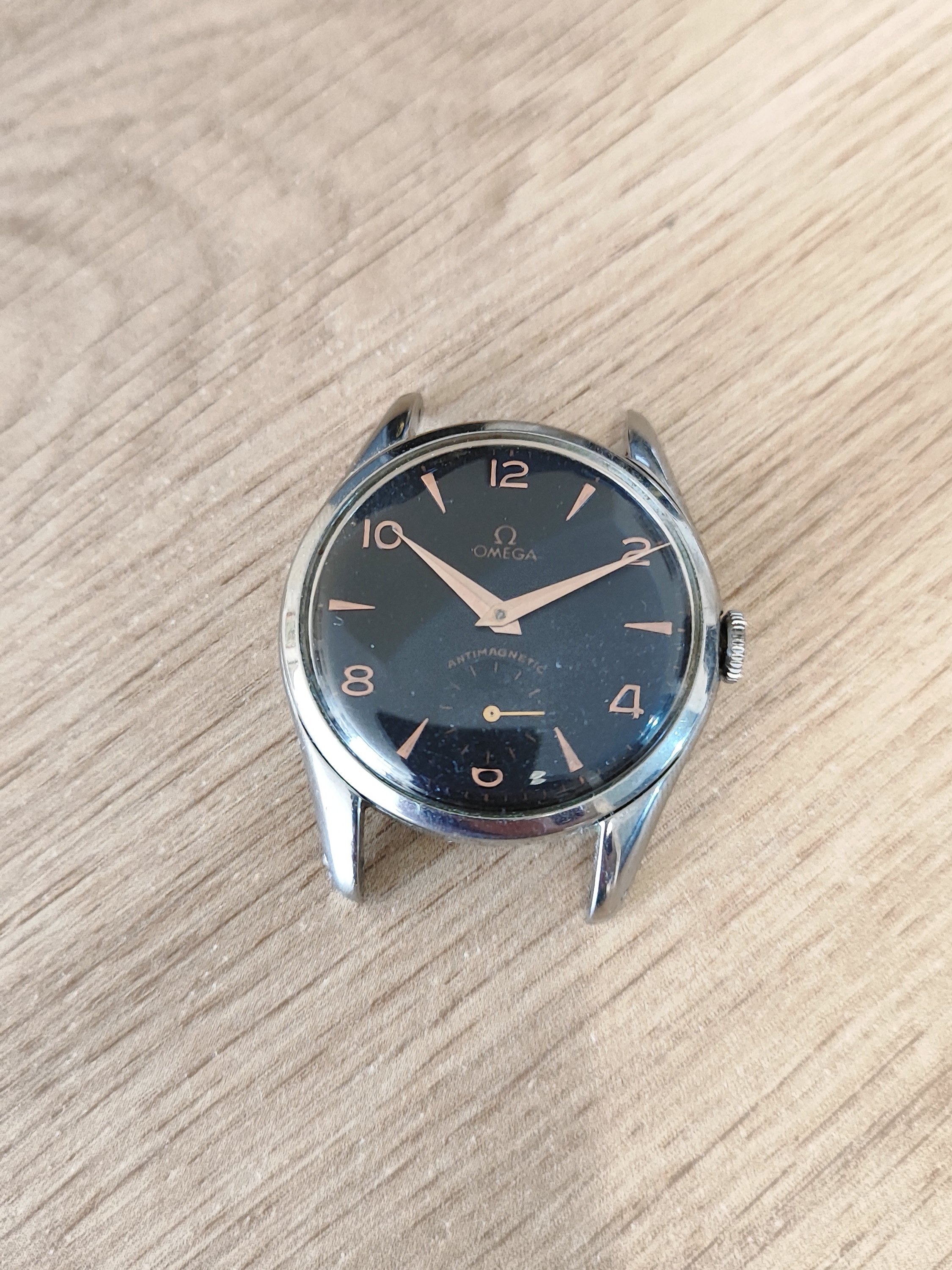

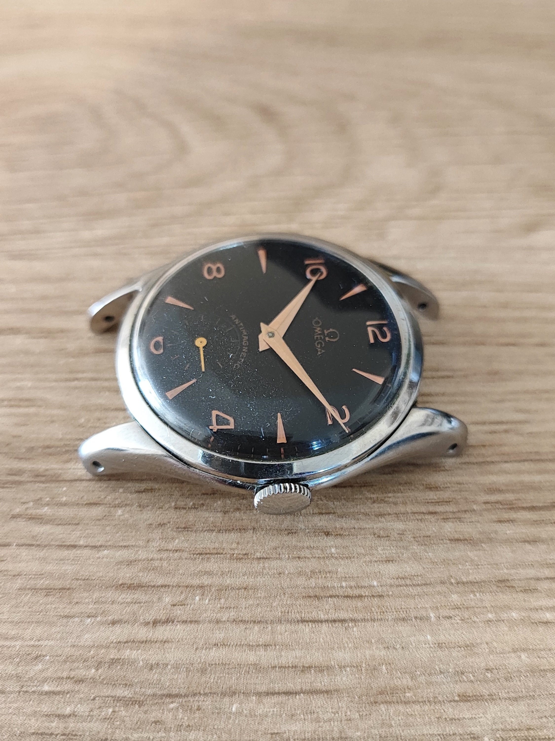

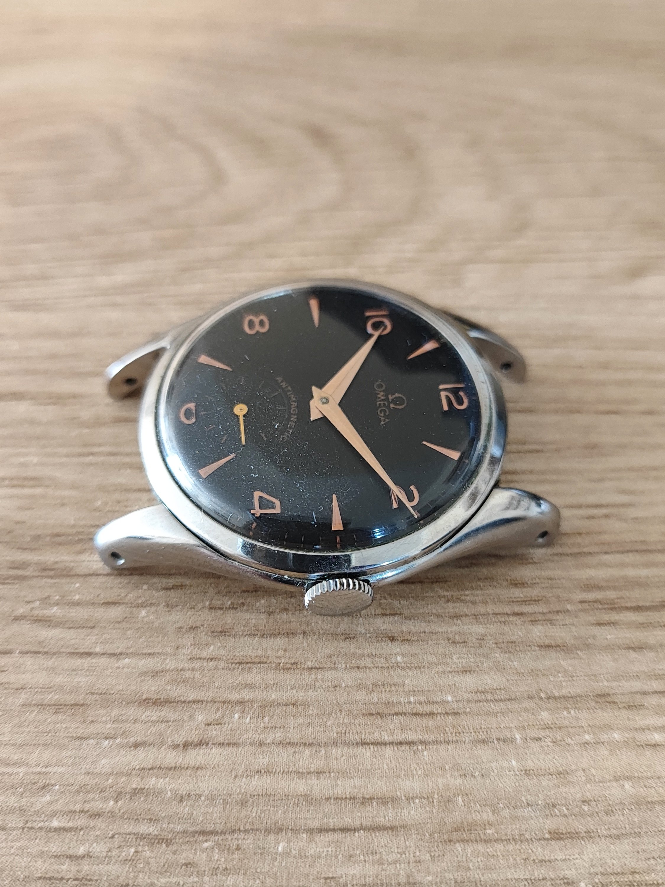

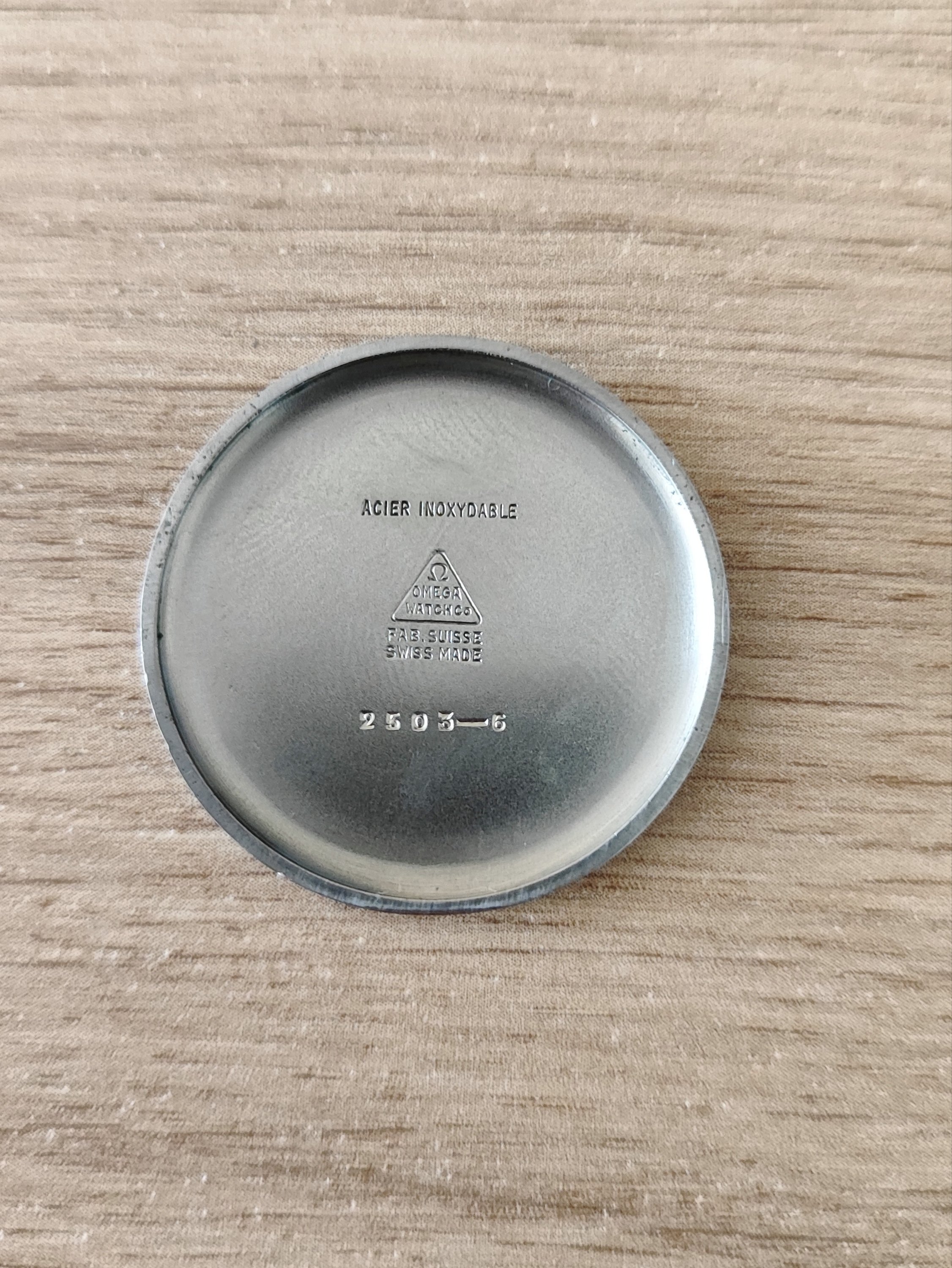

Hi all. I have this Omega ref. 2503-6, Cal. 30T2PC, that seems to have been assembled out of available parts. A bit of a backstory: my father bought it years ago and kept it in a drawer. He likes Omega and he particularly liked the black dial, but didn't dig any further into its authenticity. When I started taking an interest in watches, he gifted me this one among a couple others.
What I'd like to is to treat it as a project and restore it in its originality, no matter how long it takes. I'm totally aware it doesn't make financial sense. I'm hoping I'll get some advice on it's different parts and possible sources for replacement. What I can tell so far:

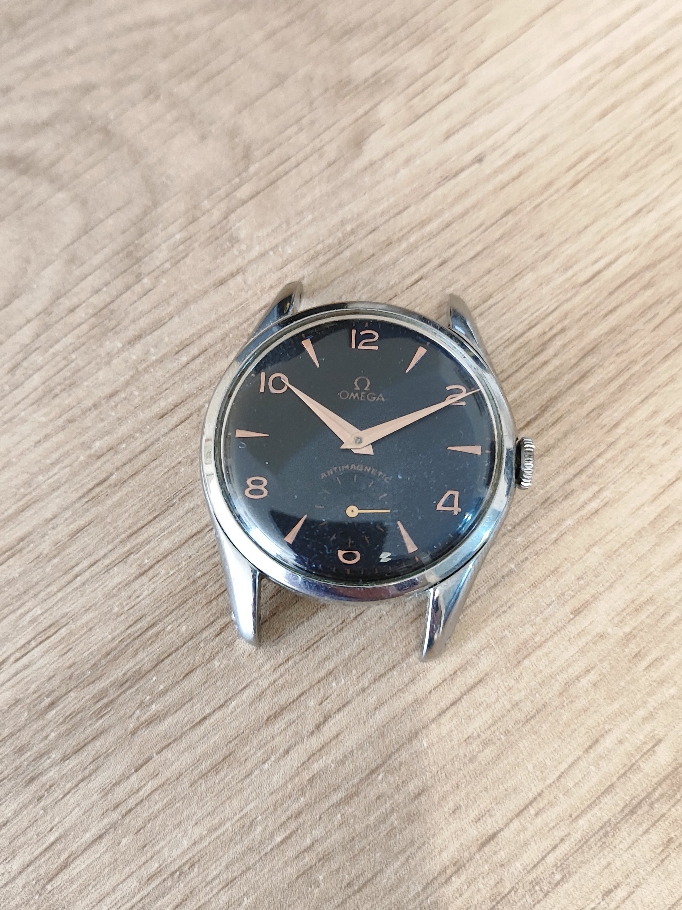

The dial: From what I've read, Omega hasn't used "Antimagnetic" on its dials. Well, the movement isn't antimagnetic anyway (that would be a 265, not the 30T2PC). In addition, the dial is too big for this watch, as much so as the "Swiss made" writing isn't even visible. It is however in there, but I didn't remove the bezel when taking photos. Any possible way of sourcing a dial that matches this particular reference?
The hands: While similar to other watches of this reference, they're once again too big for the dial. Minute hand goes almost to the edge. Any way of sourcing a pair of hands?
Crown: A random, non-Omega crown, but this should be far easier to source than the rest.

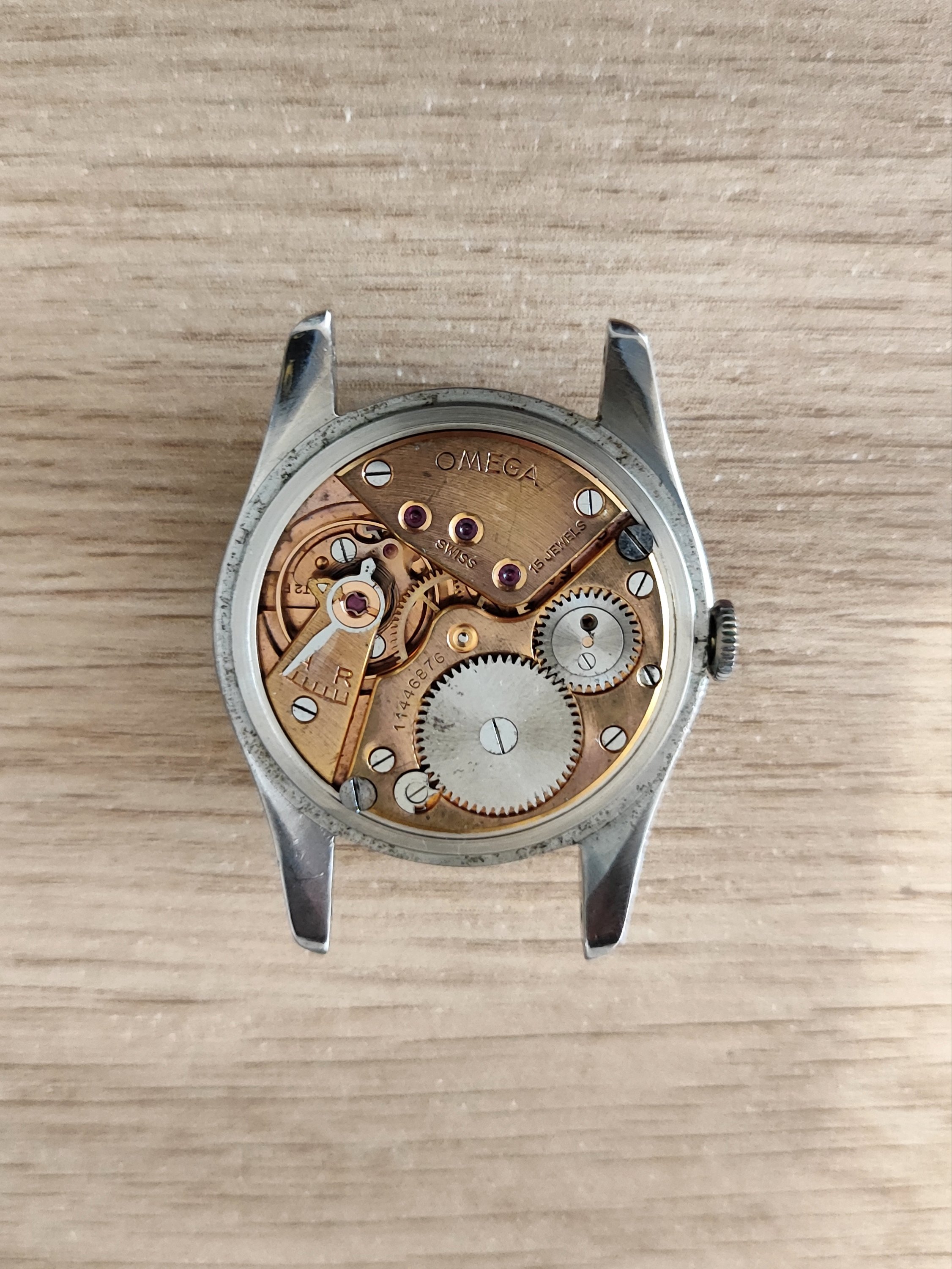

Movement: The 2503 reference is supposed to have a Cal. 260/265 according to Omega vintage database and other watches of that reference seen online. This one has a 30T2PC. On the other hand, vintage database lists this as starting from 1946 and the movement serial (11XXXXXX) is from 1947. Cal 260, as far as I know, has been used from 1949, so it would make sense for this watch to have the movement it currently has. Any ideas if the movement may have been swapped? Not that it matters that much, as it's still the same basic movement, but just to know.

The 260 AFAIK is identical to what you have there so I don’t think it’s worth swapping. If the model was launched in 1946 then he movement fitted is probably correct and original since the 3 digit naming scheme wasn’t used until 1947-8 so that was the correct movement for the first year or two. The dial has obviously been refinished so antimagnetic is just a red herring IMO. I see your point about the hands but ‘Swiss Made’ being hidden isn’t unusual even on fully straight watches so it’s not proof the dial has been changed, it does though as noted look refinished so maybe it was added back on too low.

This is one of my fav 30mm case specially the first versions like this one with the big lugs and small bezel , the movement is correct for this watch , you just have to take the time to find a better dial and the missing screw on eBay, it will not cost that much, very cool project !

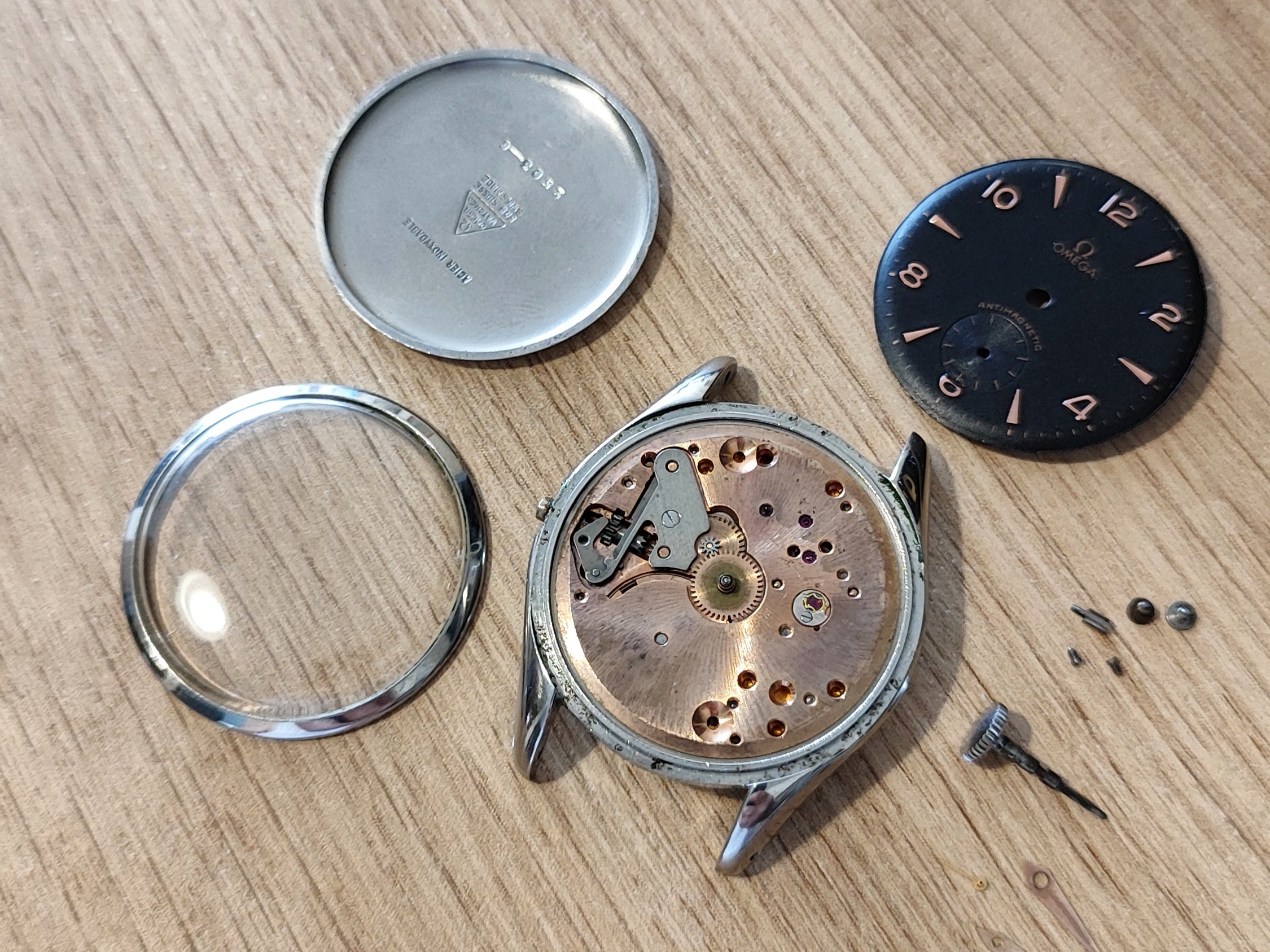

After the solid feedback I got in this thread, especially confirming that the movement is most probably original, I'm starting to tidy up the watch. Will update this thread occasionally whenever there's something interesting to post about.

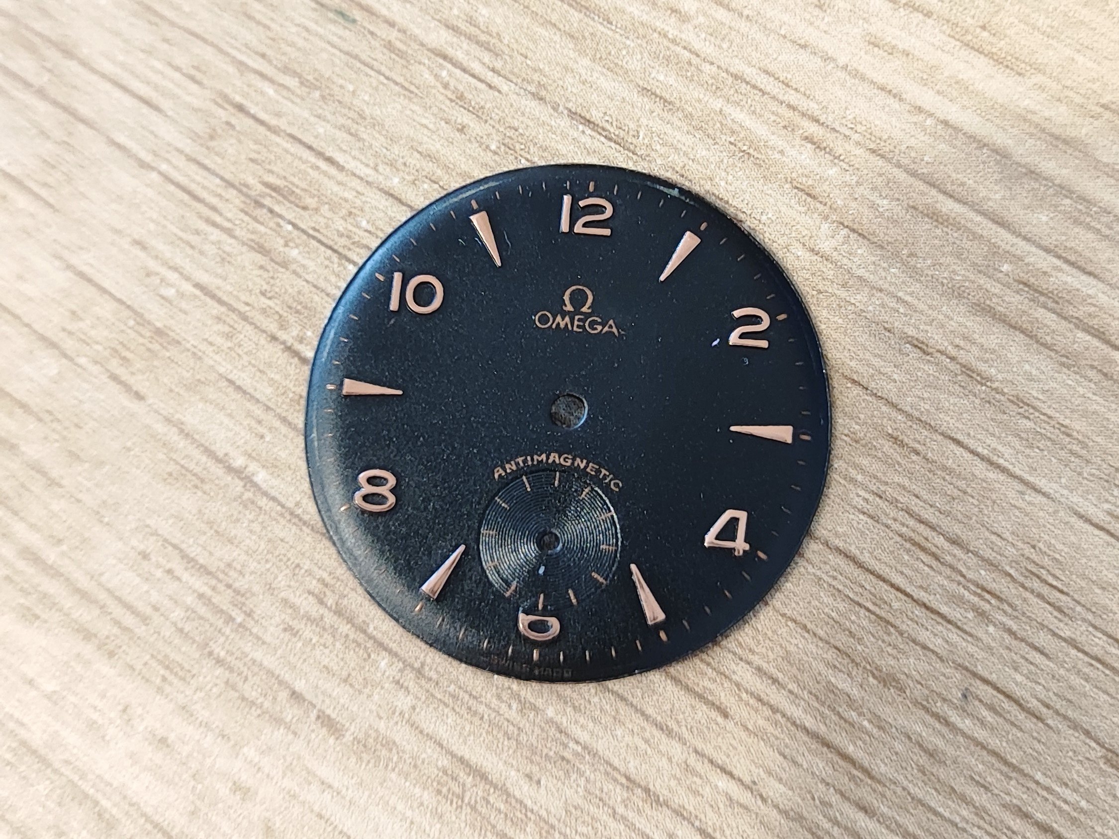

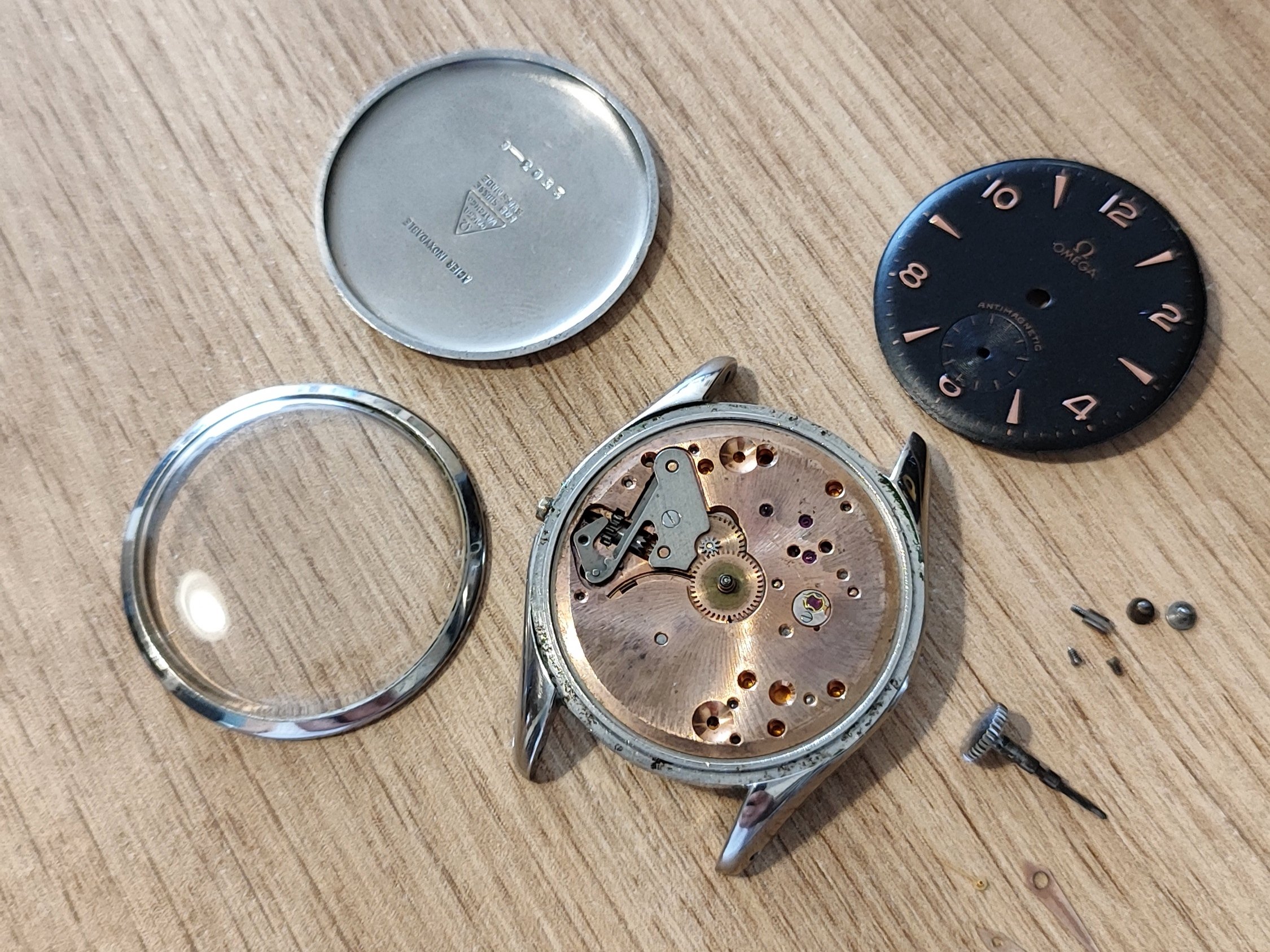

I opened up the watch to better inspect it and also take measurements of the dial and hands. My plan is to do a service on the movement myself, but that is in the near future; have a few more tools to order and build up the courage. Right now, I have to get the crown wheel core screw that's missing. Find out that one of the case screws has been replaced with a smaller one that barely stays in place, so that's for replacement too.

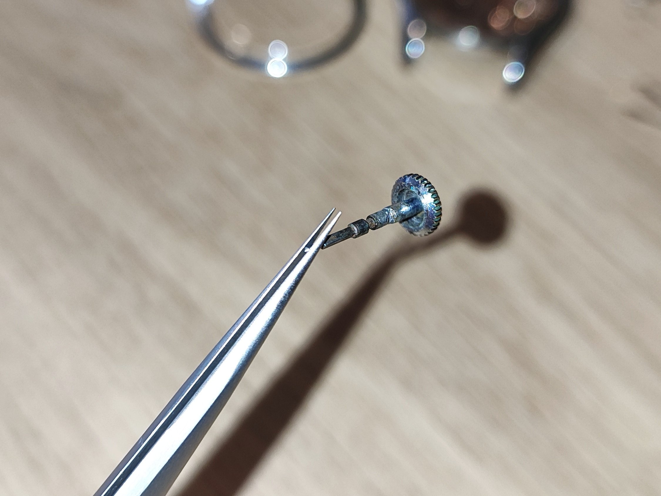

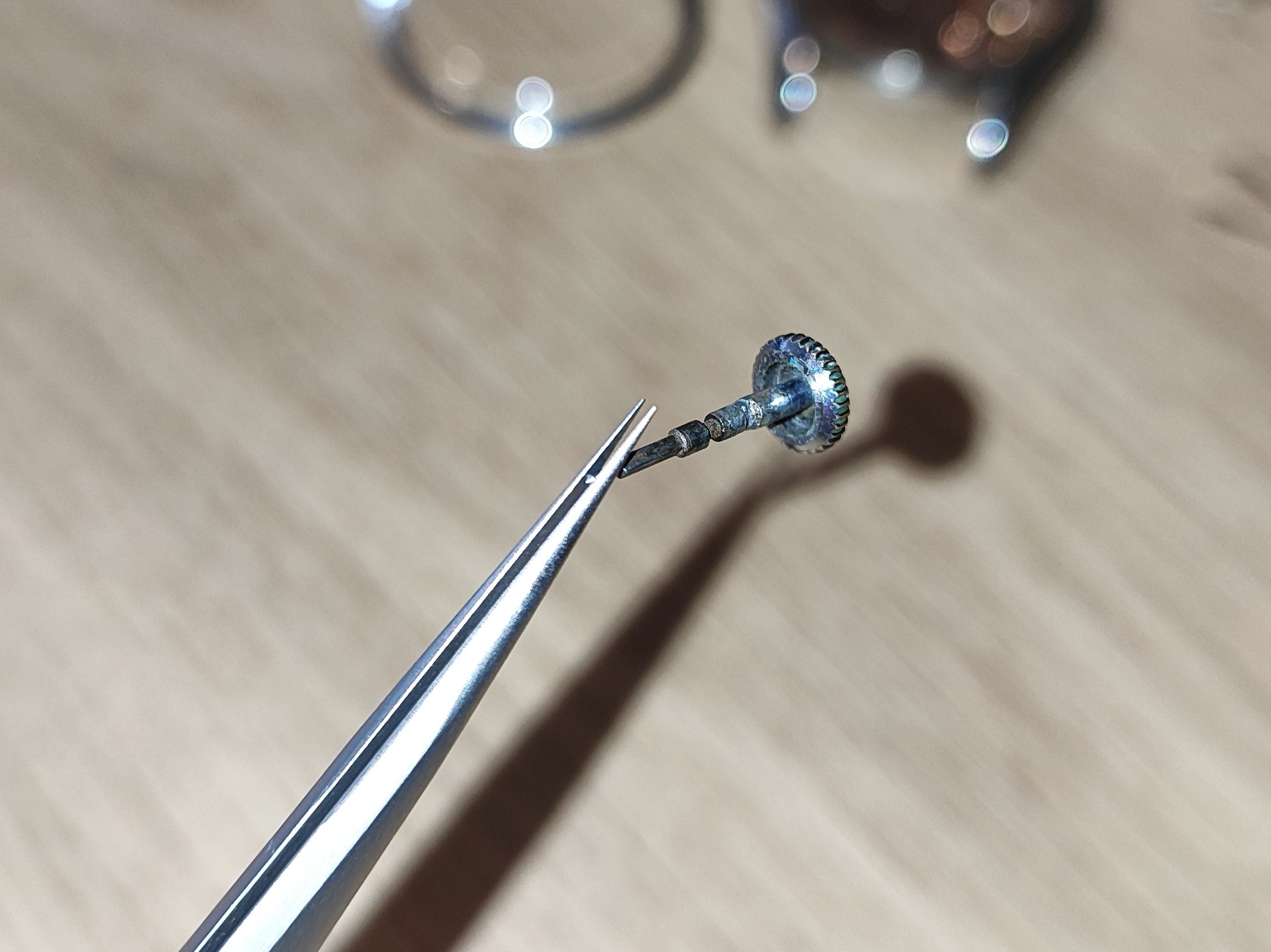

The crown also seems to have been fused in some way to the stem. Maybe the crown had a different thread and converter tube of sorts was used; I'm not really sure. I'll see if I can save the stem.

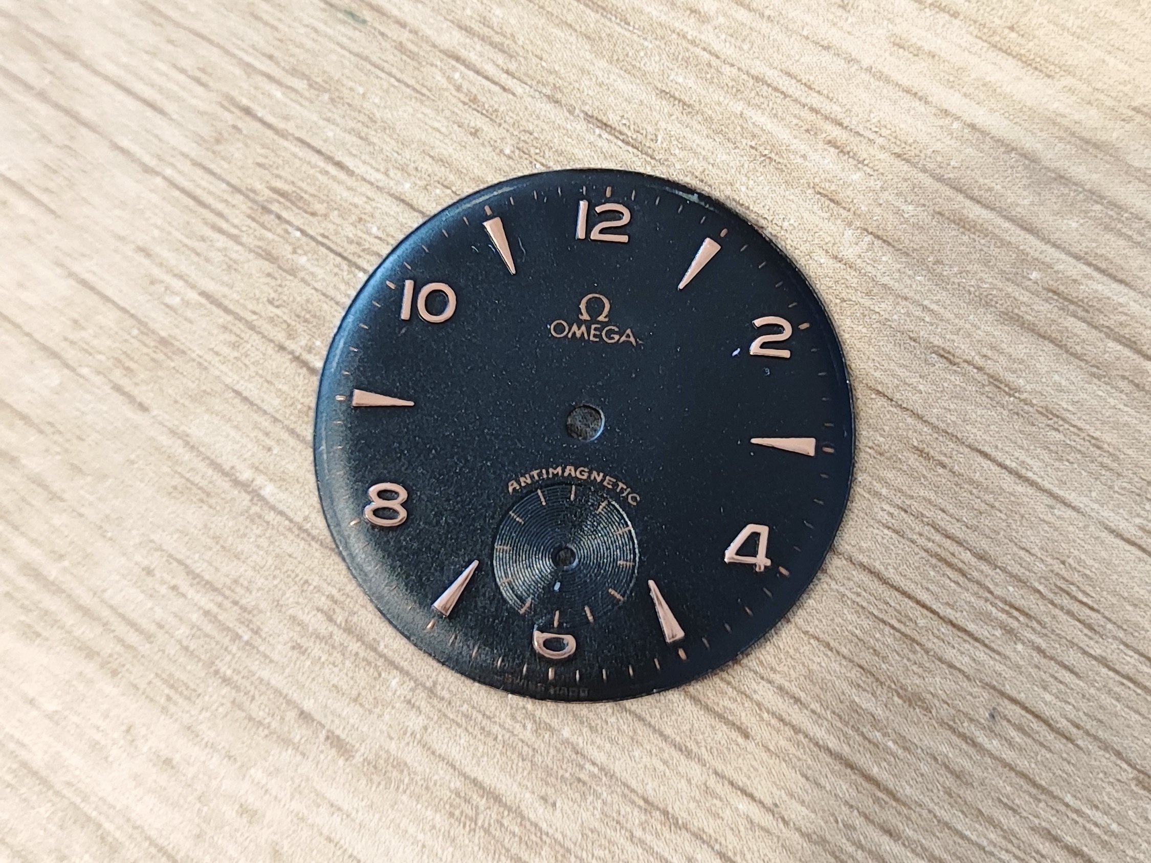

Finally, a look at the dial on its own.

Yes, the Swiss made inscription is indeed present.
In my opinion, the dial is original, but repainted. Apparently because black looks cool.
There is an option for you - find someone who can repaint it again, but more correctly (correct placement of the Swiss made inscription, remove the anti-magnetic inscription, just paint it better)
The crown, it seems, was simply soldered onto the winding shaft... So it didn't fit. You can try to unsolder it, you need to contact a jeweler.
It's a solid suggestion, something I didn't consider. I'm not sure about the dial being original though, as it has nothing on the back. No writings at all, which I don't know if it's usual with dials of this era.
As for the crown, yeah that seems to be the case. I'll try to unsolder it myself.
Are the markers and numbers on the dial attached or stamped?
718
2,107
I don't have access to it as I'm out of country. But I'm sure it doesn't have through-holes for the markers. They are simply glued to the dial.
