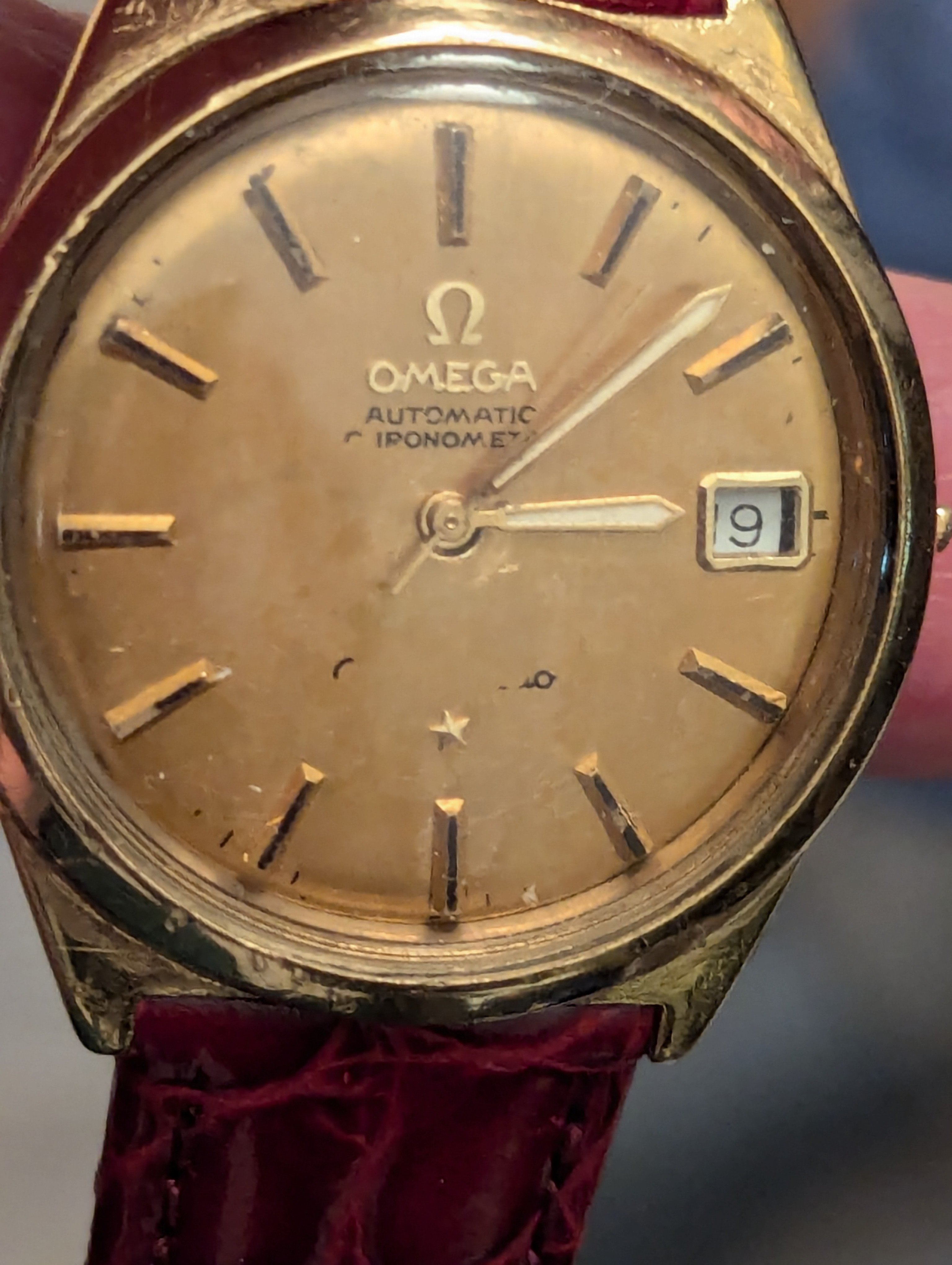

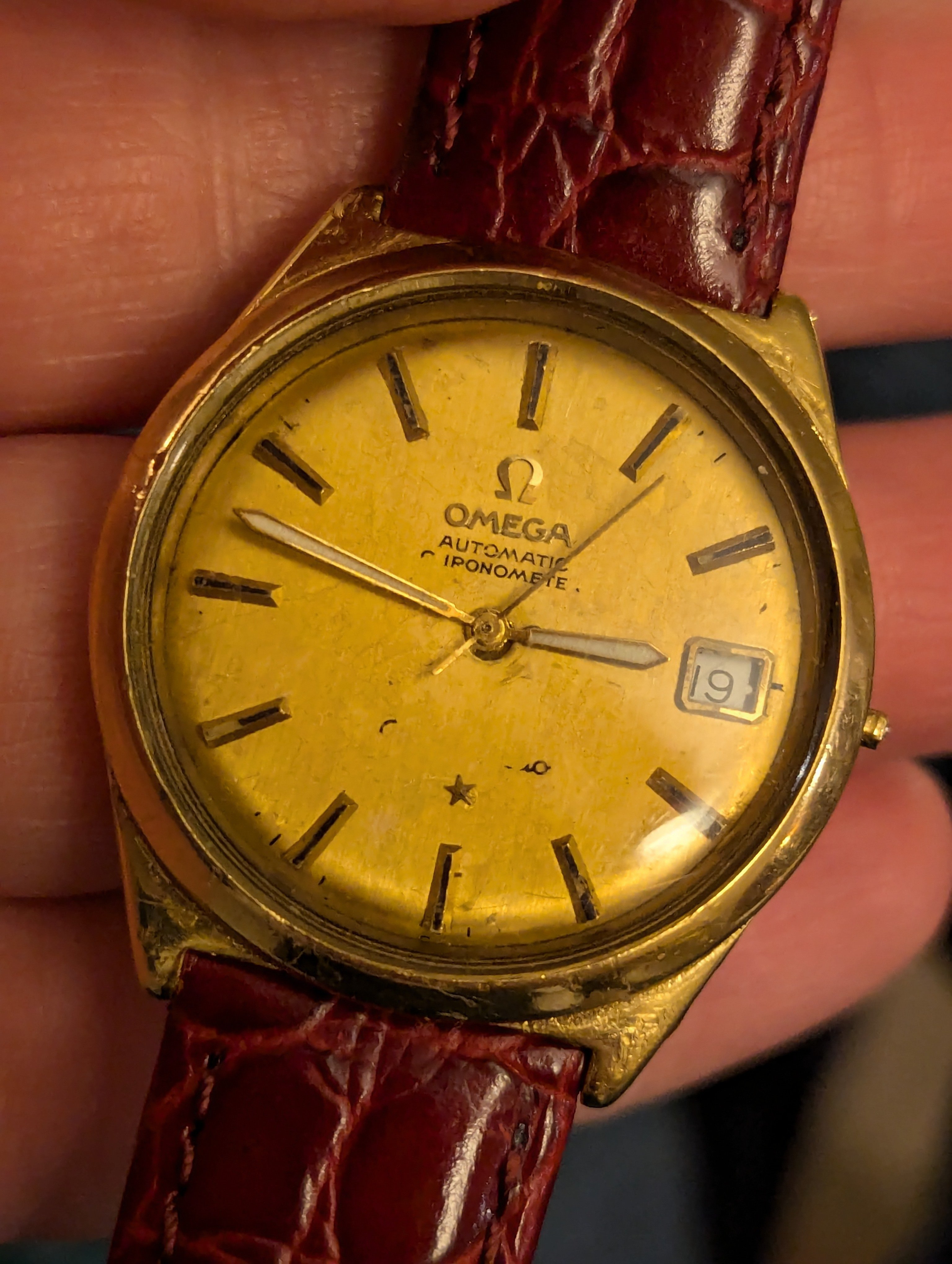

My dad was given a gold Omega by my mom's dad as a gift when they were married, back in 1970. He wore it every day for decades, but never serviced it. Around 10 years ago it stopped working so he had someone try to fix it. I think originally it may have been an Omega-certified shop, and they sent it away but it kept breaking after that, so he ended up taking it someplace else and then (sigh) had the guy replace the internals with a battery-powered quartz watch. I know... I know... None of this was my call!
So now even that has stopped working and the watch has been sitting in a drawer for at least a couple of years. He's now just wearing my old Seiko, on the somewhat-original gold band from his watch. It was a gold weave-style band that wore through, back in the 90s and he had a jeweler melt it down and remake it into more of a smooth gold strap... kind of hard to describe and I don't have a pic, but that at least is still holding up! I believe it has the original Omega buckle on it.
In any case, my question is, what (if anything!) is my best chance of restoring this back to a real functioning automatic Omega? Sadly a lot of the markings have worn off, I'm guessing from the service malpractice and hackery, but the best I can tell is that it's a late 60s Constellation, possibly 168.015. Oh and the crown is also completely gone...
There's a fancy mall nearby that has an Omega store. Do I take it to them and see what they suggest? Besides the part where I fork over eleventy billion dollars? 😀 Do I scour eBay for a similar late-60s Constellation, pray that it's still functioning well, and attempt to have the internals transplanted into my dad's watch? I know the face is all messed up, but I want to keep as much of the original as possible, for obvious sentimental reasons. I've seen a couple of eBay listings for stainless steel 168.015's (assuming I'm reading what's left of the markings on the back of my dad's watch correctly), with the date but not the day, for around $1k. Maybe one of those could work? Assuming the movement is still working, of course, and not kaput like the one we already have LOL.
So... suggestions? Omega dealer? eBay? Give the whole thing up as a bad idea and just get a smartwatch?? :-p Be gentle please!

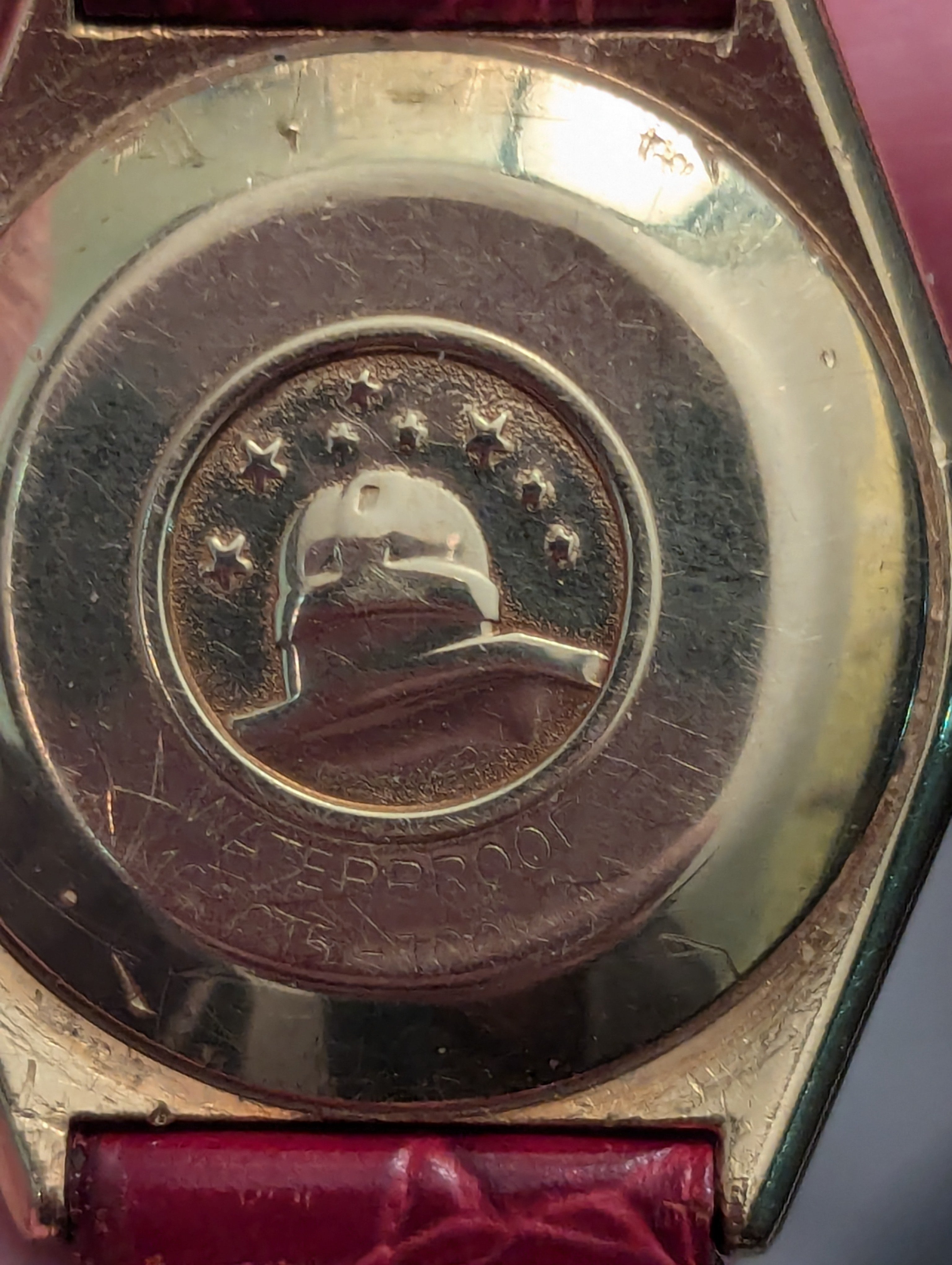

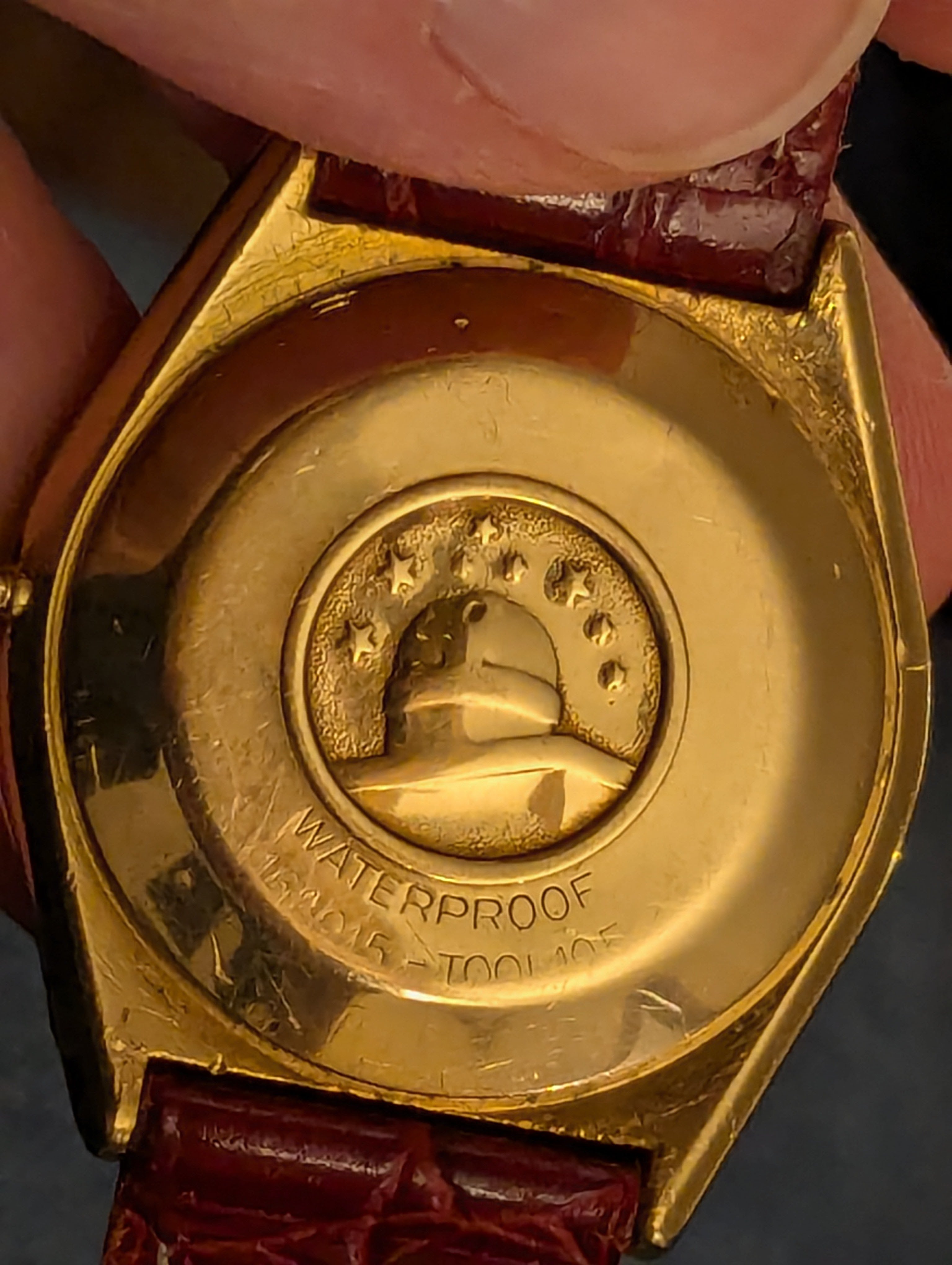

Have a watchmaker open the caseback and get the reference number. You can also try this yourself with a caseback opening ball for a few quid. These are low risk as they won’t scratch it but if it’s seized in place there’s a good chance it won’t work. Saying that, I reckon I manage to open 4 out of 5 casebacks with a friction ball and most of the watches I buy haven’t been opened in decades.
You can then either have your watchmaker source the required parts but I’d be tempted to spend a few weeks looking on eBay for a donor watch watch with the correct hands, crown and movement and then get a watchmaker to use that for the resto. There’s still the chance some movement parts will be needed as most donors aren’t perfect but that’s the way I’d go.

I think this is a monocoque case.

Good shout. I hadn’t noticed that.
In that case I’d send it to a decent watchmaker to find the reference unless you can deduce it confidently from Google.

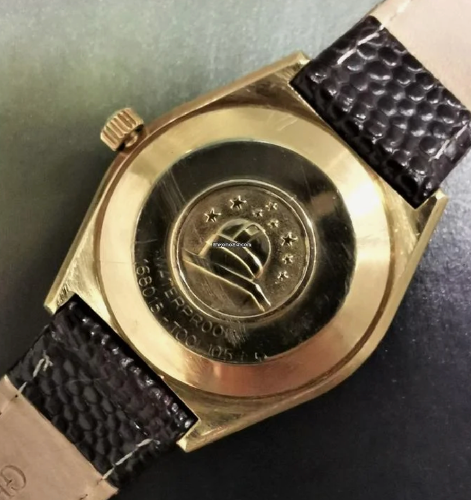

You have the right reference in 168.015
The movt required will be a cal 564.
I've a sneaking suspicion that you have a deluxe version - i.e. with a gold case and a gold dial.
The dial could be repainted - and in this case that is what I would go with.
However, the case is in such bad condition that it will need refinishing too - but there is so much damage, both front and back, that how successful that would be is anyone's guess.
The reality is that with; a replacement movt and service, a refinished dial and a refinished case, a new crown, new hands and a new crystal, the cost will be significant and you could probably find a replacement deluxe 168.015 for about the same price - and it would almost certainly look better. (there is no saving that observatory)
Omega might accept the task of bringing your watch back to life but it will be even more expensive and will take forever.
I think we understand the sentimental aspect of the watch to you but sometimes you just have to accept that a dog has had its day and there is no point in chucking good money after bad. (especially if you don't actually know if your father would want you to spend thousands on his old watch)

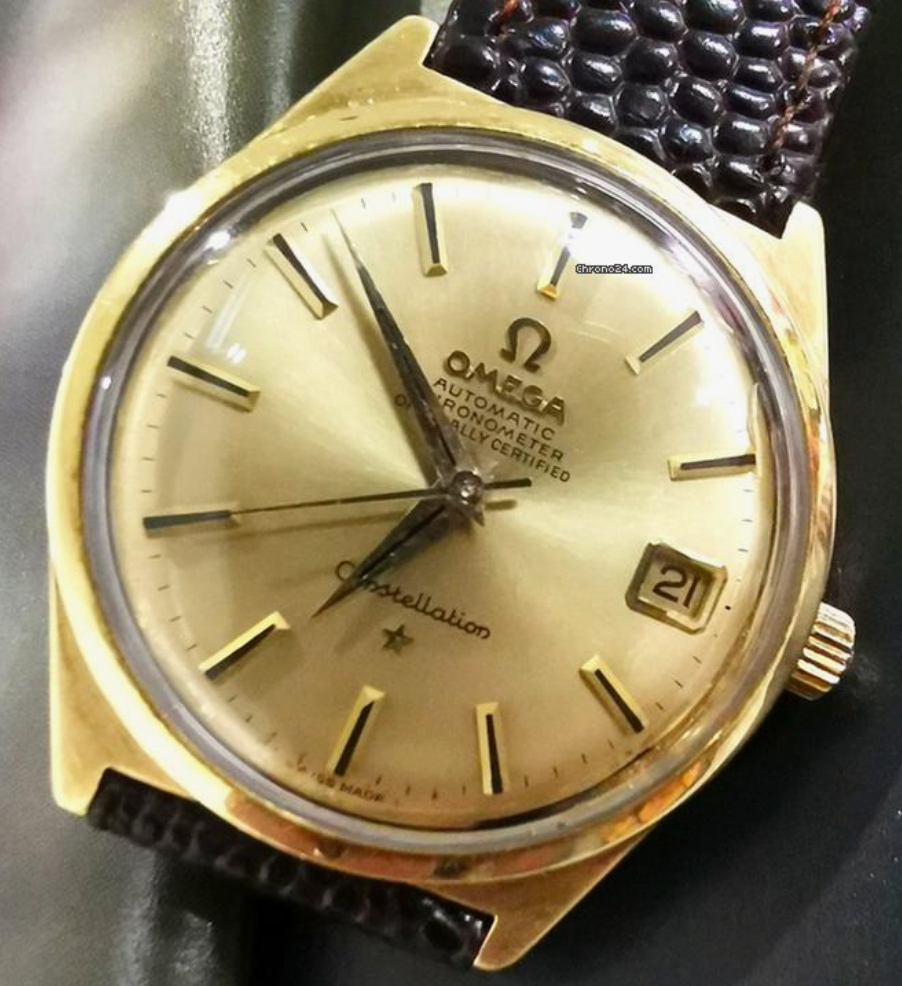

a quick delve into Chronograph24 brings up this deluxe 168.015 for $3000 (and their prices are always way over the top)
https://www.chrono24.co.uk/omega/om...4923736.htm?searchHash=6a2474bd_DYkCED&pos=11

What no one seems to mention is. That in order to fit the quartz movement into the case. The dial posts may have been cut off and dialed stuck to movement with sticky dots? Or whatever they’re called
Any current replacement crows are gold plated, so those will have a brassy look, but not much you can do about it
