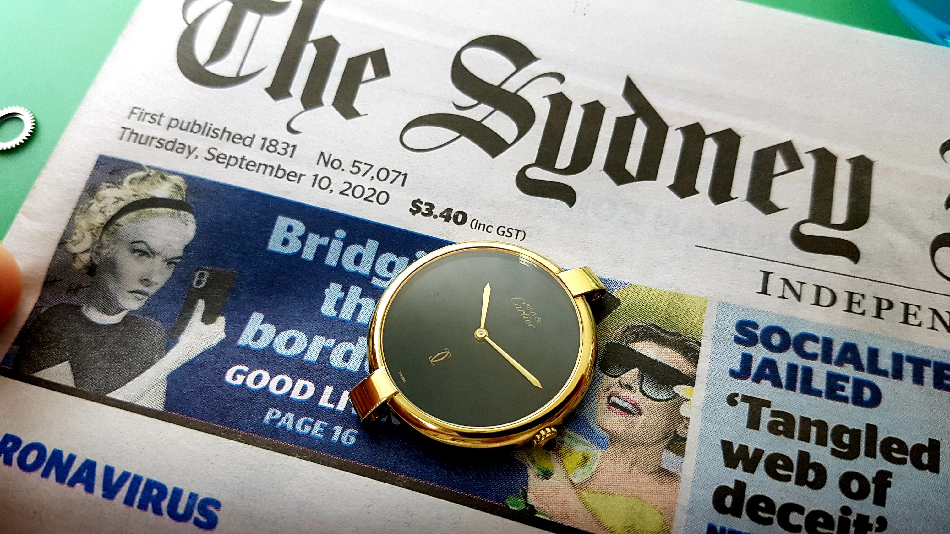

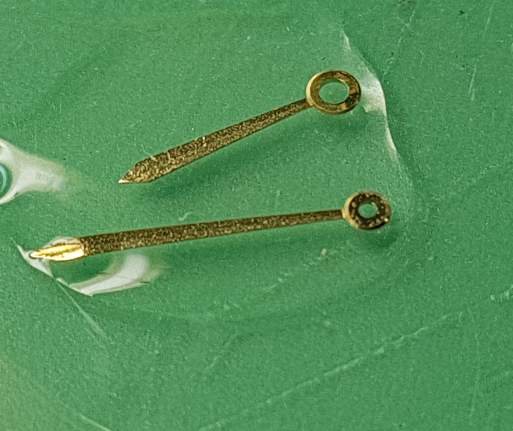

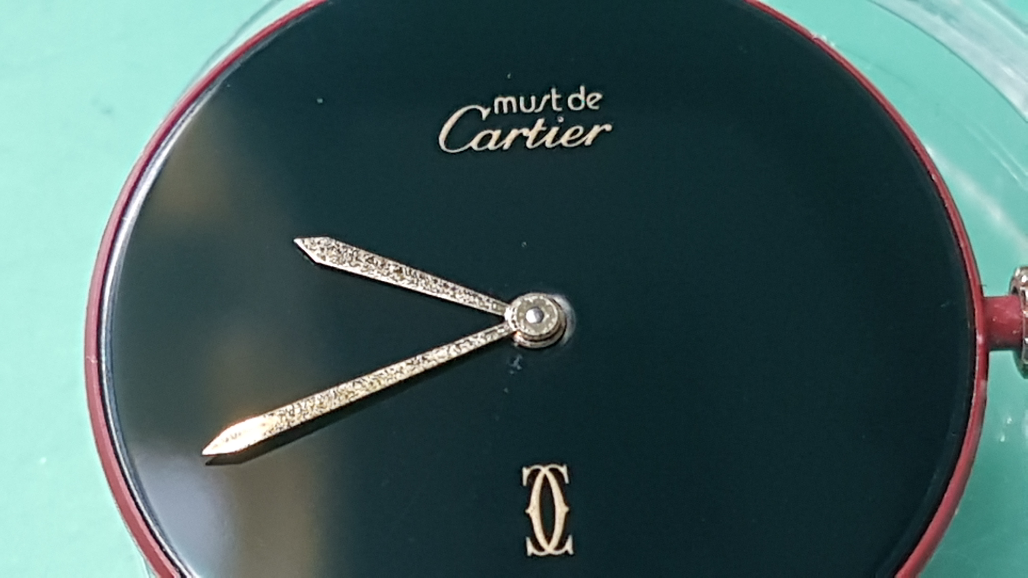

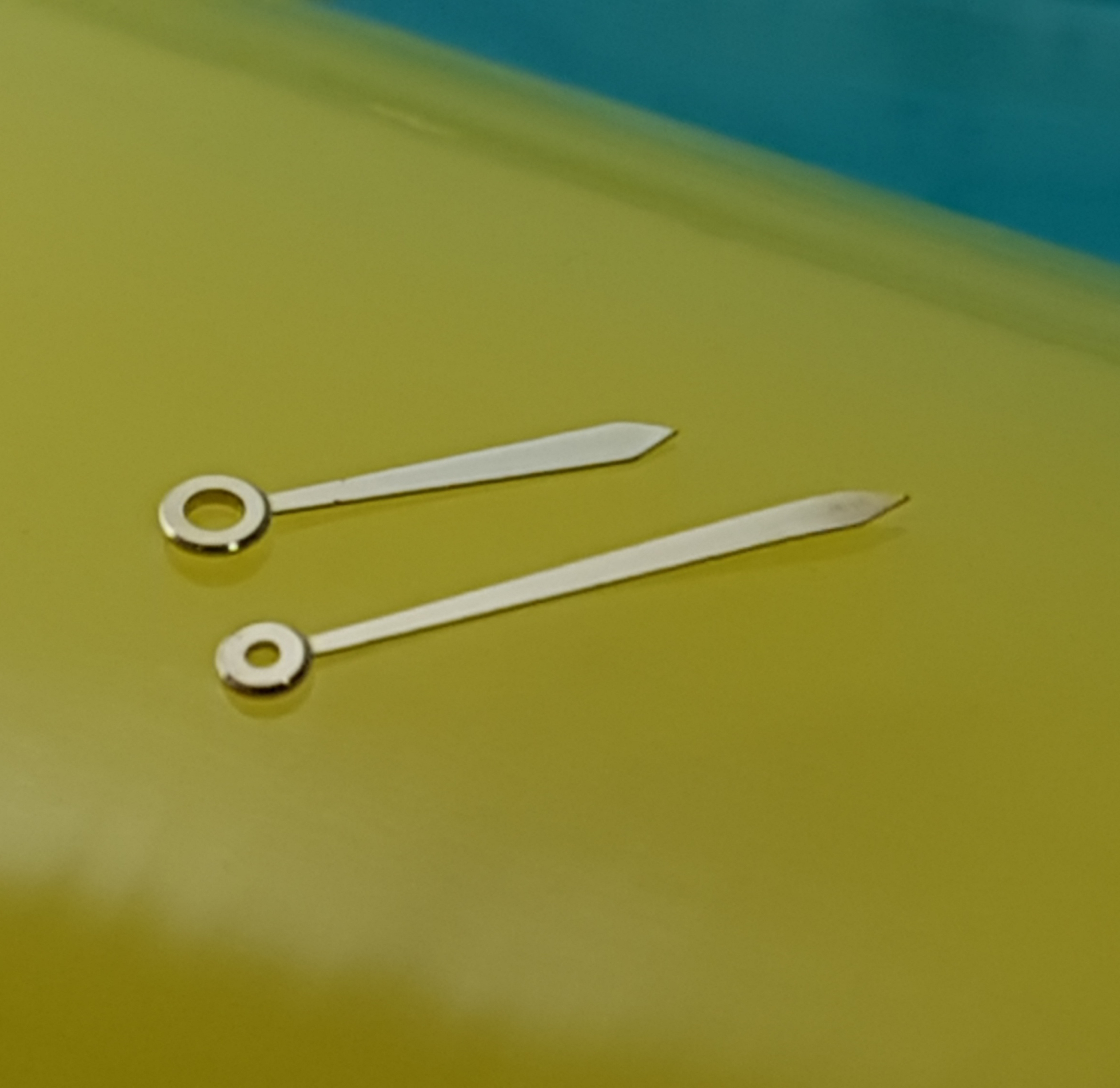

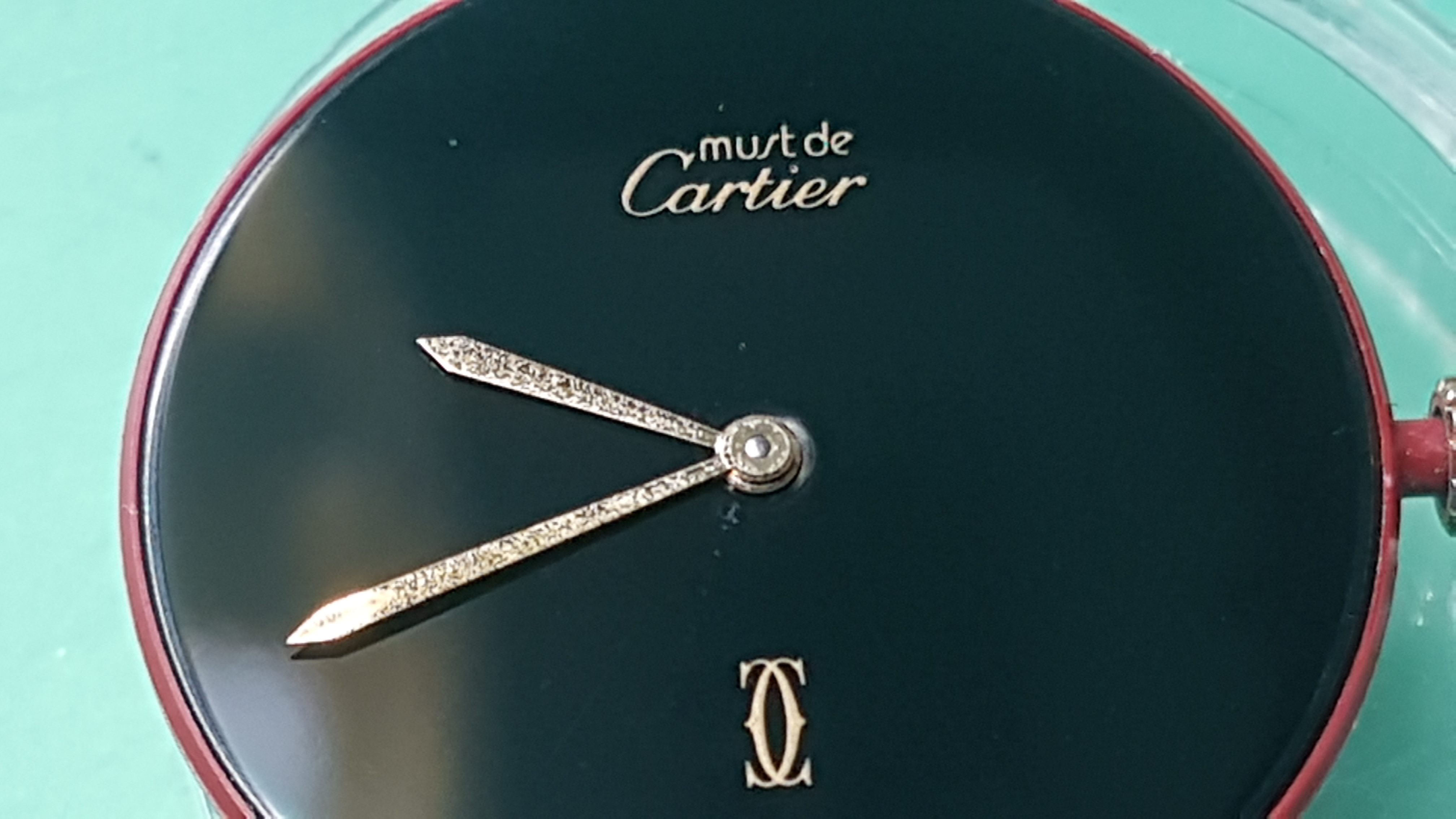

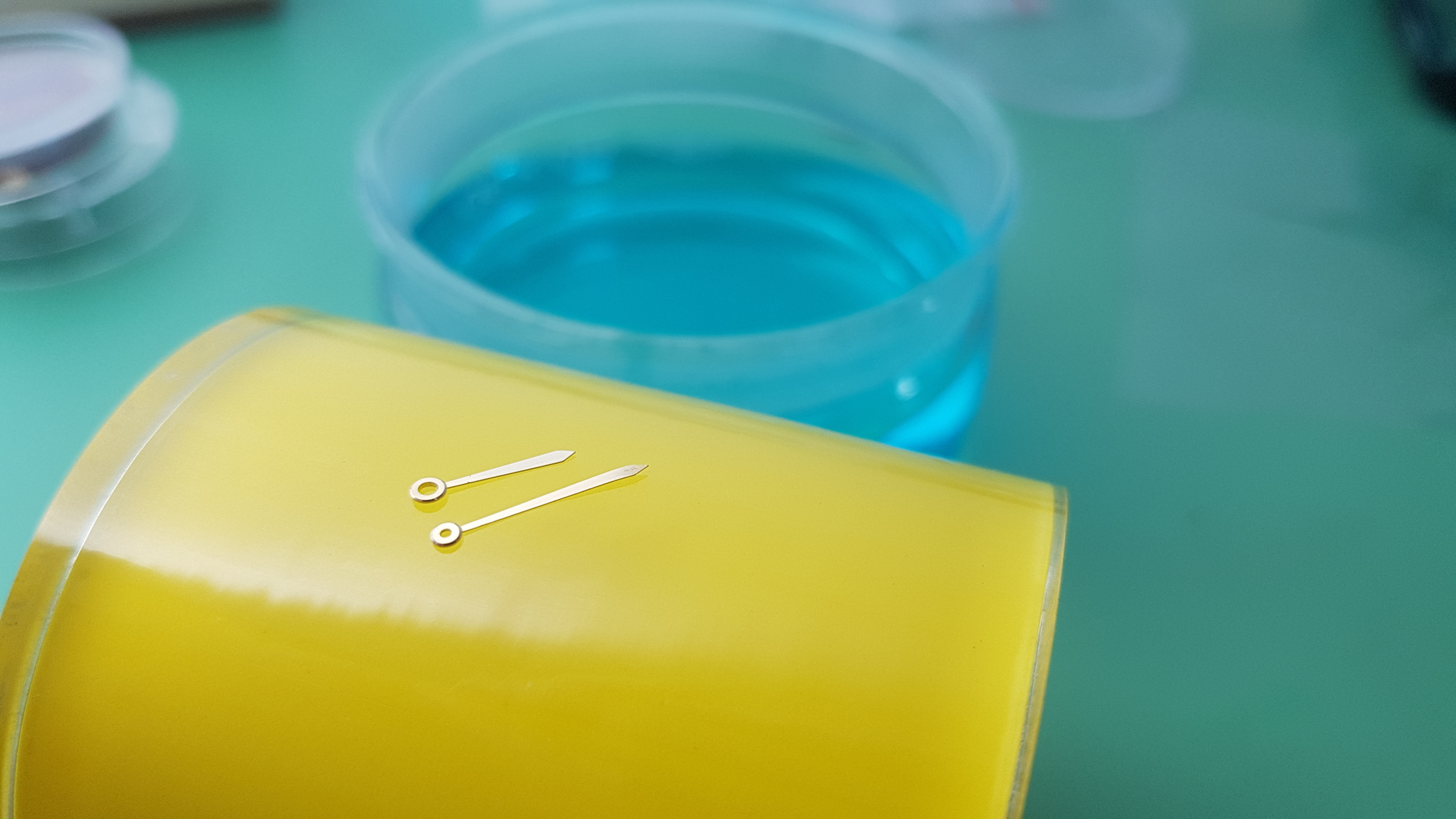

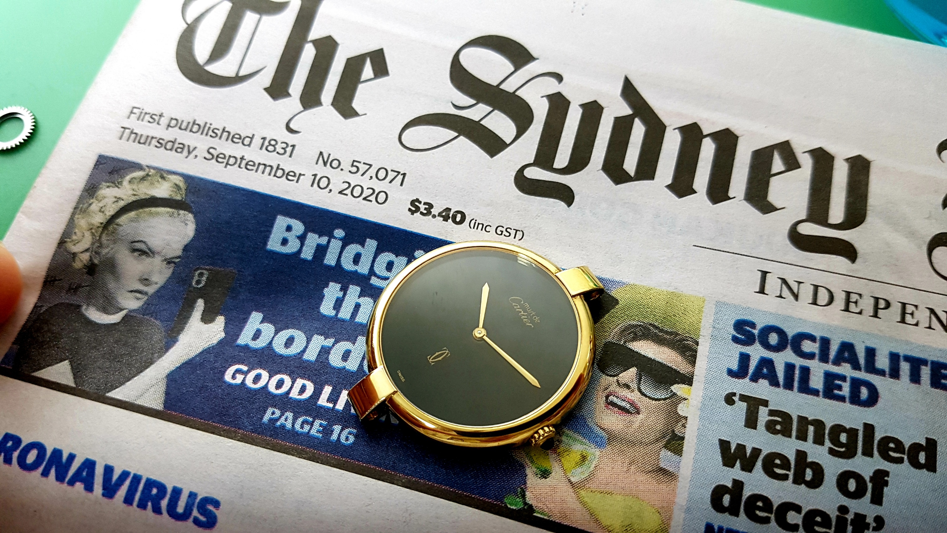

Success rate? How about 10 out of 10?
Blue stuff, pitted and heavily oxidized gold hands, customer's watch - done as we speak (note the date).

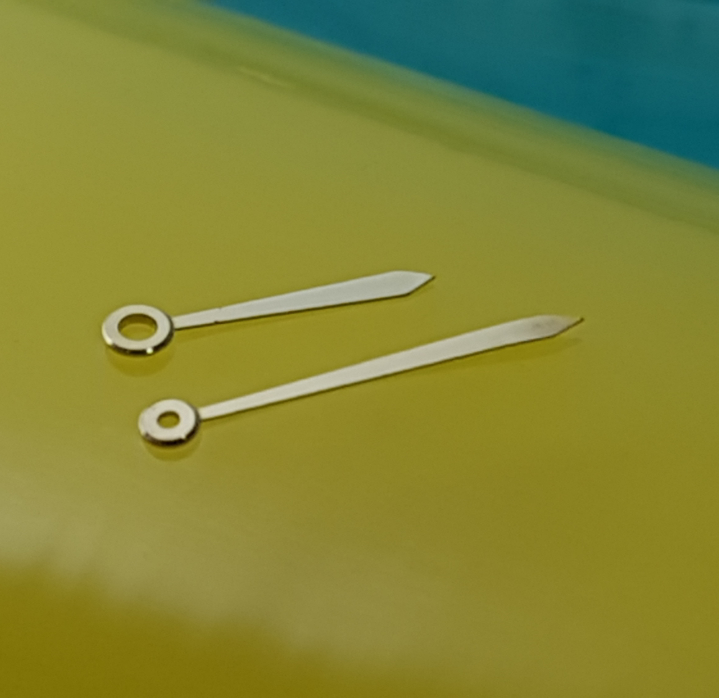

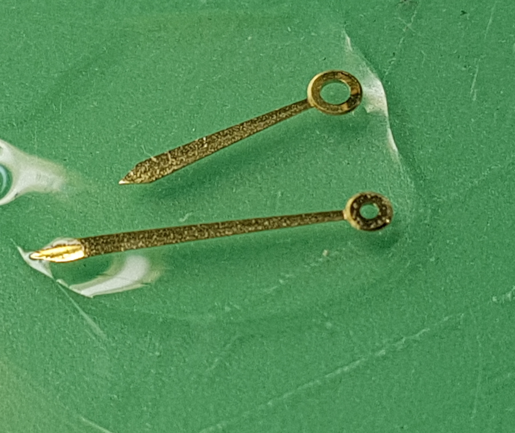

$3.40 for the SMH nowdays?
Phew, glad I'm in Melbourne, only $2 for our version.
