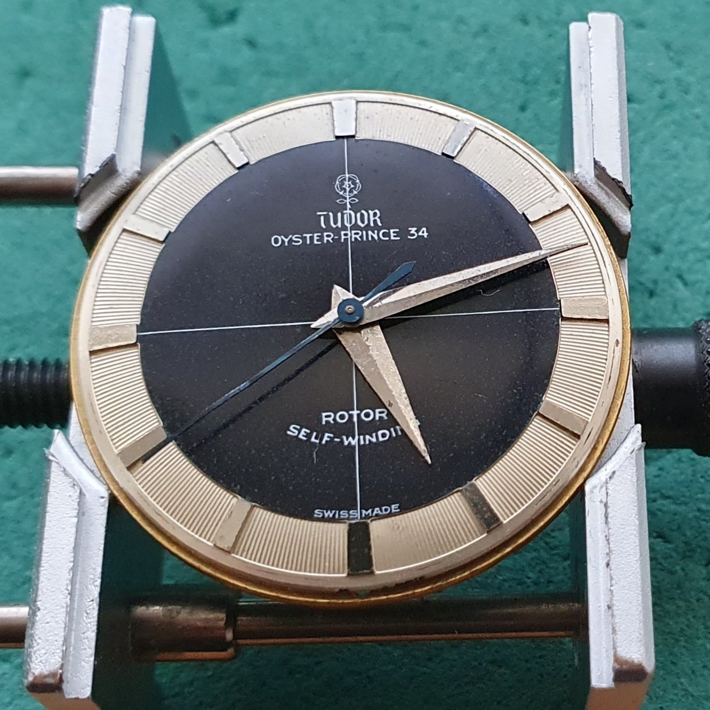

I just posted a video of a Tudor 390 restoration
5
14
Hi everyone, my friends know I have a soft spot for this caliber 😀
I condensed 2 days’ worth of work into a 12-minute video and concessions were made in terme of compression quality...
The watch will be given to my son’s girlfriend.
Let me know your thoughts.
Cheers

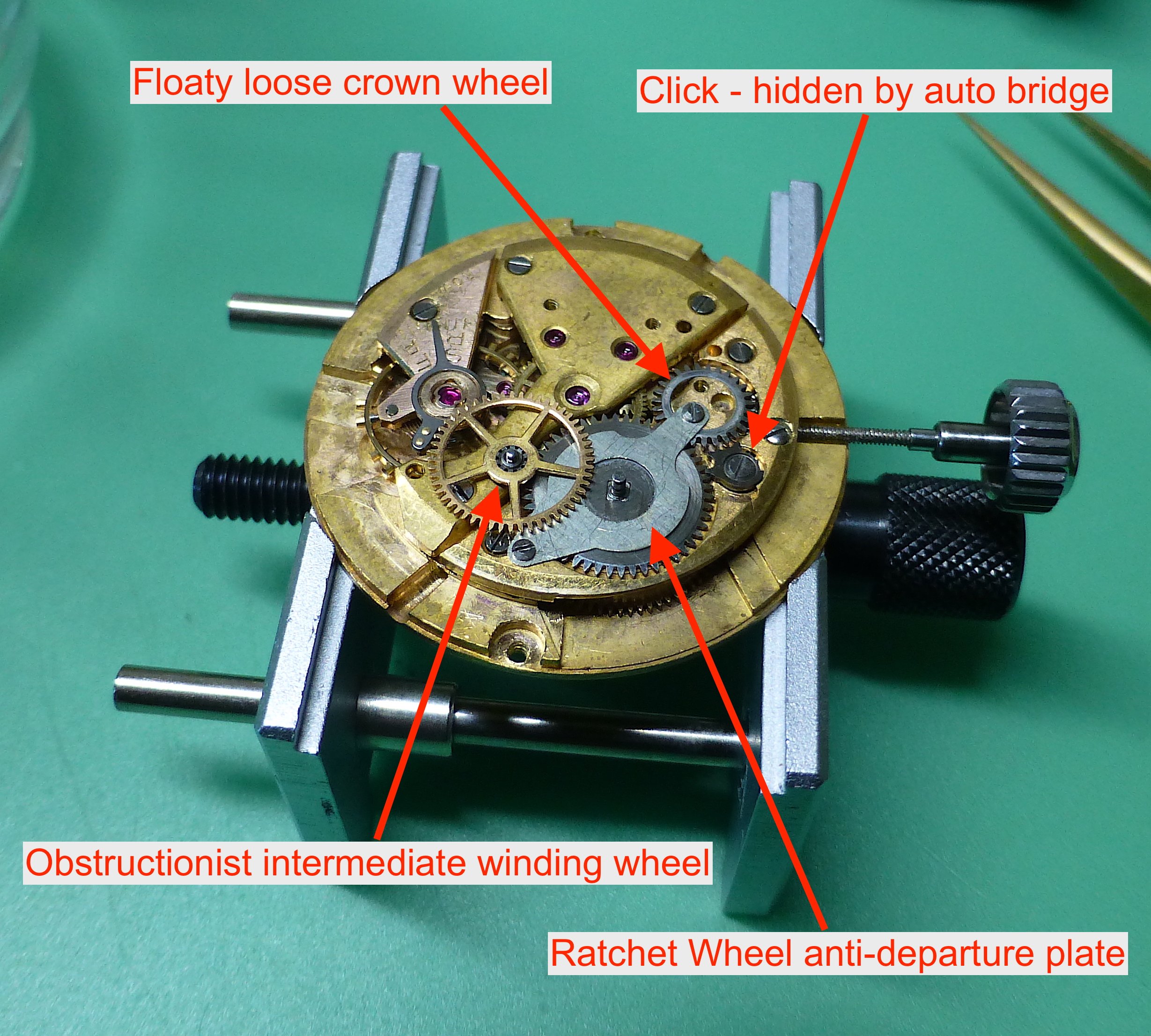

AFAIK the auto winder is problematic on this calibre. If you have one with an issues, would it be possible to pull that module and use the watch as a manual wind?
18,835
39,169
It can be problematic if not serviced (lubricated) correctly.
Even if you wanted a manual, you would still have to install the auto-wind bridge (sans cogs'n'bits) as it holds stuff together on the base caliber (FEF 380/390). Here is a "manual" version just needing the bridge to keep everything in place.

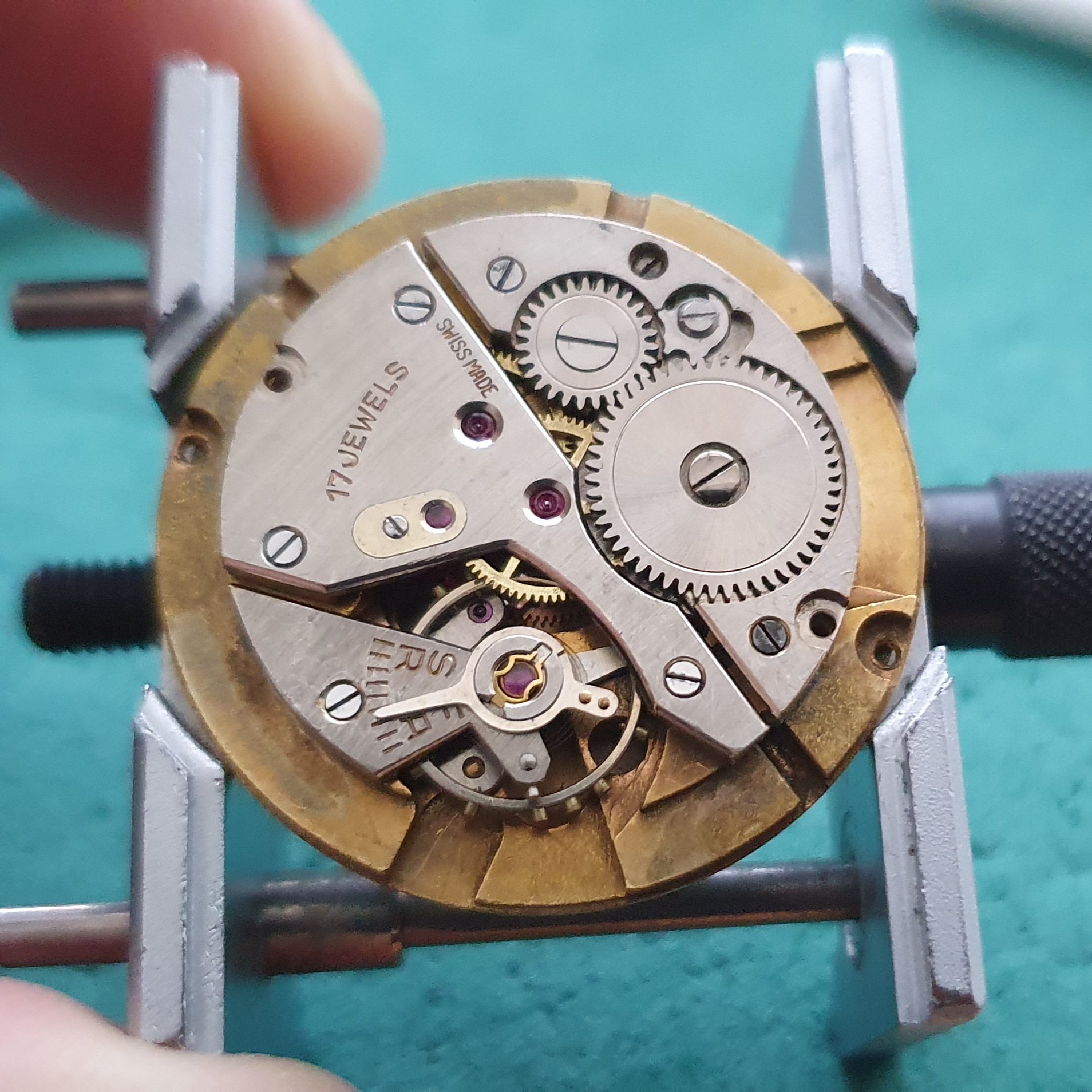

I solved the problem by installing a complete FEF 380 on a 390 Tudor main plate, it works well and makes for a great everyday manual Tudor:
