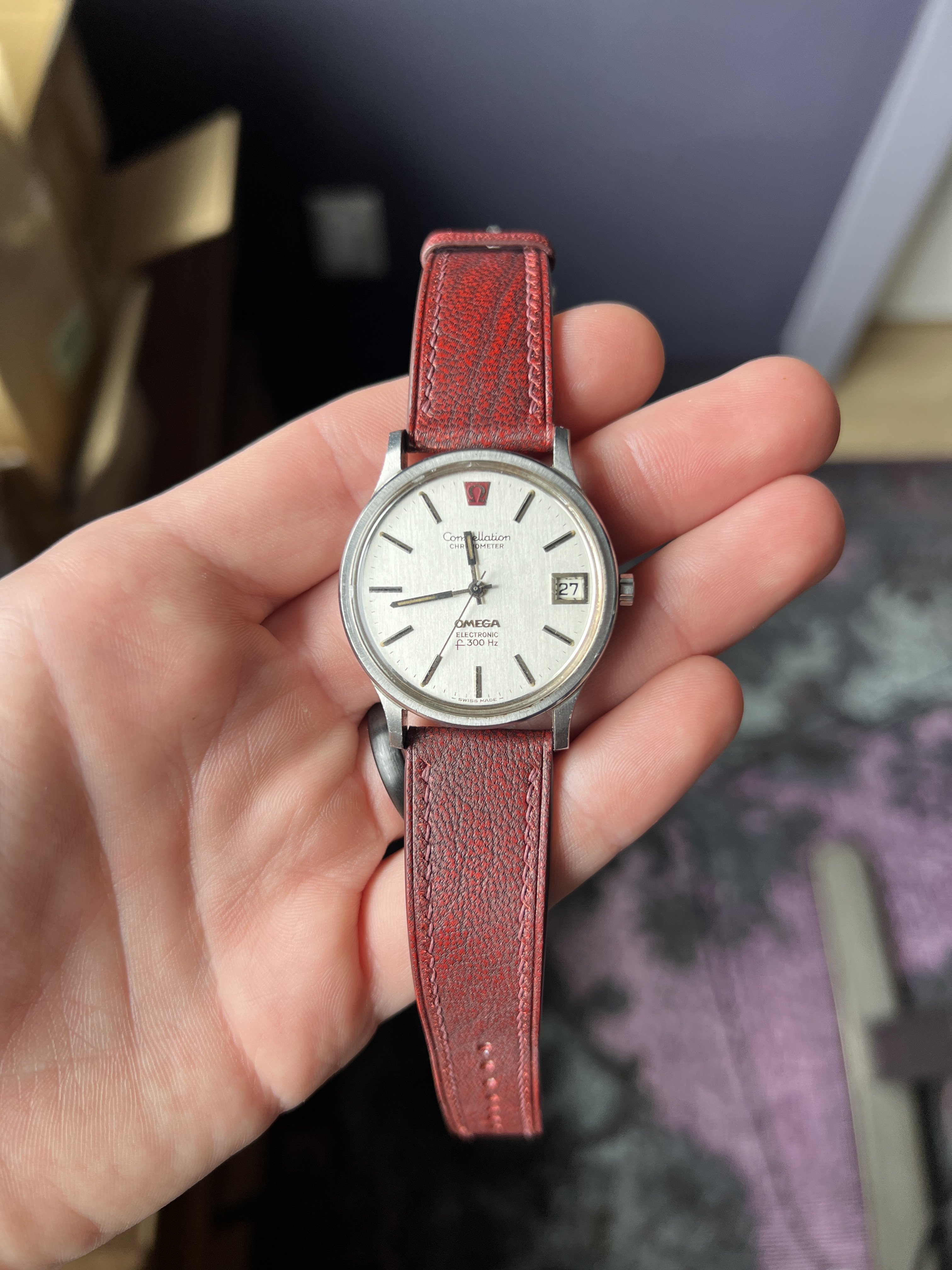

Hey folks,
First things first - this forum is a wealth of knowledge that I deeply appreciate. I've searched it many times as a non-member, and finally came across a question I can't search up the answer to.
Based on the research I've done, my stainless 198.003 takes a 5106 crystal. In searching the net, I've come across a couple variations of the 5106:
- PZ5106 is the 5106 with a silver tension ring
- PX5106 is the 5016 with a gold tension ring
an "L" on the end indicates a magnifier.
Am I correct in assuming that the PZ5106 is the correct crystal for this watch?
194
492
I looked on the extranet, there is also a rose gold tension ring variant:
063PY5106 | GLASS PLEXI 5N RING D31.62 H4.15
It does look like all steel case variants of this watch use this for a non-magnifier crystal:
063PZ5106 | GLASS PLEXI ST RING D31.62 H4.1
Like 1
27,052
69,029
For...
STEEL CASE CAL. 1250 | 055ST1980003
The two crystals listed are:
063PZ5106 and 063PZ5106L.
So both magnifier and plain crystals are used.
I appreciate your insight here!
