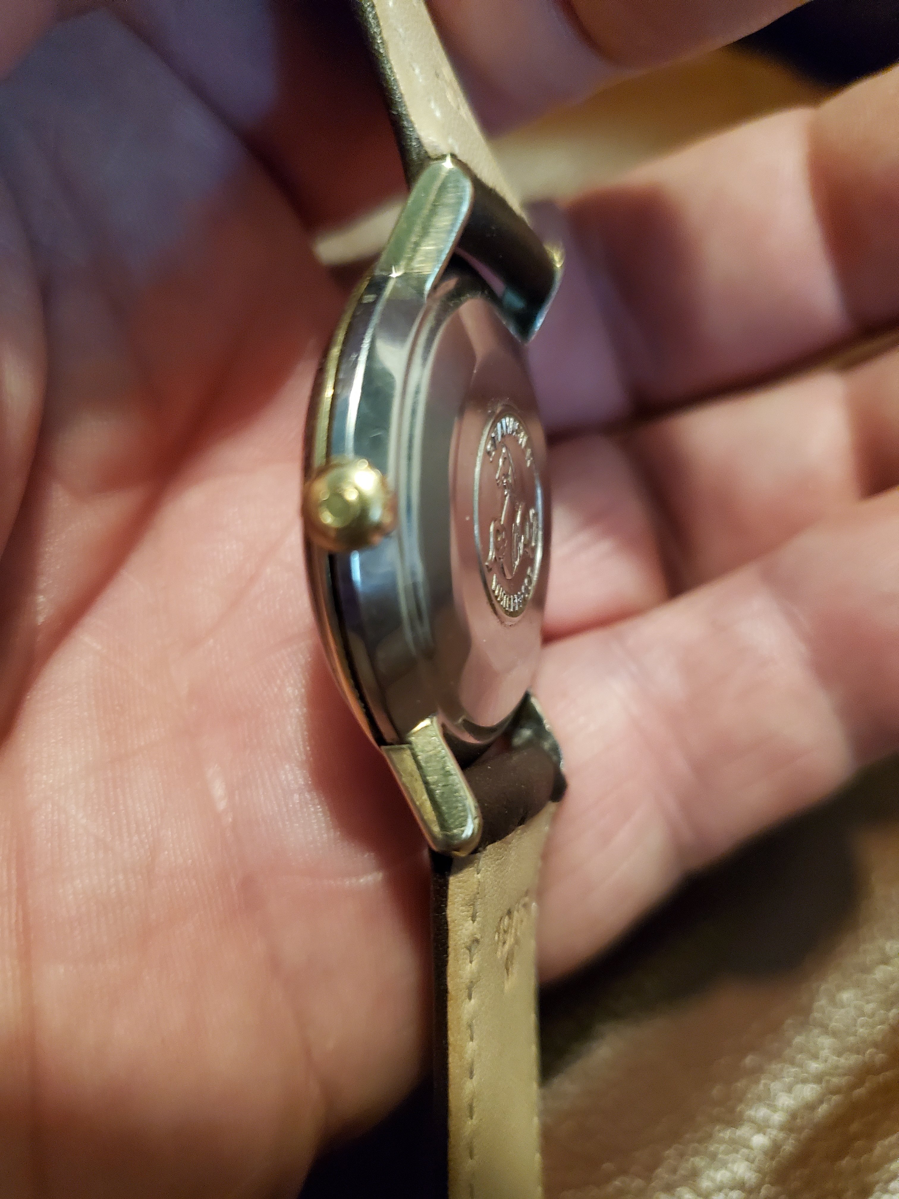

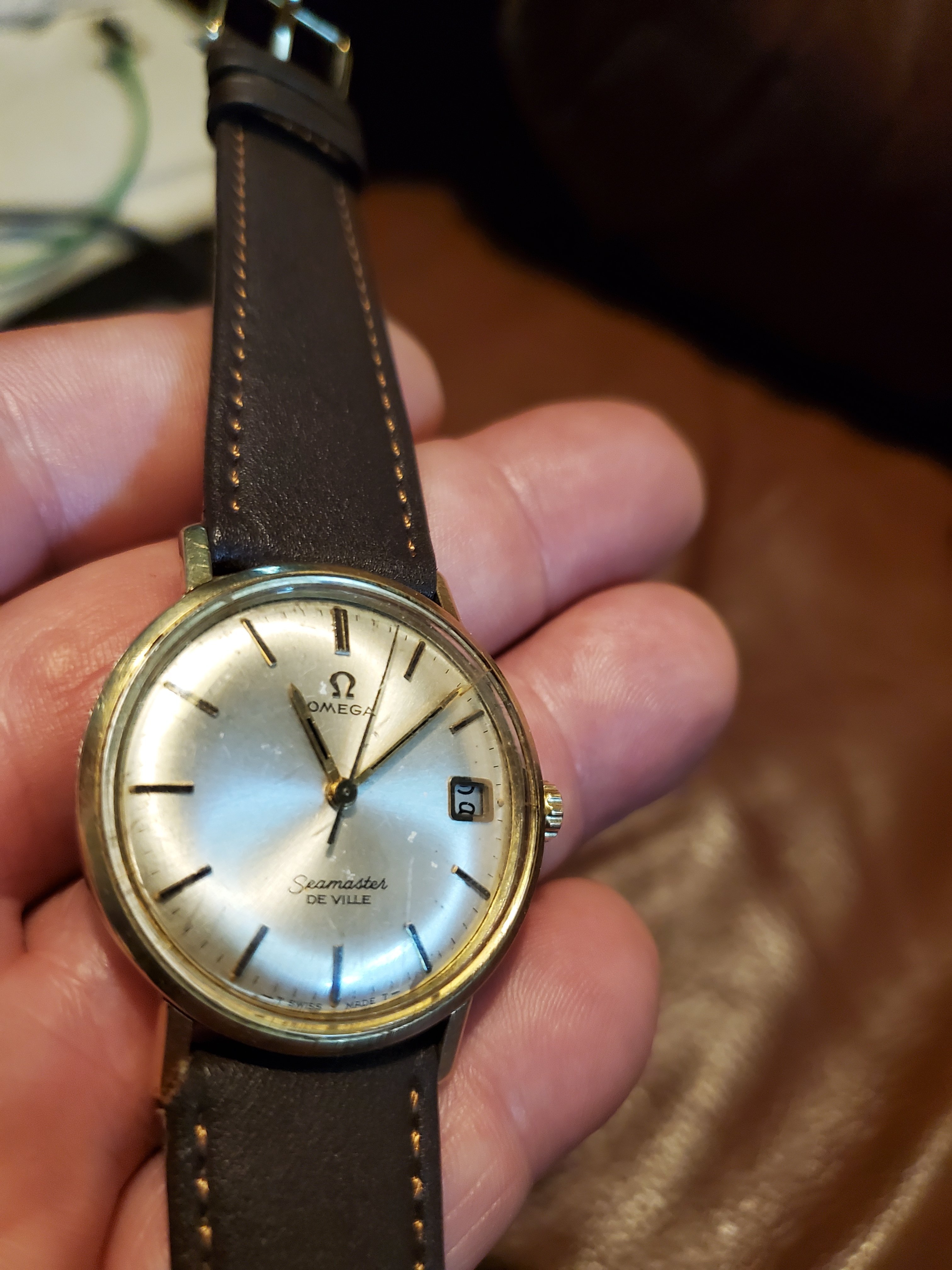

I have a vintage Omega Seamaster Deville from the mid 60s. It appears to have a one piece case, with the back not being removable. The crystal is a signed original, but it has a crack in it. On inspecting this further, I removed the bezel, and the tension ring has a crack on it too, (and fell out). I have some questions if anyone wishes to assist.
1. It appears that a new crystal should be pushed in from the rear of the bezel, is that correct. (Yes, I know I will have to invest in proper fitting glass press. I live in a remote area, and I expect the nearest Omega service center is 1000+ miles away.)
2. If I can find a crystal (PX5072 I think) from CousinsUK or Ottofrei, that is listed as genuine, will it be signed with the Omega symbol?
3. I take it the tension ring is supposed to be bonded to the hesalite? The reason I ask is that I see someone is selling NOS on ebay for $150 and it looks to me like the tension ring on that one is cracked as well, and I have also seen 5072 glass for sale that is just glass says you have to add the tension ring?
4. The movement is Omega 613. Is this a two piece stem?
5. The bezel seems to snap on and off fairly easily. How was this watch ever even close to being waterproof!?
Thanks in advance for any thoughts, answers, or opinions on any of this!

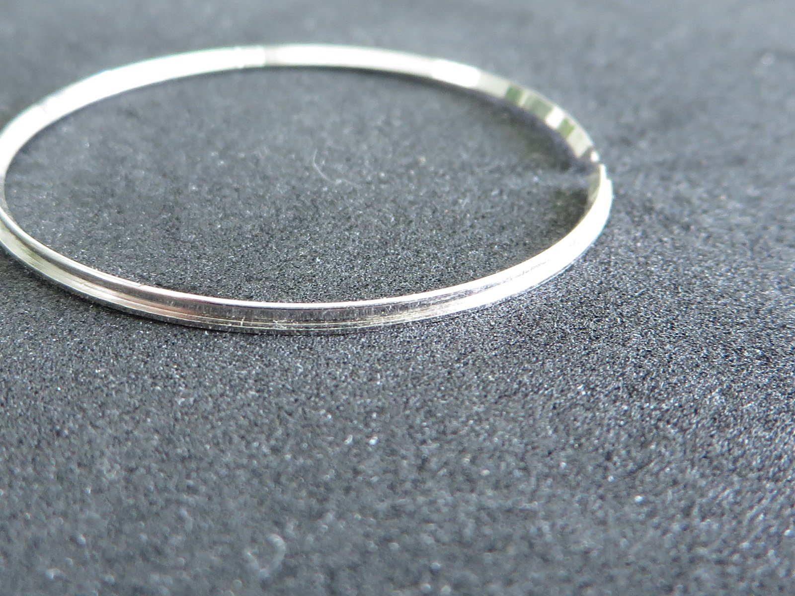

The tension ring it supposed to be split yours is not cracked.

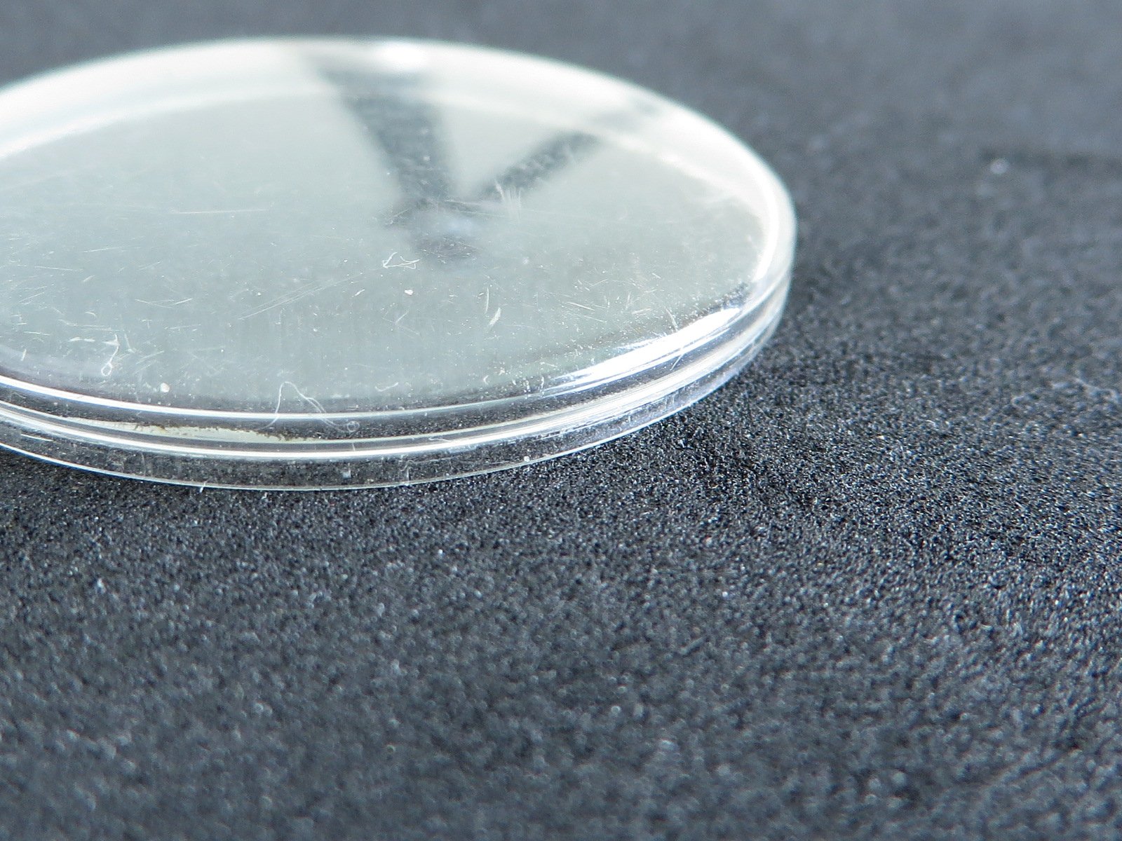

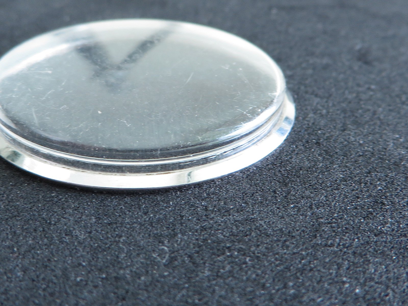

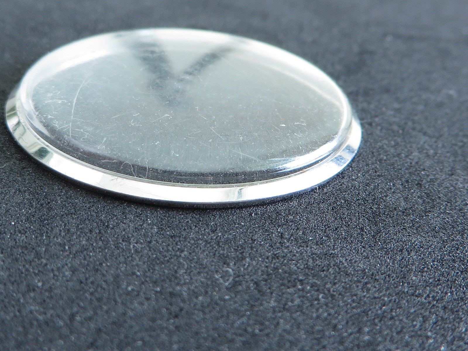

The correct crystal is stepped on the outside, the bezel presses onto the crystal then the tension ring is pressed into the inner groove then the assembly is pressed onto the case, very waterproof.

Bezel fits to the crystal from the underside (if it is a correct crystal it is notched so bezel can not slide over from the top) then fit the tension ring.

As above the tension ring is not bonded to the crystal and it isn’t an unbroken loop, it has a break in it to allow fitting.

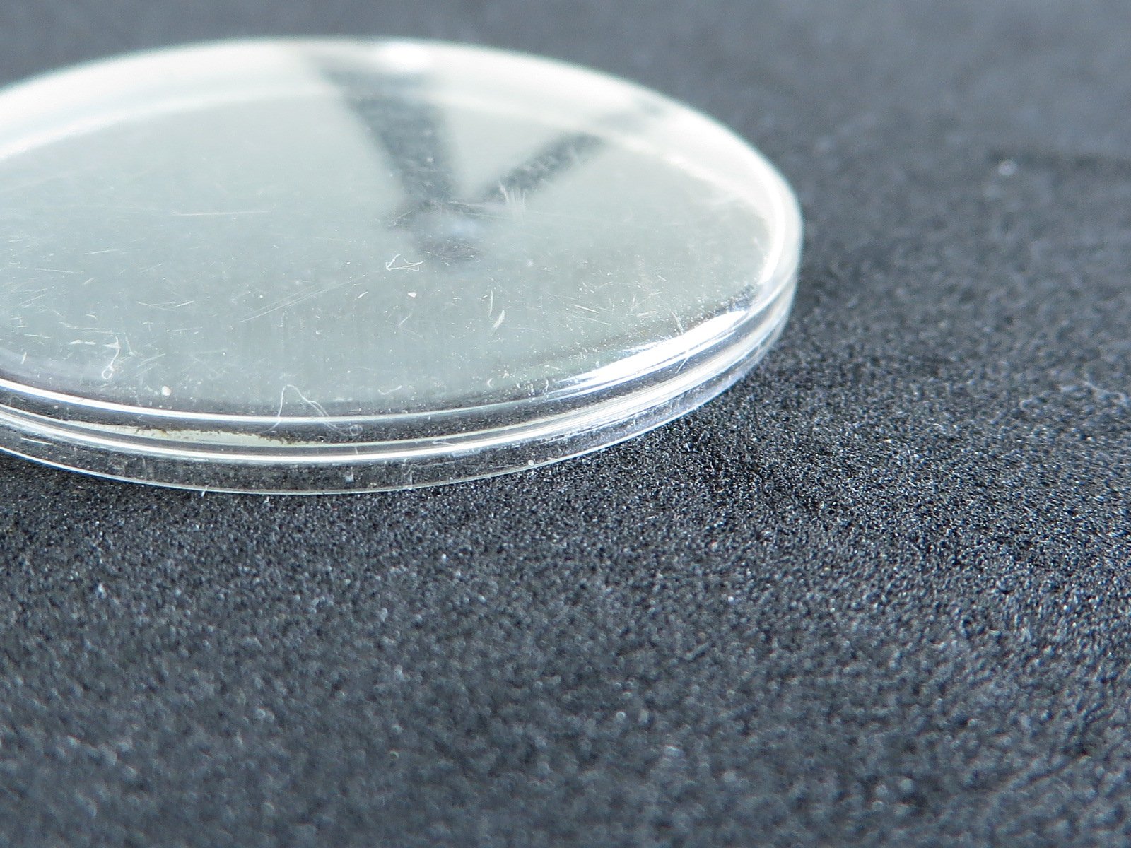

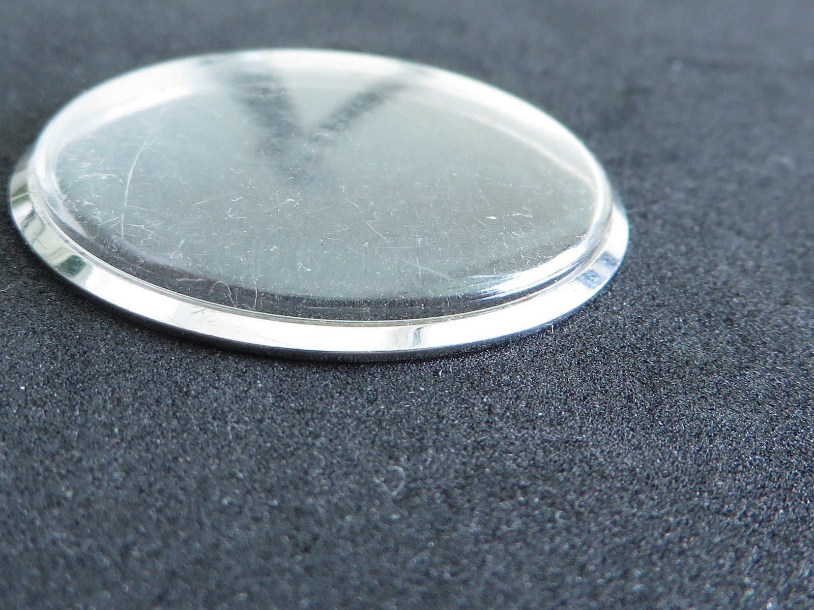

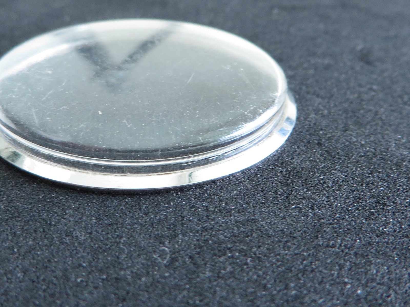

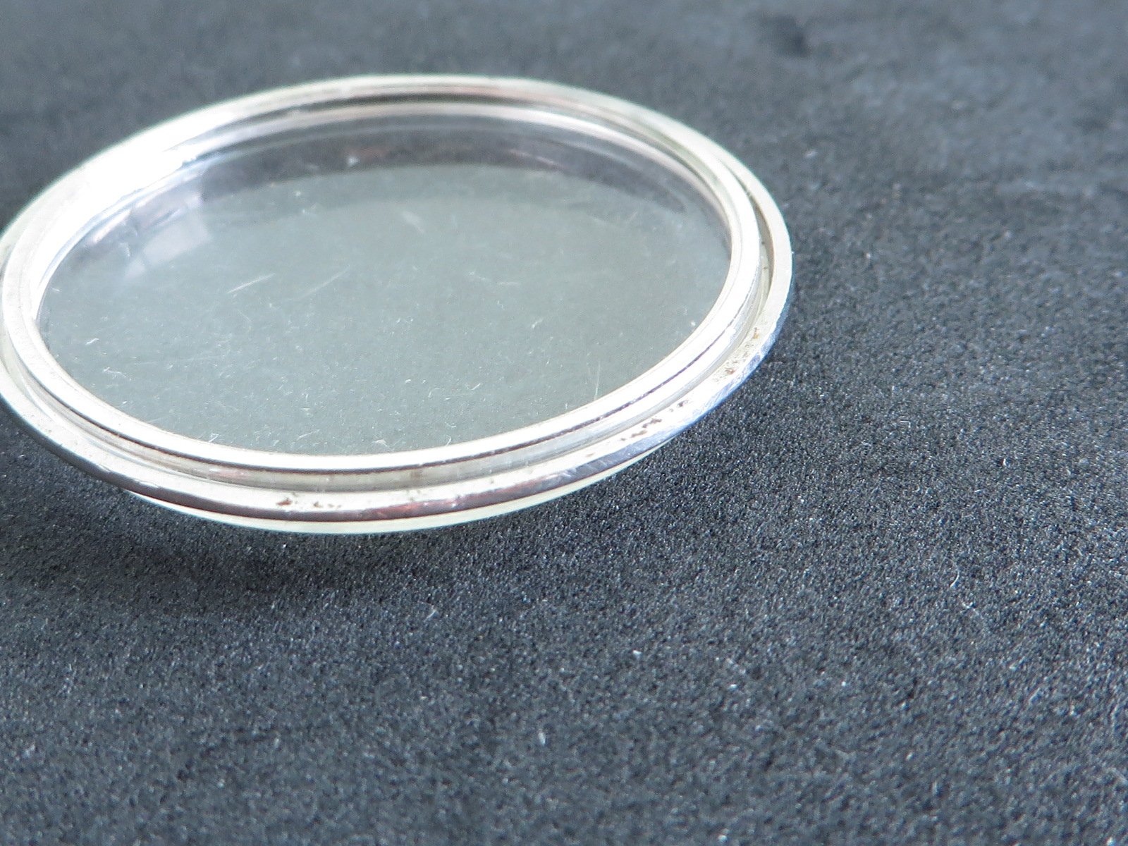

As I previously noted the SDV crystal is notched on the outside this is what keeps the bezel from coming off.
All pieces are hand fitted, bezel fits onto the crystal from the bottom and the tension ring fits into the crystal once the bezel is fitted. Note that the correct tension ring has a flange who's outer diameter roughly matches the outer diameter of the bottom of the crystal.
The reason many aftermarket crystals which supposedly fit the SDV don't is the lack of the notch and or the lack of a flanged tension ring.

I've had good luck with the 5072 from STERNKREUZ. Notched crystal and flanged tension ring.
