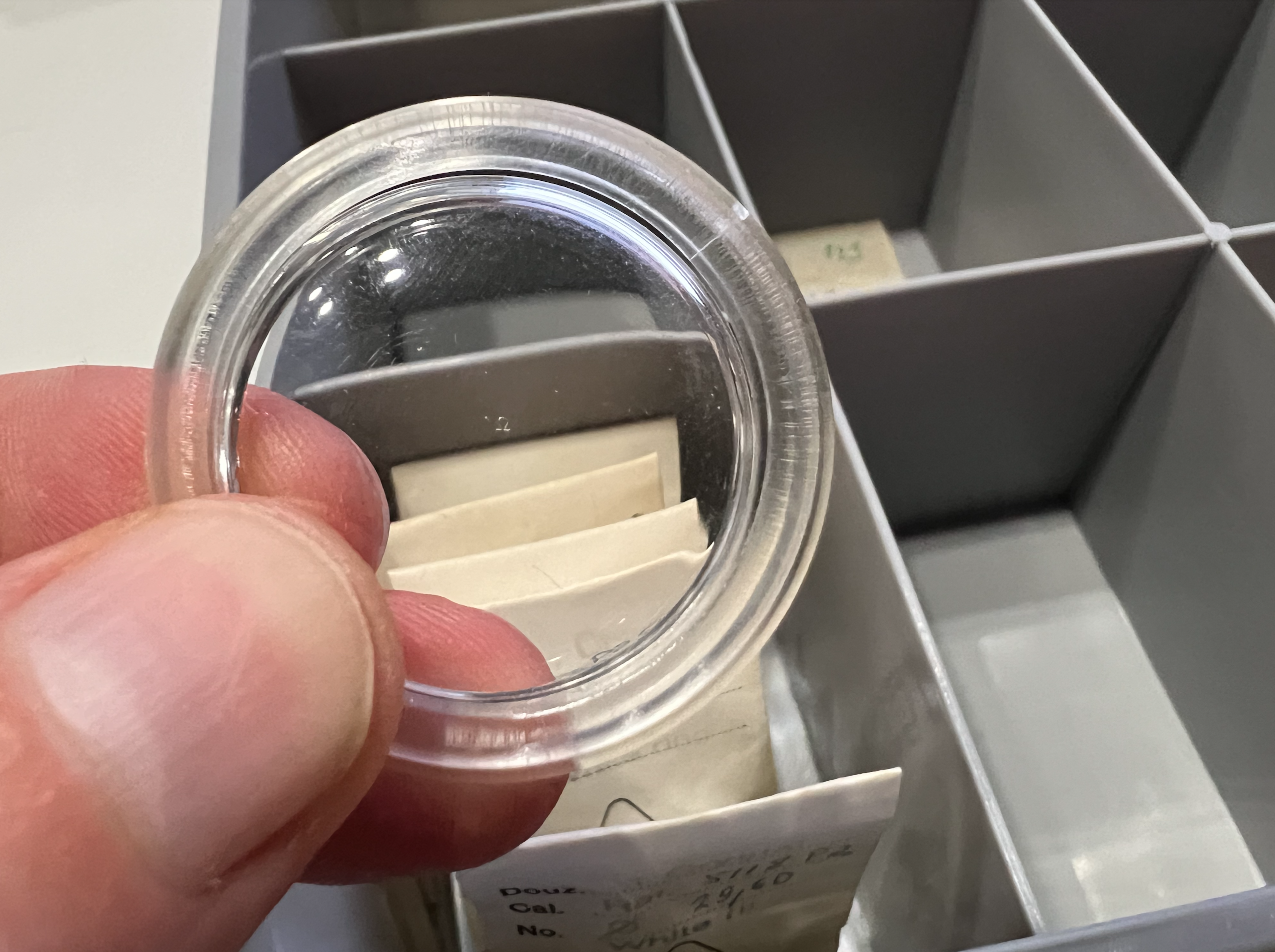

I think this is a relatively common issue as I've seen it before, I've recently got a small batch of crystals for a very good price, upon inspecting the first crystal, it was puzzling why someone would discard a silver ring crystal like this, not like the steel was melted, and the crystal was flawless

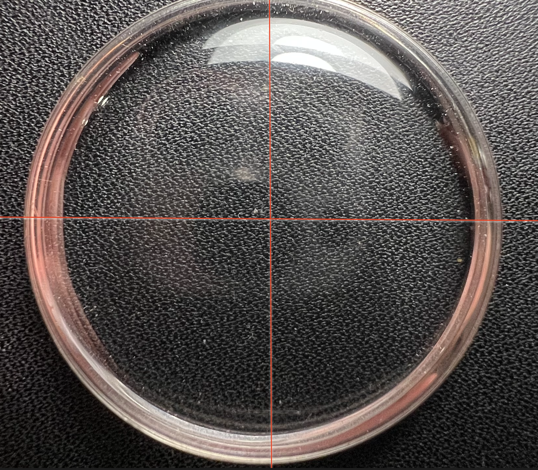

Than I noticed that the logo is nearly 2mm up and nearly 2mm left of where it should be, when you overlay this crystal on a dial it's more apparent, but I tried to draw the red lines to reflect how it appeared on an actual dial
I'm a bit torn myself, on one hand it's a flawless crystal, on the other hand the logo is so out of place that it's confusing mentally

Maybe it's more common for C-Case crystals but I've seen at least 3 so far, this one was a 5118
2,681
3,161
Another 5118, this from one from US, the first one was from UK, this one is more to the right

If you think of how molds for these are made, how the heck does one produce a crystal with the mark in the center, then one out as far as what you are showing? It doesn't is the simple answer...so unless we are to believe that Omega used a series of defective molds and produced all these and released them into the market, then there's only one answer for me...

When it comes to crystals Omega itself didn't made them like they didn't make most things, I've observed many different crystals, and many different defects, maybe one of the crystal producers was more susceptible to mistakes like these in their own process
Even if they were "aftermarket / fake" - those fakers assumably used a similar process as well, so one way or the other the process for making this specific crystal was susceptible to logo centering errors. By Occam's razor it's more likely these are original, rather than someone making fake crystals with 1:1 armor rings 30-40 years ago when crystals were cheap and available to anyone

That is a big assumption. Personally it would seem more likely that some faker is using generic crystals and trying to stamp an Omega logo in them after the fact, which is a process that would be more prone to such centering errors. The originals would have been made by producing the crystal from the start with the logo as part of the casting process.
