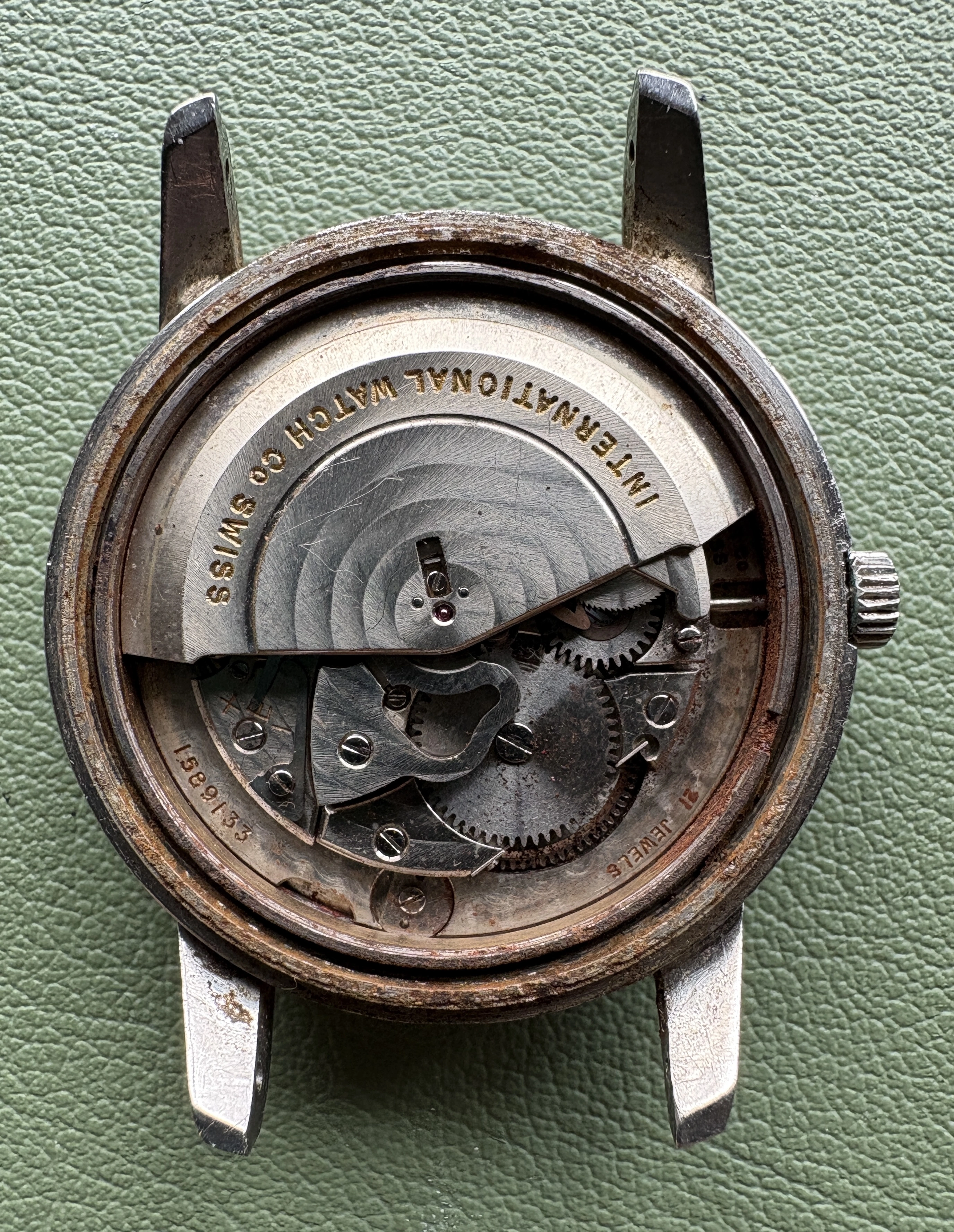

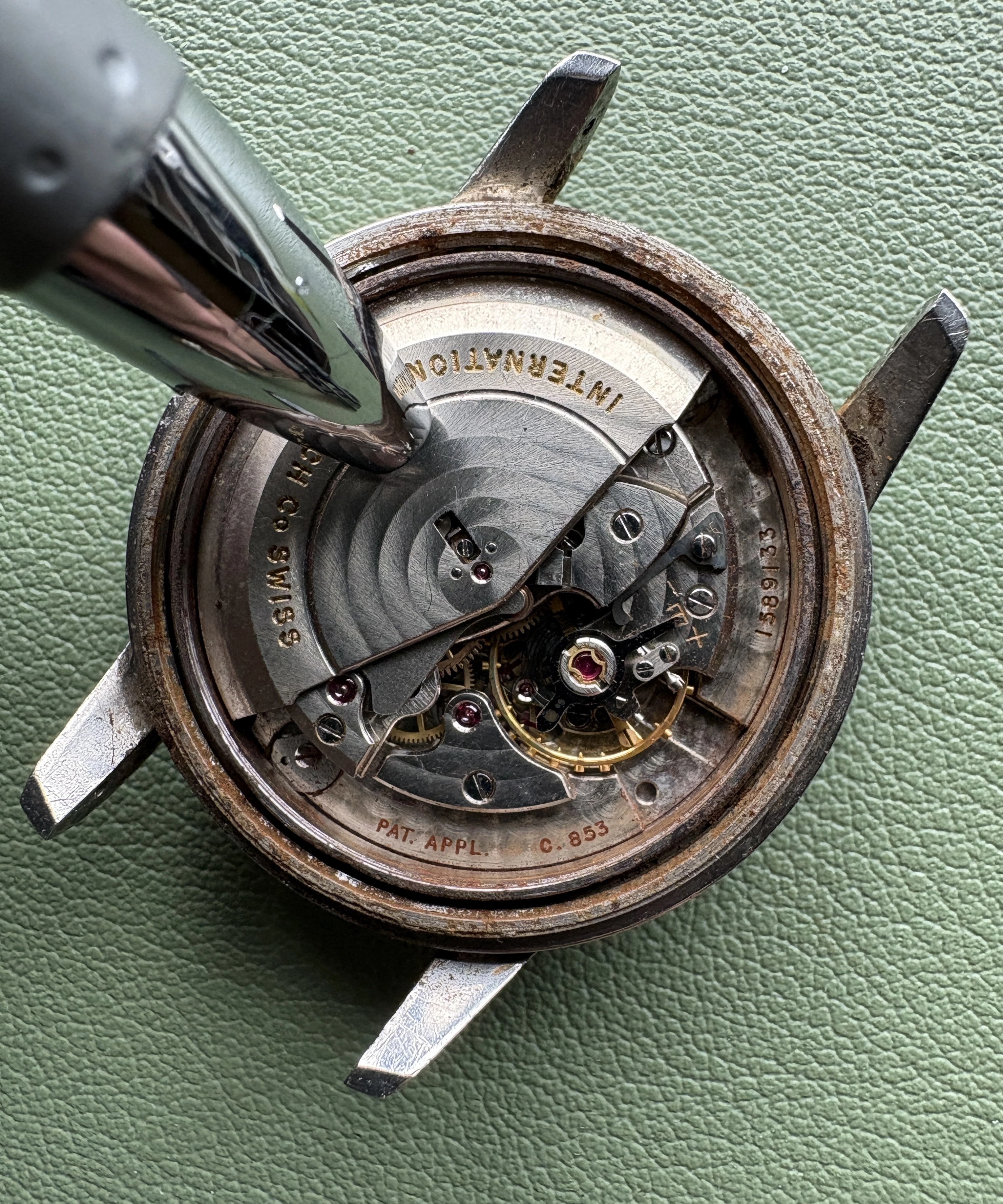

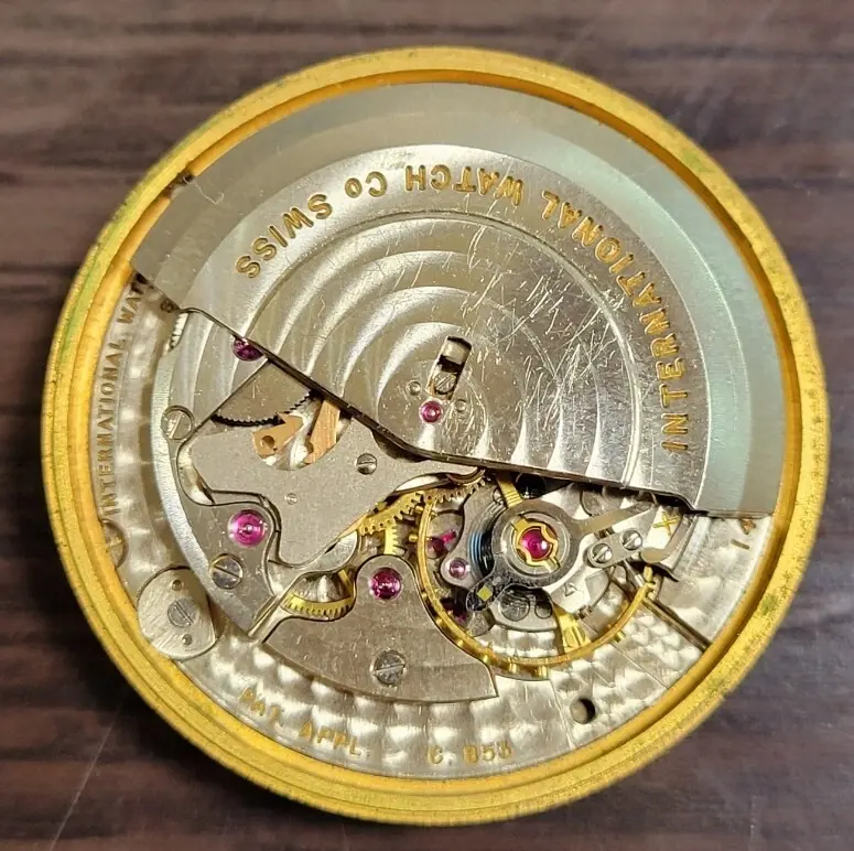

I suspect that the answer to this is that one can't be sure until the movement is disassembled, but if anyone wants to share their gut feeling about this movement, I'd appreciate it. Unfortunately, my long-time watchmaker friend has completely retired and sold off his entire shop, so I don't really have anyone local to take a look. I'd have to ship it off, and I want to make an educated choice. Try to get it running and possibly make it into a complete watch again eventually? Or just leave it as is, and possibly scavenge parts off of it in the future, if they're worth scavenging.
This is an IWC Ingenieur ref 666 with cal 853 that I mainly bought to use the dial to replace a repainted dial in a family watch. But I also have the case and movement, so I'm thinking about what to do with them. The watch winds and sets, but does not run. It looks pretty bad, but if it ticked, I'd feel better about a potential restoration.

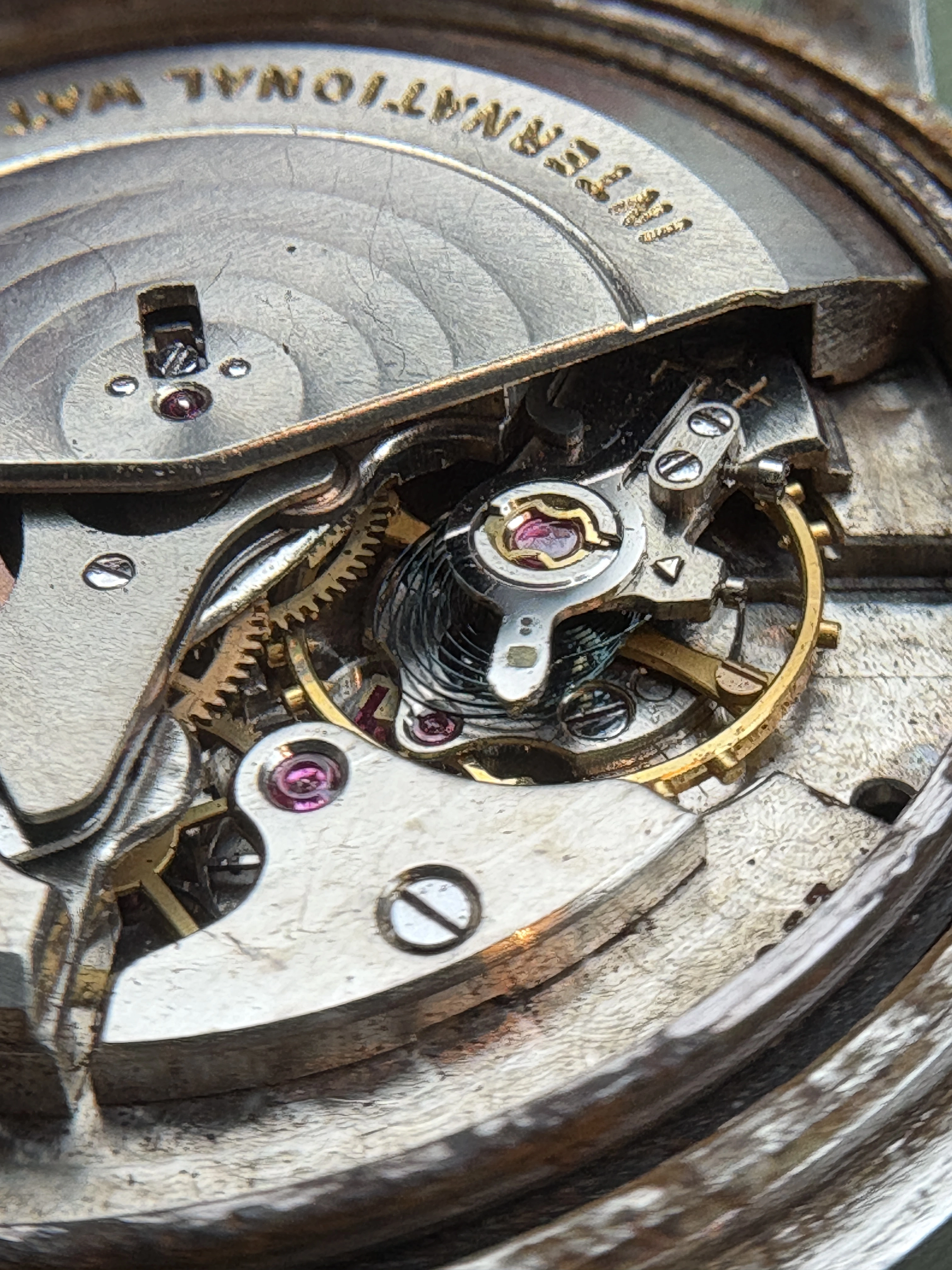

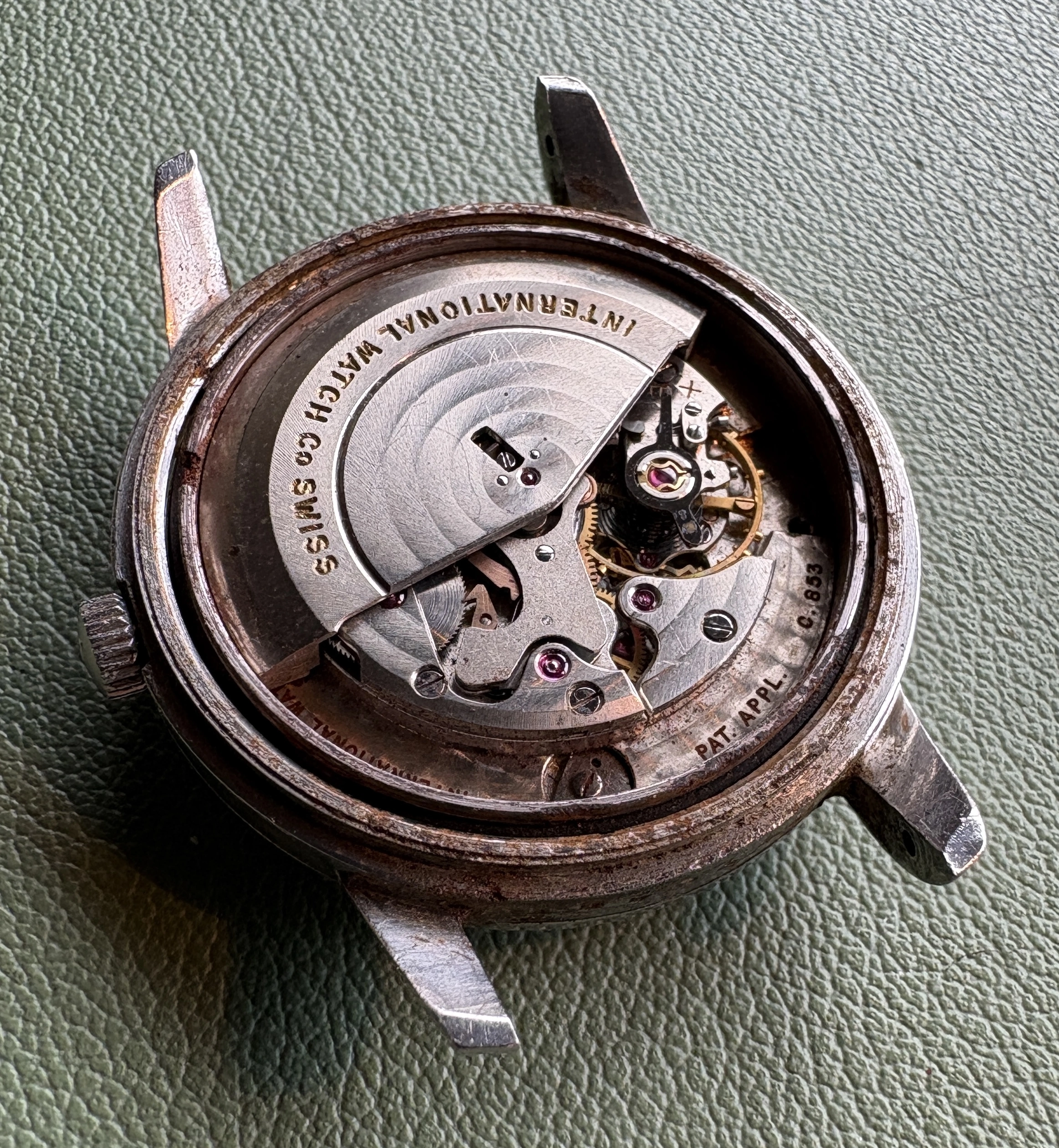

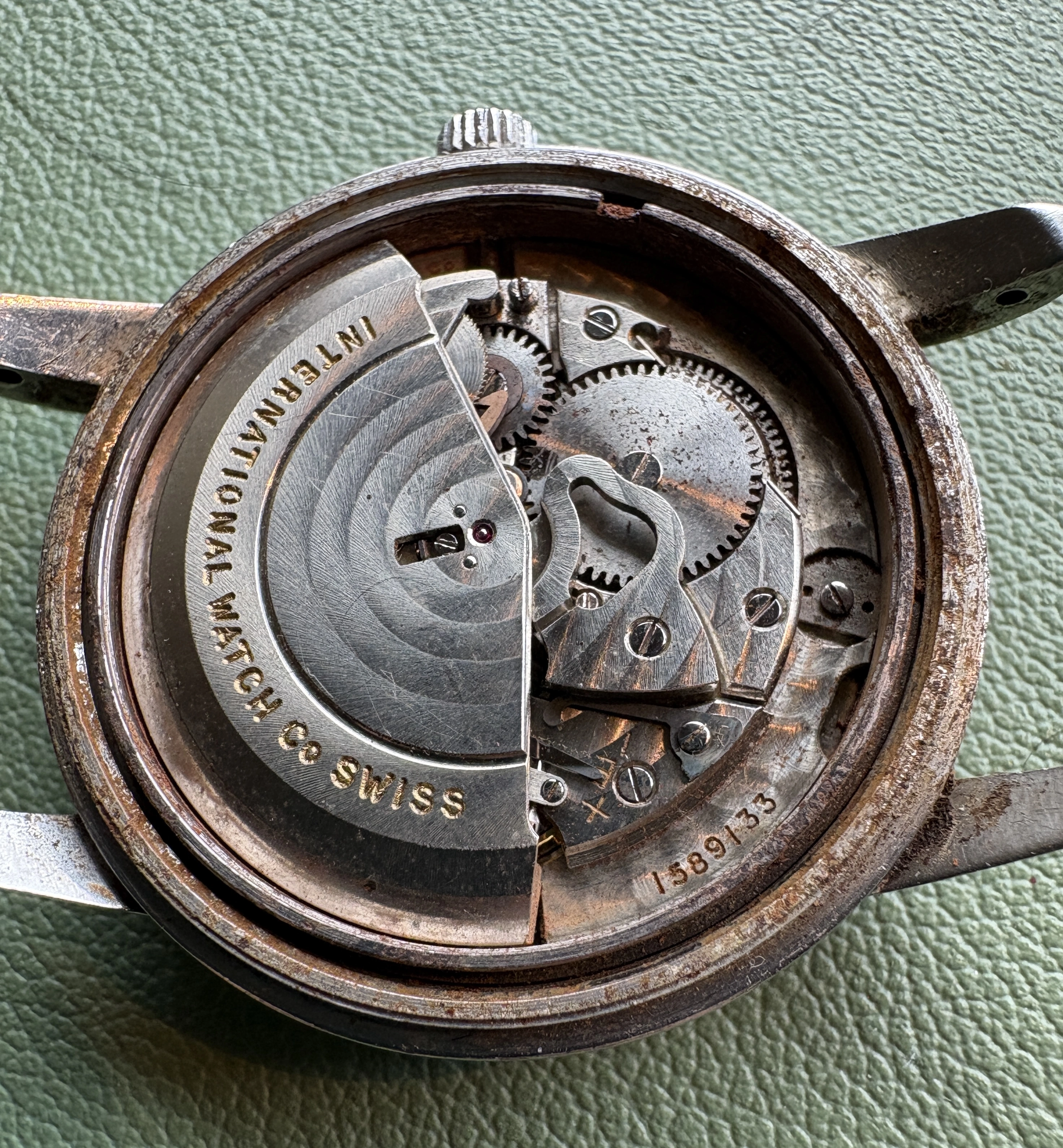

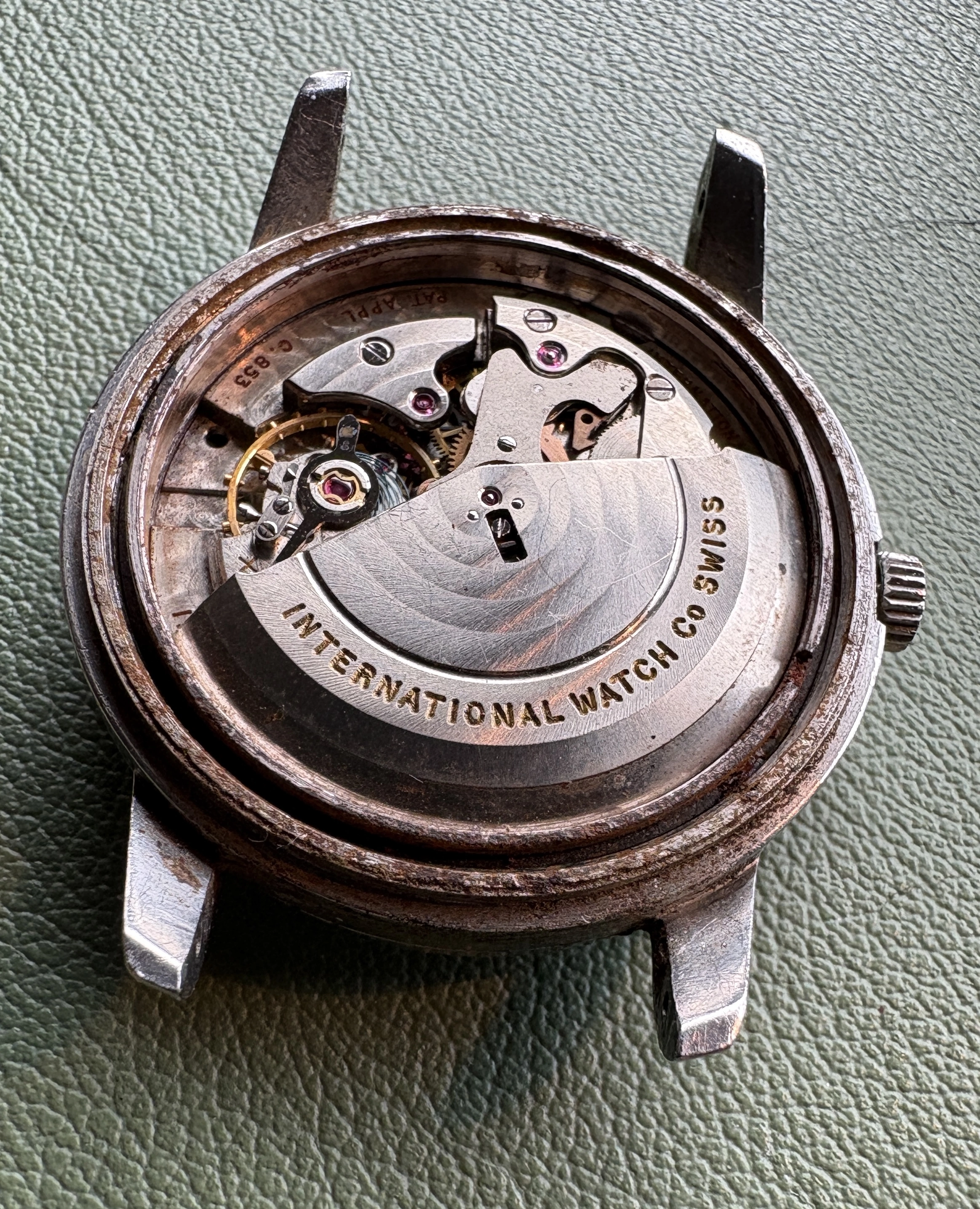

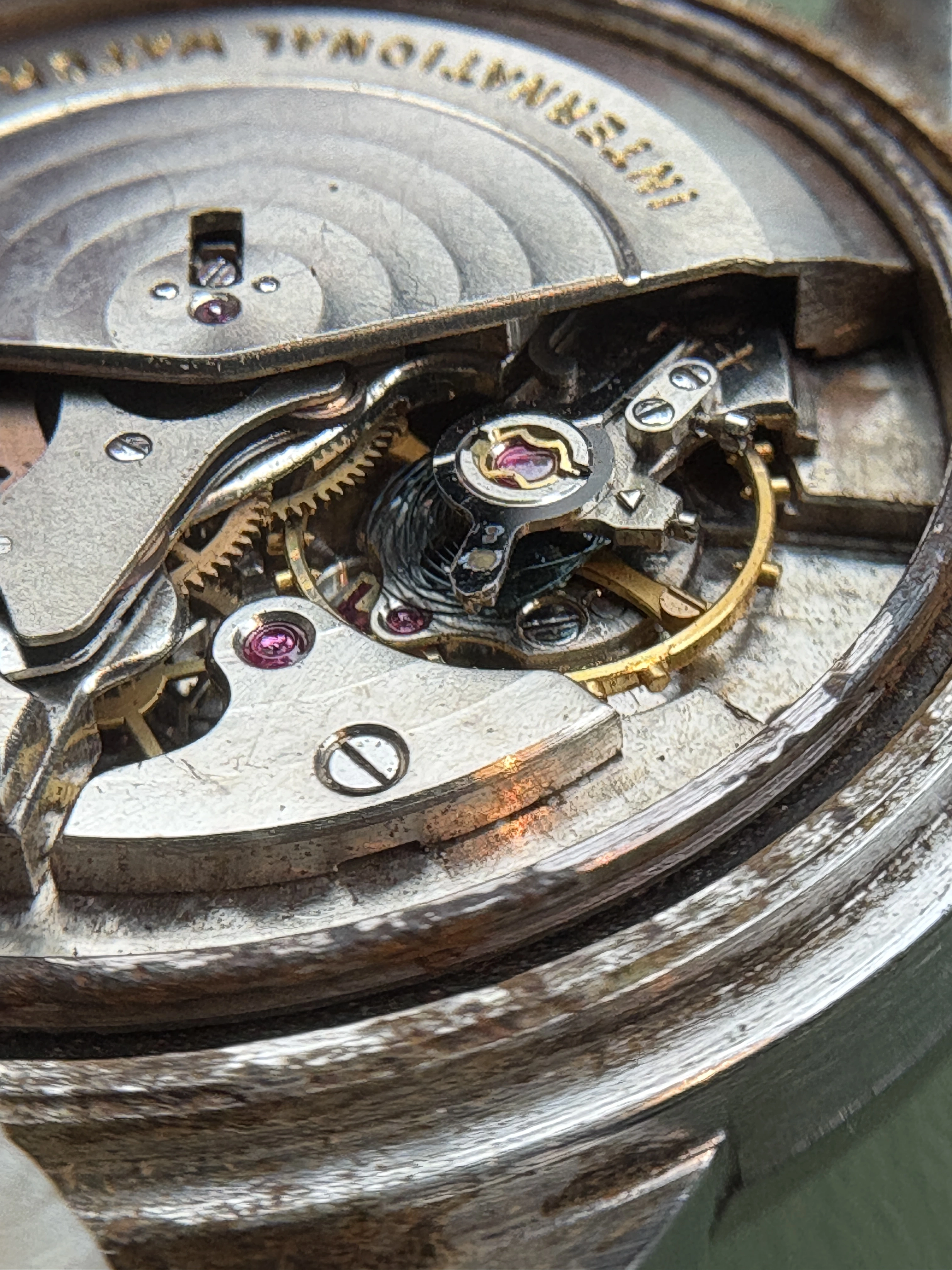

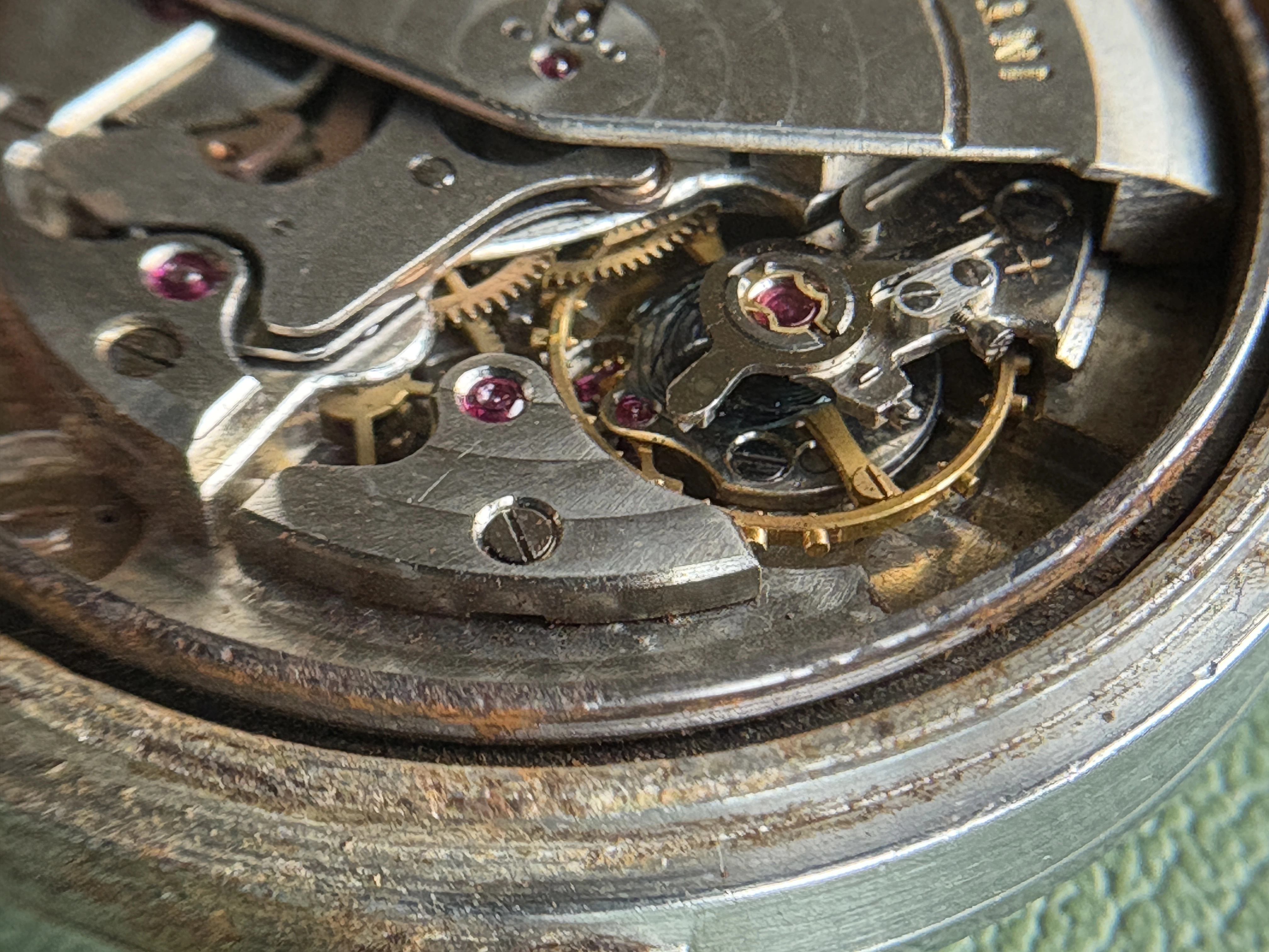

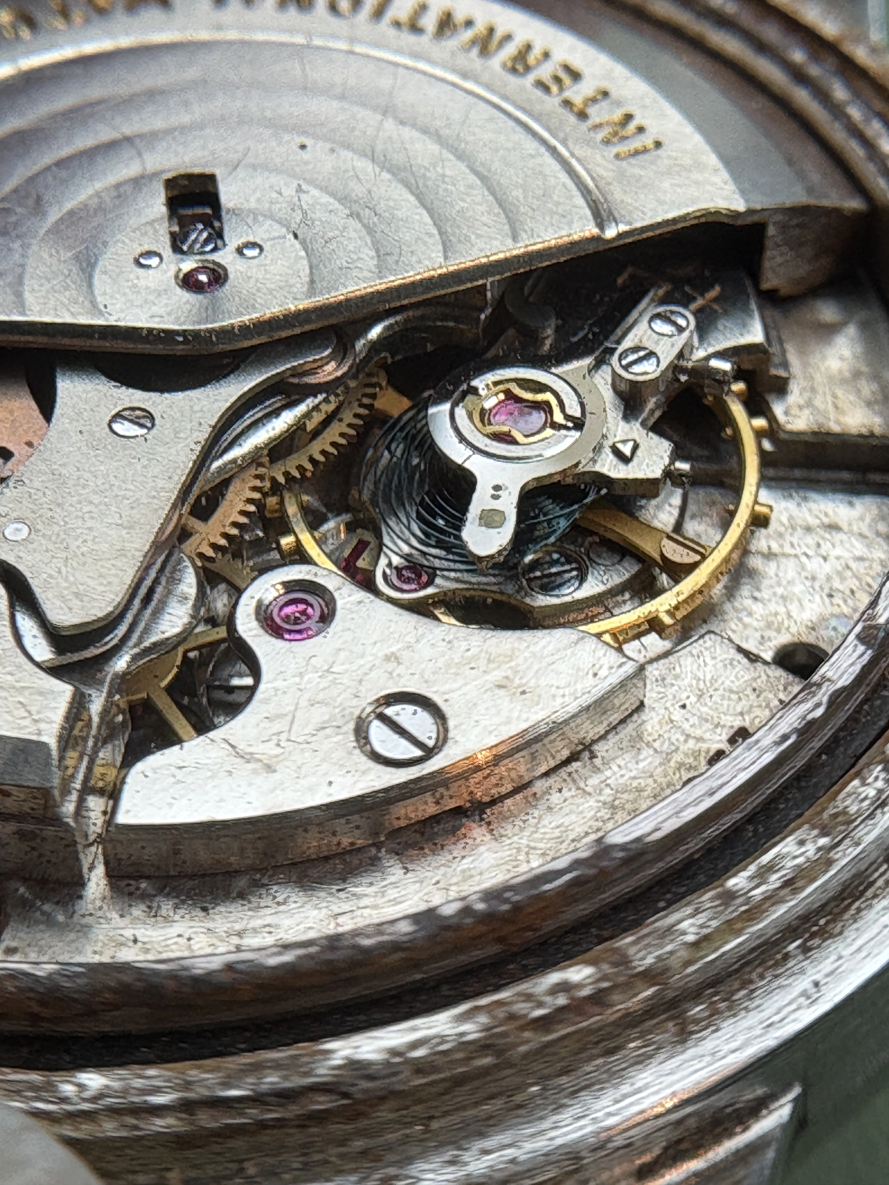

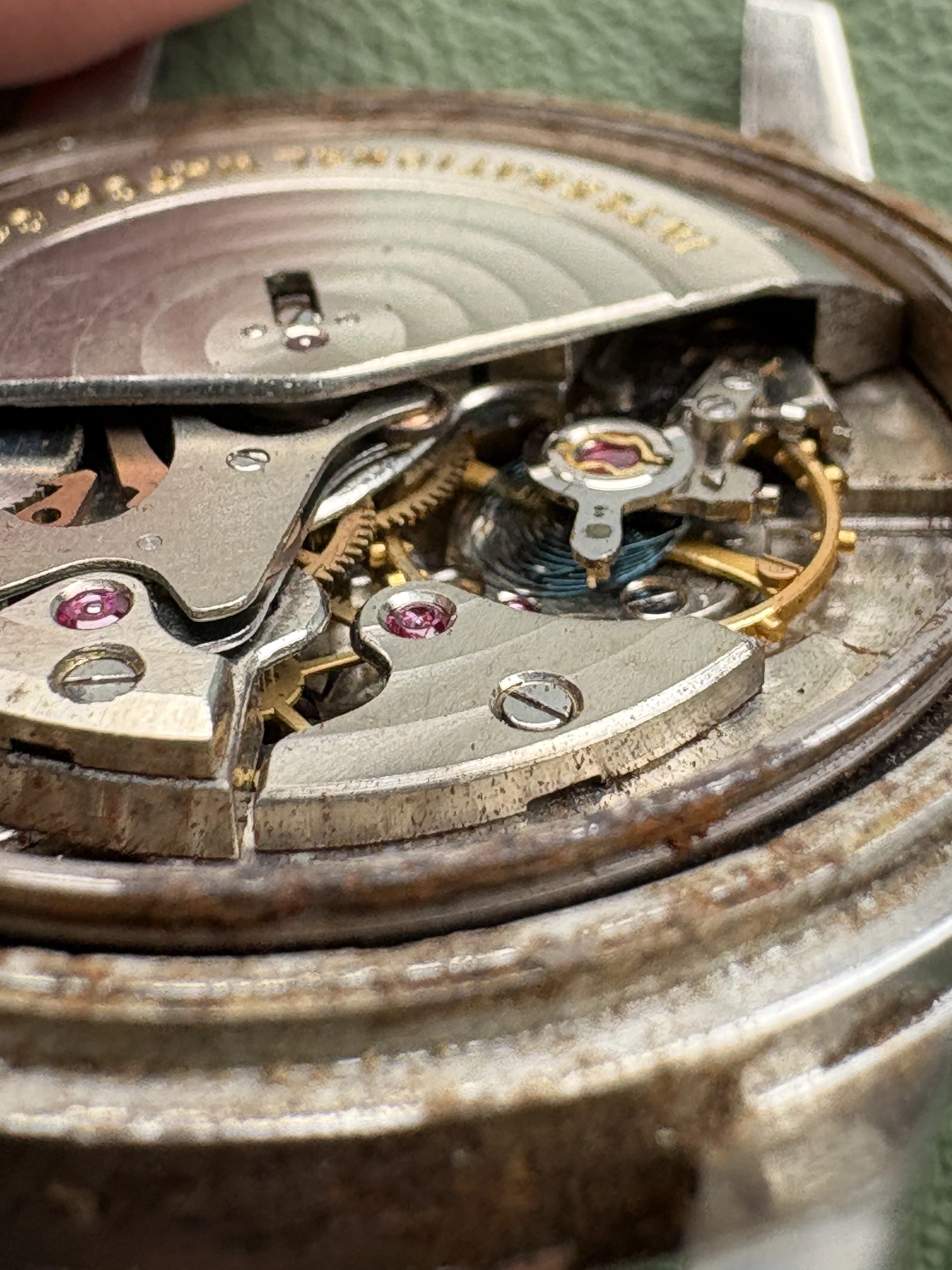

The case obviously exhibits a LOT of corrosion, and I can see some rust in the movement as well, so that's a concern. The balance does not move freely and when I look closely, the hairspring looks funny, like part of the coil has come up out of the correct plane. I've tried to include some macros. Some are slightly out of focus, but if you look at all of them, I think you get a sense of it.

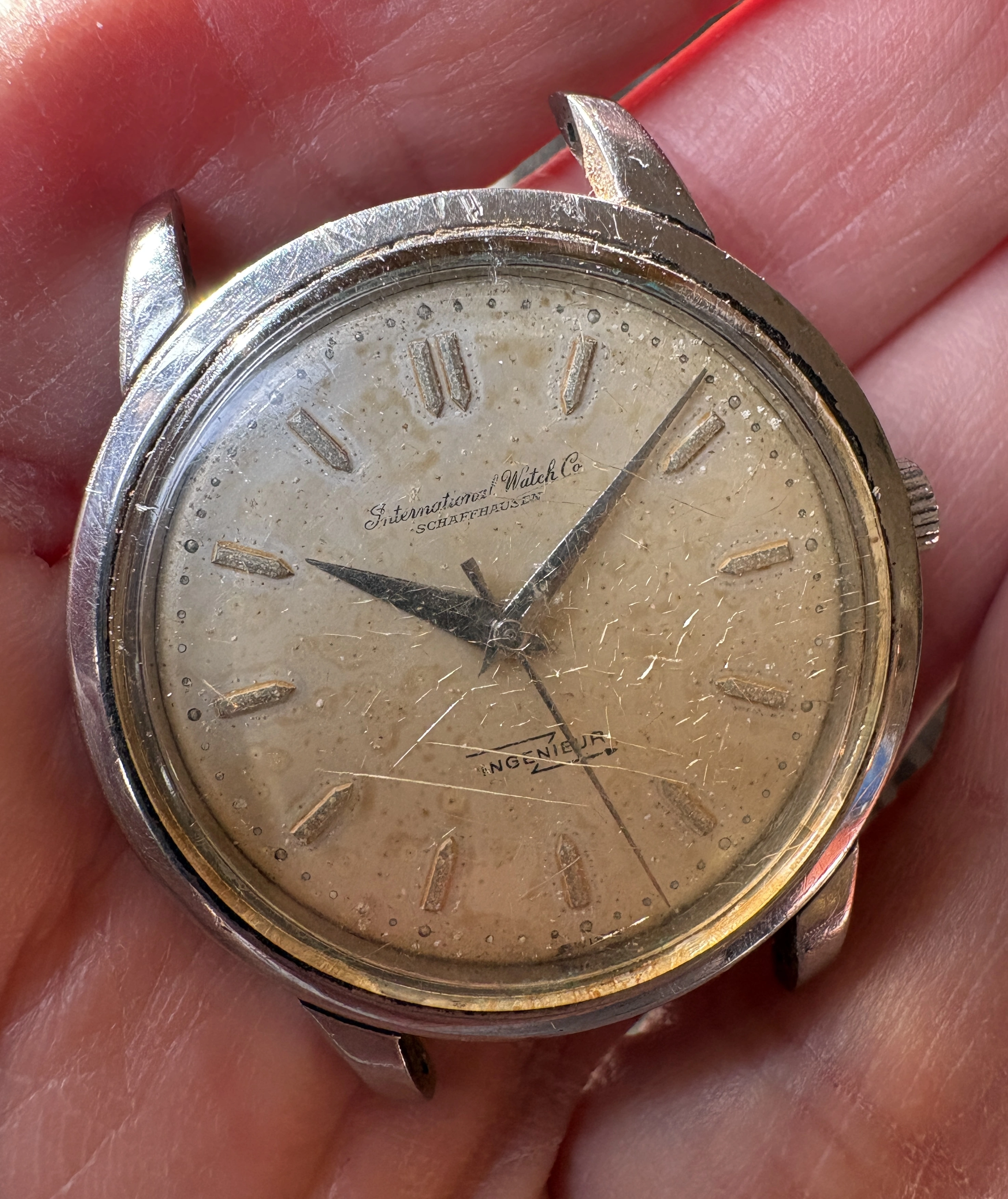

Dial photo at the end to satisfy any curiosity. It's not the greatest, but it's original and better than what I have.

Here at the Home For Wayward Watches our hearts go out to quality vintage watches that have "seen better days" so we hate to see one rejected and put out to pasture.
I'm not the one to evaluate movements from photographs, but that one looks filthy and corrosion is evident. The case looks like it went through the war. Still, it could be sound underneath with a good rehab by a qualified watchmaker. It's all for naught though if once running then a dial must be sought.

From a Hobby perspective the movement in the photos is quite repairable. A little rust never bothered me. Everything is present so a cleaning should get it ticking again.
Getting back into pristine shape depends on how much wear/rust there is under the dial. This is the sort of watch one sees on You Tube shakedowns.
What ever the case (no pun intended.) This watch will be a total timesink, So repair will be expensive and probably comparable to factory restoration.

I don't think it would be worth restoring this one based on the repainted dial it will end up with, and the condition of the case. I would keep it for parts though.

Personally, I would definitely restore this watch for myself. Would I send it somewhere and pay money for the restoration? Probably not, since it could very well become a money pit.
I don’t mind the dial. The movement will need a lot of work, and I expect some unseen problems to be found along the way. It seems like a neat challenge, though.

I'm an amateur watchmaker and serviced about 100 vintage movements in various condition. I wouldn't hesitate to tackle this movement. Looks quite serviceable from the pictures.
The hairspring looks like it is caught behind the stud; it may be not even be distorted once "released" from the stud.

Little polywatch will help. And can't say it doesn't have character! Nothing a bath, a lot of scrubbing, and a good oiling won't do to lift the spirits of an old watch.
Seriously though, it's going to be some money for a full service and once pulled apart, getting any replacement parts, etc. As for the dial, it exudes the patina of bygone era which time forgot. Especially for vintage, can definitely work if you find the beauty in it. But yeah, it falls under a labor of love with this one. A noble endeavor if choose to go that route.

Thanks for the feedback so far, the comment about the hairspring made me hopeful, find a new balance is something that I would like to avoid.
Regarding the crystal, unfortunate there is extensive crazing, it's not just superficial.

The crystal is definitely done for, but a new one with a silver tension ring should work just fine.
As others have suggested, I think the hairspring could be fine with a bit of luck or may only need minor adjustments. Whether the balance staff is intact still needs to be determined.
I find this movement intriguing.. Especially the saw-tooth crown wheel looks funky.

TBH, the movement itself seems like it shouldn't be too bad, the rust/water intrusion actually is probably not going to have much problems inside of it.
The hairspring scares me/makes me less confident in MY ability to fix it, but the rest is probably not too bad to fixup. IF it wasn't for that, I'd offer to see what I could do for the cost of parts 😀

I think that is a bit off to the side of where a crown wheel would go. I think that is a ratchet that is part of the automatic works. I think I've seen a Longines with a similar feature not long ago...

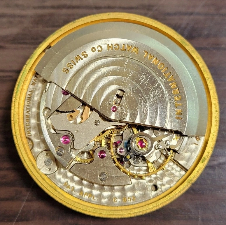

I came across an auction for a working cal 853 movement, so I picked it up for some insurance. Looks like it has not been handled with tremendous care, but the seller claims it is running when wound using the rotor. I would have paid the same amount for a balance complete, and this way I have extra parts as needed. At least probably some of the parts would be usable.
Based on the dial furniture and hands, it was probably taken from a gold watch. I guess movements are easier to find in the high gold era.
