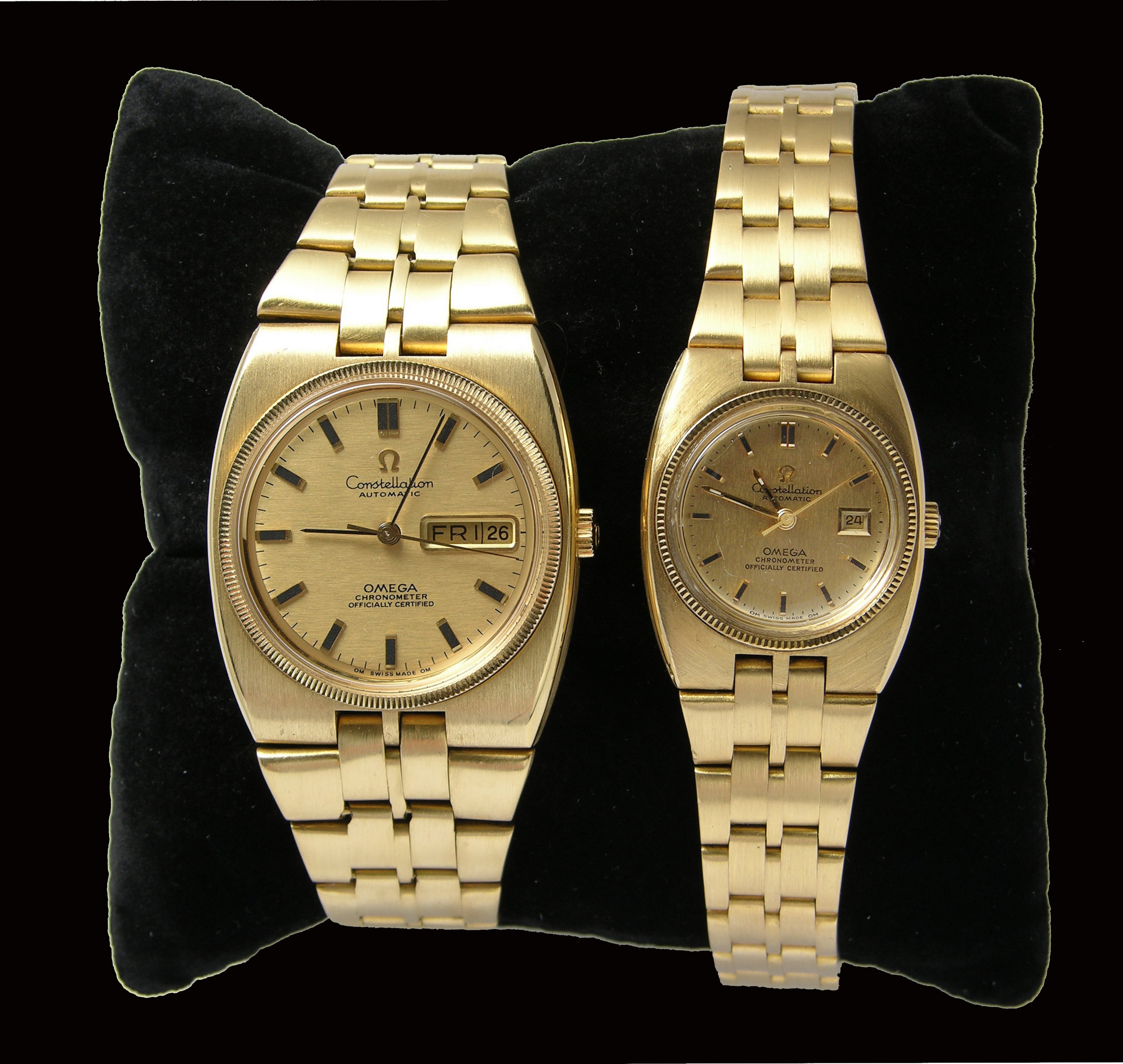

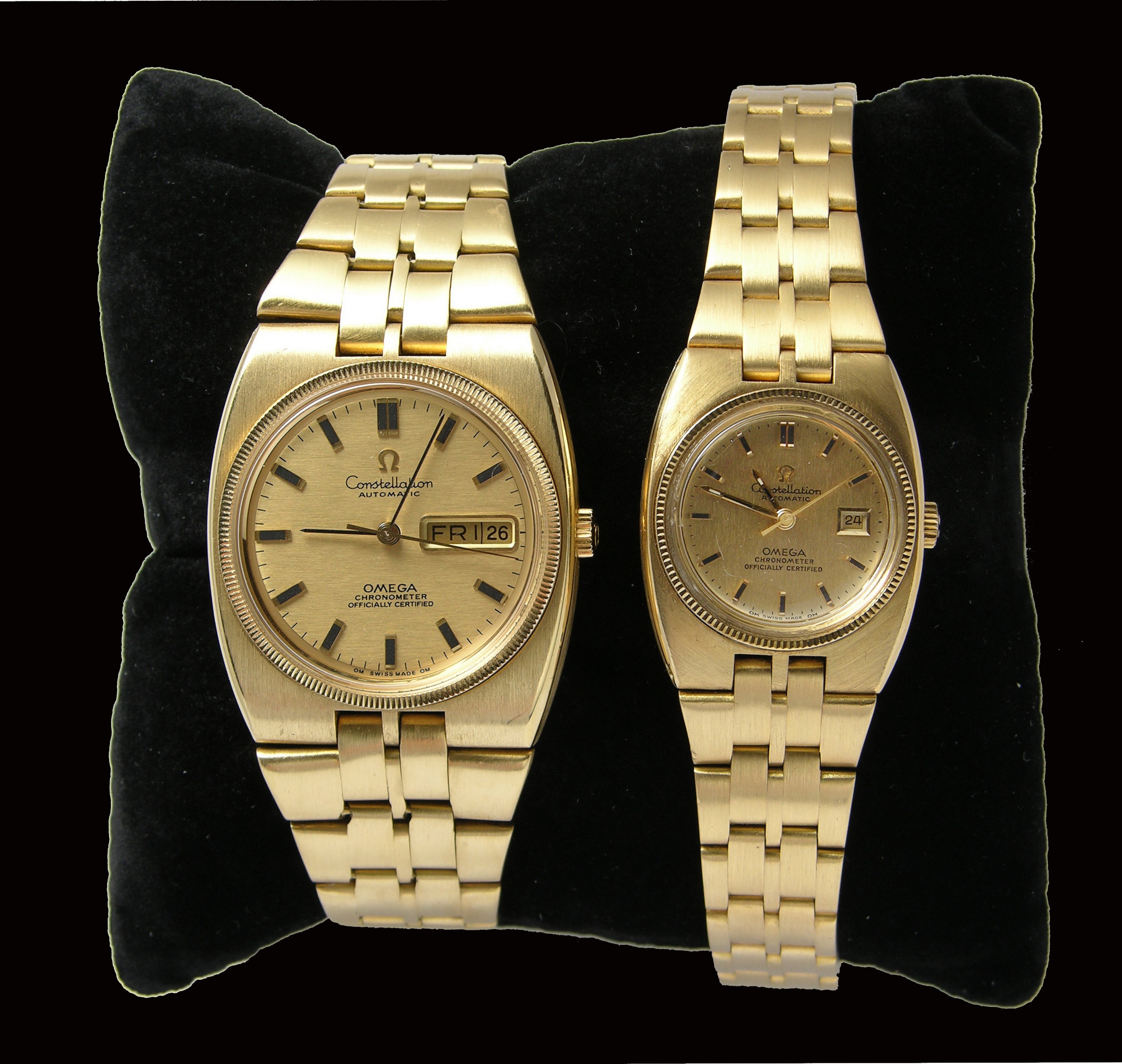

Hallo @ColytonJohn and Omega friends,
the 145.017 is available in Ebay around 3-4k€.
So its not an expensive vintage jewel, where the service costs will immedately increase the value. So a cleaning and repair by a local watchmaker is all right.
When I search a vintage watch I accept a similar price upgrade, when an original Omega service is documented or (at best and) the original sales papers are included.
At the moment I have 4 watches at Omega Biel with estimated costs between 850 and 1200€.
As the collection watches are not worn often nor in heavy environment, the Omega service document keeps its value longer than the next decade.
My local private watchmaker does a good job, but has to be creative due to missing Omega parts, so I like his job, but cannot document the quality in case of sale, so its for the less valued watches.
My local Omega certified watchmaker gets parts, it takes long time and at least its similar costly.
The next question is, am I ok, when Omega replaces original parts like crown or crystal? In most cases I say yes, the better fitting service parts are ok.
Only with a rare and still original and complete watch like the deLuxe models, originality is first!
See of what type of watches I am talking.
