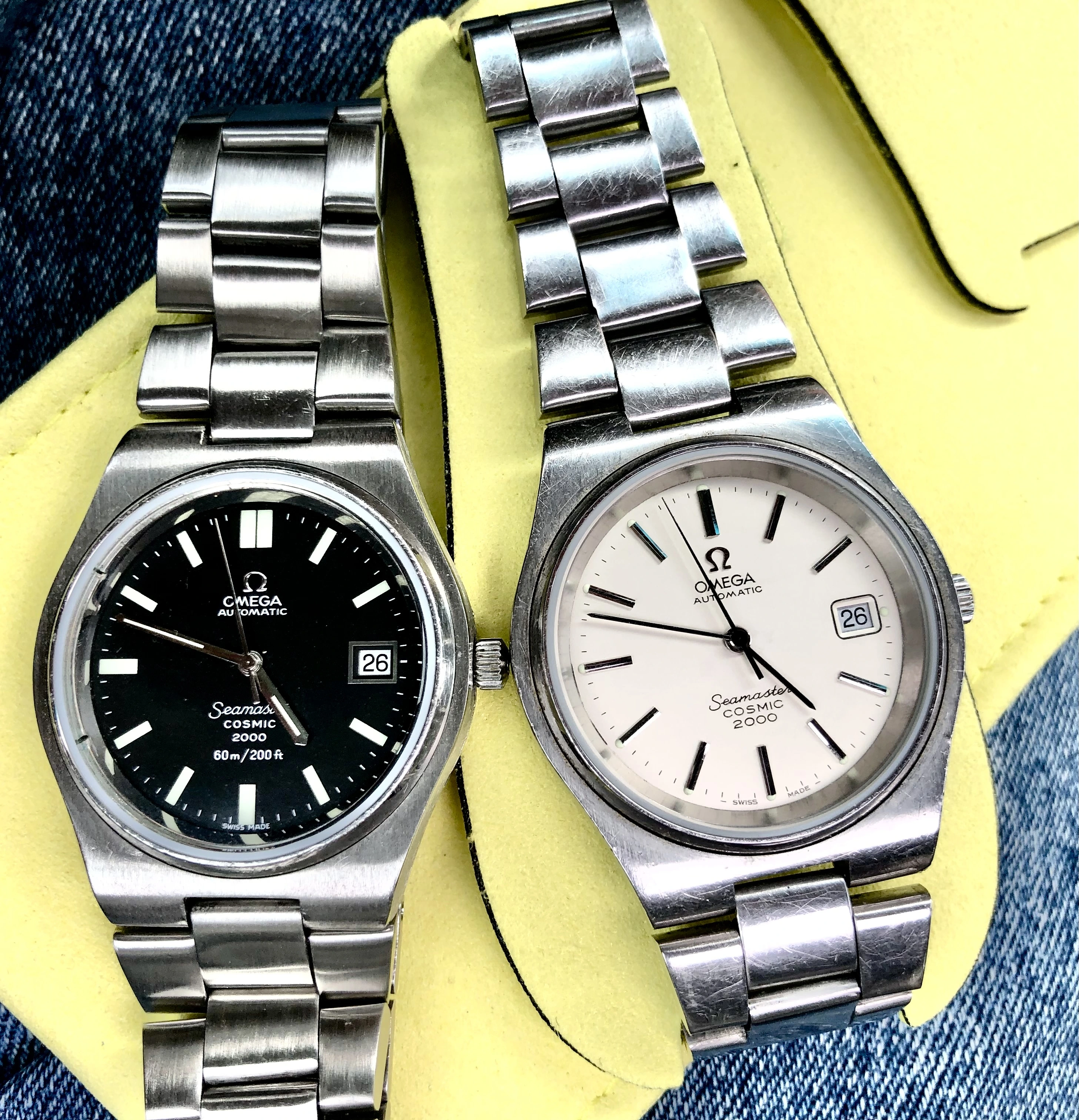

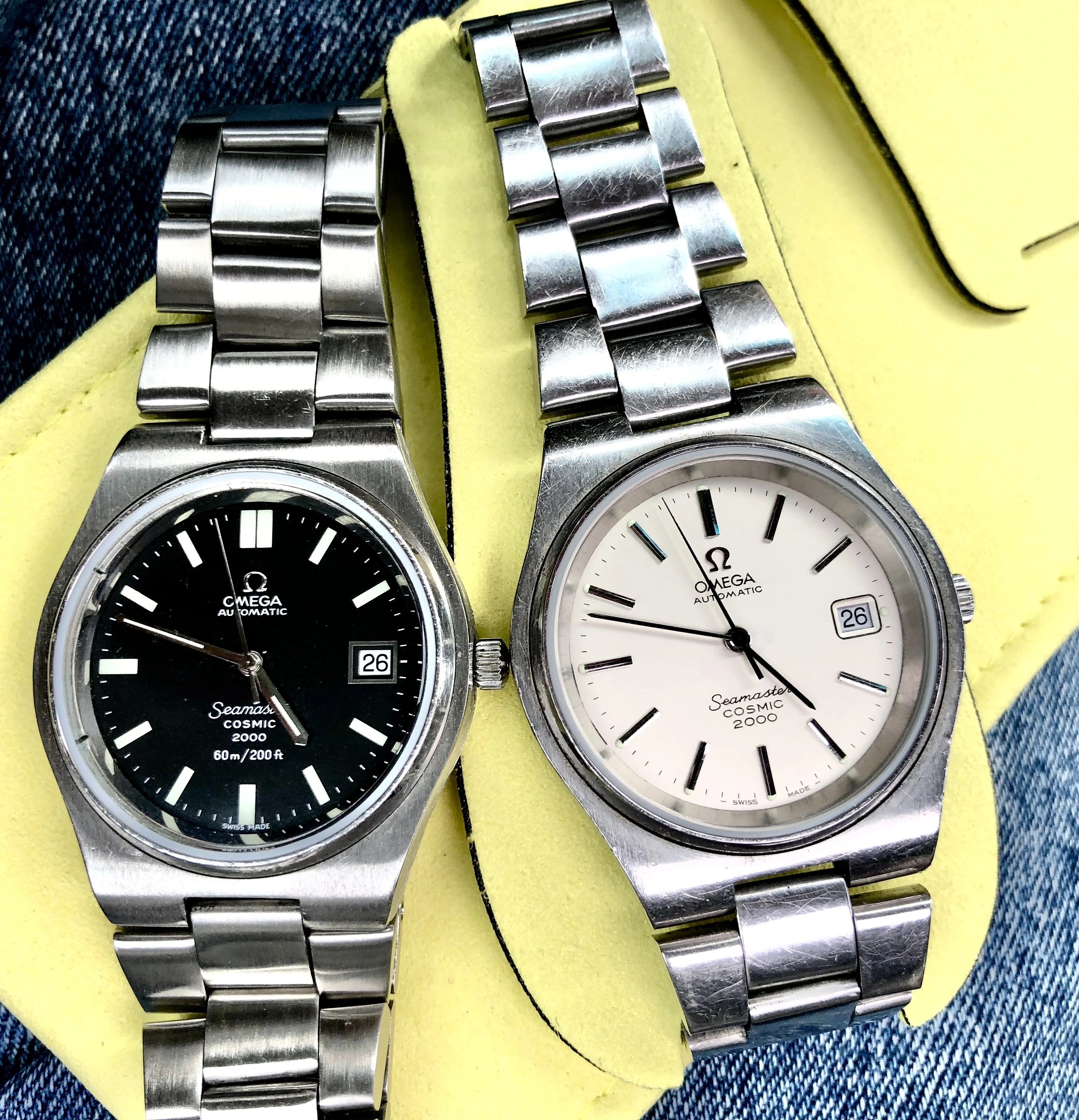

I took my 2 Cosmics to

I took my 2 Cosmics for service. The watchmaker was very familiar and didn’t hesitate one second. (October, 2024)
https://www.marylandwatchworks.com/

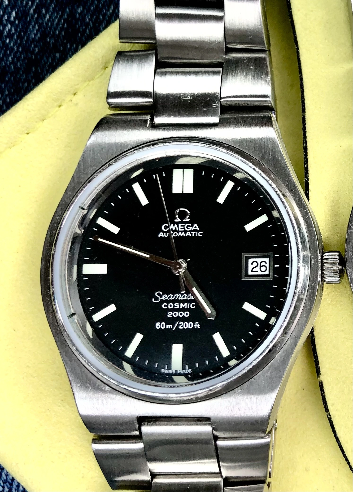

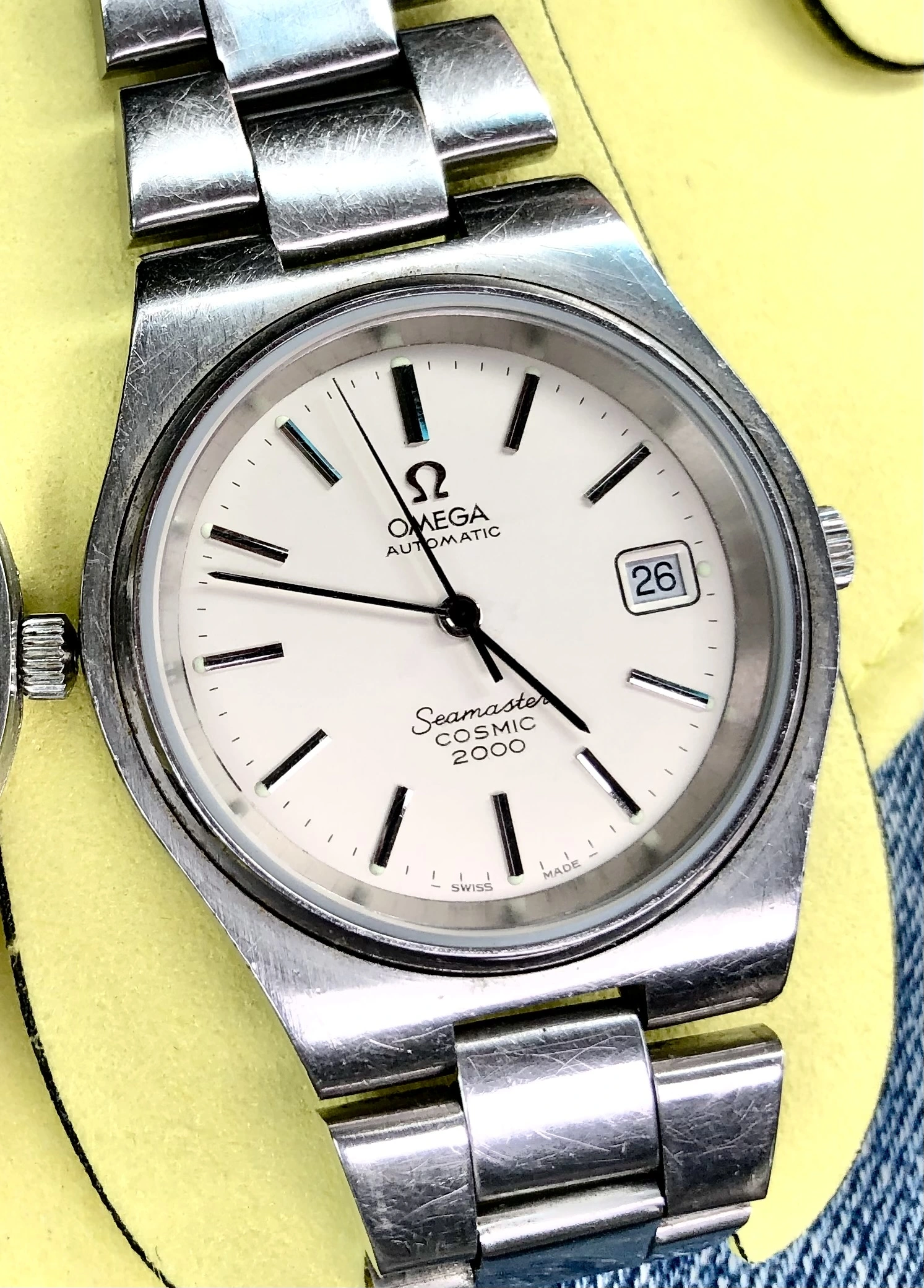

He opened both while I was watching. He has good access to parts too. The black one was an eBay wreck.

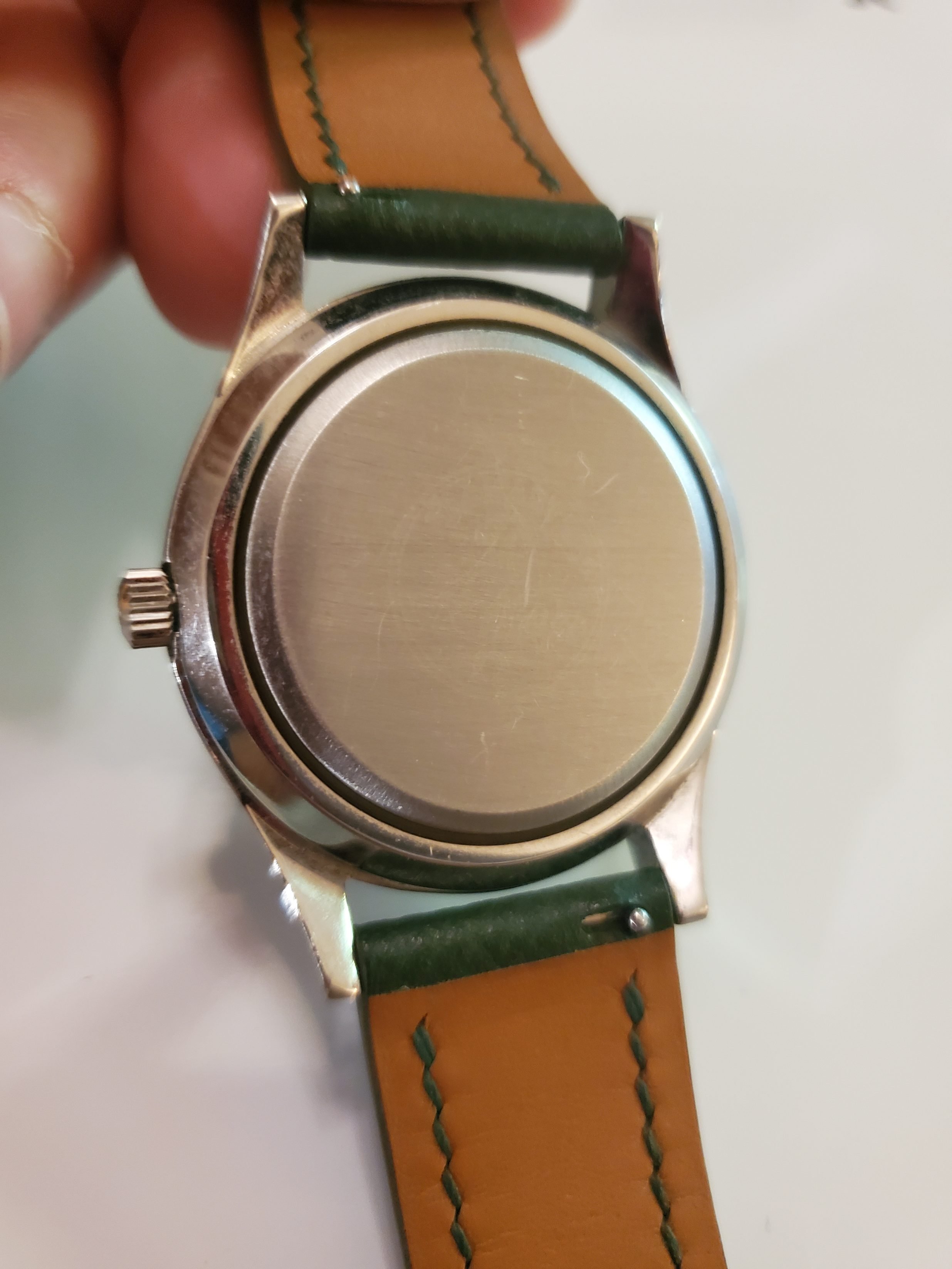

As for the opening the case of Cosmic 2000, the entire movement (crystal, movement, and back) are pressed thru the outer ring of the case. No compressed air needed, nor recommended. The shop I went to opened my two watches while I watched with a press. And after an evaluation, closed them up in the same press, and some weeks later I have 2 fine examples. I linked the shop in my response to him. I asked the watchmaker if he was familiar with Cosmic and he said he gets them in several times a year. No mystery.

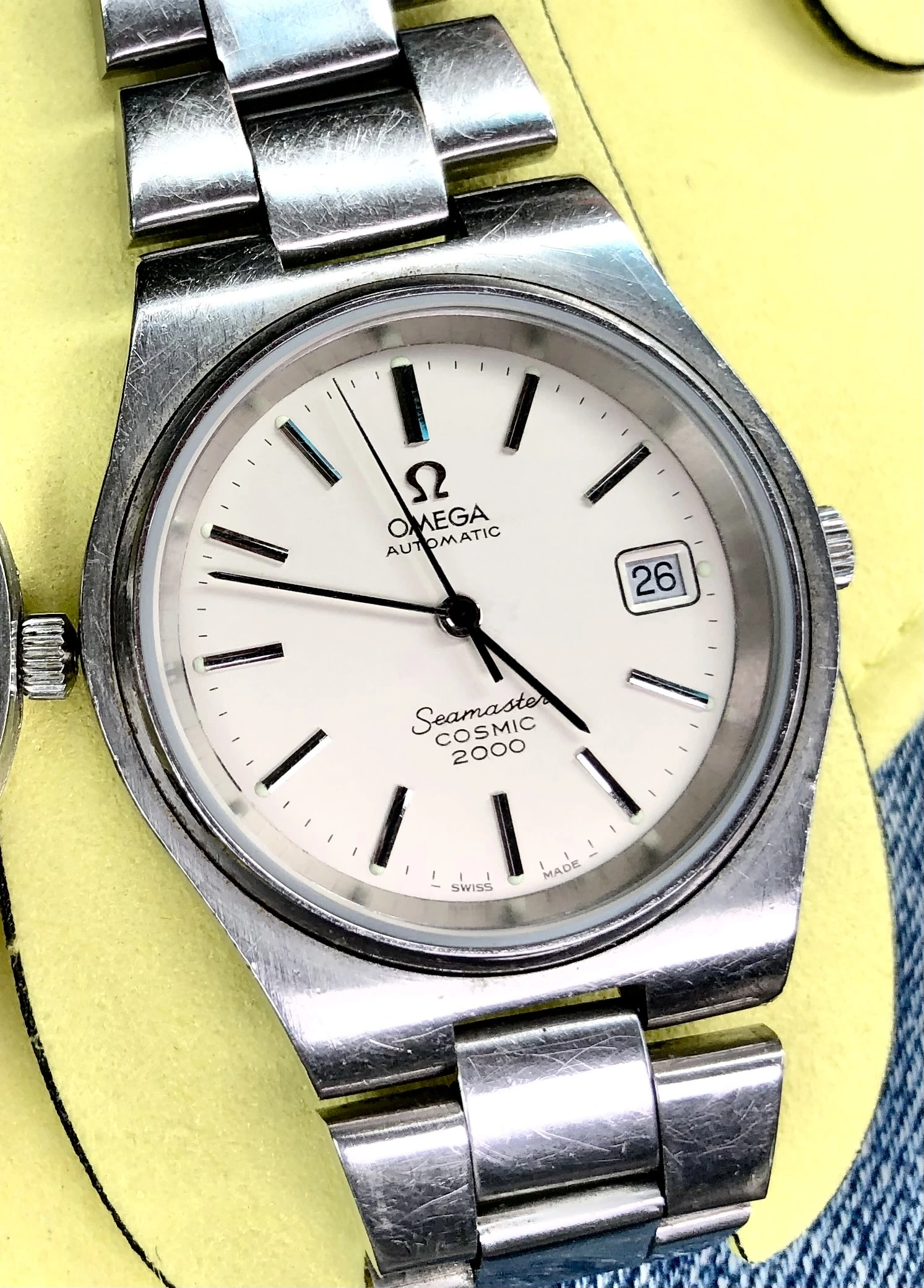

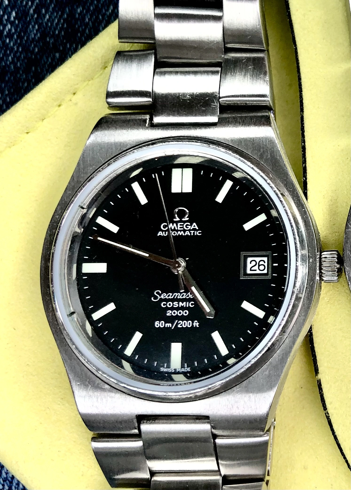

The 2nd Cosmic. (Ignore the damage on the inner ring of the black face. That was an existing damage and replaced)
