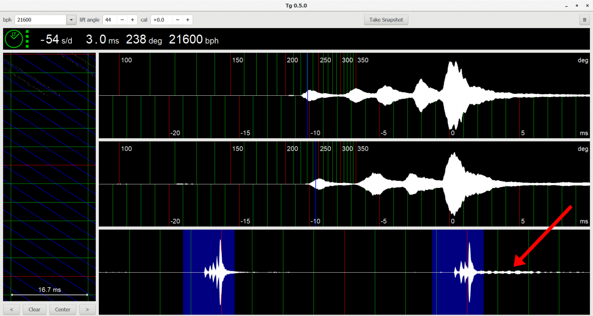

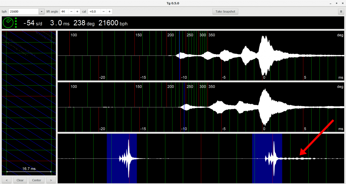

Good progress. I notice that the lift angle in the software is set at 44 degrees; what is the reasoning for that value? The lift angle affects resultant amplitude values.
30,326
78,262
That's the lift angle for the 6497...
I dont know how reliable the results are. The amplitude seems to look not that fancy at almost full wind, otherwise i tested the results in 4 positions (head up, head down, crown up, crown down) and it looks surprisingly not so bad 😀
Well, glad you have the setting working now. As you state, the balance amplitudes are quite low. By the way, is this a clone of a 6497-1, or 6497-2?
If it's the former, the beat rate is 18,000, and if it's the latter, it's 21,600. Unclear if this is a parameter you have to set, or if the software picks that up automatically. No idea how reliable the readings are with that sort of set-up. honestly although they have serious drawbacks, the cheap Chinese timing machines may be better than the set-up you have there.
It does both. You can set it on automatic or a fixed rate. Currently it is set at 21600. All the displays would show gibberish if the rate was incorrectly set.
What caught my eye is the long tail after the drop/banking pulse on the acoustic graph; could there be something rubbing -roller jewel or safety dart? It would explain the lower amplitude...no?
Honestly, i dont know, i didnt find any indication on the movement! Initially i set up 18000, but the Software couldnt pick any reading, then i tried it with 21600 and it was reading just fine. There is an option to set the beat rate automatically though, but i never use it.
So it could be a clone of the 6497-2.
This long tale did disappear after adjusting for beat error though.

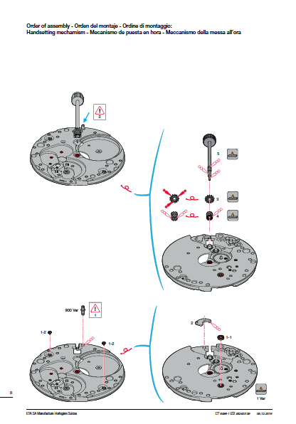

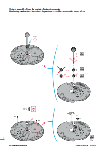

My apologies for the "Oiling Instructions".
I just grabbed a pic from the net to show the centre wheel jewel.
When I linked to the site I should have explained that I hadn't checked anything there for accuracy or commonsense.
:whipped:
If @Eve sends me a PM I can provide a copy of the complete ETA technical guide, including correct lubrication details.
