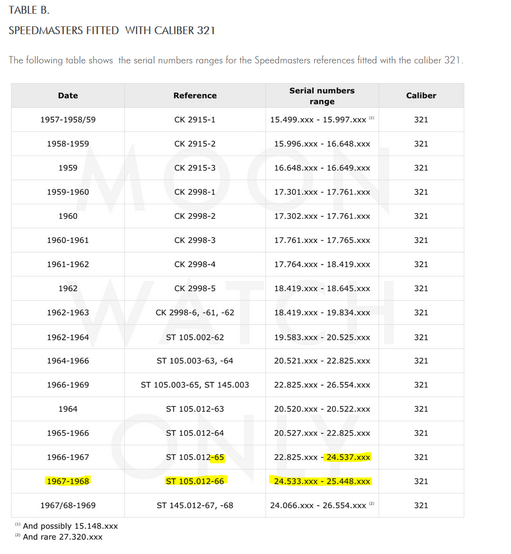

Not really, you don't need to got to that trouble on a sixties Speedy. If it passes with an extract for a 105.012 (they don't give year iterations on extracts but the CB was only seen on the -66 of course) then I would be satisfied that the movement is original, if it doesn't then there is your answer. As you have already noted presumably, yours isn't quite in range for a '66 according to a few reliable sources but it isn't far away.

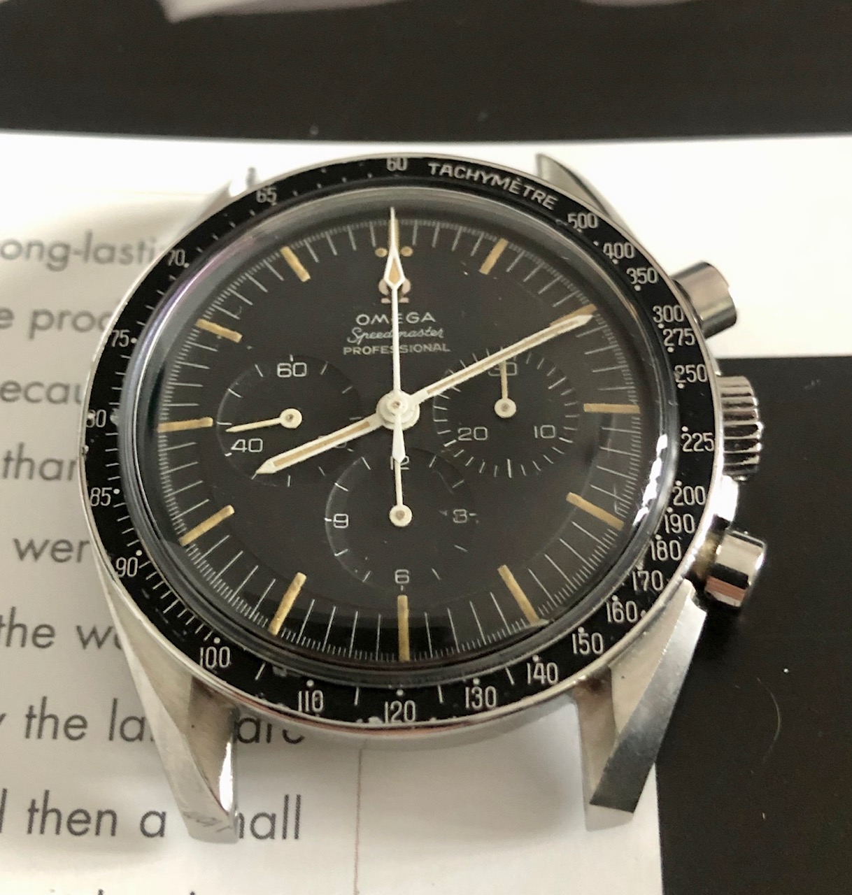

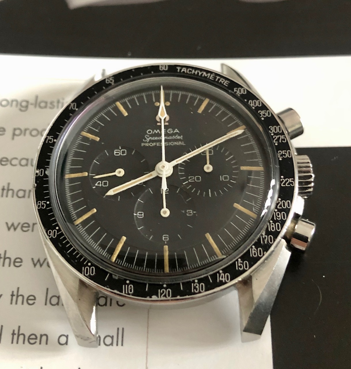

The watch in the picture is a totally original late 105.012 - 66 CB that I own for some years.
It comes with the rare B2 dial, and a ref. 25.440.xxx movement serial and the correct band.
By the way was the ref. 1116 band with 575 end links used one the late 105.012-66 watches?
Thank you

You say totally original, but as already noted it’s not in the accepted range for 66s (see table above and other sources) so I am afraid there is a small shred of doubt. An extract would add confidence. It’s likely absolutely fine but I question your certainty. Unless you owned it from new you can never be certain and funny business can occur even then at service time.
24,833
55,238
Unless you owned it from new you can never be certain and funny business can occur even then!
Exactly. Why would someone claim that a watch is "totally original", when it's impossible for them to know, and unverifiable. When pushers have been changed, other things could have been changed as well.

On the Moonwatch Book the 105.012-66 CB serial are located in the serial range in between 24.533.xxx and 25.448.xxx
The watch has a serial 25.444.xxx...

OK, do you see where the confusion came from? You typed the wrong number the first time. Pushers still don't look original to me (and hands maybe repainted), but very nice watch nonetheless. Appealing dial and sharp case.
