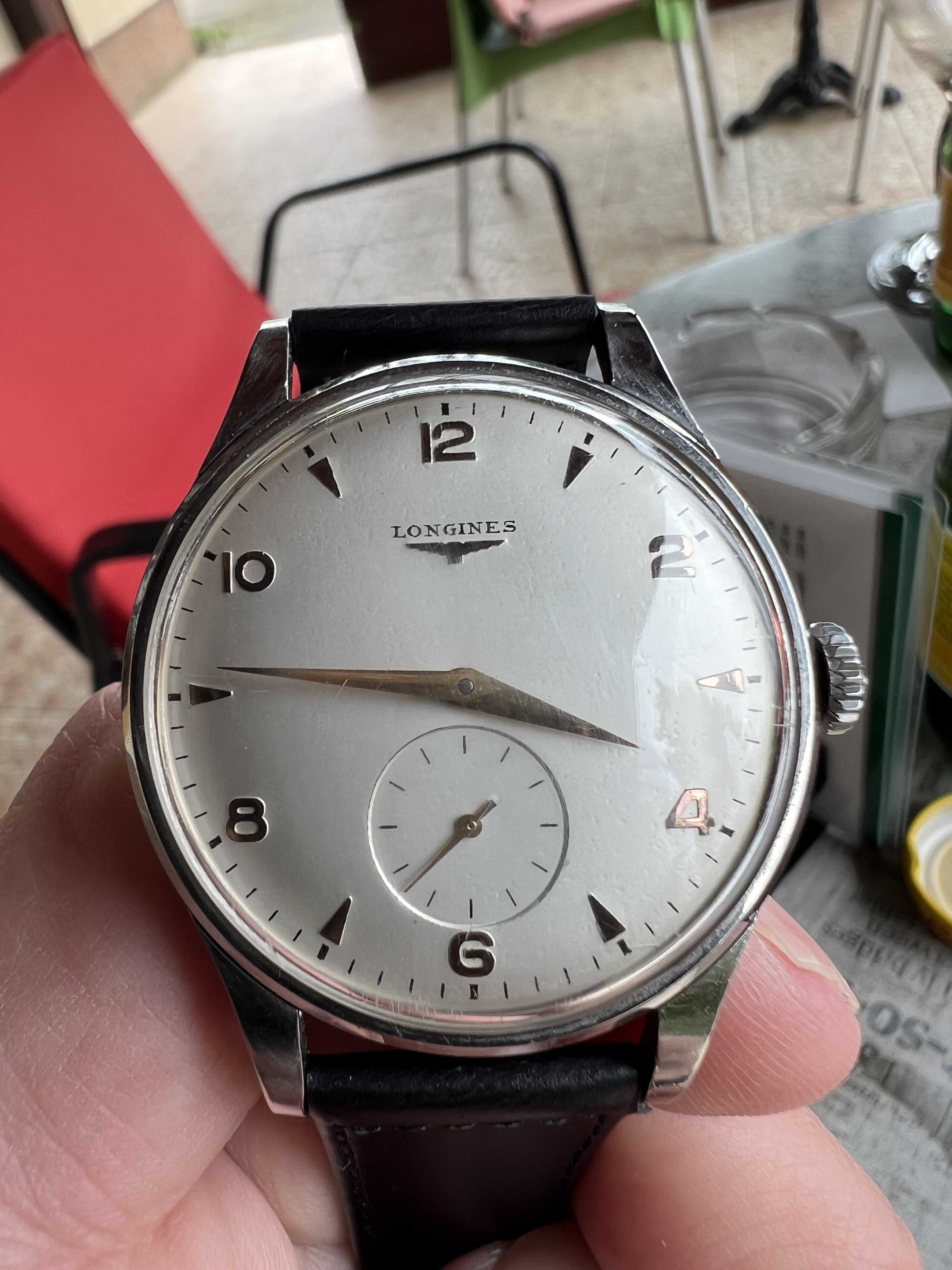

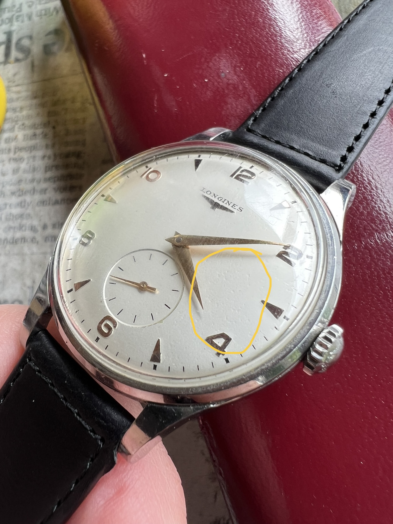

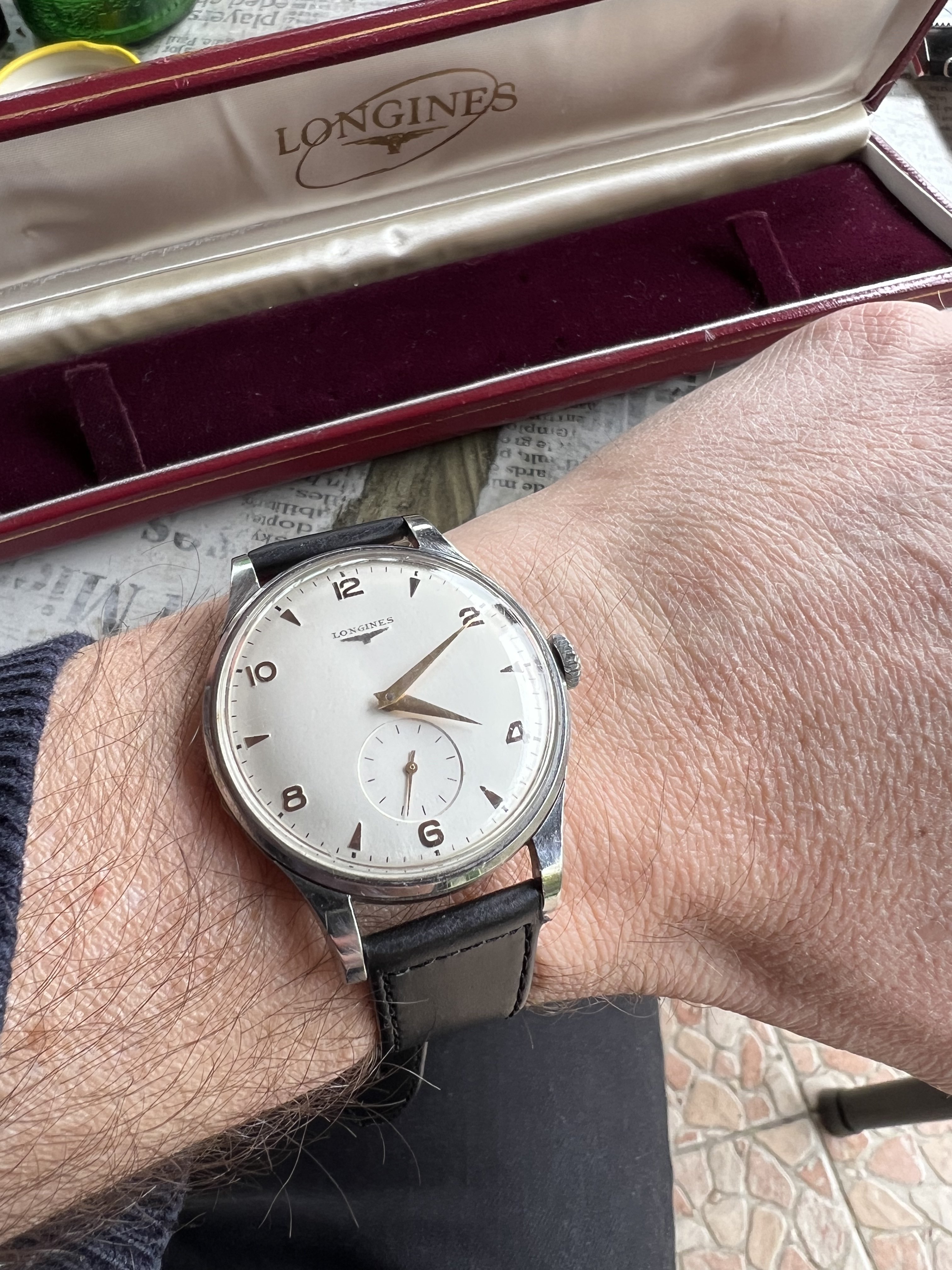

Hello everyone, what do you think about the watch attached below; is it redial ?
I'm also not sure that the hands are original, they seem too short.The diameter of the watch is 37.5 mm.
Thank you very much for your help, I appreciate that.

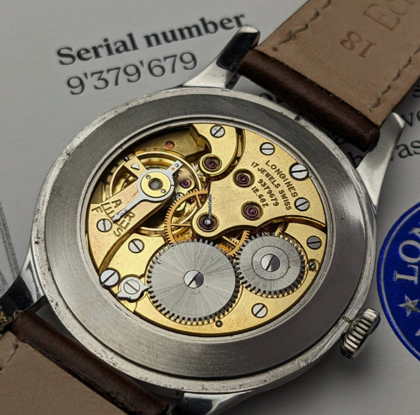

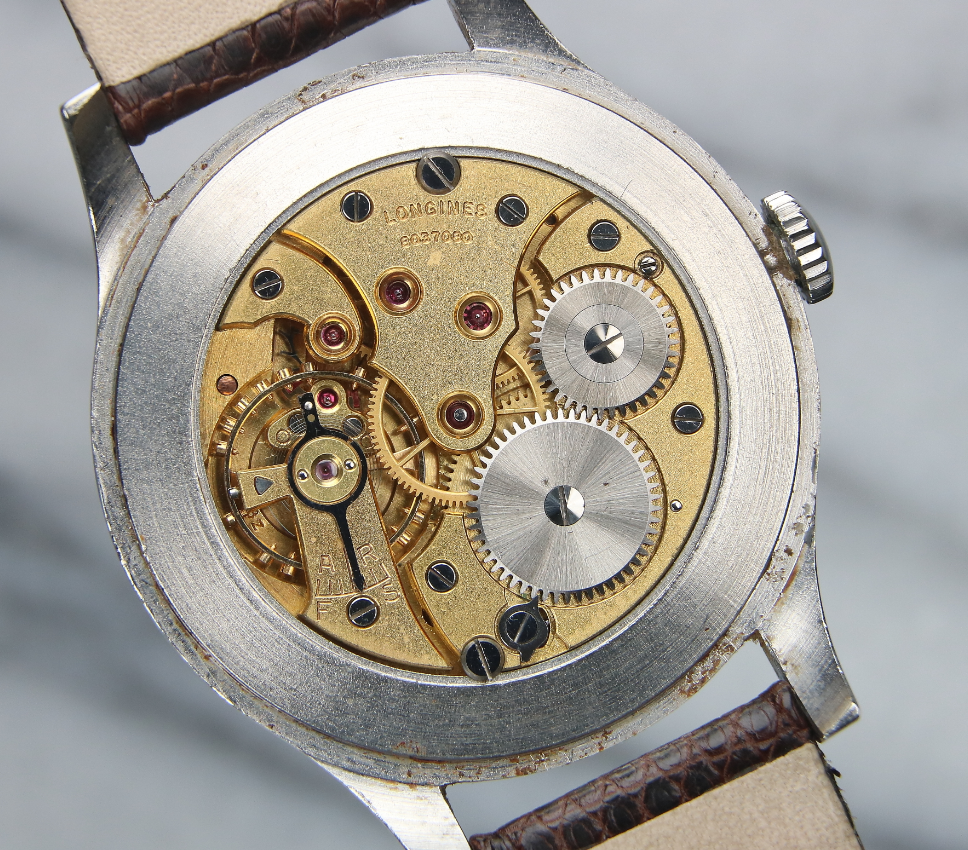

I wonder if this is a reference 4914? I have not studied this reference in detail, but I do think that these hands (hour and minute) are too short. I am not certain about the dial. Looking at a photo of the movement would be helpful to see if the condition is consistent.
3,309
37,293
Agree with your assessment, redial with replacement hands.

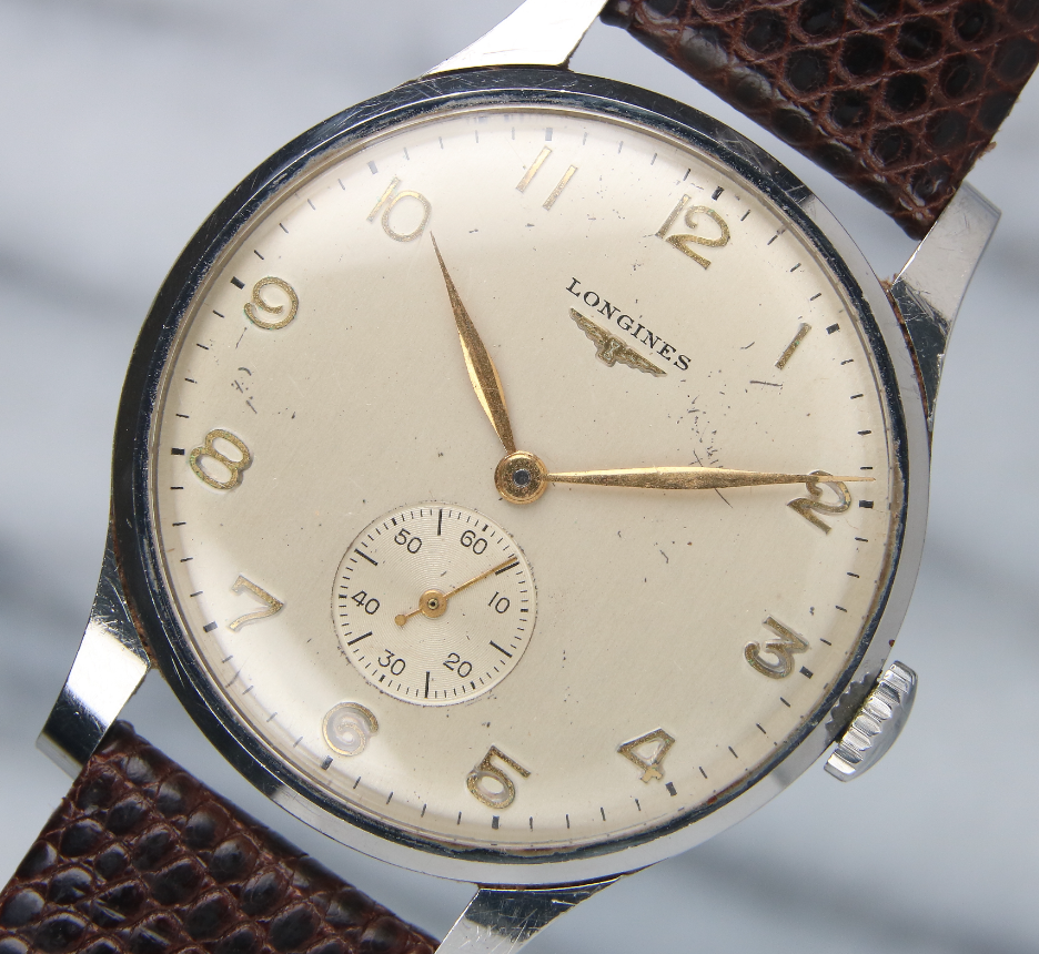

poor example removed to avoid confusion

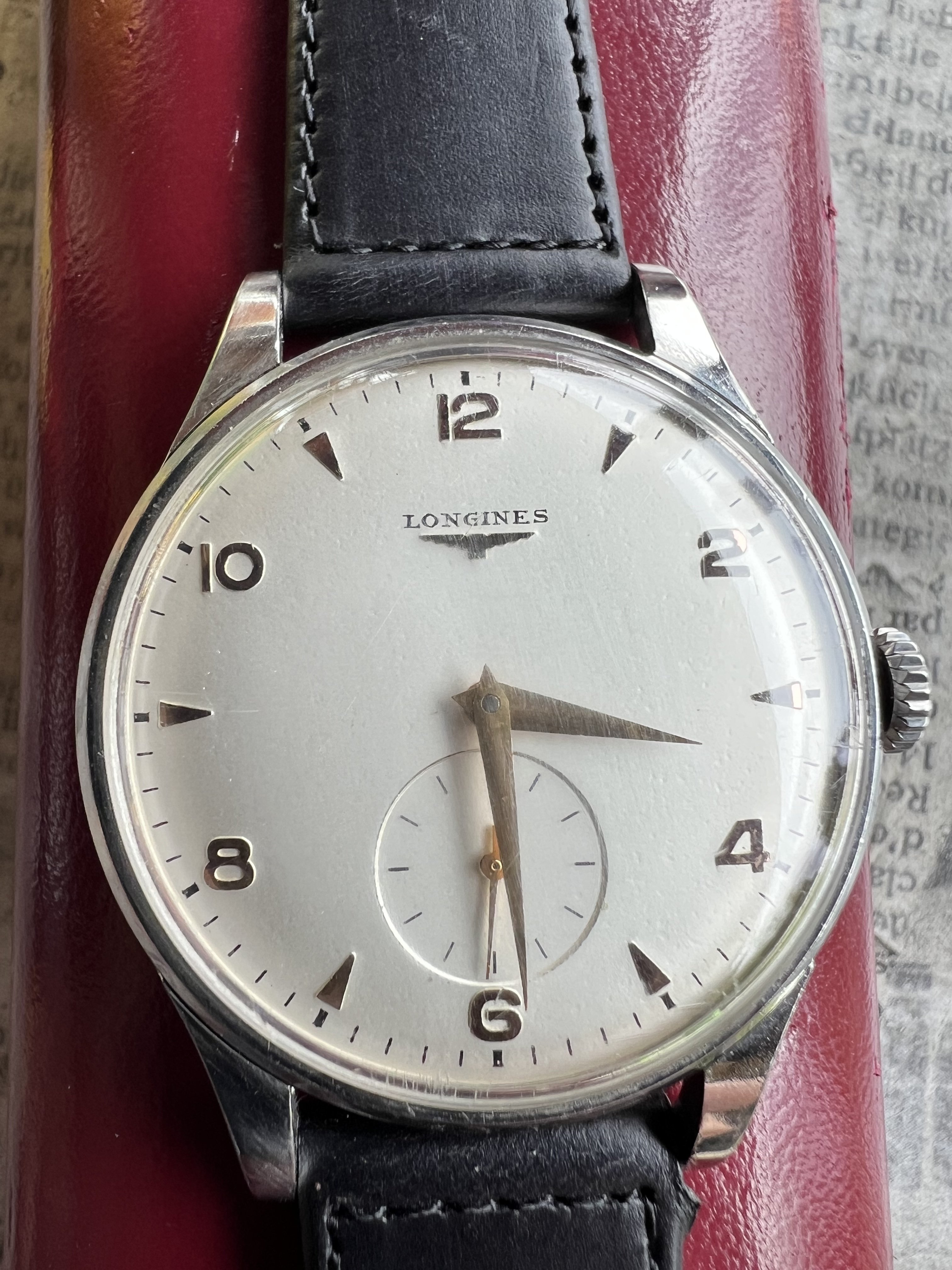

My 4914 for comparison

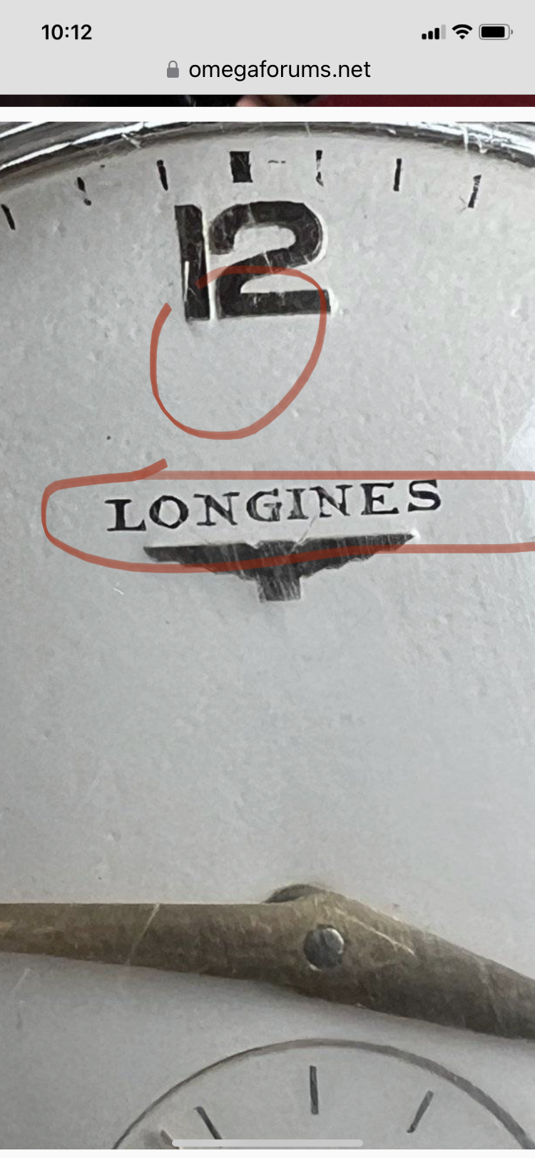

This dial looks refinished. Both the font of the signature and design of the sub-dial are not consistent with original examples. Also, the hour and minute hands are mismatched, and the crown is incorrect.

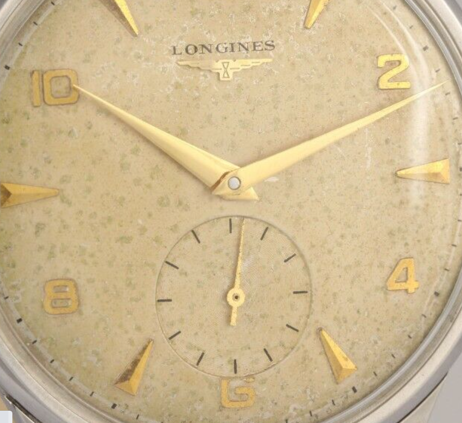

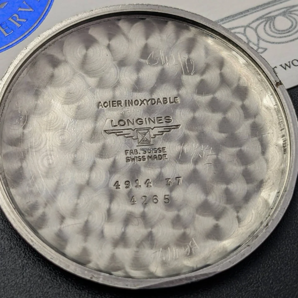

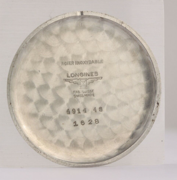

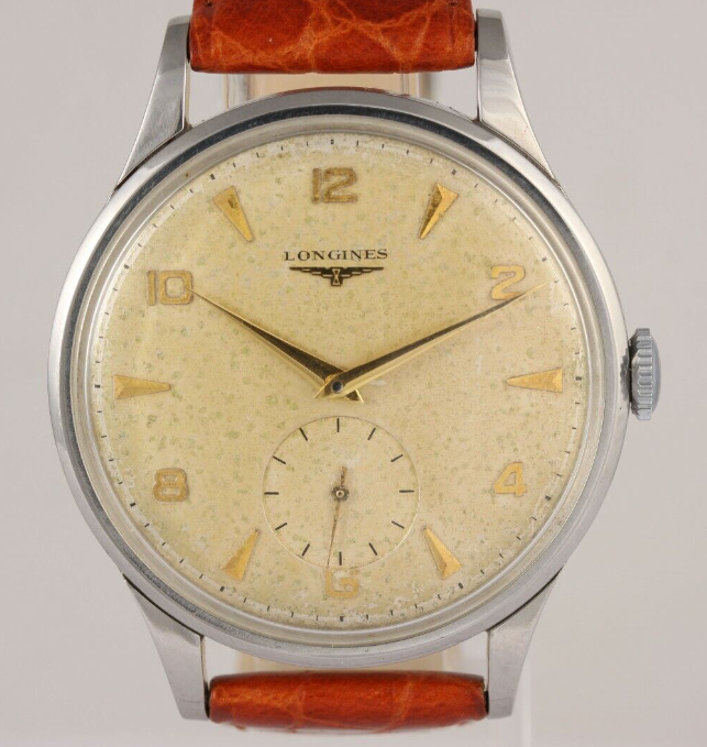

Below are two examples for ref. 4914 with original dials, IMO. The first one is an earlier example (serial 8'037'080, iteration 10) and the second one is a later example (serial 10'750'016, iteration 46). You can see that the signatures on each dial are different, but both are precisely executed.
Source: https://www.stetzcowatches.com/product/1950-longines-ref-4914-jumbo-37mm/
Source: https://www.ebay.com/itm/2842414075...XPoHzdeBS3FPAZY+A6ucoGIhzj|tkp:Bk9SR7r_lrHvYQ

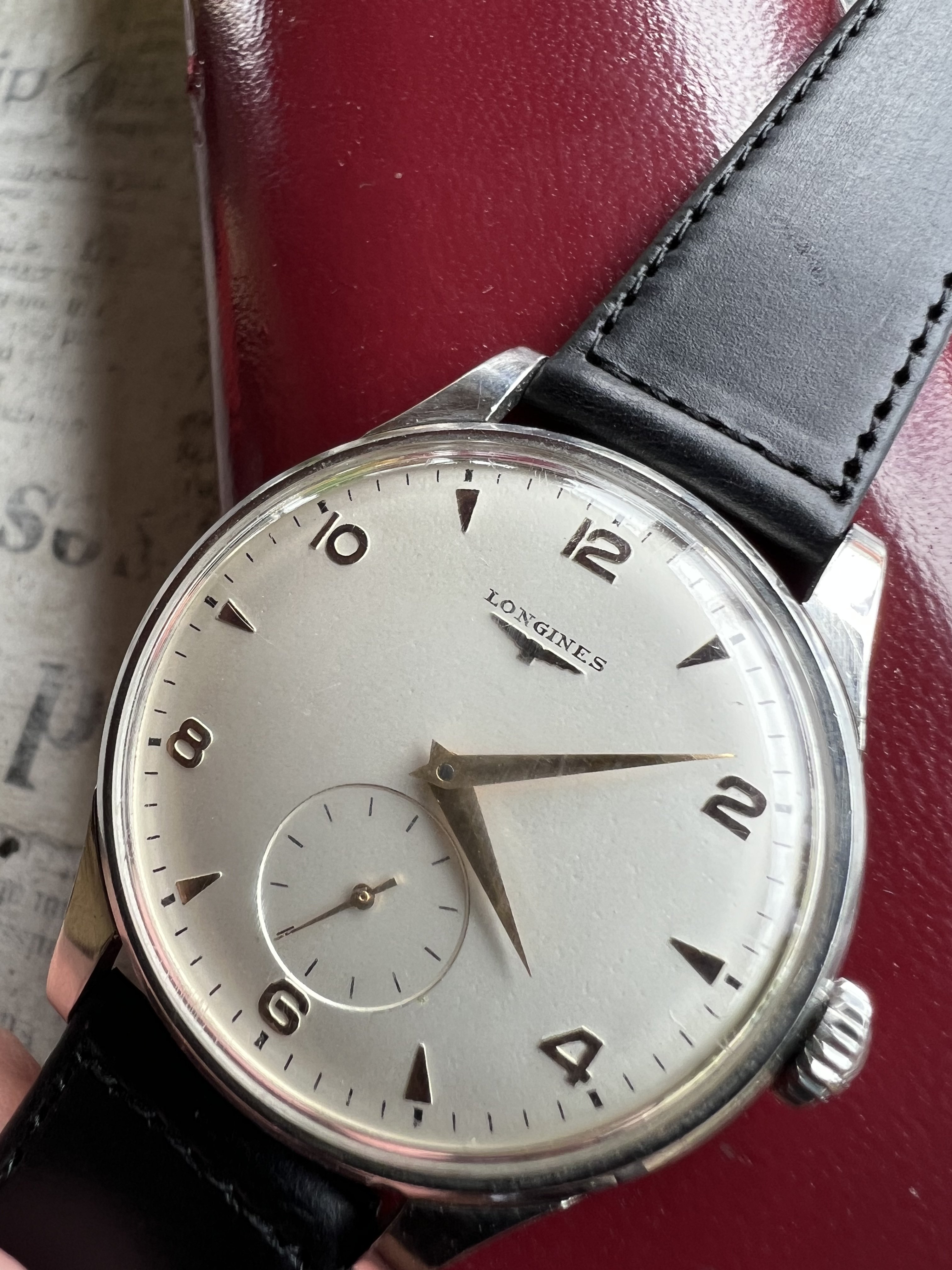

thank you very much for your comments, some of my suspicions were confirmed. Otherwise, the condition of the watch case is not bad.
Looks a lot better in these photos

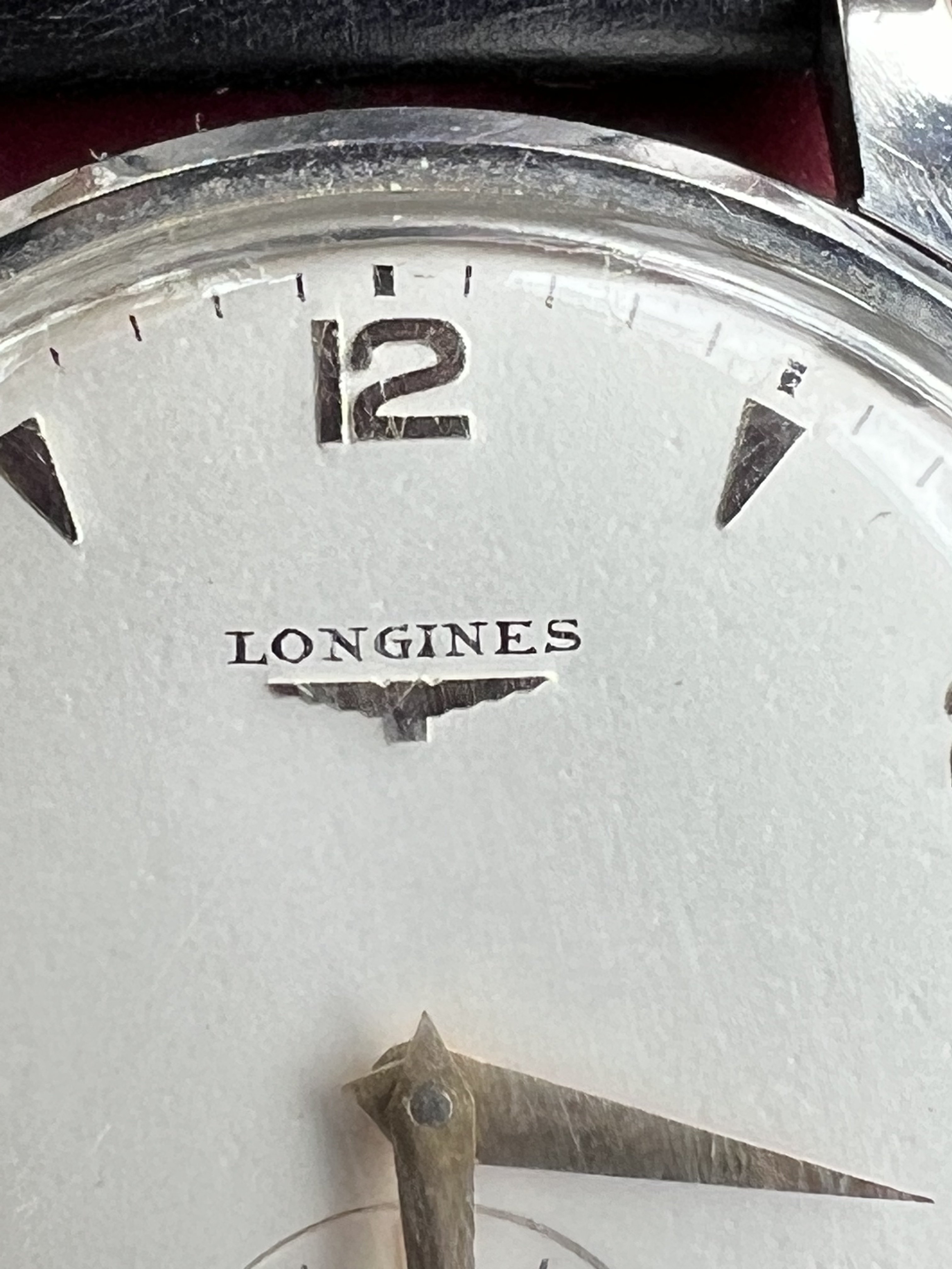

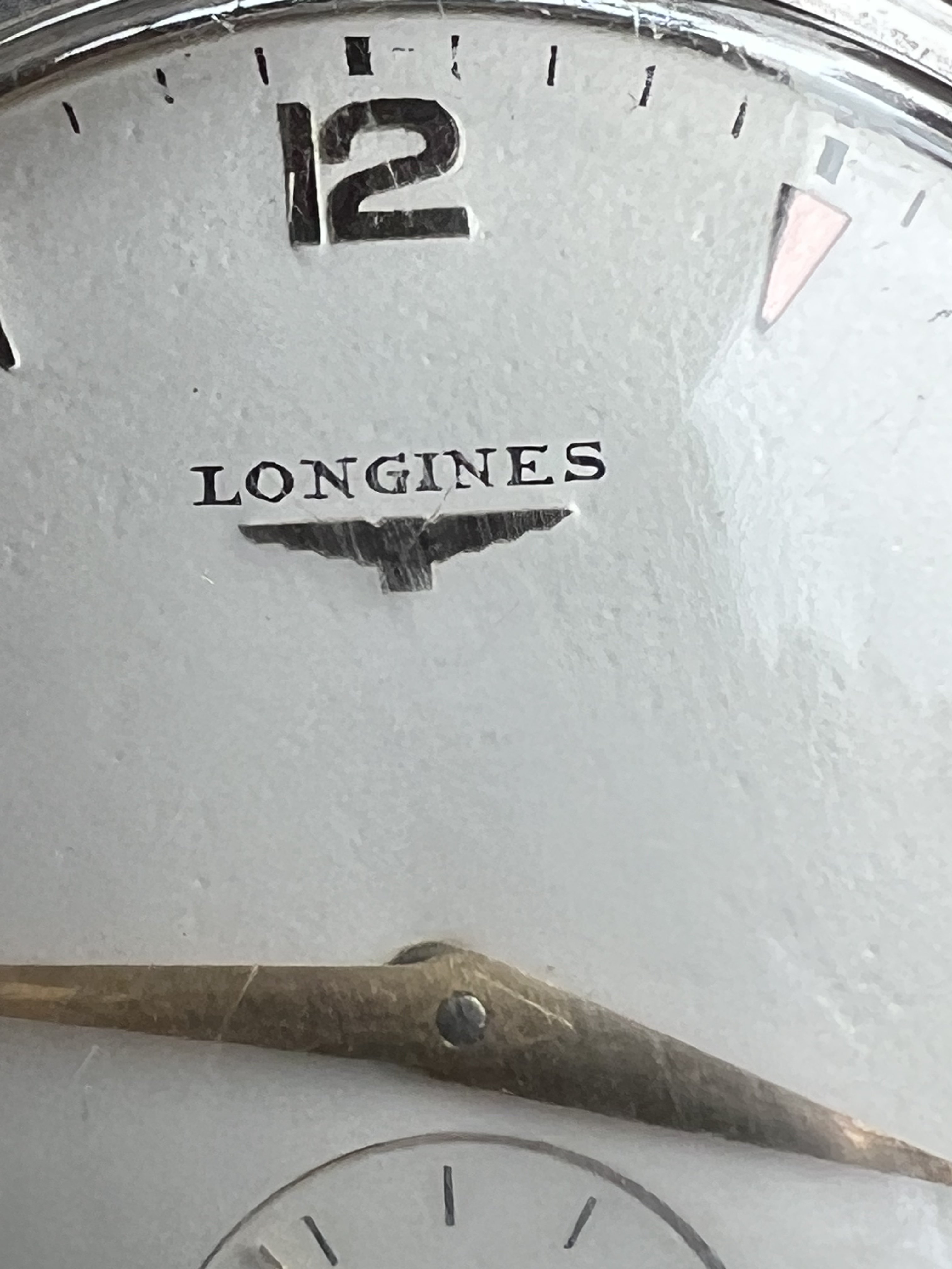

Those impressions do strike me as suspicious, assuming that they are on the dial and not the crystal.
Additionally, does the sub-dial have clearly visible concentric circles like the examples below? If not, this combined with the imperfect signature and very white appearance of the dial would lead me to conclude that it has been refinished. The more I look at it, the more suspicious it appears.
Source: https://www.ebay.com/itm/2842414075...-53473-19255-0&campid=5338788128&toolid=10001
Source: https://www.chrono24.com/longines/l...-longines-archives-extra--id28114803.htm#gref

The sub-dial dont have visible concentric circles and I impressions on dial are not reflection from the crystal.
It also seems to me that the watch was restored a long time ago, because according to the seller's statement, it was bought in that condition during the 80s while his father was working in Switzerland.
