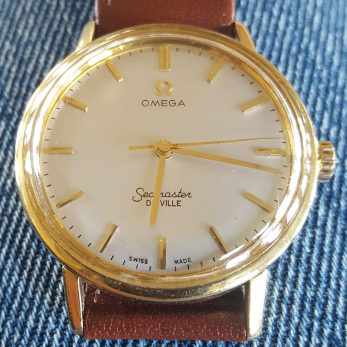

To cut to the chase, I’m now in a bargain for an 18k solid gold case Omega Seamaster De Ville manual winding watch, for which the seller asks USD 1100. I’m wondering, considering my concerns below, do you think that this would be a good deal?
To begin with, please find the photos of the watch here.
I believe that the watch is overall in pretty good condition and has original parts including the case, the crown, the calibre, the crystal glass (incl. little Omega sign in the centre); however, I’m worried about the following matters:
1. I’m 99% sure that it’s a redial (see pictures). The sans serif font used for “Omega” on top and the way “Seamaster” and “De Ville” are written under the centre are typically “unique” to this one. Note the lack of any space between “S” and “eamaster” and the steep angle of the italic Seamaster writing. Plus, never saw a De Ville written as simple as this one. And I don’t even mention “Swiss Made” being over the Seconds circle. The way the Omega logo, hour bezels and seconds look didn’t bother me that much, though.
2. Other than that the watch has a little rounded edges compared with its peers in the market.
3. Last but not least, do you think that it could actually be a Frankenwatch, given that it has a case number of 135.020 and a 600 cal with a serial number of 18xxxxxx (pointing to 1961)?
According to this informative thread on the forum, considering the case number and 600 cal, the watch should be an Omega Seamaster De Ville and not a Seamaster (with cliffhanger S). And Ranfft suggests that 600 was used between 1960-1964. I was suspicious because Omega website only matches Seamaster De Ville model that doesn’t look like the one I’m considering but as written in the thread I mentioned above, it may be the case that Seamaster watch has later on been produced with De Ville sign.
All in all, I believe that the watch is a redial rather than Franken. What do you guys think?
And what are your thoughts on the bargain I got? What about buying it for this price and changing the dial with an original one?

Redial- walk always from this one
So I assume that you don't see this as a good deal, despite the watch being authentic except for the dial? Is a redial almost always a no-go?

It heavily impacts the value / demand.
If you like it, negotiate the price down but know that the demand for it among collectors is next to nil.
16,305
45,025
^^ what he said.
if you find the redial attractive, then that is not for us to say if it’s good or bad. But it always affects value and in this case you would be applying value for the gold content and movement alone- not for the watch as a whole. If you decided to sell it down the line, you would have a limited audience- not the collector market.

Thank you so much @redpcar and @JwRosenthal ! I'm not planning to buy it to resell afterwards, just looking to buy one to collect for myself but your statement perfectly stands for my demand, too. I don't want to look at my wrist with a regret each time so I will skip this one. I'll stick to rather fully genuine timepieces. Let's hope for better bargains in the future!

I bought a lovely redial for my first vintage Seamaster (most people could never tell- it was really well done) and it bothered me to the point I never wore it and eventually sold it.
