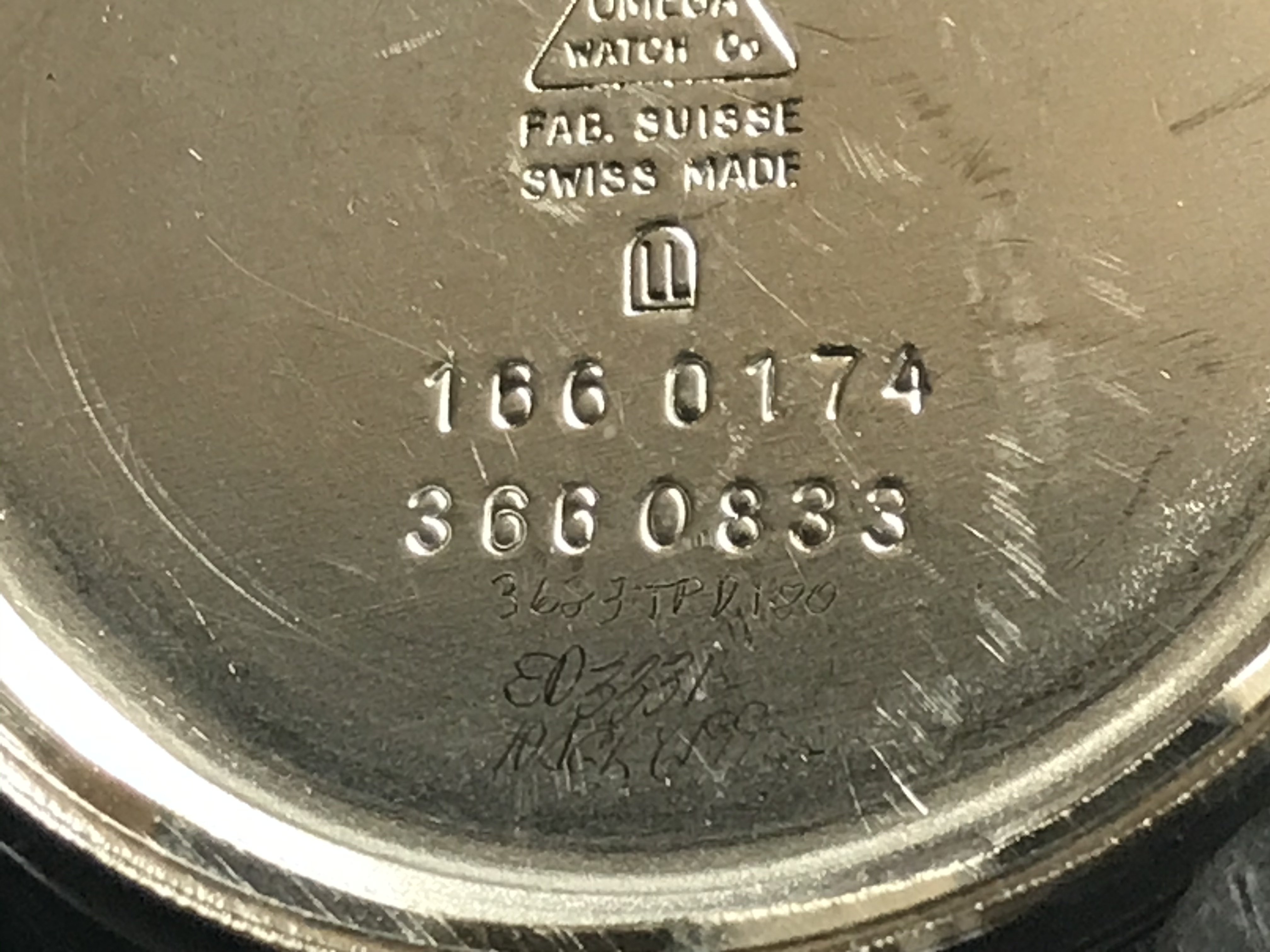

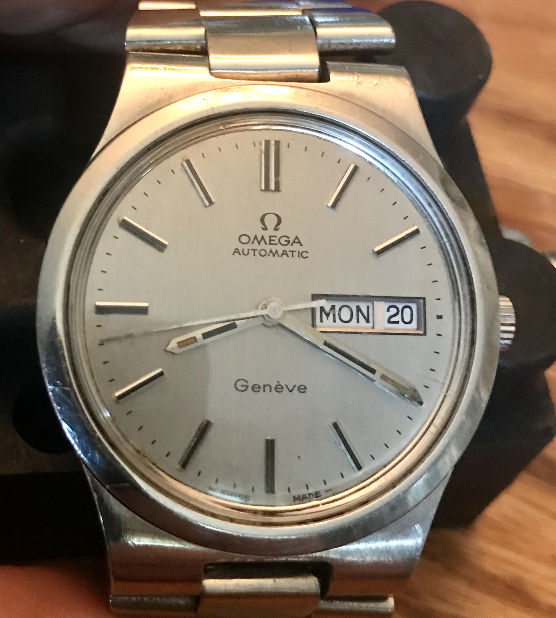

View attachment 984138 View attachment 984139 View attachment 984140 View attachment 984141 View attachment 984142 View attachment 984145 View attachment 984146 View attachment 984149 View attachment 984150 View attachment 984152 View attachment 984153 Hi All-

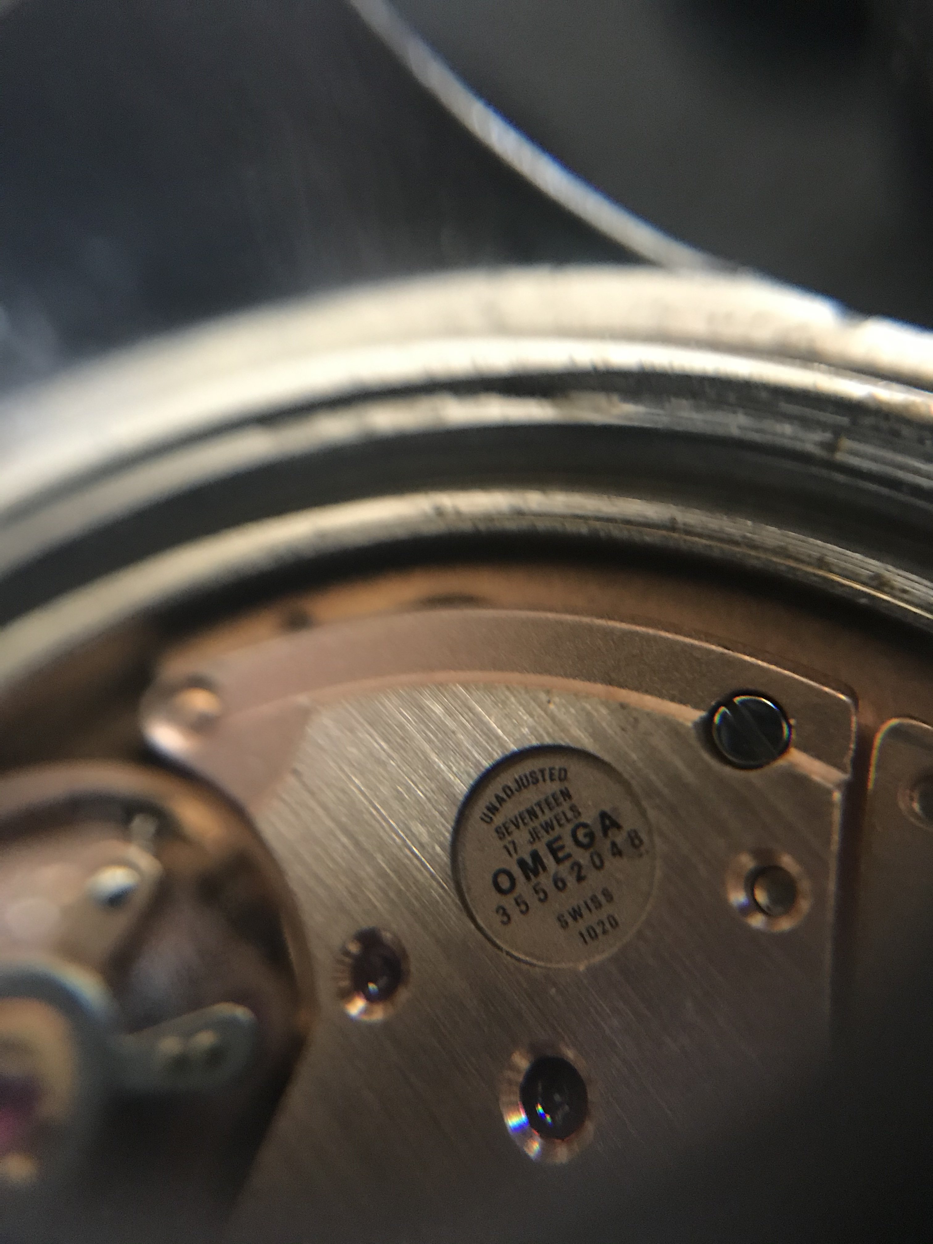

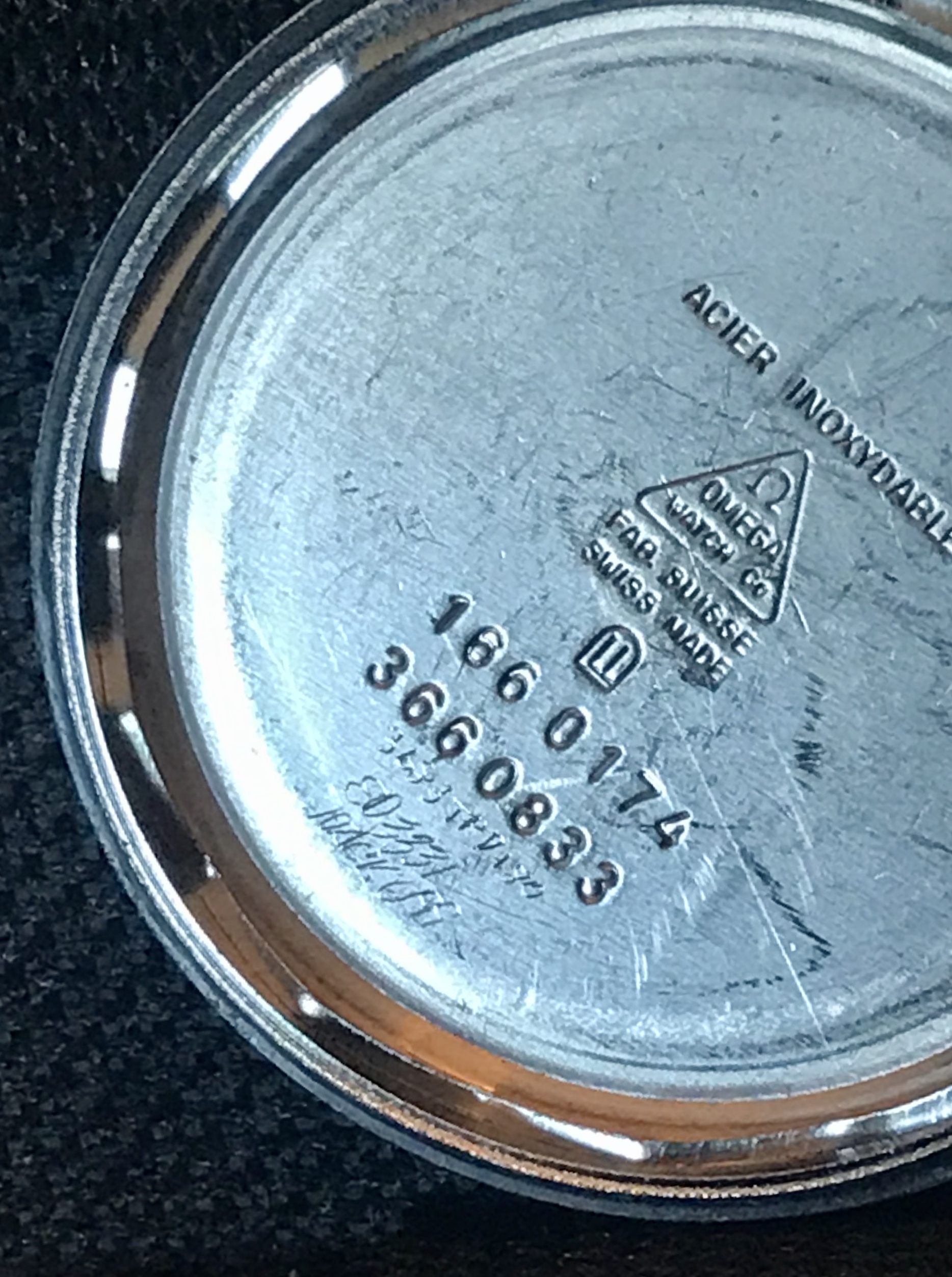

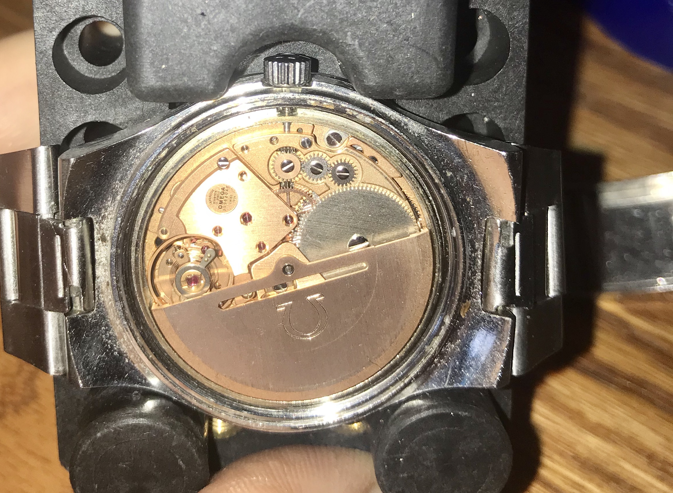

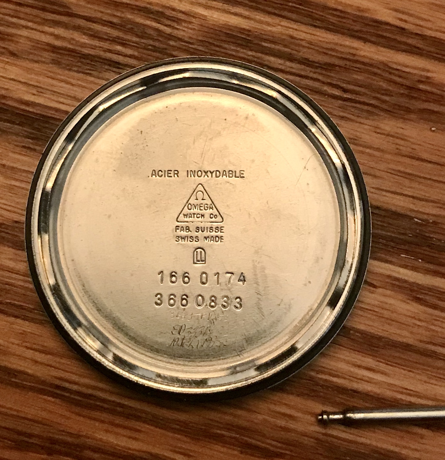

New to the forum and my first post. Apologies In advance if I am not following protocols. I was recently given what appears to be a 1970s Omega Geneve, stainless steel, automatic. I’ve opened it and shot photos but truthfully unsure if it is legit.
The watch was gifted to me so I’ll definitely be keeping it. It is used and it hangs up every so often so it isn’t really fully functional and I was wondering if it is worth investIng in having it repaired.
One link on the bracelet is missing and has been replaced with a non—matching link as well. I shot some photos, can shoot more, but I am wondering if it is a real Omega as I have looked at other images of Omega Geneve watches and its build seems a little bit inferior (just my thoughts). I base my date of the 1970s from other models I’ve seen online. There is no paperwork, box, etc. The family member that gifted this to me enjoyed watches and I really like this watch but need it to function properly. I doubt they purchased it new. Wondering if it might just need some oil in order to run properly. I’ve looked at the forum and noticed there are several posts on the proper method.
I would really appreciate any thoughts from the forum and thank you for your help.

It’s real and a nice watch worth a service from a watchmaker with a Omega parts account. For a few hundred $$s you will have a nice watch that will be a great watch for the next 5+ years. Bracelet parts may be available
( Don’t send it to omega as they are not sympathetic to keeping it original. )

Then it’s really important to get it serviced, as @STANDY has said. If you don’t, you risk placing unnecessary wear on the internal parts. It should become a great daily wearer with a little love and attention. Members here may be able to recommend a good independent watchmaker if you share your location.

5,076
15,713

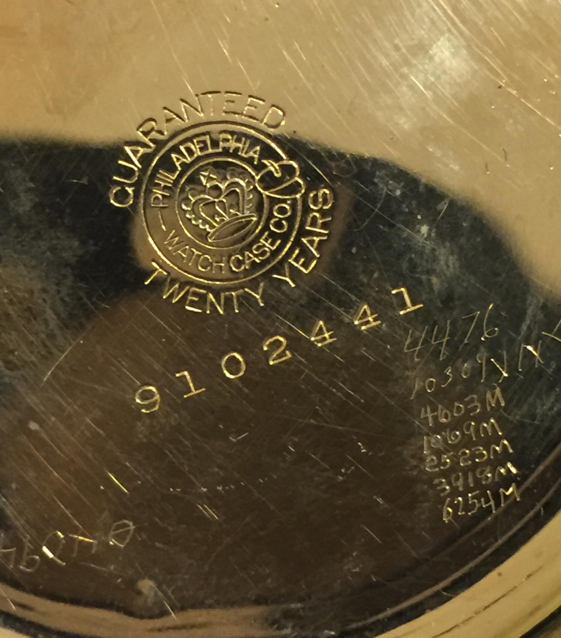

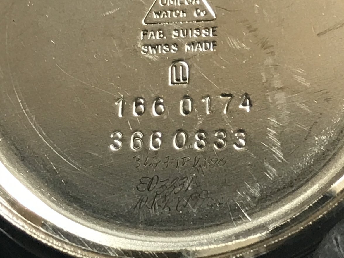

Can you post more photos? Just kidding 😉 Watchmakers put these marks inside watches (occasionally and unforgivably on the lugs) to track when they serviced the piece. It is kind of like a shorthand, rarely can you decipher what it means without the watchmaker translating it for you

That’s really interesting. I’m guessing that there are certain scripts tied to particular watchmakers.

And on a positive note, it’s been serviced more than once in its lifetime.

I get it. That’s an inscription for each service. So the serial number is neither of these. Is 35,562,048 the serial number? If so, then that would make the year of the watch 1972 according to this chart.
10,804
16,814
35.5m is more like 1975. Most of the online tables like the one you link to have big inaccuracies or are very vague, that one is no exception.
I find these marks pretty cool to see. You can sometimes see the same watchmaker’s script, who worked on it for years, and then someone else performed the service. It is a fascinating picture essay, and could be its very own thread

That’s really quite interesting! I wonder what they refer to? Is it a code for what type of work was performed? An identity code of the watchmaker? A service ticket number?

Thanks. I really do like the watch. I was looking to find a replacement stainless steel Omega bracelet or just get the one currently on the watch repaired. Also wondering how much it will cost to get it working again and where to take it. It currently runs but then stops after a few minutes if there isn’t constant movement. I guess if it stopped it would give me the correct time at least twice a day.
Could be all of the above. In some cases the code refers to a date, it could be an internal job number for the shop, and in some places watchmakers were assigned individual codes by a governing body for the trade. But it varies based on where in the world you are, and what era the service was done in.
This is no longer considered good practice as it is intentional damage to a customer's watch.
