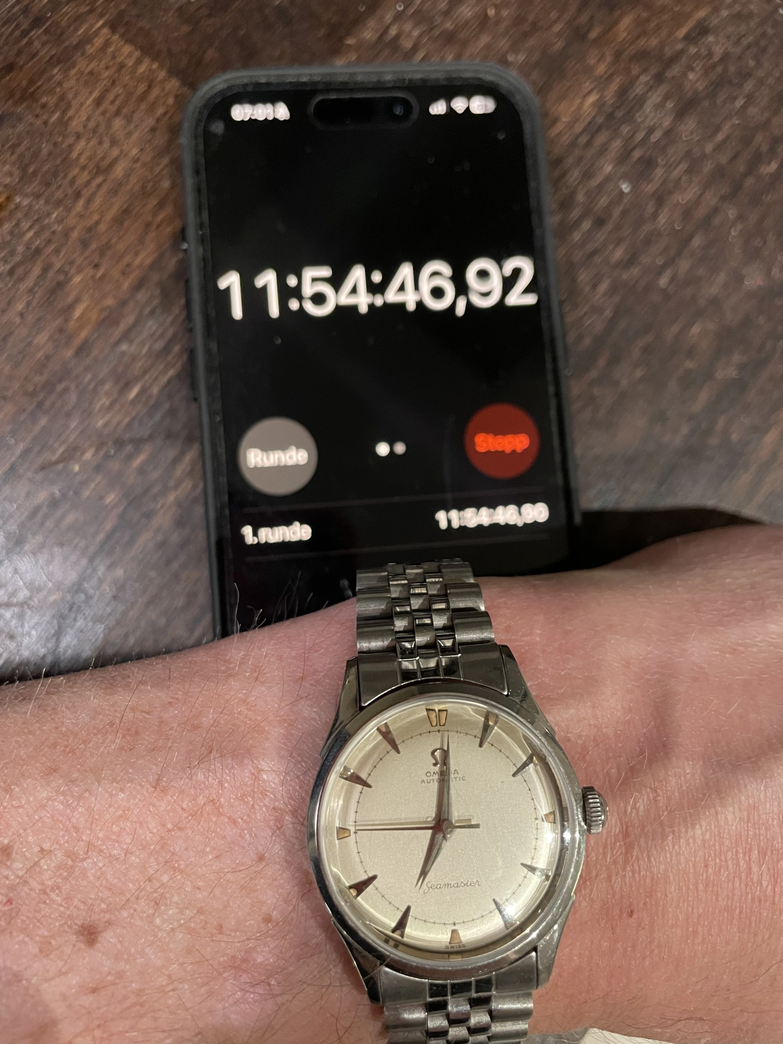

For those holding your breath:
Currently about a second off, after almost 12 hours on the bedside table. I’ll report back in 12 more hours👍
