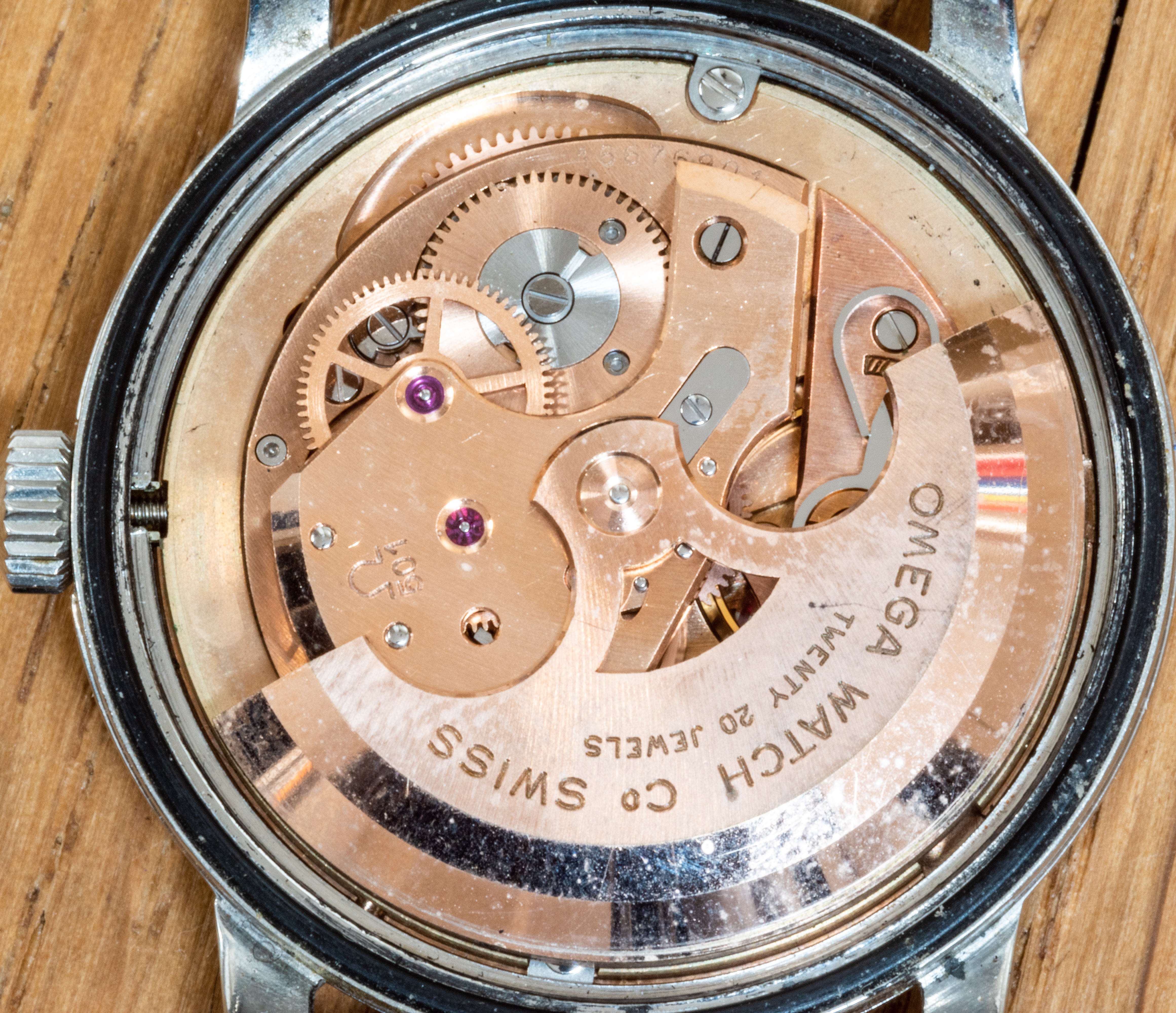

Hi people of all knowing and smart and stuff. Is this common in vintage omega watches that dials are fake on them.
Or maybe anyone knows what is the watch called, because I can't find exactly same looking seamaster.
Thanks for your kind help.

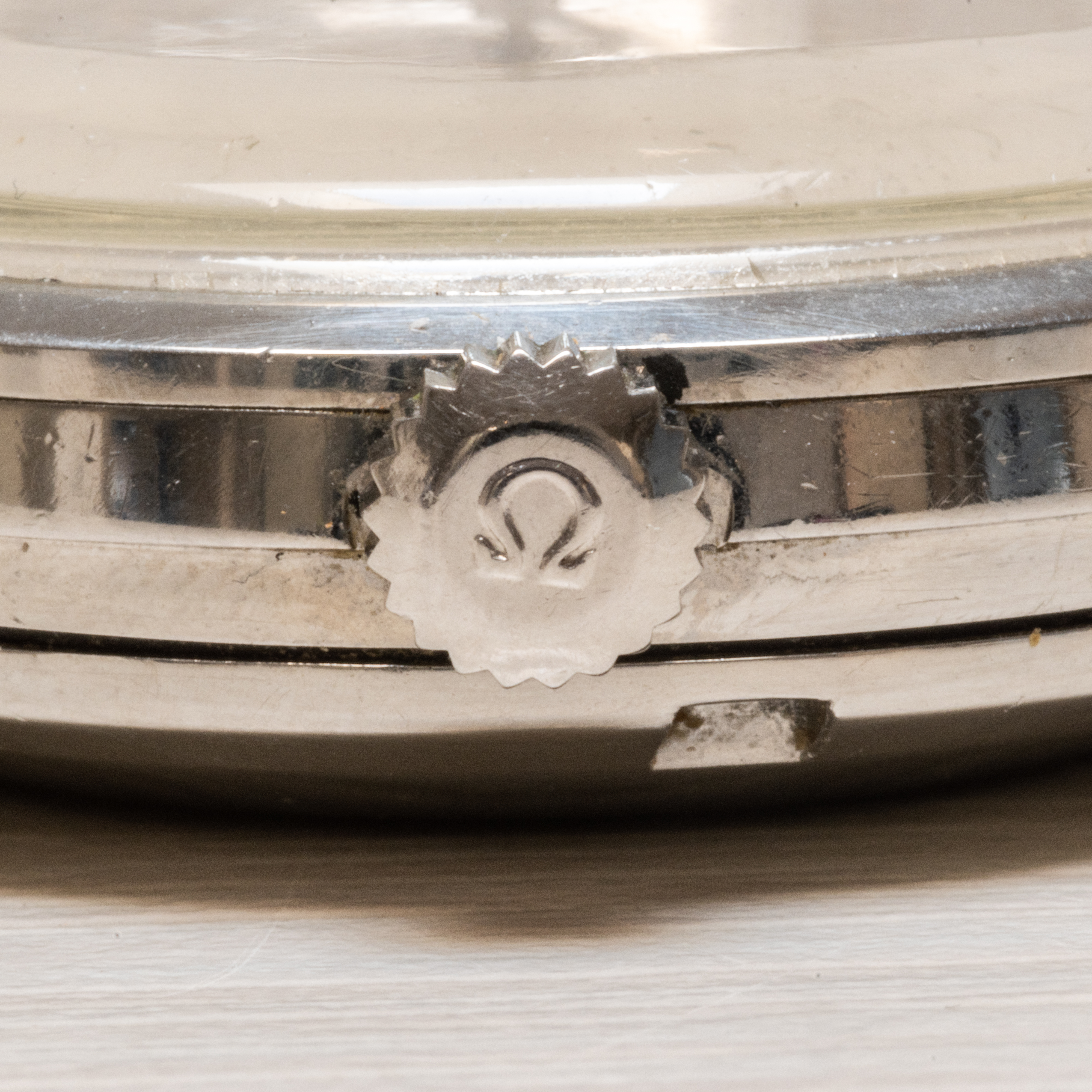

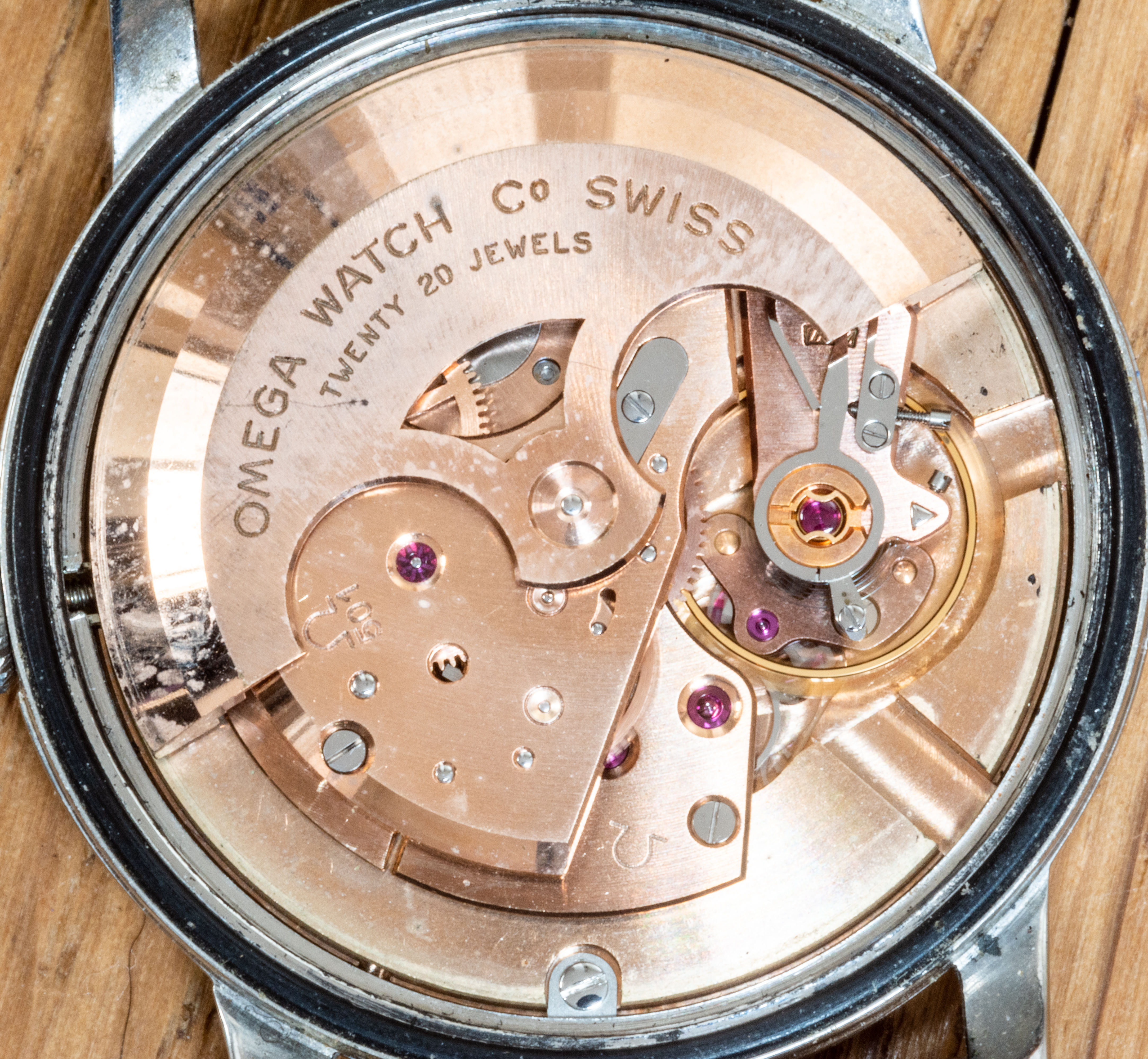

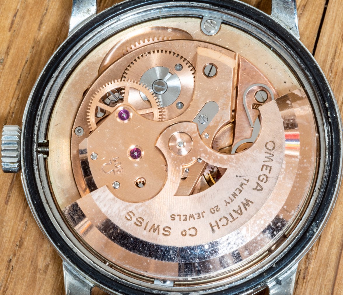

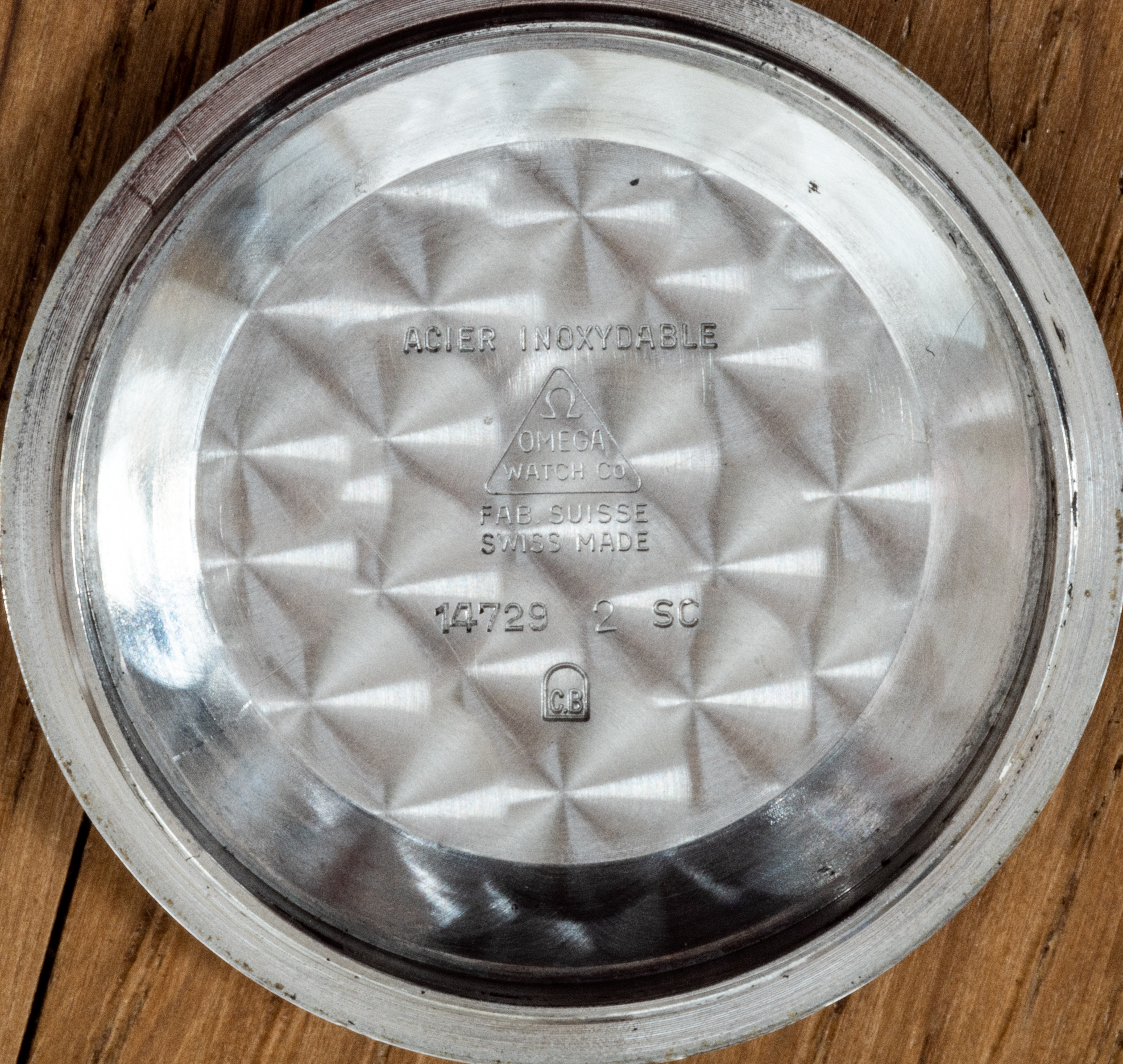

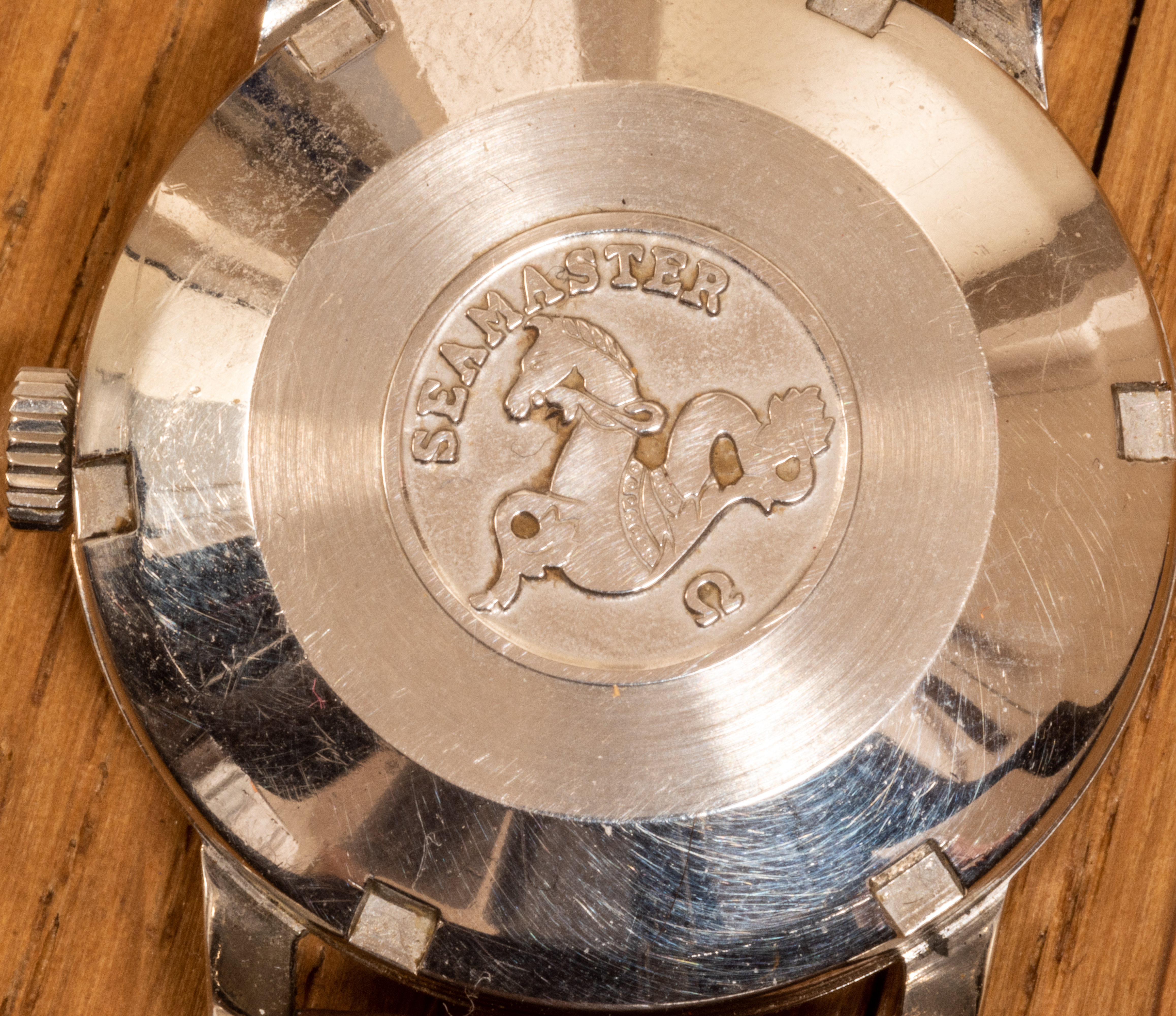

Hi
here are some better pics.
Thanks people.
PS. not good idea to make pictures with macro lense😵‍💫 , needed to reduse picture size , could not upload . Hopffuly its ok
1,536
1,735

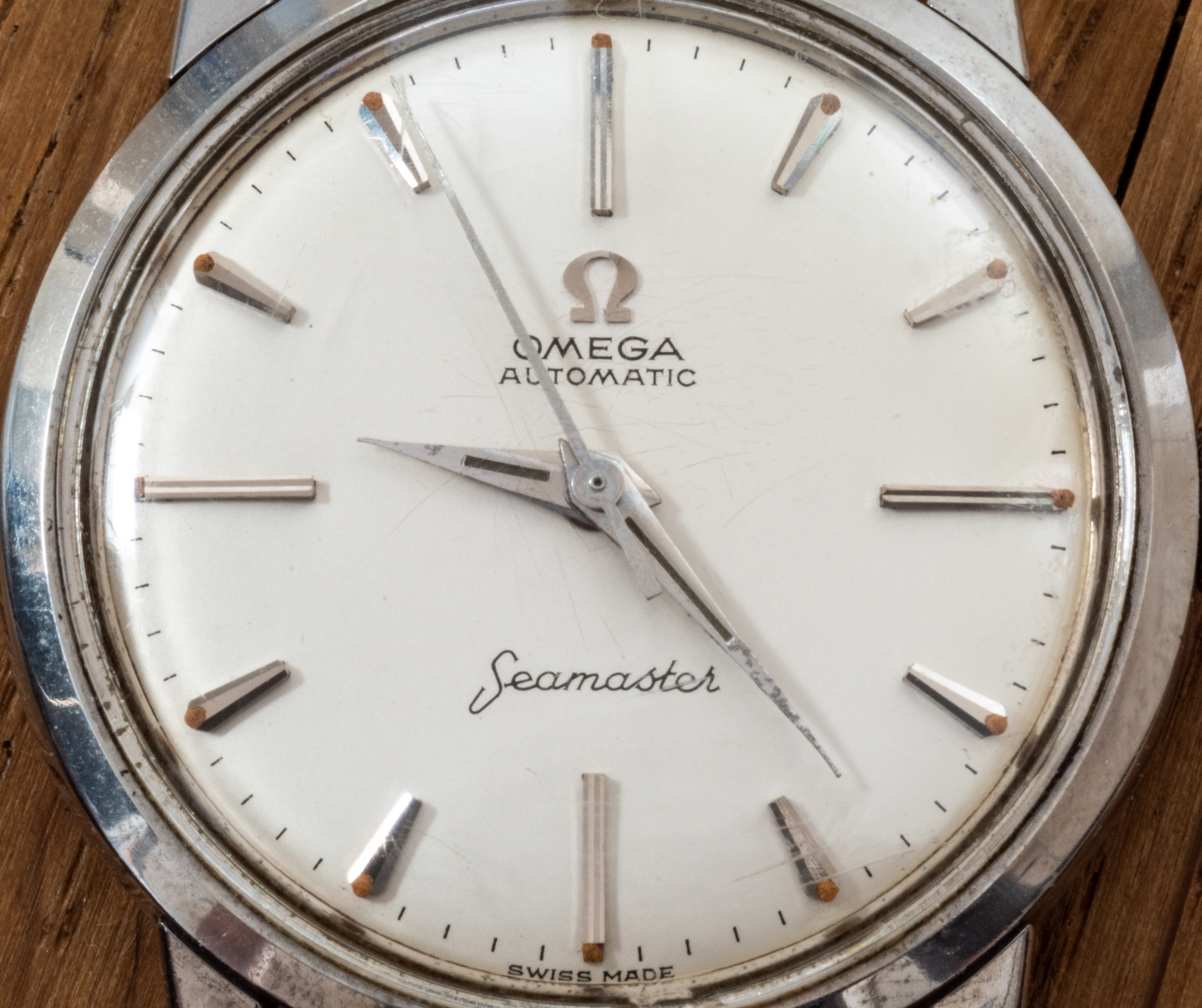

Font looks ok to me, based on the shape of the 'S' the movement serial should date it to 50s or early 60s. Also I see lum dots on the markers but no Ts.
Something to look for.
Cheers,
Harry
5,537
9,475
That date range would mean radium, not tritium, so there would be no Ts on the dial (I don't think that started until around '63 anyway). No lume on hands, so likely hands are not original. Some dial degradation around the 2 marker. Also looks like there may be some crazing, unless that is in the crystal (not easy to tell much from the straight-on dial photo)
365
455
The dial seems to be in very good condition. Damages are on the crystal only, IMO.
Enhanced picture
7
4
Enhanced picture
we were not so worried about it being fake. As it's bought in Switzerland local buy/sell site, just seems bit strange that we can't find exactly same looking watch. And don't fancy to pay 100 franc for omega to identify the watch.
