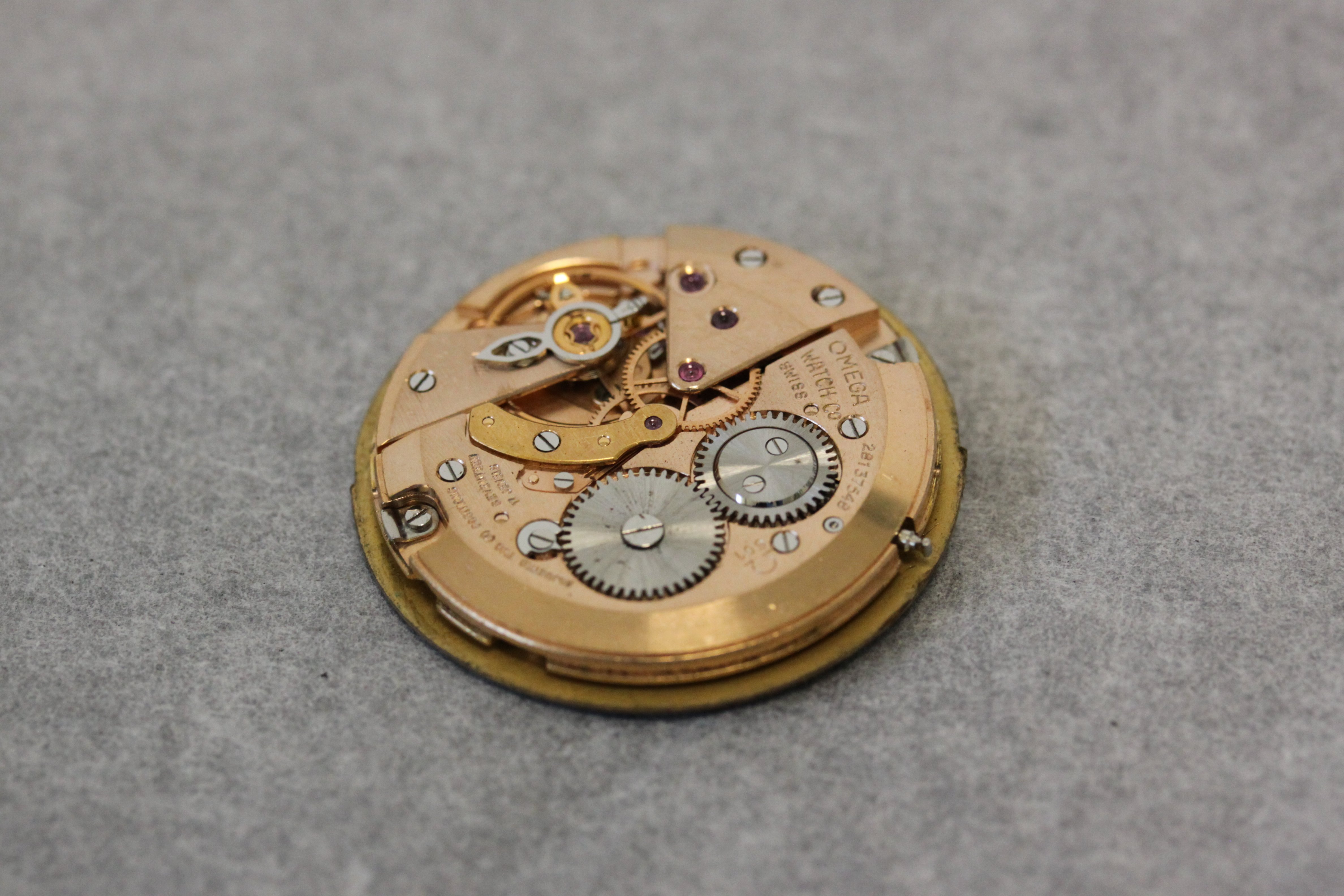

Hi all,

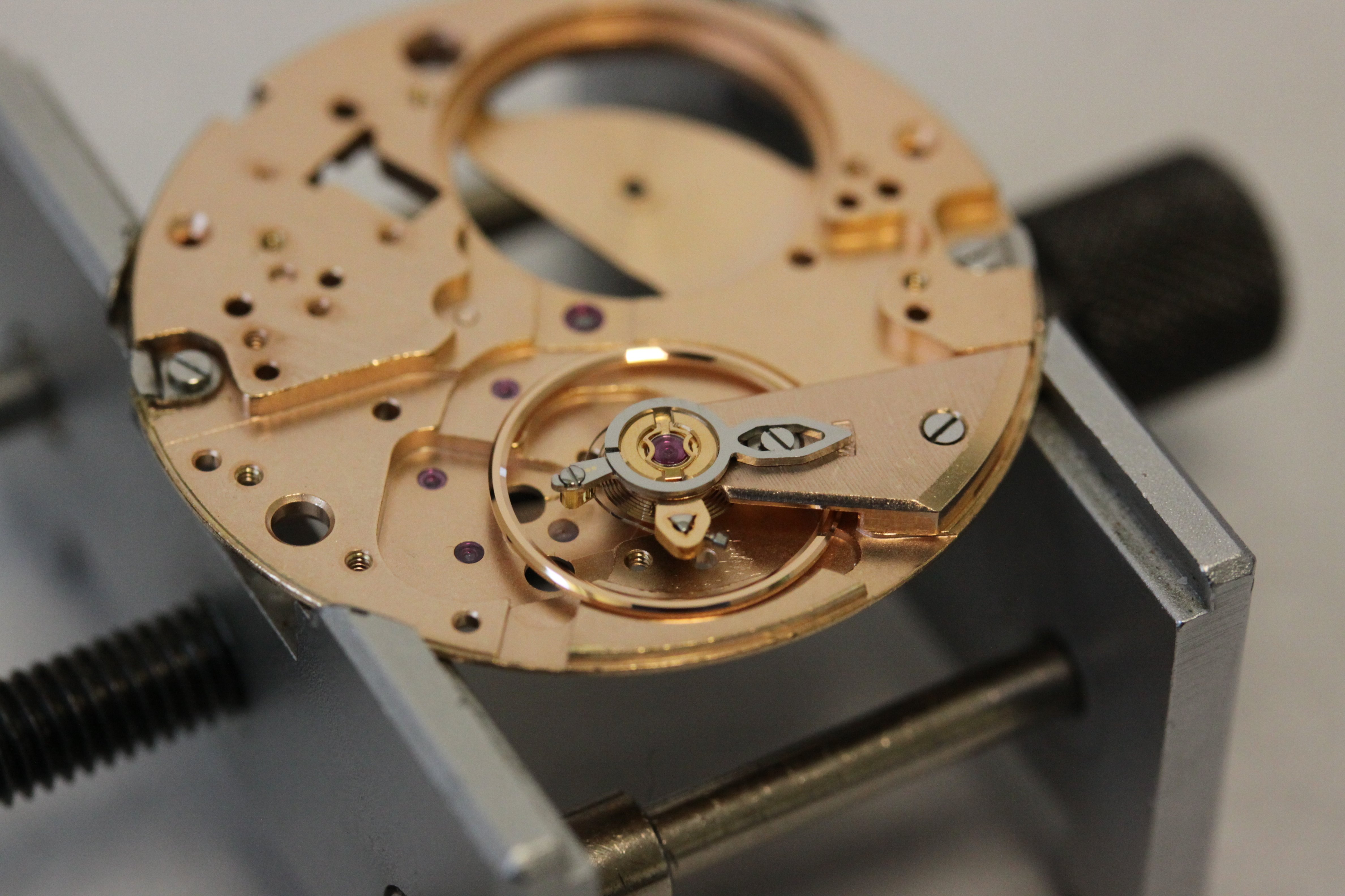

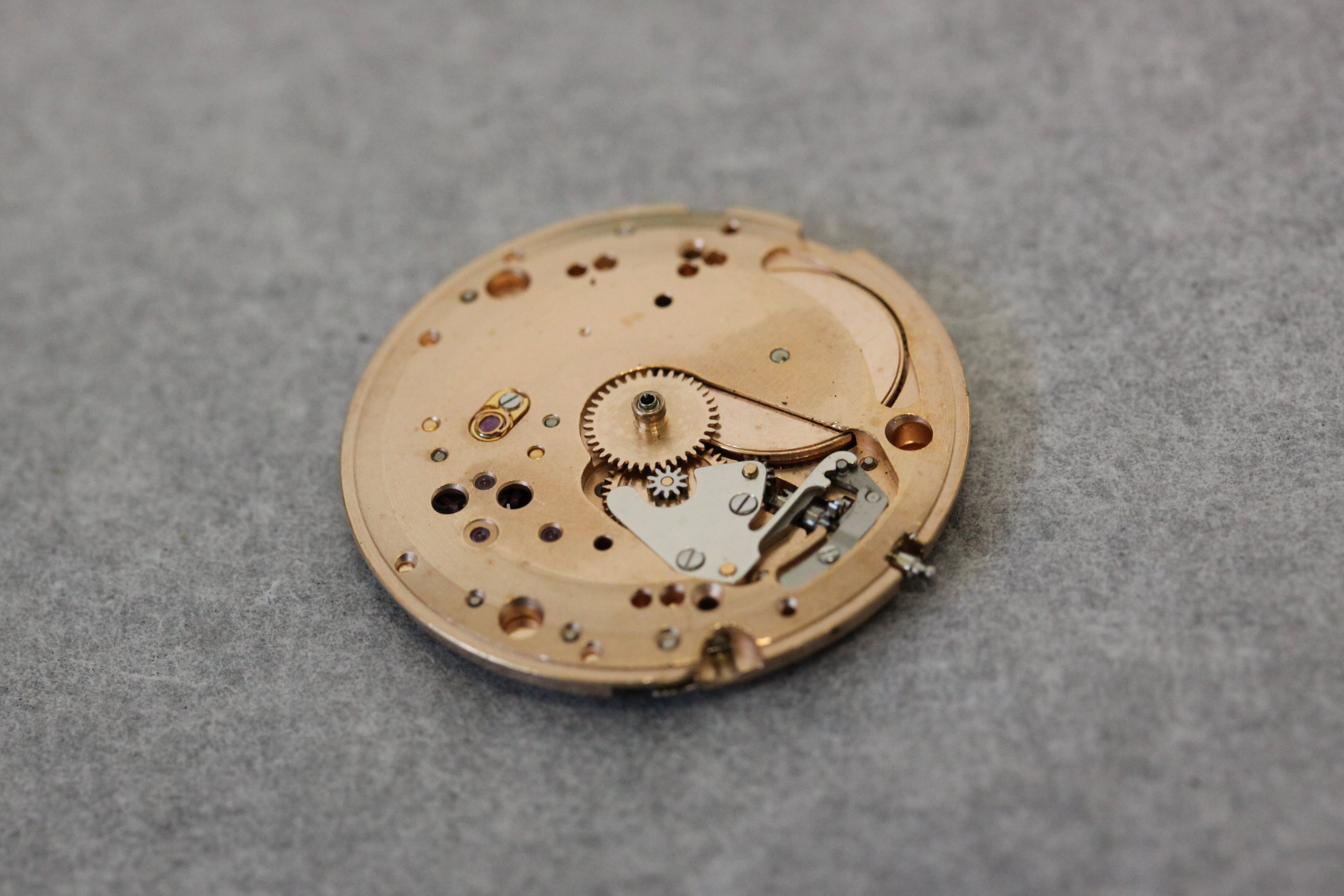

I'm brand new to the forum, so thought I'd introduce myself by showing you some photos from a recent watch service by Mitka's Watch Shop, coz who doesn't like seeing some service shots from a cal. 601, right?! Anyway, a little background, the watch was bequeathed to me by my father for completing my GCSEs, I'm 38 now, so do the math(s). Great little thing and very sentimental too.

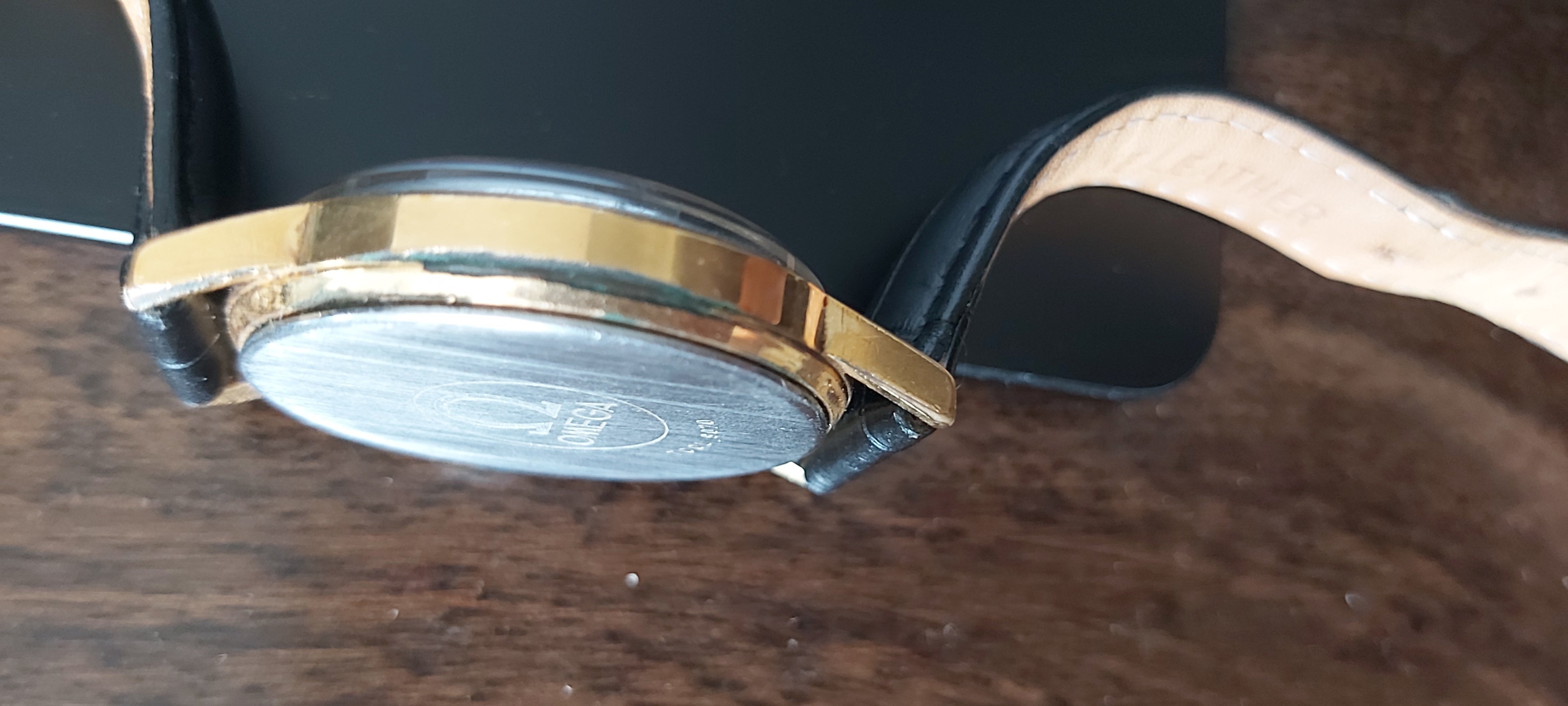

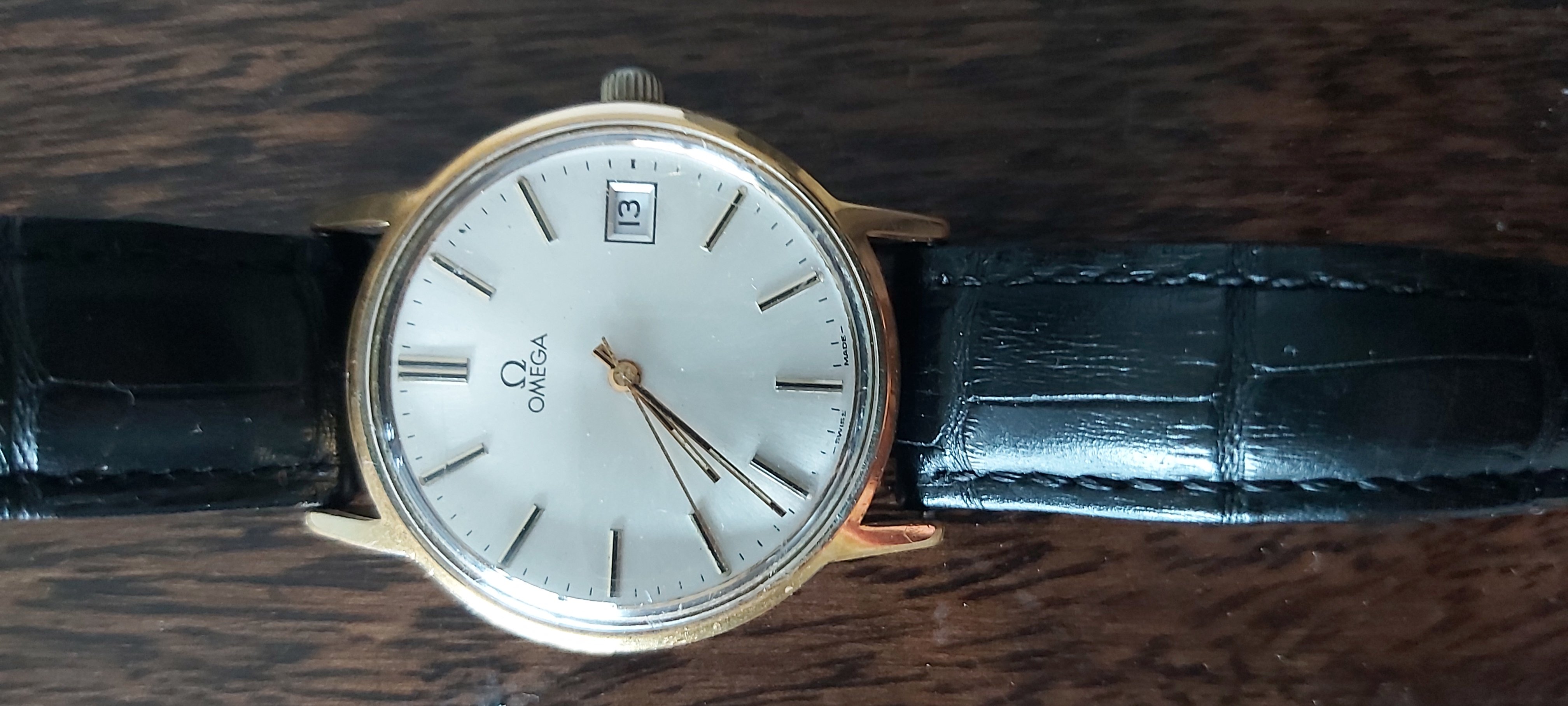

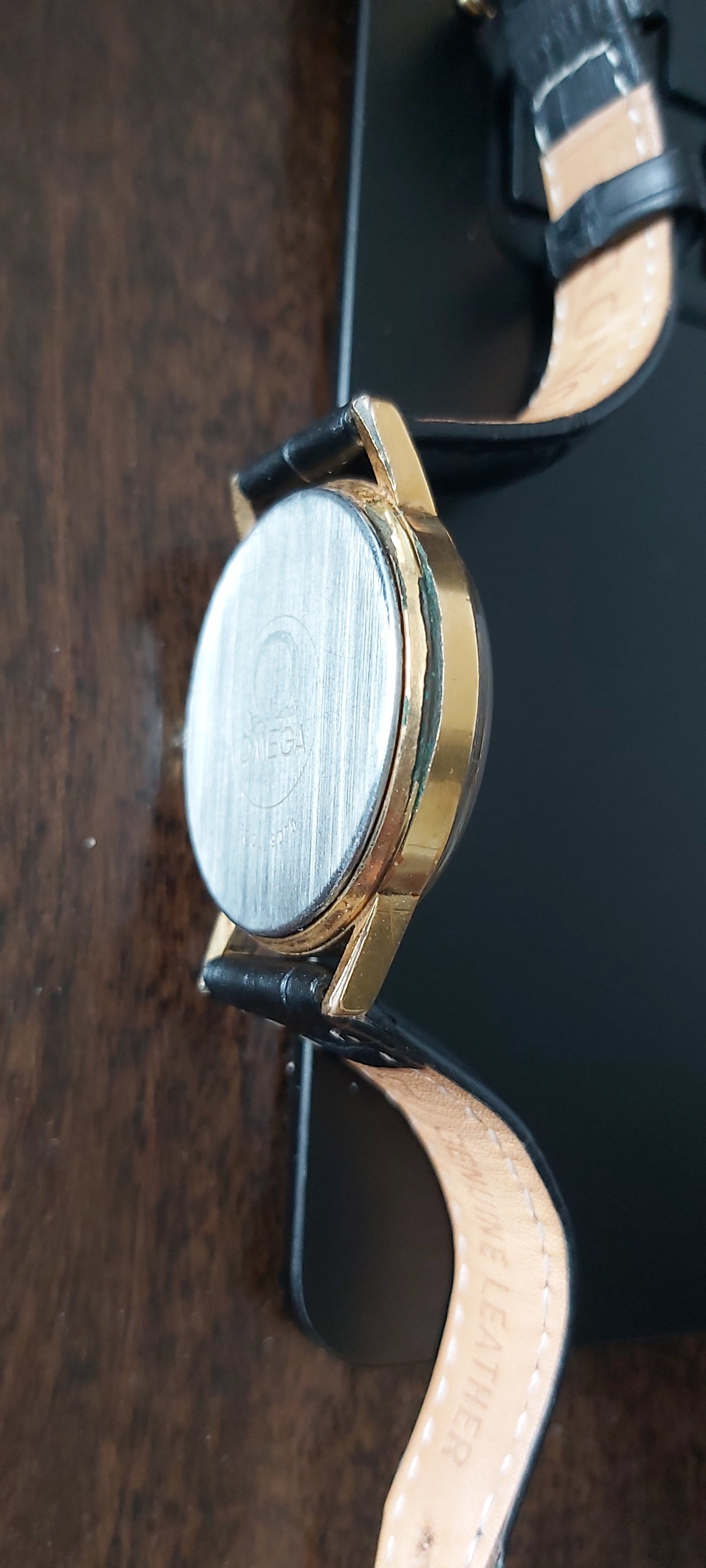

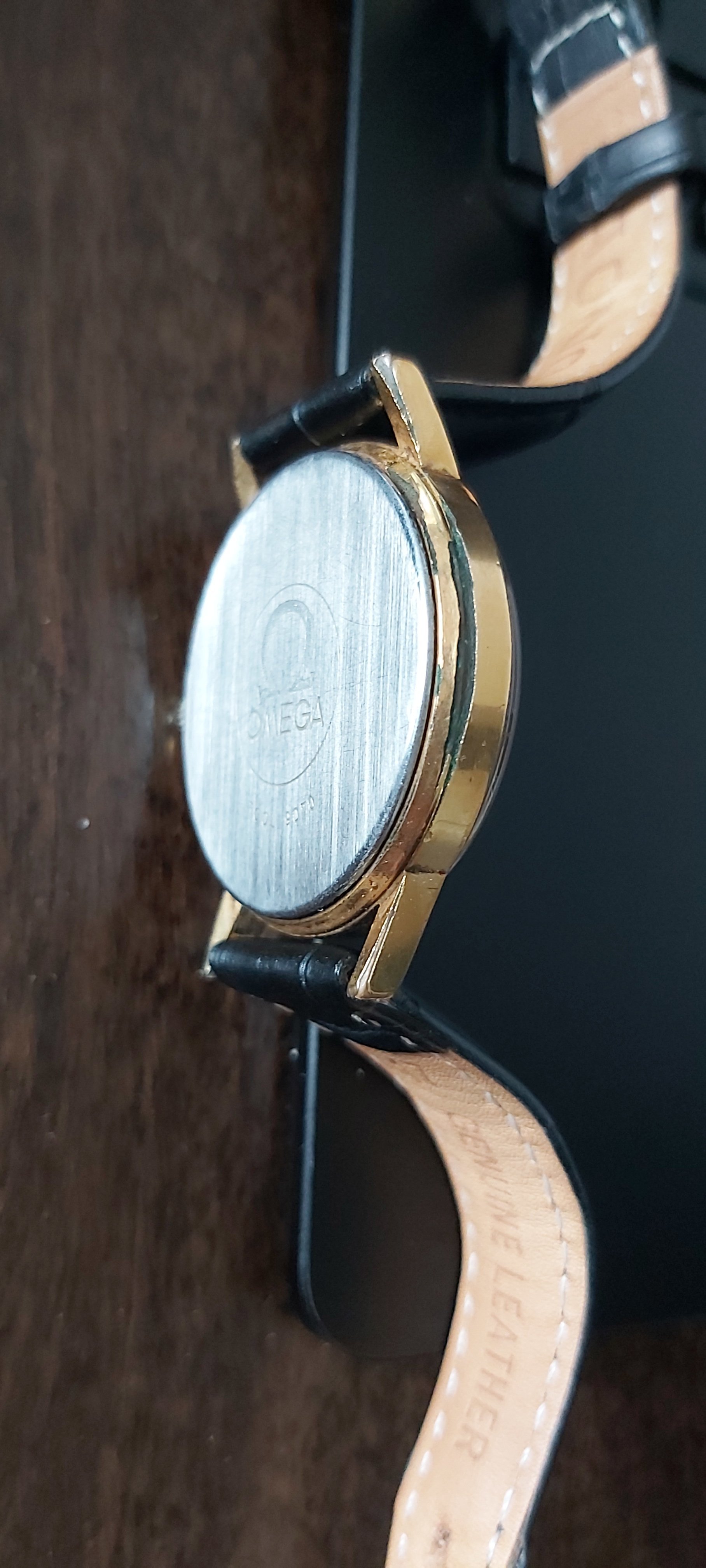

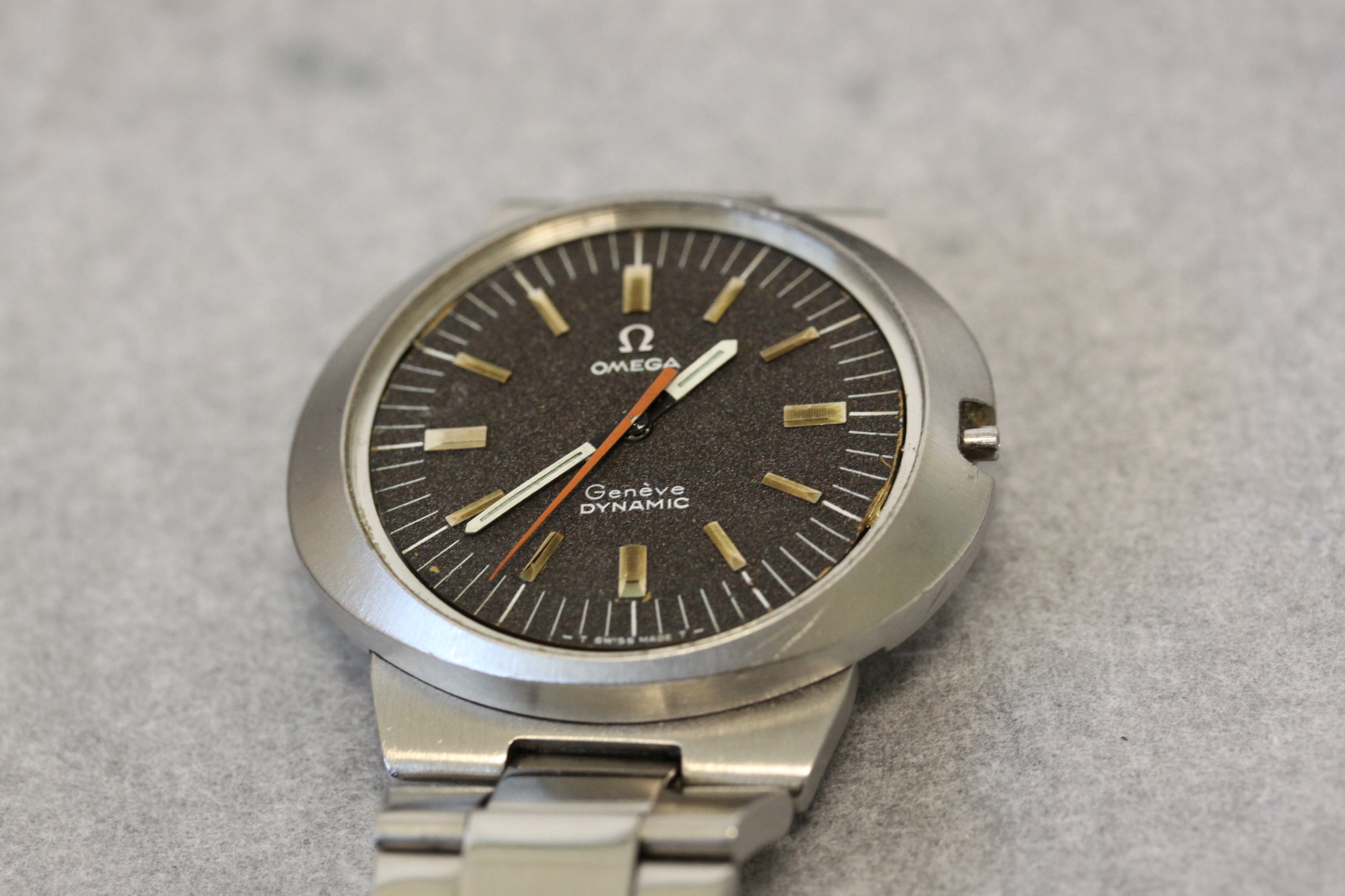

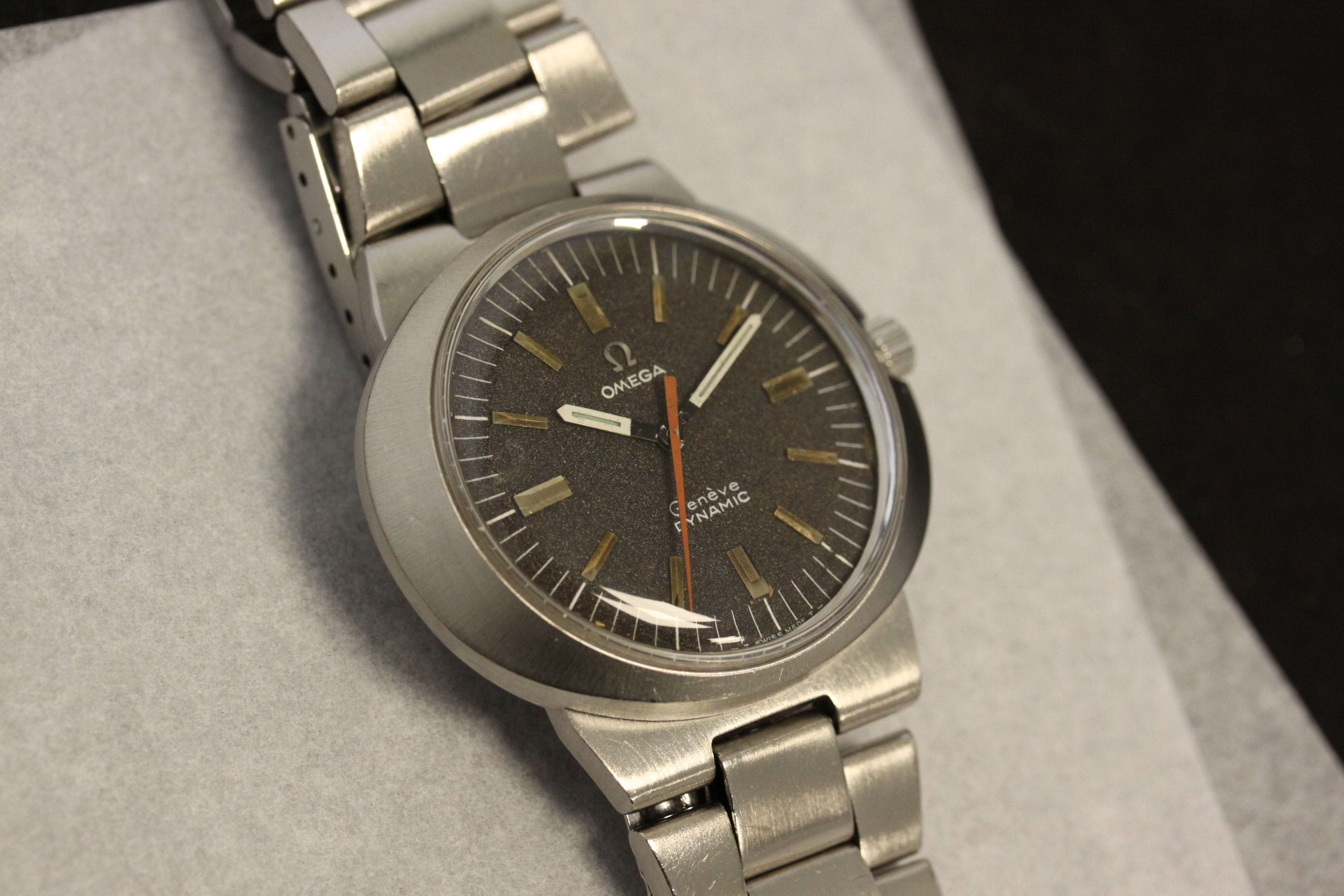

Anyway, now the money shots of the calibre are out of the way, onto my question for the forum. The below was also bequeathed to me by my father when my son was born 4 years ago, I was supposed to get my son's birthdate engraved on the back but have never got round to it but feel now might be the time and at the same time maybe get the case re-plated - see slight loss of plating in the photos. So the question I have is do people think getting a re-plate is worth it?

Not only is the plating worn off, but significant amounts of metal are missing from the lugs and case.
This is caused by minute amounts of perspiration accumulating in areas on the watch, resulting in galvanic or dissimilar metal corrosion, leading to loss of the base metal which makes up the construction of the mid case.
I suspect the cost to strip the plating from the case, perform restorative base metal filling (if at all possible) and replacing the case will far outweigh the value of the watch.
If it was mine, I'd just keep it dry by wiping it down with a damp cloth after use and continue to wear it as is.

There is a beauty in honest wear and the effects of the passing of time.
I believe the Japanese call it Wabi-Sabi meaning acceptance of transcience and imperfection.
In women and watches, appreciate seeing the journey and time they have embraced. It's a beauty that can't be duplicated.
I'm sure you can guess my vote.......I think it is spectacular as is.

Good point, hadn't thought about the filling required. Makes sense about the sweat corrosion - it got most wear whilst we were out in Hong Kong. Thanks for your input.

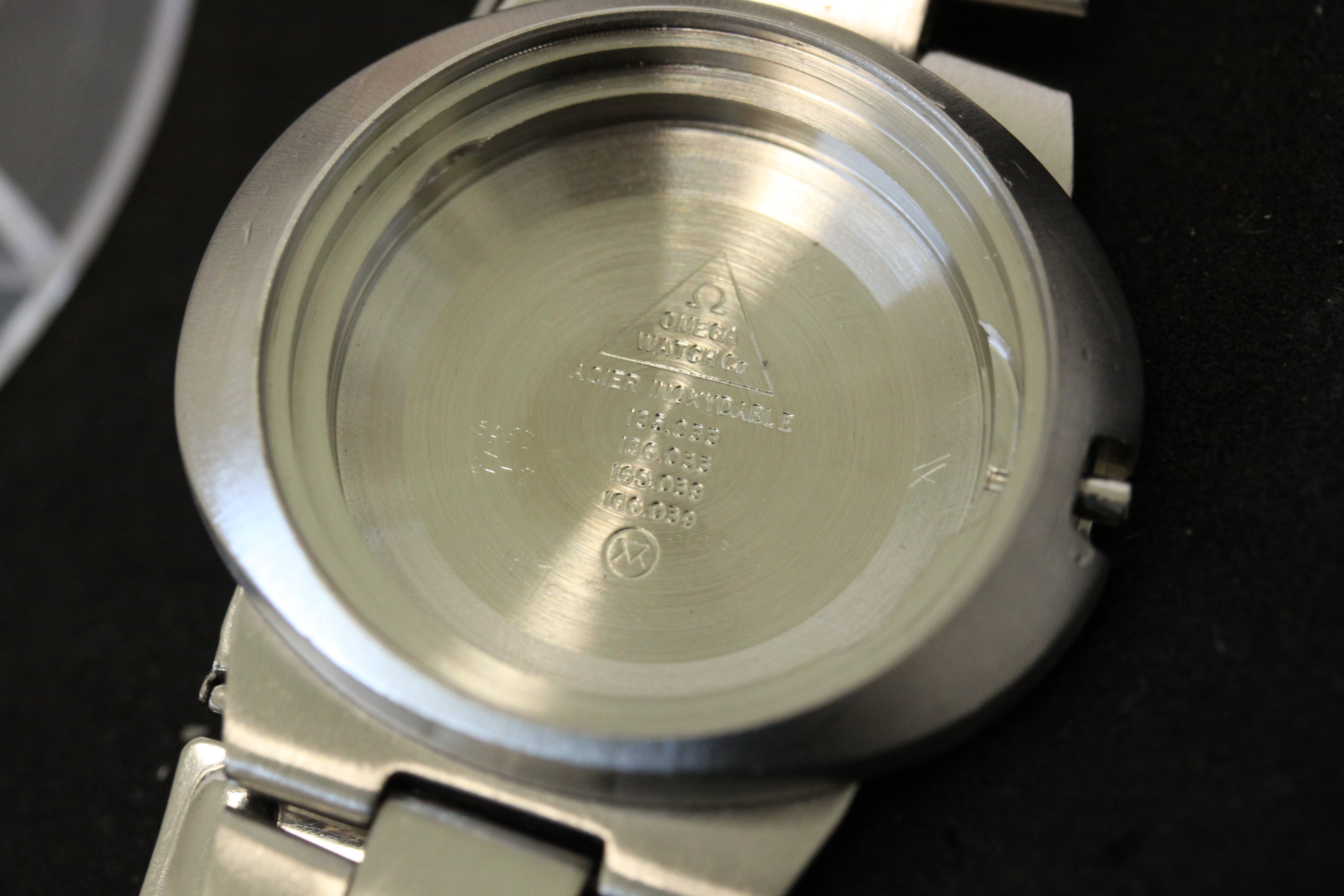

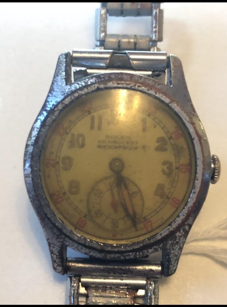

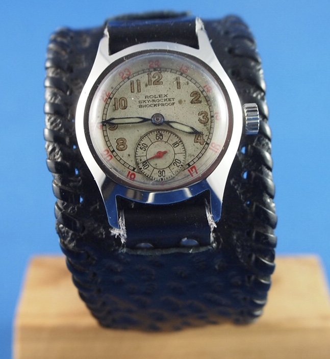

In the hands of the right case repairer, wonders can be wrought. This is a before and after of a case repaired by a firm named Replate-It. Formerly in Quebec, but now located in California. If you have the Omega case repaired, the same damage will recur.
4
Agreed the case does look great and I'm sure getting mine done would make the watch sing that little bit more. Still leaves me with the issue of finding a local repairer and then shipping it to California 😕
