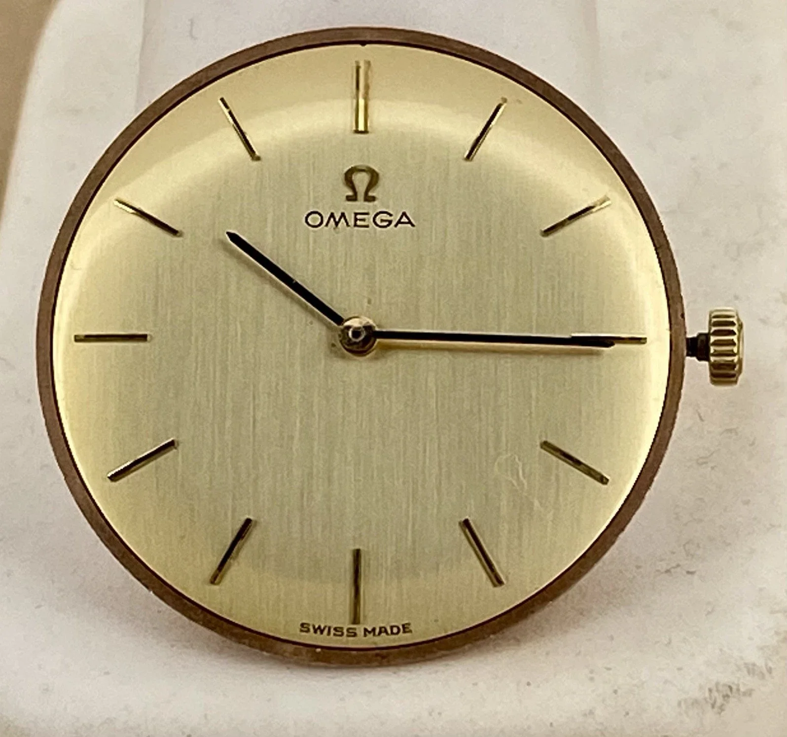

I picked up 2 beautiful Omega dials and movements, a 620 and a 510. They are dials/movements only. I have looked in the usual places and can't find any new cases to recase these vintage movements. Does anyone have a suggestion on where to go or how to use a readily available case to fit these? Any help or advise would be very appriciated.

Well you'll have to do some research regarding those movements. Which case references do they fit and which dials correspond to the combination of movement/case references too. With Omega there are generally many variations which may or may not be correct. Photo's might help.

There are a lot of 620 movements out in the wild. These 18mm movements were used in ladies watches and gents dress watches. I do not have as much experience with 510. That is a 25mm movement, also looks like used for dress watches.
Since these do not have sweep seconds (or any seconds hand) they are not too popular.
27.5 is a common dial size for smaller watches. There are so many dial variations, that finding a similar one is more luck than skill. There is not much reference at hand other than old adverts and catalogs, which could use retouched and even hand drawn images.
Curiously I have a 620 stainless steel case with no dial or bezel. Finding a decent dial for a decent price is difficult. There is a bit of competion for the good stuff, so the overpriced examples (often with visible damage.) sit unsold online.
