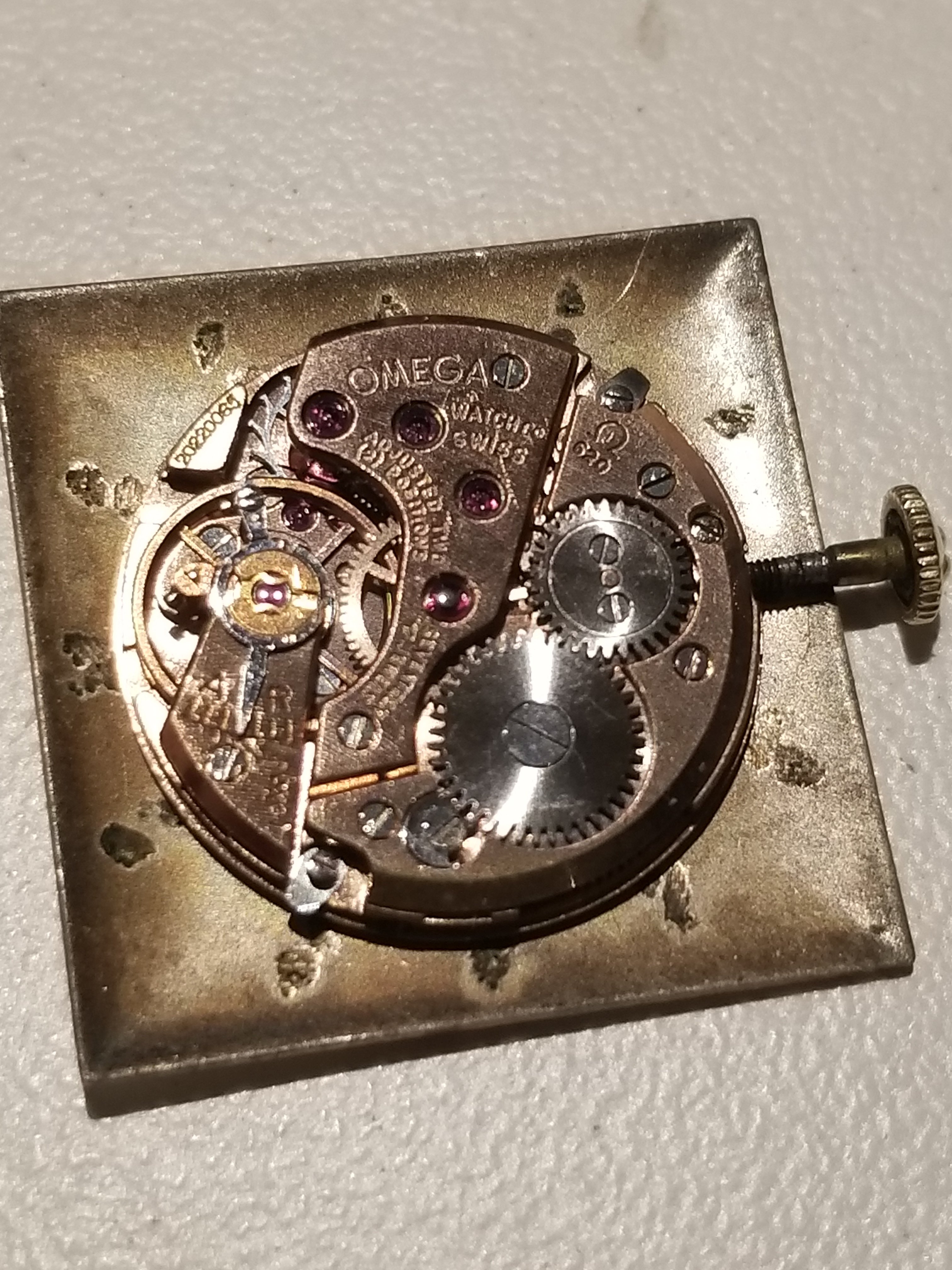

Well, not easy to post pics here. I'll have to get them from phone. I only have a couple. Movement already removed. Working with my local watch guy (pro watchmaker).
Local guy, very expert, but does not have the time and patience to sort parts for a low revenue passion project like this.
10

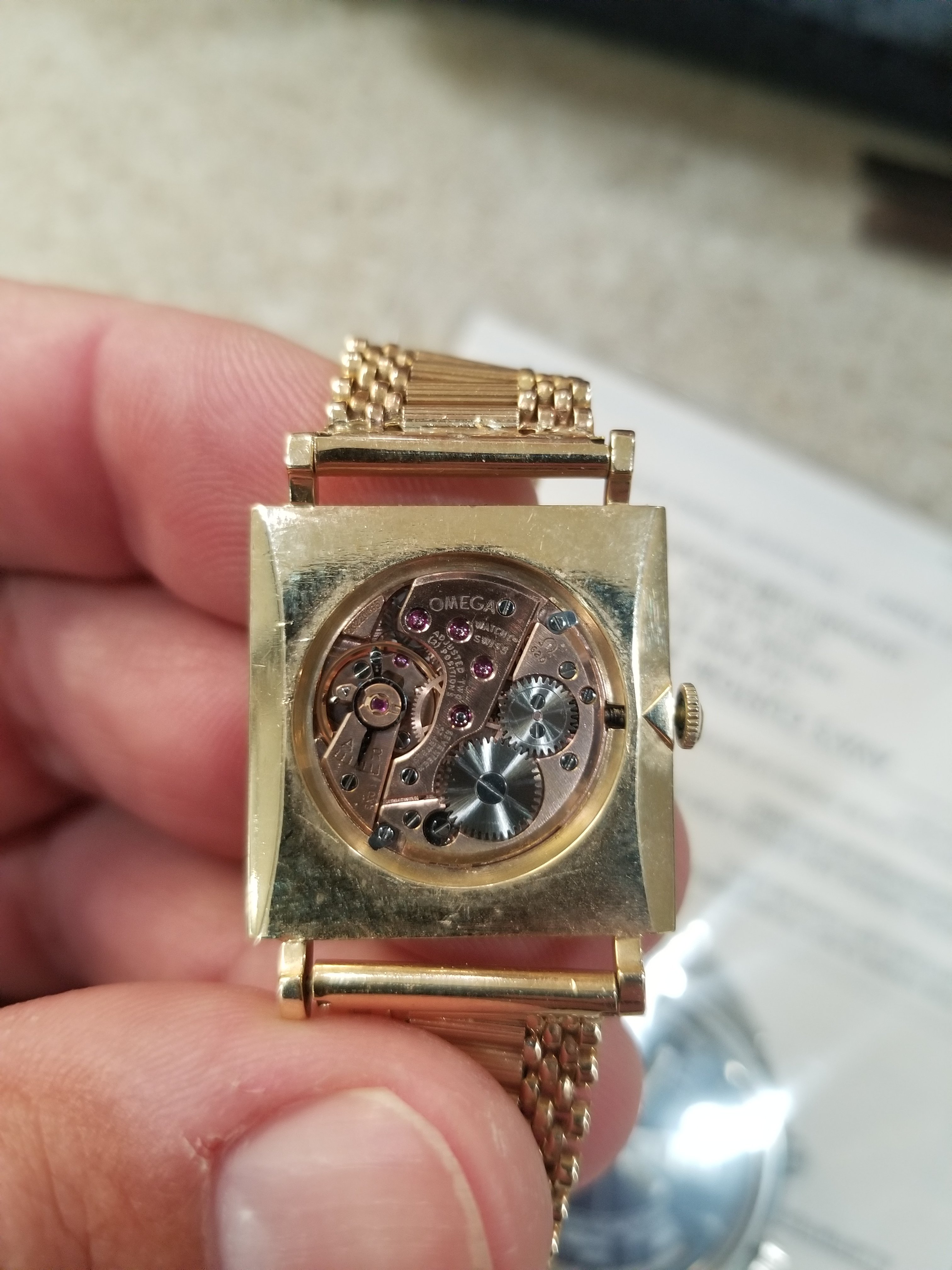

Never seen another with this case and band (and I've looked, for 30 years). Could've even been cased by a local jeweler. 620 movement marked OXG, export for USA.
10
That is my hand holding it. Large glove size, but I don't have huge hands . It's just a small, small watch.

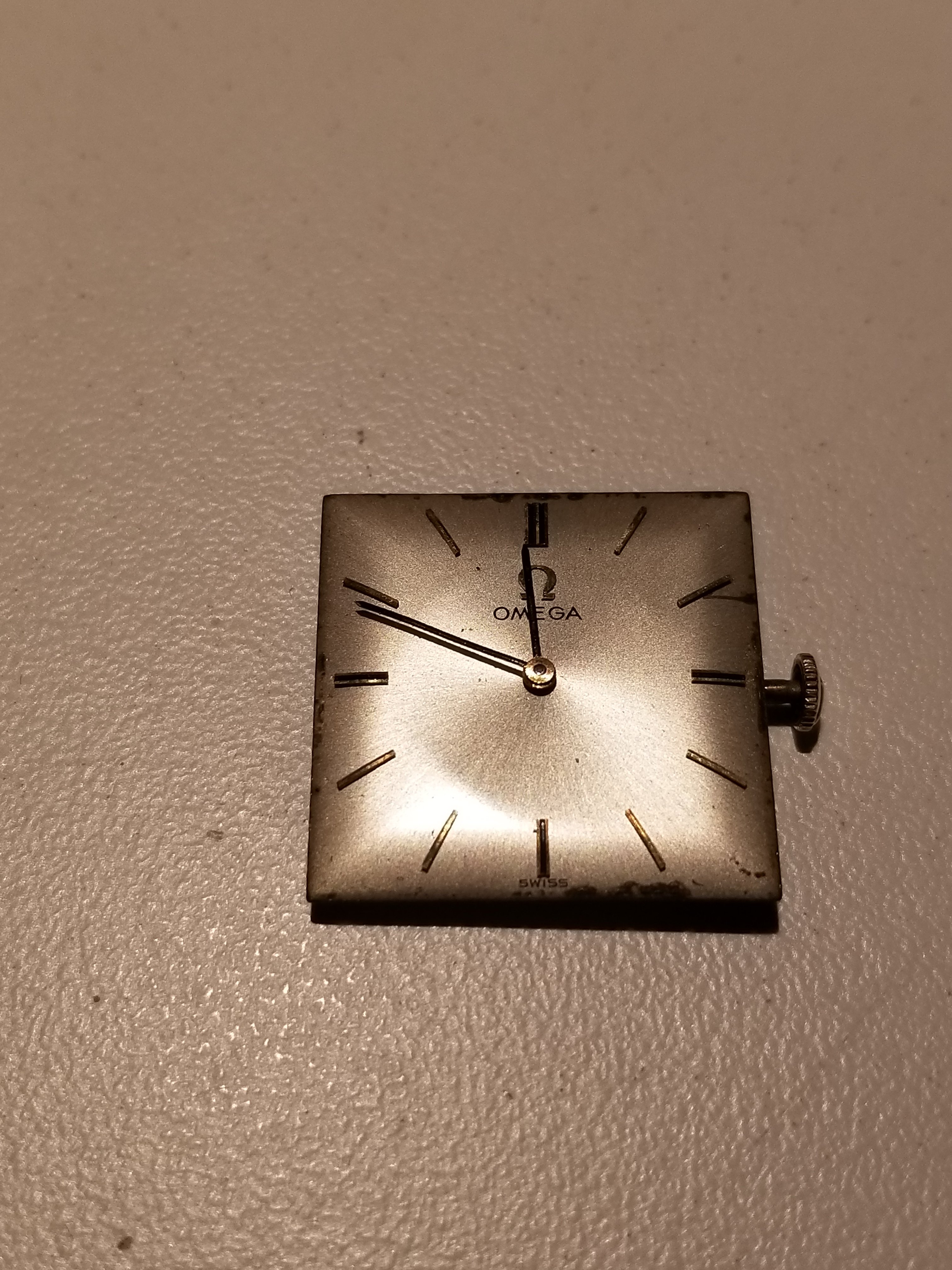

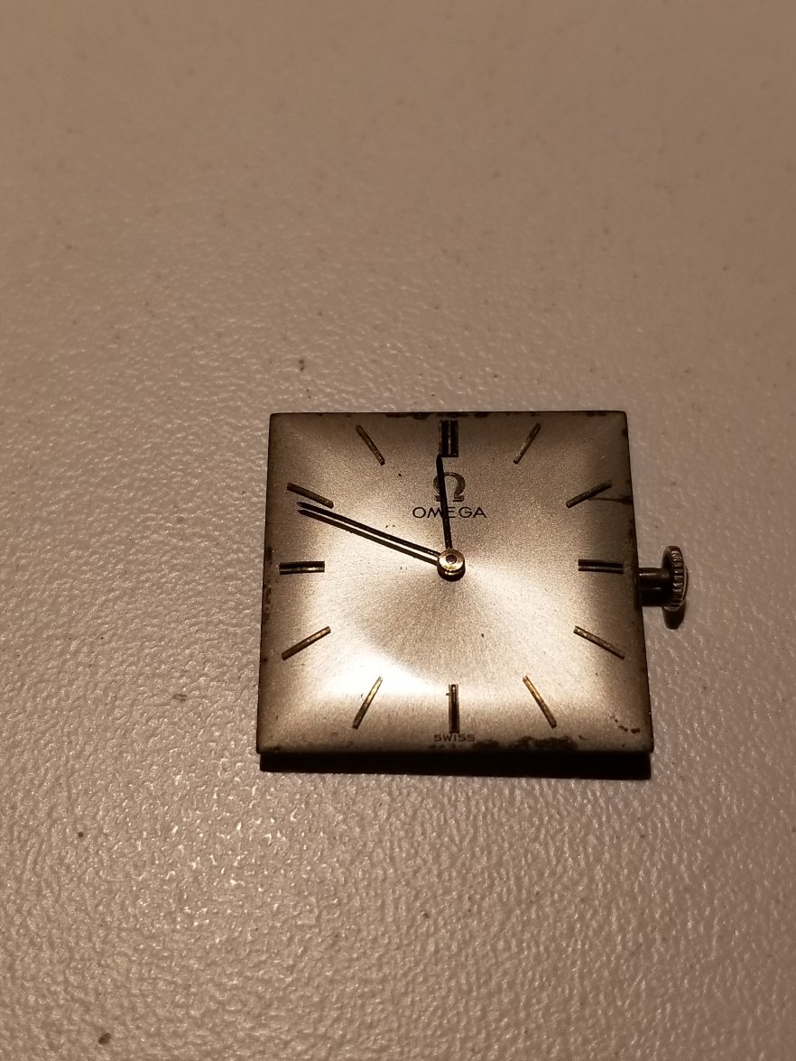

A view of the original dial. I assume dial is local USA also. I guess gold, number of jewels, etc were a big part of the value, affected import duties, so the end run was partial local production.
10
Looks like most (all?) Of the 6-series dials have posts at 11 and 5. Are they all in the exact same positions?
Also, hands could be difficult. I do not see anyone selling hands for these movements. Does anyone know which hands will fit?
