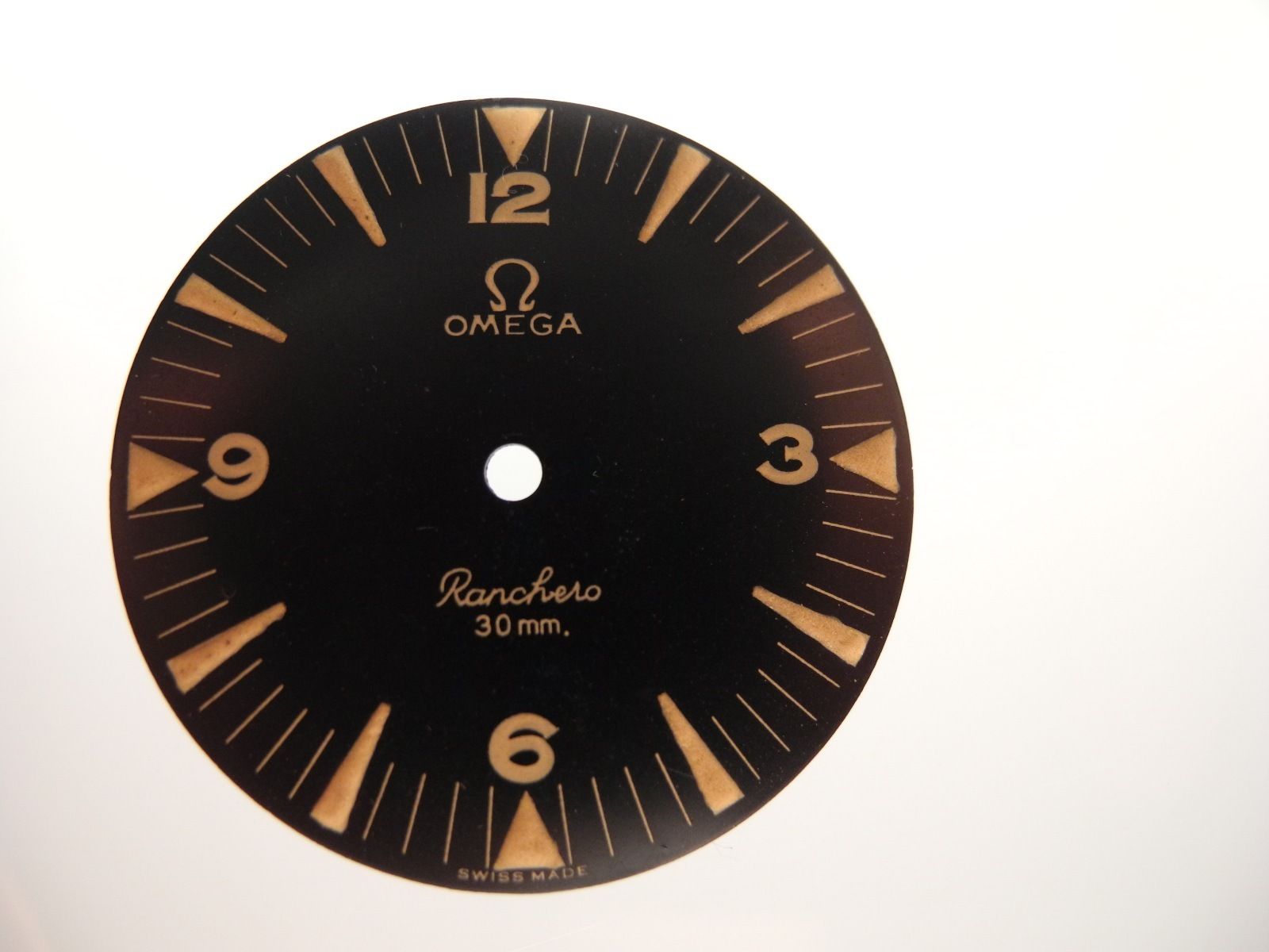

Another thing to look for is that no original Ranchero will have the "Swiss Made" script at the bottom partially obscured by the rehaut like in PitPro's photo reposted here:
I wouldnt agree that is a tell for a fake.
The original and the replacement crystals
For the 2990 have the tension ring built into
The crystal. If the crystal is changed from the original, I think there is a strong possibility
That the silver ring will not be in the original
Position. I think this caveat also holds true
For many vintage Omegas.
1,294
1,808
Ah, very good info...thanks for the reply...

Thanks to this great thread, I am able to see that above eBay Ranchero 2996 dial is not original. Seller believes otherwise. It has some telltale indicators of a copy, Swiss Made alignment is off and it has the extra change direction from Ranchero h to e.

Totally agree with you Marc the dial is not original, The loops on the 6&9 is to close together the 3 sits slight to high as well . The font in omega is a bit ropy as well the letter e is thinner and slightly smaller that the rest of lettering ..

Yeah, I came back to this thread to post that eBay listing, but looks like it's already been addressed. The dial in the eBay listing is the older "closed 6 and 9" version of the replacement dial that was being sold for around $250 before they became unavailable.
And thanks for pointing out the position of the 3 and 6...that's also a good detail to notice. The arrow point should be centered with the middle of the 3.

Fake, fake, fake, fake, I mean just look at the Ranchero script....and that giant Arrow hand....omg
https://www.ebay.com/itm/222203765589
Yeah, I this one is maybe 3rd generation as the numbers are looking worse and that "Swiss" alignment is quite off.

a fake IMHO is when some one is trying to sell an item that is clearly not genuine in the gentleman's favour he clearly states the dial is redone therefore not quite the same. crown is a replacement .but from the rest of the add the movement case back and case all look genuine.

OK, true. Maybe I was a bit harsh. It's just frustrating how many "redials" there are around. And I'm guilty of this too with my redialed 2996. But like I said earlier, these dials aren't made to survive the decades like the rest of the watch and its just unfortunate that Omega did/does not have any official replacement dials available.
