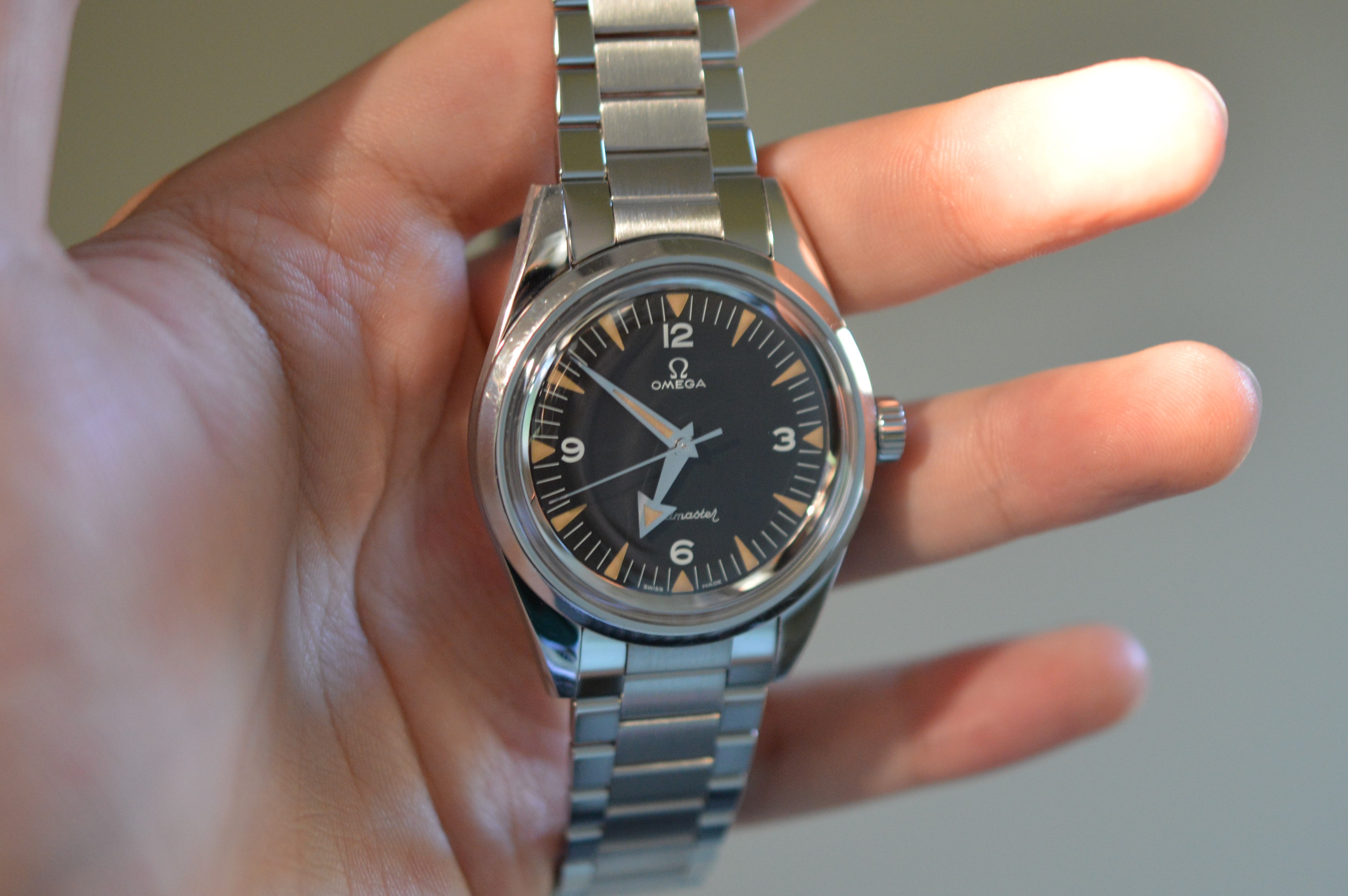

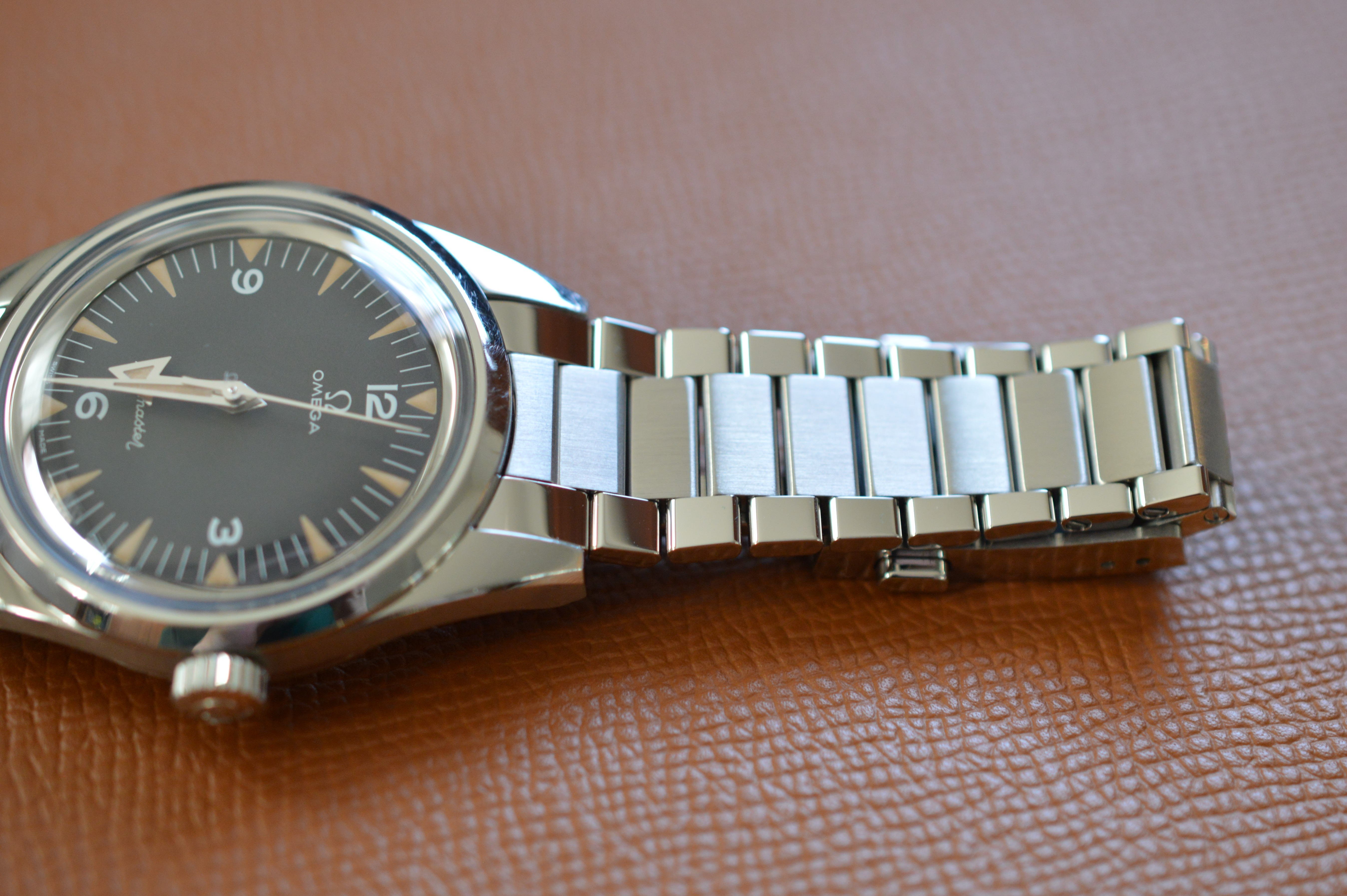

Hi David
Thank you for your explaination and the pictures, because my fist plan was to buy the Fortner Flatlink, now I am glad to own the 321er bracelet.
OK, it ist a lot more expensive, but for me it is worth. Yes, the Forstner links semms to be a bit to small, you can see a gab between, with the 321er there ist not so much space. The rattlings bracelet is for some Omegalovers the sound, they want to hear, others get stressed, I think there ist no right or wrong, ist semms to be a matter of taste 😎
I know what you mean. I don't mind the bracelet band rattling a bit but I think the way the Forstner endlinks flap on the RM case is too much. It's also not pretty when I catch either of the endlinks "up", showing a gap. It's a shame, because the bracelet is beautiful and very comfortable. I'm sure it's great on the Speedy. Will need to bite the bullet and order the calibre 321 bracelet for the RM.

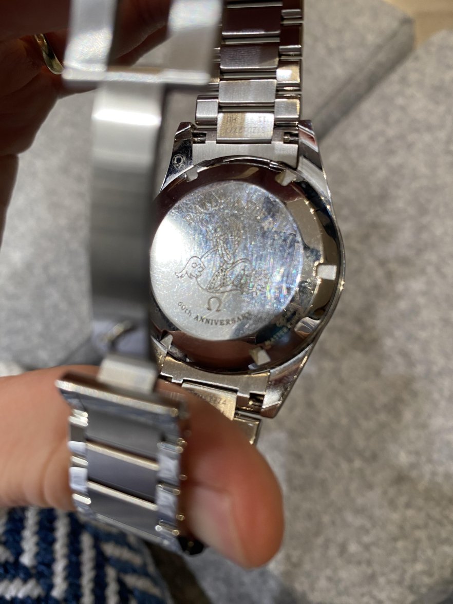

I just picked up the 321 bracelet for my RM (looks great!). It took 2 months. According to my OB, the bracelet is made upon order.
1,957
5,922
Photos or it didn't happen! 😉

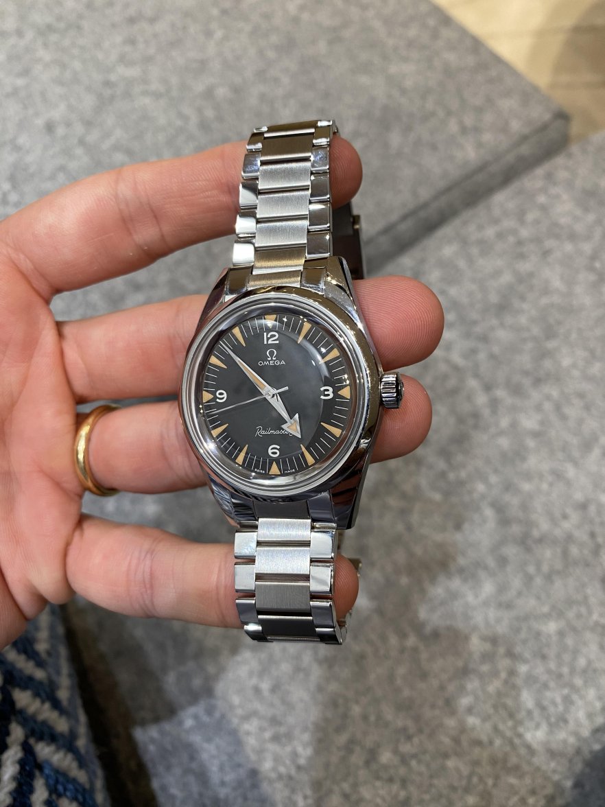

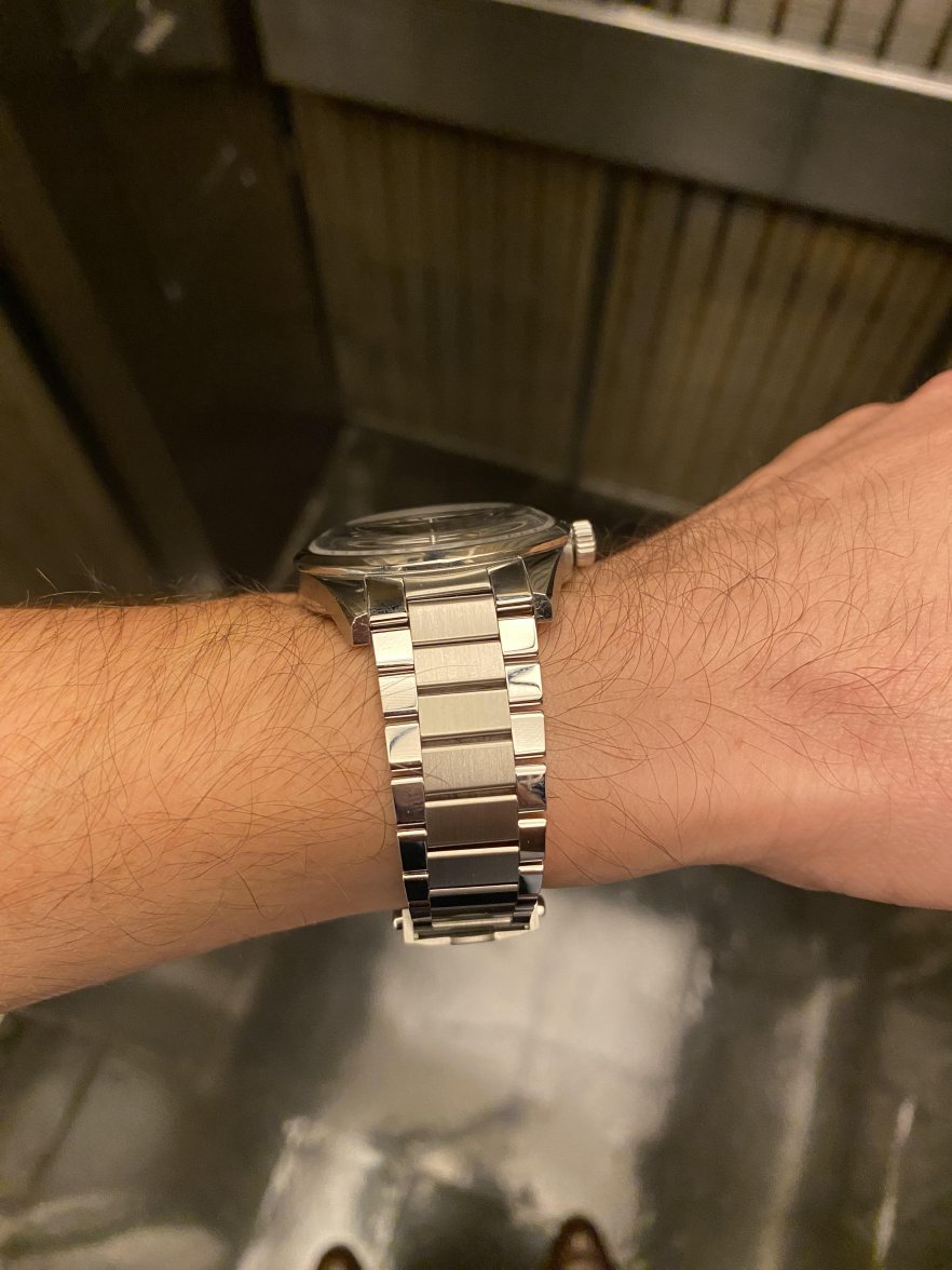

Ever since the 321 was announced I've been trying to get my hands on its bracelet to try and fit it to my Trilogy Railmaster. Today, I was able to do just that - and I am quite satisfied with the results.
One thing that has recently bothered me about the original bracelet, aside from its thickness and untapered profile, is the difference in the width of the center links compared to the original. On the Trilogy bracelets, the center link is 12mm wide, whereas the original flat links, as well as the 321's, are 10mm.
On the wrist, the bracelet is comfortable. While I didn't mind the chunkiness of the original, I do feel that the light and supple quality of the 321's bracelet is a huge improvement. It also doesn't hurt that it makes the watch a more accurate aesthetic approximation of vintage 2914s.
With that thought, I've said pretty much all I have to say. It's a fantastic bracelet, and I'd recommend people take a look at it if they get the opportunity to.
Some hastily taken beauty shots:
Many thanks to the Fashion Valley OB for being great to work with, as always!

There you go! Very happy with the result.
Yes - had to use slim spring bars, not the ones that come with the bracelet. I did it myself because the technician wasn't in at the OB until tomorrow and I couldn't wait. I just used random 19mm spring bars I had at home. In my experience, most non-Omega 19mm spring bars are thinner than the Omega RM ones.
