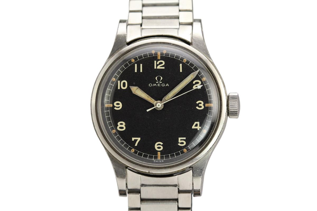

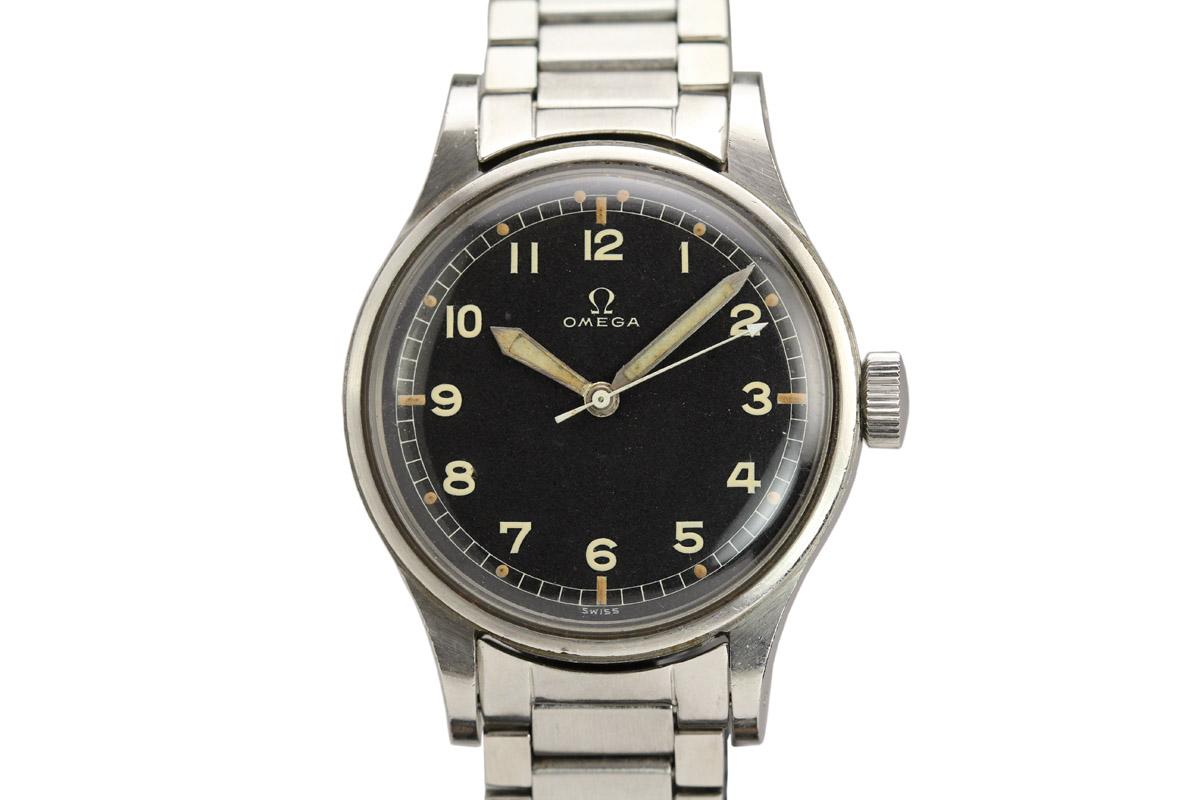

Found this yesterday at Goodwill while visiting my dad over the weekend. Reference number is 277-2sc with a Calabar 283 movement. I can't find anything online that looks similar to the face. Looking to see if I found the real McCoy or if it's a dud.
Let me know your thoughts

Congrats OP on the find!
A 2777-1 is the best place to find a workable antimagnetic dial to refinish, hands and movement parts.
1953 2777-1 “Fat Arrow” RAF
Just curious, why would you take a dial from an RAF fat arrow instead of the dial that’s on the watch? Would you try to just have the RAF dial “touched up”, paint over the broadarrow and just have “Railmaster” printed on it without anything else?

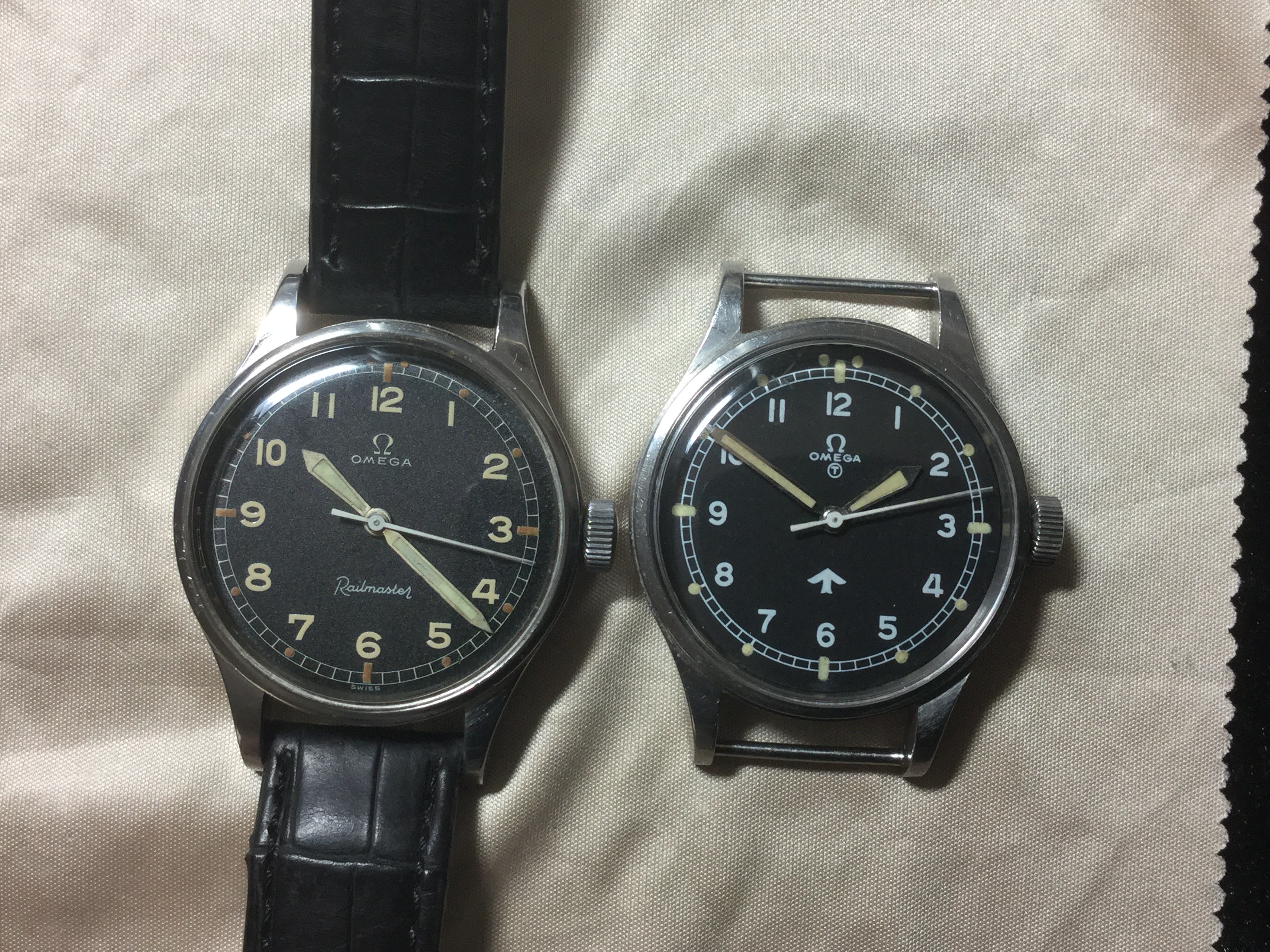

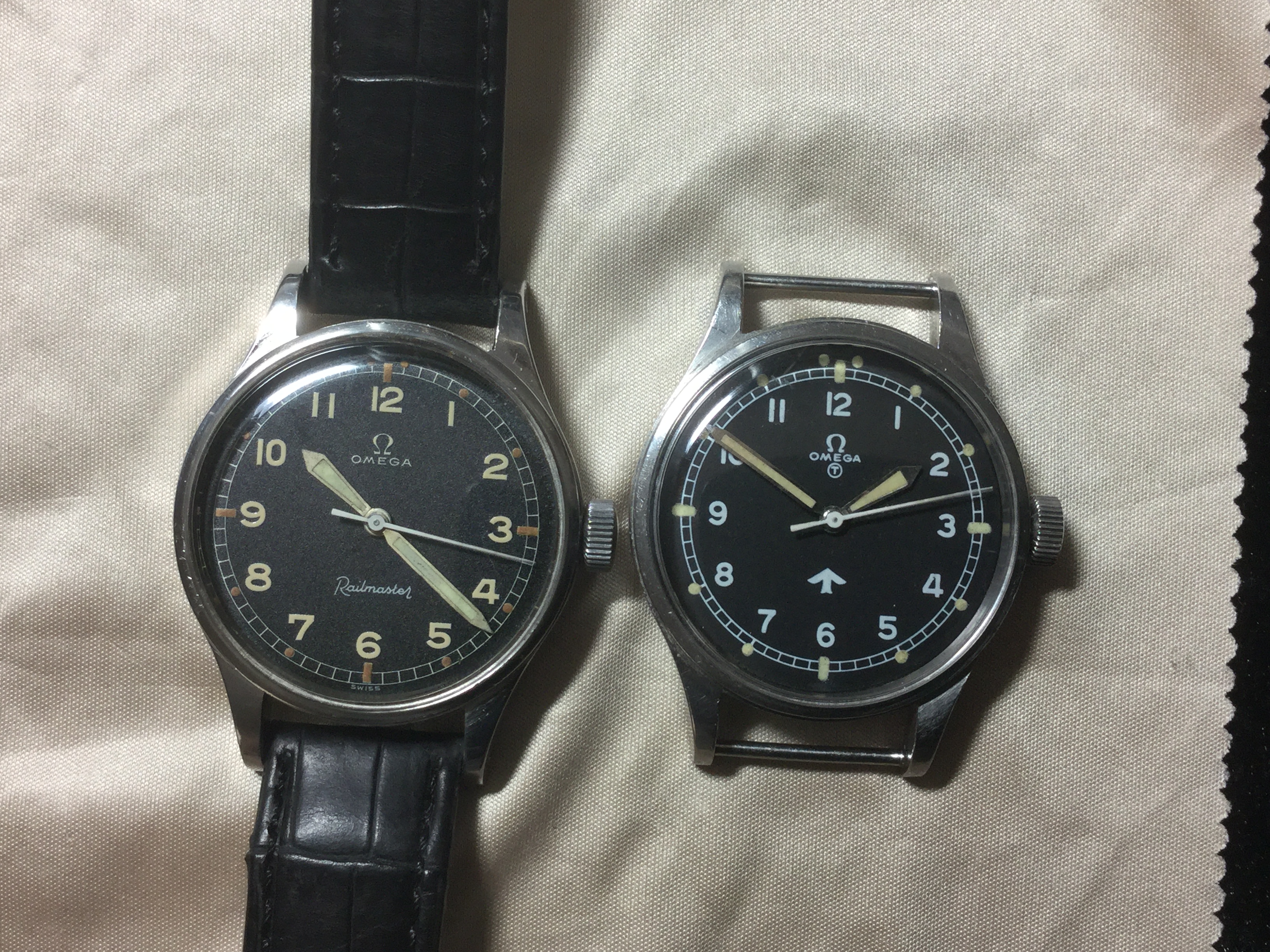

Well, a big determinant would be the OP dial. Is it a thick anti-mag dial at all? If it is an original dial plate, I can’t think of any reason why it was altered in the first place. Using a 53 2777-1 as donor for dial, hands, movement parts, case perhaps, offers a few options. Leave it alone, add the Railmaster script or leave it sterile, as a few other 2777-2 were produced.
Comparing the 2777-2 Railmaster and 2777-1 RAF, they are quite similar in layout.
Here is a 2777-2 “sterile” version.

Touching up, refinishing the dial was common but the OP Railmaster dial is like nothing (luckily) every produced by Omega for an early Railmaster. Normally, the touching up is to restore the original dial look.
That’s why I’m curious if it’s even the original thick (1mm) RM dial as it’s appearance is so difference from any 2777-2 produced. If the OP dial turns out to be a thin, 0.4mm “regular” caliber 283, 284, 285, 286 dial plate then the watch has lost the antimag qualities it was designed to have. A donor 2777-1 RAF dial would restore antimagnetic characteristics of the watch.
